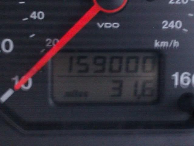

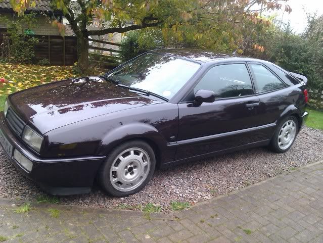

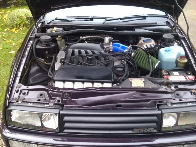

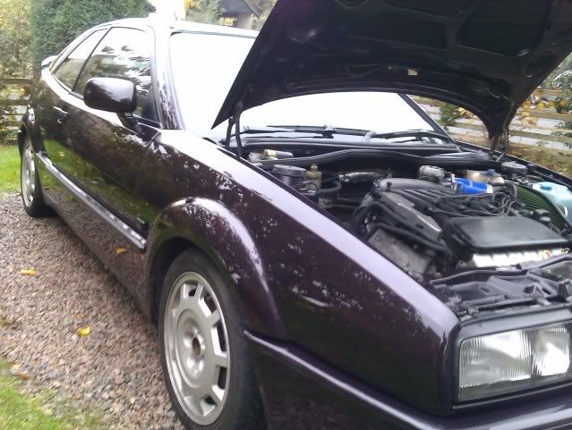

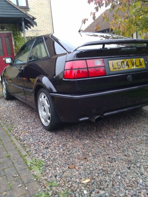

Swompy 0 Posted November 20, 2011 Today the old girl got a bit of a pampering ready for the winter weather. She had a wash, quick polish and two coats of collinite 476 wax to help keep the salt off the body on my next day off I will give it another quick wash then one more coat of collinite was followed by some soft turtle wax to give it a nice shine :D Any way enough talking here are the pics (excuse the wheels, they were put on whilst the car was getting the engine change, the BBS's will be back on soon) The compulsory engine shots Ans whilst taking it for a spin the car millage clicked over to this. Cant wait for spring to come around again so I can give her a proper detail and going over with a machine polisher as there are so many scratches :( Over and out Quote Share this post Link to post Share on other sites

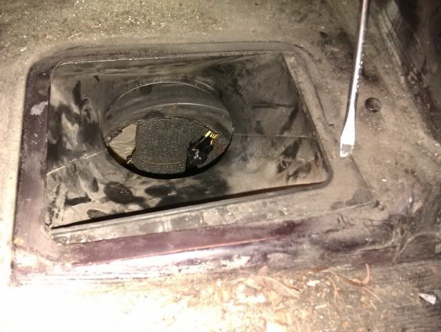

Swompy 0 Posted December 3, 2011 Just ordered the parts to replace the foliage seal as mine is leaking and the fan doesnt work. So going to have a good old week of getting dirty on the old girl as Im not working :D The parts came to around £9 so even cheaper than the Wiki page says so there is no excuse not to do it now http://wiki.the-corrado.net/changing_heater_scuttle_foliage_cover_seal.html Quote Share this post Link to post Share on other sites
Swompy 0 Posted December 9, 2011 Replaced the foliage seal today after coming across a bit of a snag with the fan housing Fitted the new seal and put it all back together with a working fan. But only works on number 4 so will be sorting that bit out later. Going to take the bumper off later and give the front sub-frame a good clean up as its covered in rust. Will up date later :D Quote Share this post Link to post Share on other sites

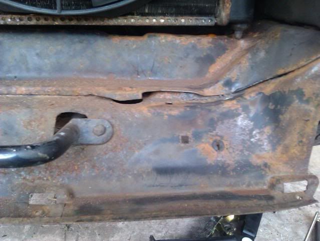

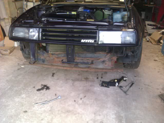

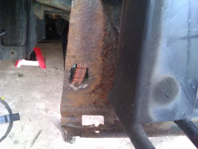

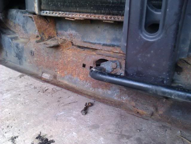

Swompy 0 Posted December 9, 2011 Started to take the front end apart to get at the rusty cross member. Now do I take it off complete or do it as is? How easy is to to remove the cross member? As I needed to be able to put it all back together before the end of tomorrow due to work and possibly moving house soon. [ATTACH=CONFIG]50542[/ATTACH] Quote Share this post Link to post Share on other sites
Swompy 0 Posted December 9, 2011 Also snapped one of the tabs on the grill as well:mad2::pale::onfire::brickwall::mad: Quote Share this post Link to post Share on other sites
CazzaVR 0 Posted December 9, 2011 Pretty easy really. Remove the lights and the slam panel first. Then its just a couple of bolts. Remember to undo the top of the engine mount and support the engine! Quote Share this post Link to post Share on other sites
Swompy 0 Posted December 9, 2011 Cheers Andy What do I do about the cooler pipe (PAS I think) that goes through it Quote Share this post Link to post Share on other sites
24V Renshaw 0 Posted December 9, 2011 Take it off with a receptacle for the power steering fluid which will come out. You need to support the rad too. Quote Share this post Link to post Share on other sites

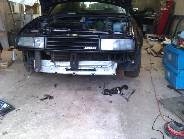

Swompy 0 Posted December 13, 2011 Took the front bumper off to clean the rad support up earlier this week and it has finally been put back together. Learned a lot doing it believe it or not and cant wait to get my hands dirty on other parts of the car. On the down side I will be moving out of this house soon (buying my own place :dance:) and the garage I'm going to is tiny so wont have the space I have now :( . Looks like all the work will be done in the summer when the weather is good When I started to clean the rad support up I found it was had more rust than I thought so didn't go to town on it as there was no point. I gave it a clean up with a drill and wire brush attachment followed by a coat of hammerite paint. Unfortunately the only colour I had was silver and I wasn't going to buy another pot when this one is still full so just stuck with it. :afro: Next year I'm going to get hold of some good condition rad support, front cross member and bumper Iron (bit that goes at the bottom of the bumper by the splitter) and get the powder coated along with a few other things :D Any way enough talking time for pics and excuse the mess in the garage I need to get rid of a lot of parts To start with The worst bit All painted up Quote Share this post Link to post Share on other sites
