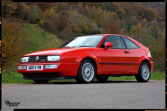

I think they suit some colours better than others. Like red for example:
