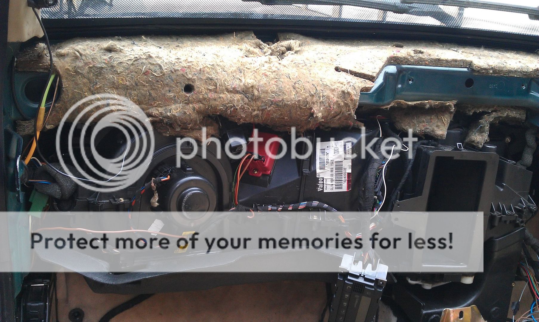

fla 9 Posted April 5, 2011 Do you have any pics of the unit you installed? Now i'm not sure if mine is a Passat unit or Golf..... Quote Share this post Link to post Share on other sites
krnau 0 Posted April 5, 2011 This is the only one I have :( It came off a 35i passat. This is the square shaped unit, and had to be trimmed to fit. Adapting it to the corrado centre console was a real PITA. I even had to trim the climatronic inner circuitry and the centre console plastic sepparators.... It took about 4 or 5 hours to make it fit propperly, really!! Quote Share this post Link to post Share on other sites
krnau 0 Posted April 5, 2011 oh, and you'd know that the climatronic controls the radiator fan as well, so this part of the wiring needs to be removed and replaced with the climatronic one, which works together with the VR6 rad fan relays (the ones in the engine bay)... so if you've not already got'em.. you'll need to wire them as well!! In addition, you'll need to trim/replace the glovebox if you don't already have A.C., as well as the lower shelf. Would I do it again? er.... probably as I'm crazy LoL!!! Quote Share this post Link to post Share on other sites
