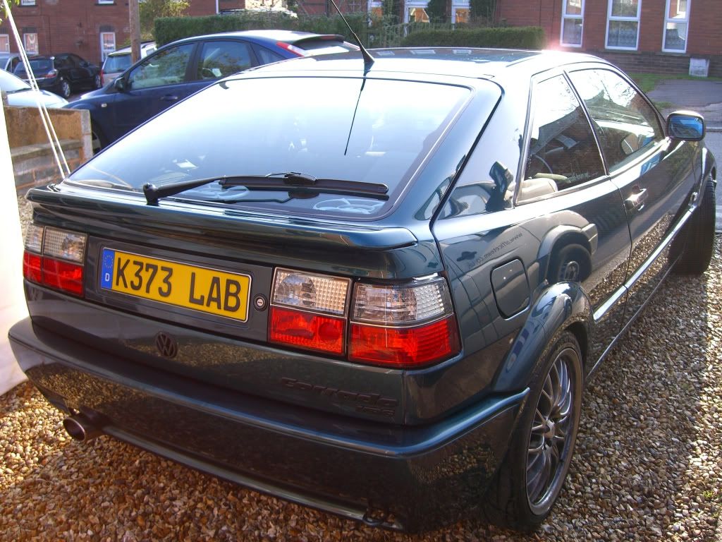

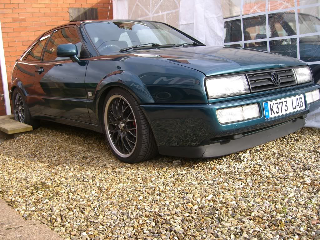

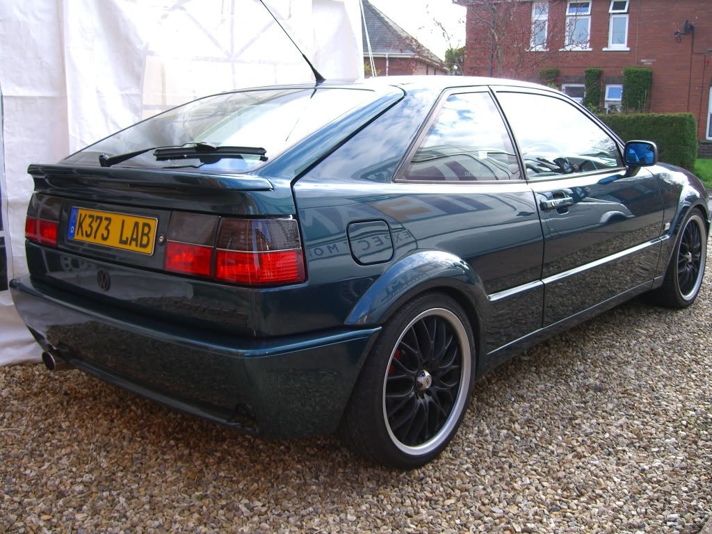

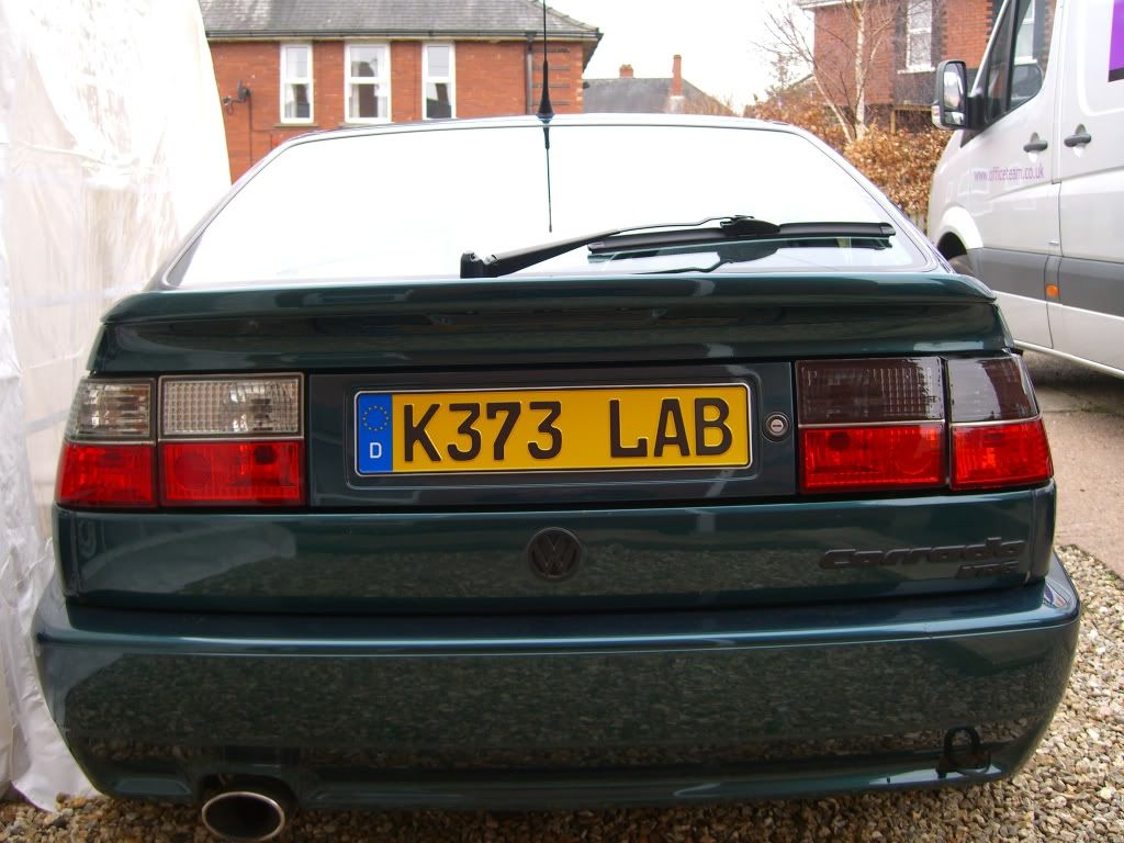

Picked this up a few weeks ago now, so thought I had better get some pics up.
As I bought it.

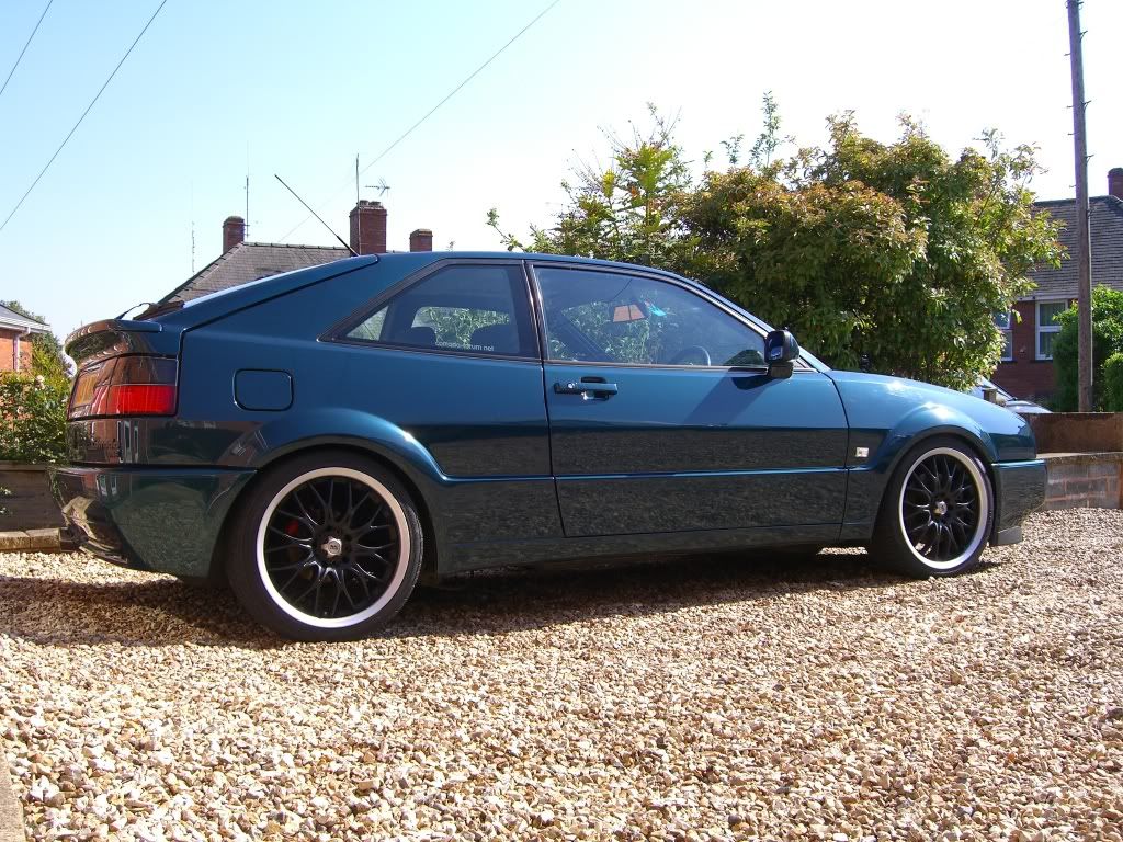

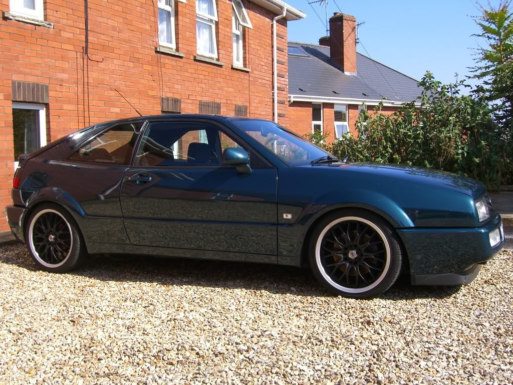

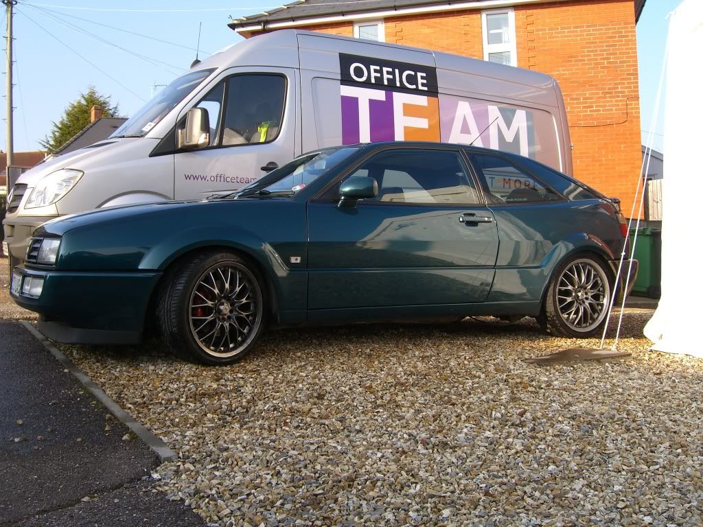

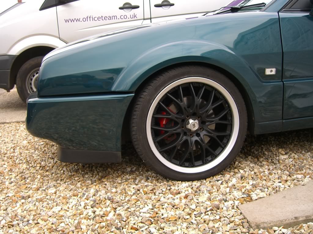

Since buying it I have fitted some 288mm front calipers from a mk4 1.8T with new brembo discs, fixed the broken water temp gauge, put some dials and a stereo in and fitted aero wipers.
Also refurbed the wheels myself with matt black centers and silver rim, and lamin-x'ed the rear lights.
How it looks now.
Got some infinity door speakers on the way to sort out the sounds a bit.

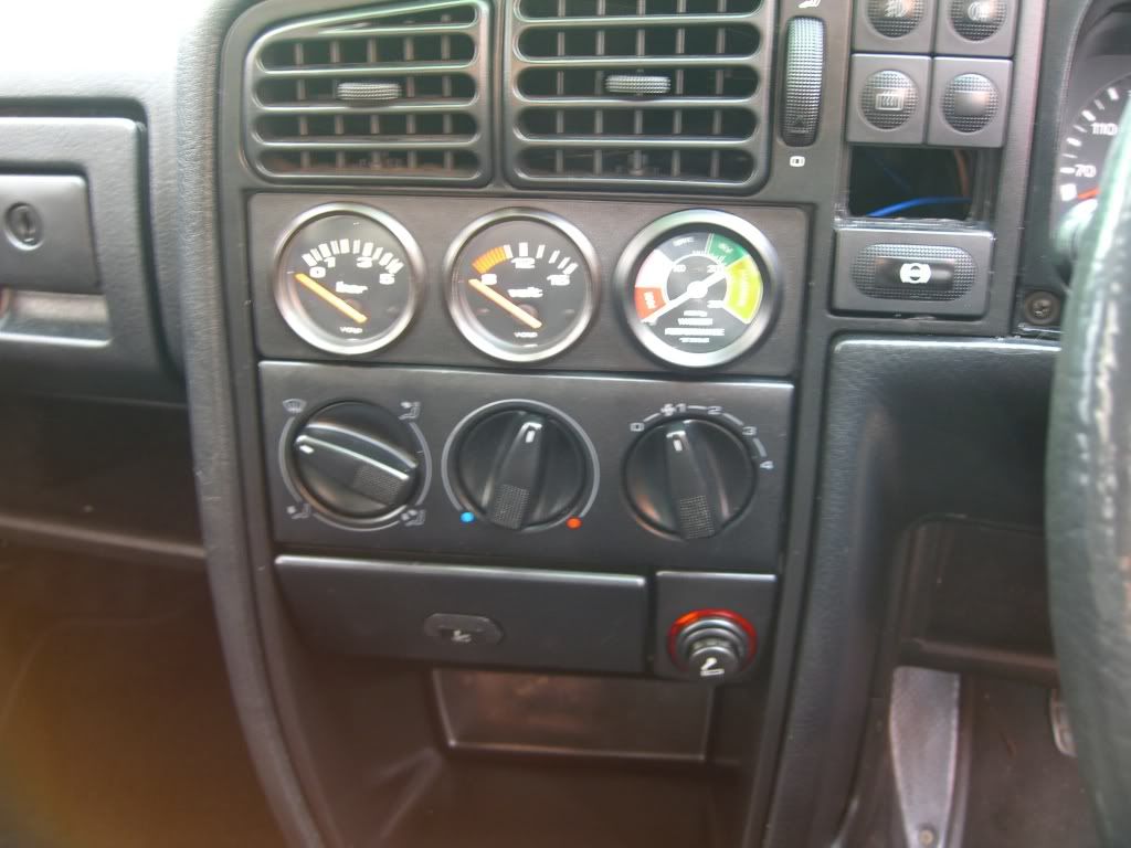

Got fed up with the hole in my dash, so made a blank out of wood and sprayed it matt black.
Also got a load more gauges fitted. On the look out for a cheap de-cat pipe now so I can get the wideband plugged in.

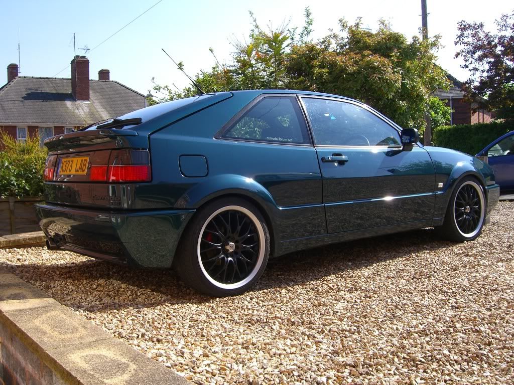

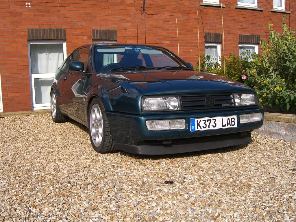

Seeing as the weather is good and its just been cleaned some new pics.:cool:
These shinny bits are also ready to go on once the wideband bung is welded into the de-cat. and its been heat wrapped.

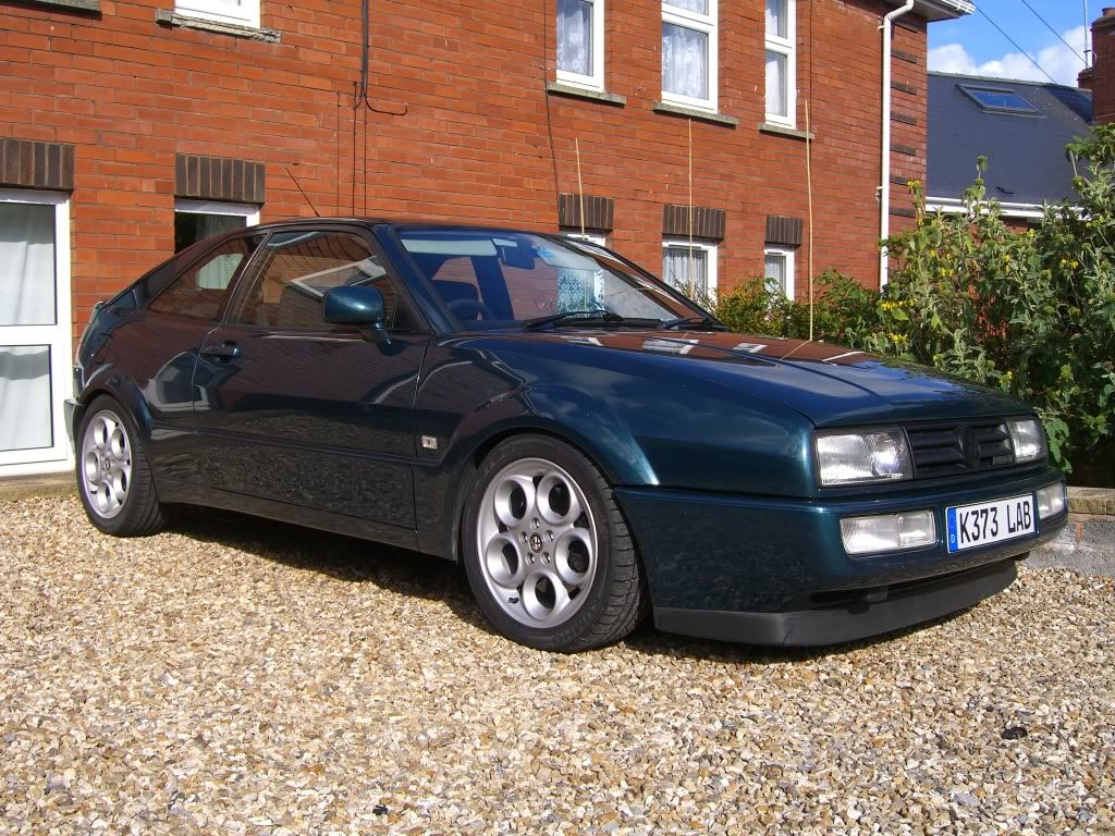

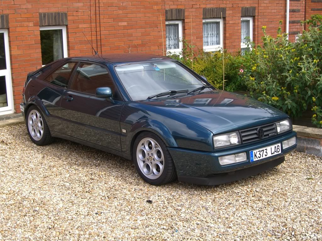

Picked these up yesterday.
Getting them acid dipped then going to have a go at polishing them. Plan on fitting some 205/45/16 which should make the ride a bit more pliable. Will also be good to have some decent tyres, as the car has cheapo Fullways on the front and equally **** tyres on the rear. Thinking Rainsport 2 if I can get a good price or Kuhmo'

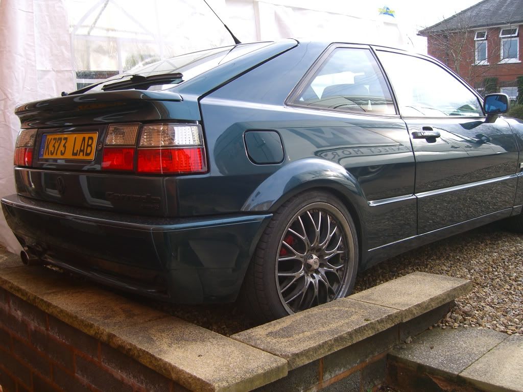

Gave up on polishing and ended up painting them. I also wanted them on this side of x-mas, and polishing by hand to get the casting marks out is a complete ball ache.
Got some custom made spigot rings made up for the 1mm difference in hub size, and also some 9mm spacers to clear the front brakes. Drilled out the wheel holes to allow the wobble bolts to do their thang and hey presto, wheels that fit.
Ride is massively better now, as should be grip after a few hundred miles. Steering is lighter and there is also less road noise.
Went for 205/45/16 Kuhmo KU39's in the end. £240 delivered from cam skills, then £25 from a local place to get them fitted.

Always considered Alfa wheels and now I know what they look like! 10 times better than when you first got it!
Cheers, wasn't too sure to begin with, but the more I see it the better it looks.
