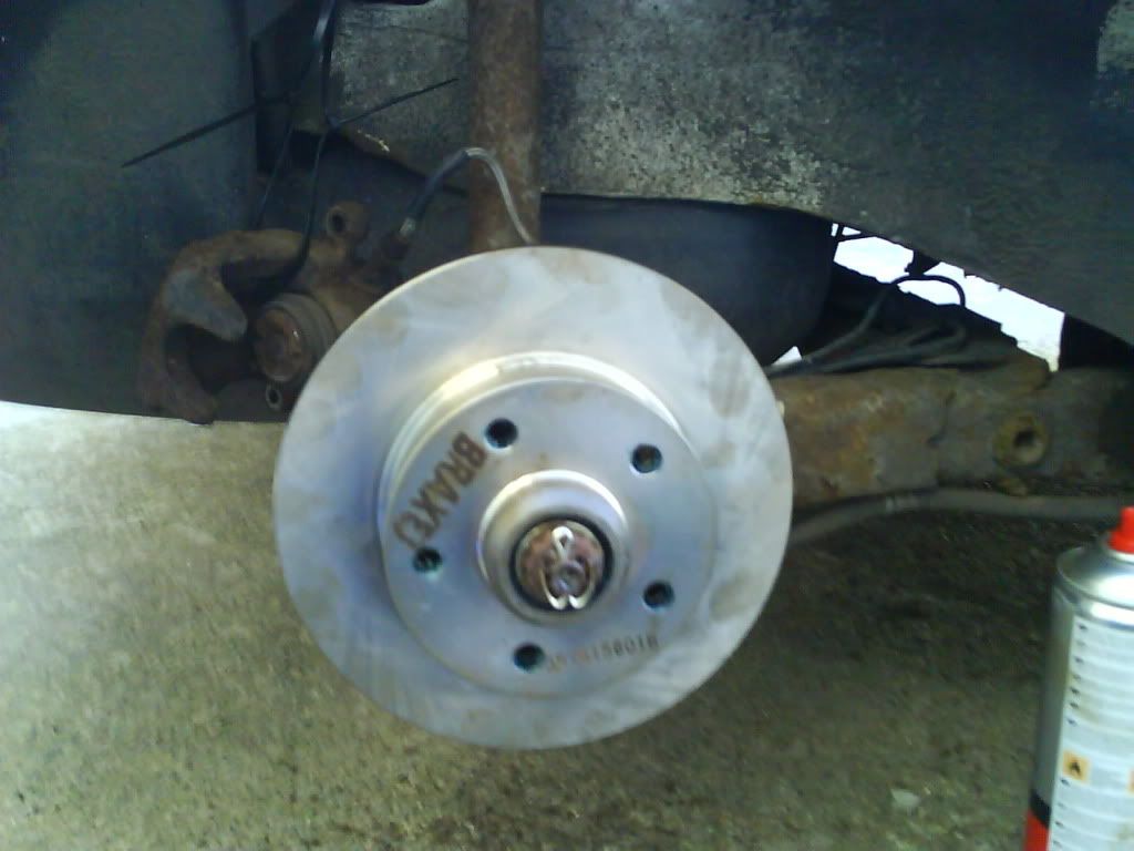

as it had a slight weep,{sry no pics}, new discs and bearings on the rear,

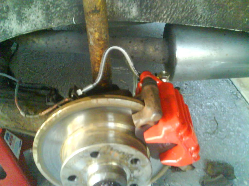

didnt take long to fit, hardest part was removing the caliper carrier,

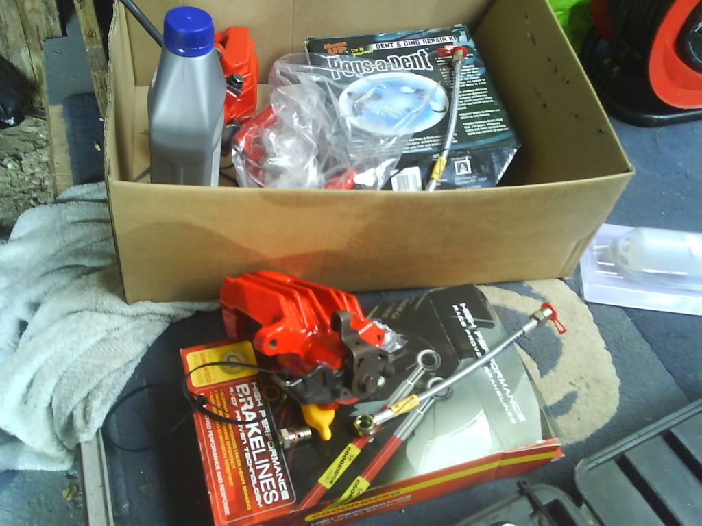

next up was sorting the handbrake out! mk4 calipers and conversion hoses..
wasnt to bad to install,apart from the brake fitting being seized to the copper hard line,
had a spongy feel with the new pads bedding to the disc even after being bled 4 times,
its all worn in now,brakes are spot on!

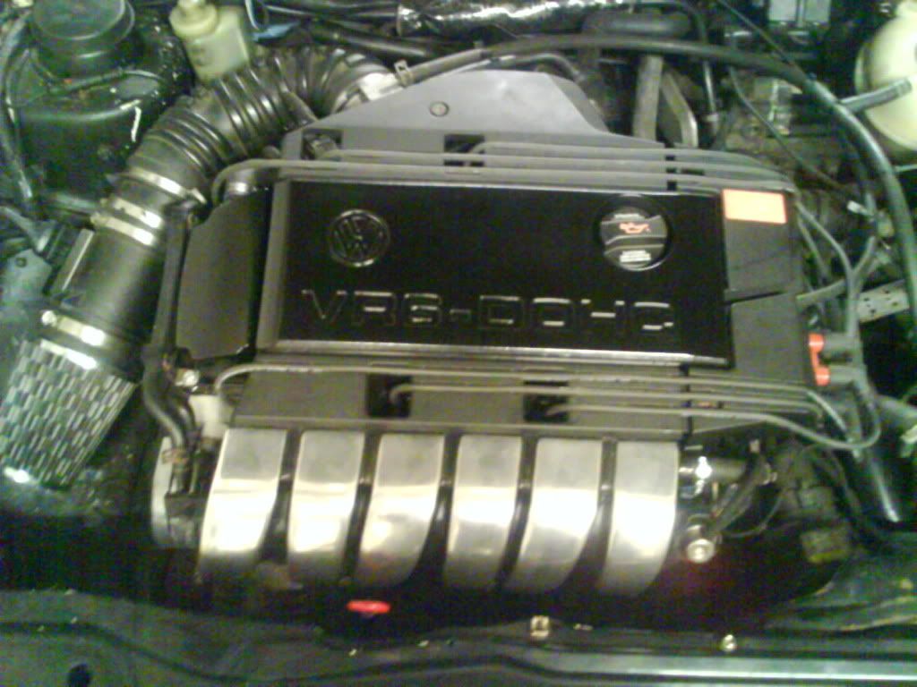

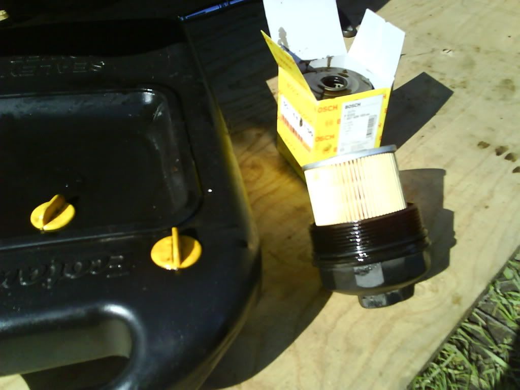

did an oil and filter change and sorted out a leak from the knock sensor and oil cooler,
this seal prety much turned to plastic.
gota love new parts :) if you havnt got one of these sealey oil drain pans idd get one!
they make oil changes an absolute doddle!

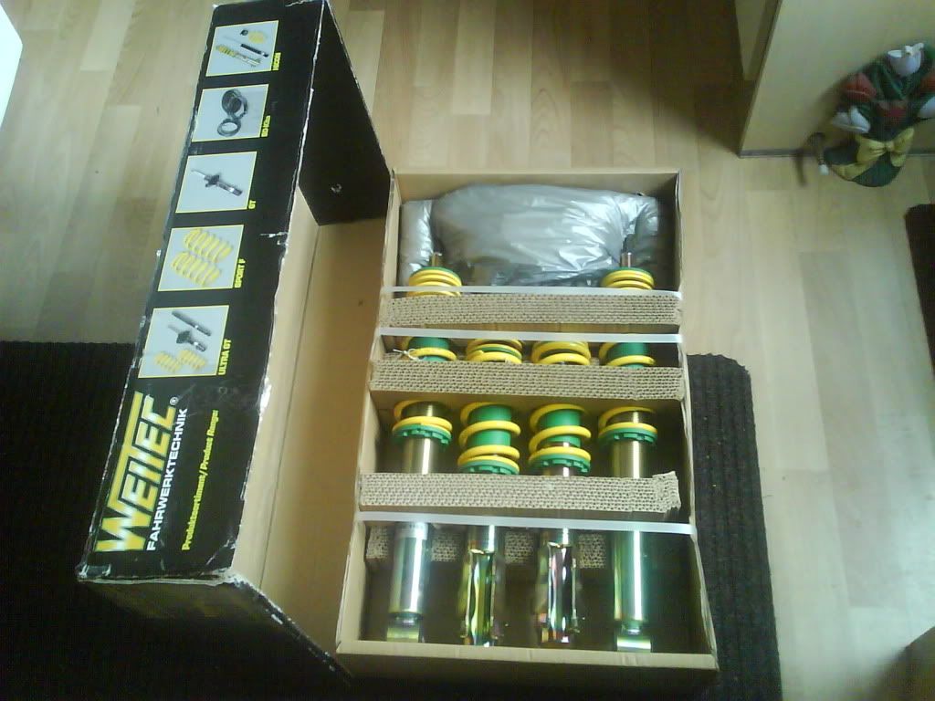

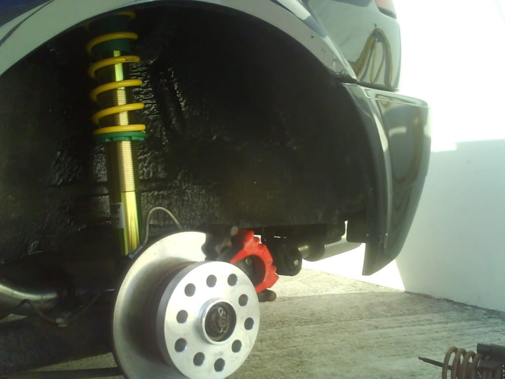

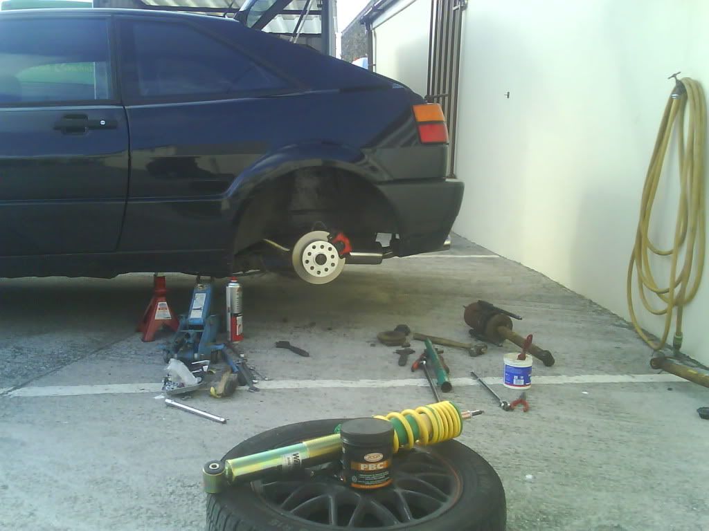

one of my shock dampers was buggered and the springs looked like they were about to snapp
so i thought AH what the hell! new shocks top mounts and bearings!
did the rears after work in the evening,
gota love seized bolts... NART!!

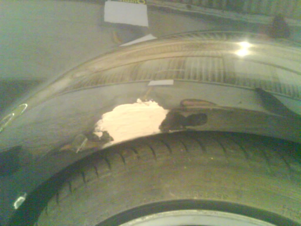

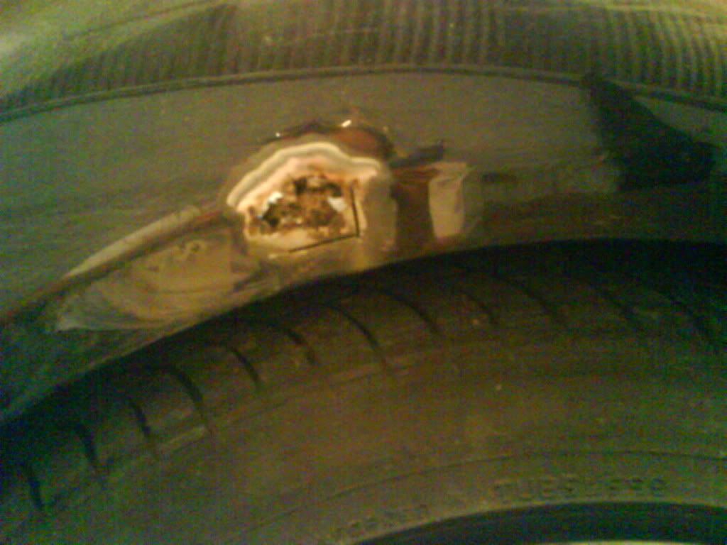

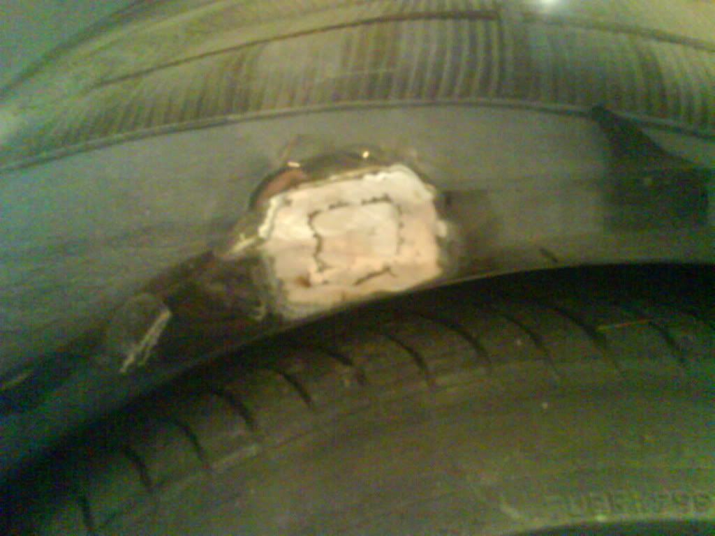

got abit of rust bubbling on the arch you can just see, thats one of the body issuses to sort out.

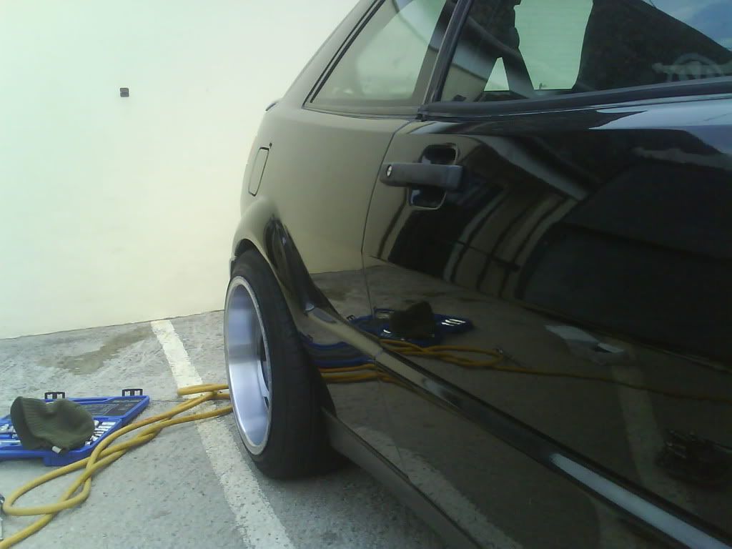

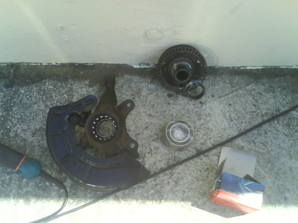

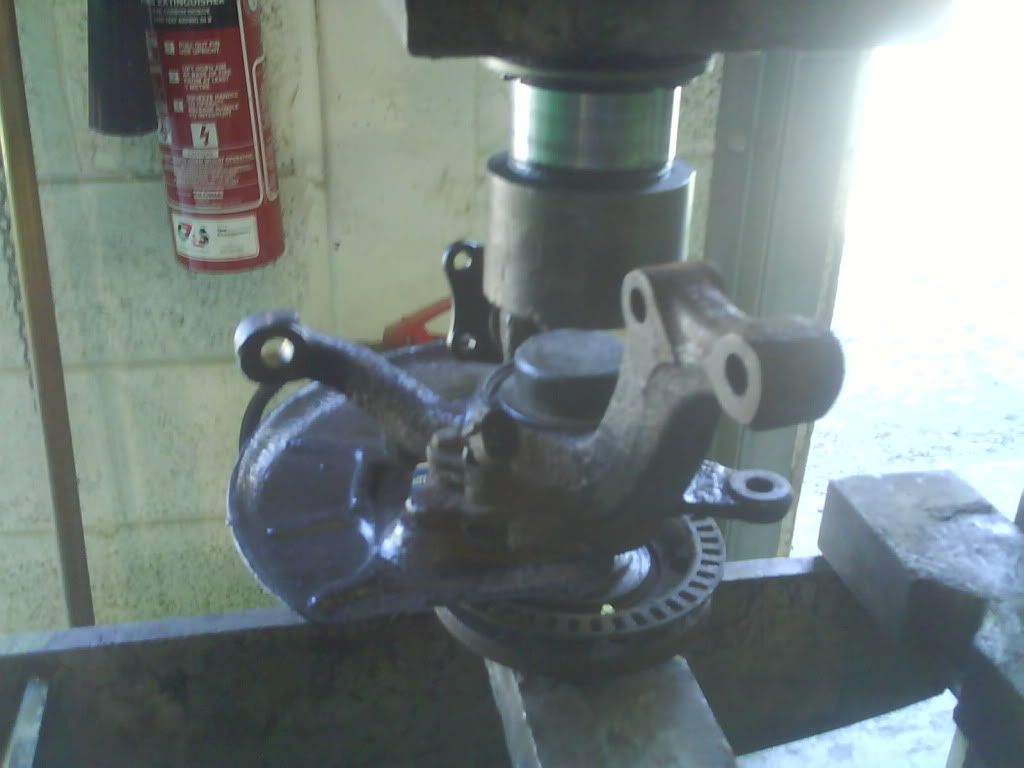

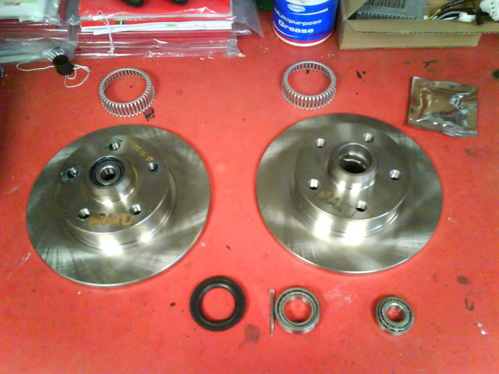

i didnt take any pics of the front shock install but i did take pics of the wheel bearings
which i did the same time,
the hammer and socket method failed big time! think i was abit Naive here thinking i could do it with a hammer
and suitable size sockets,just pressing the hub back in,
if i had the time i would of had them blasted and painted up, but my car has to be driveable at the end of the day.

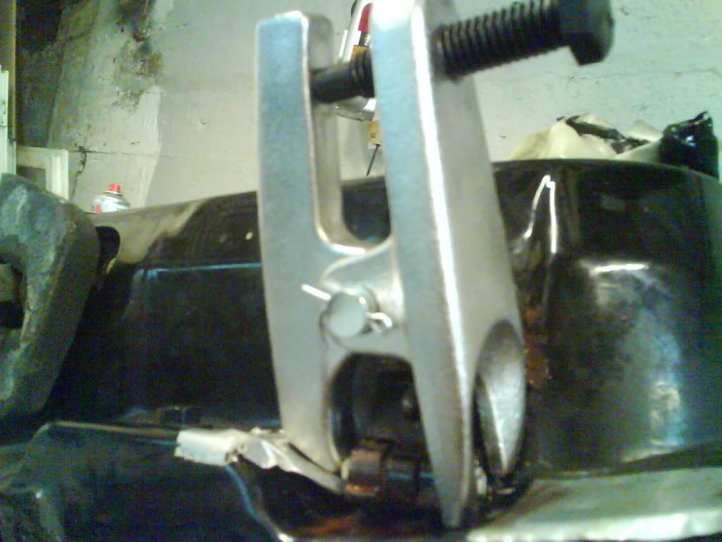

just got to replace a ball joint i renewed as the rubbers split! buy cheap buy twice!
then its going in for wheel alignment,and hopefully wont have to do anything to the front again! :)

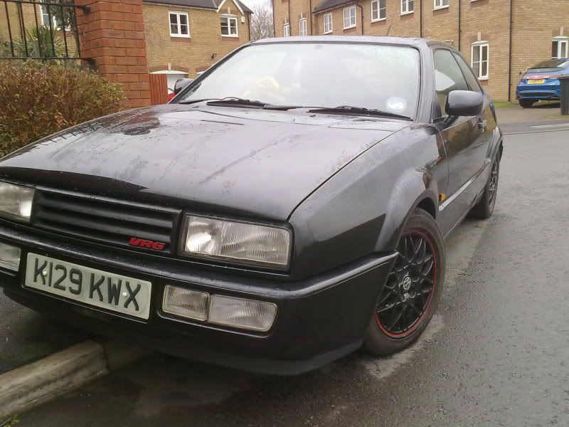

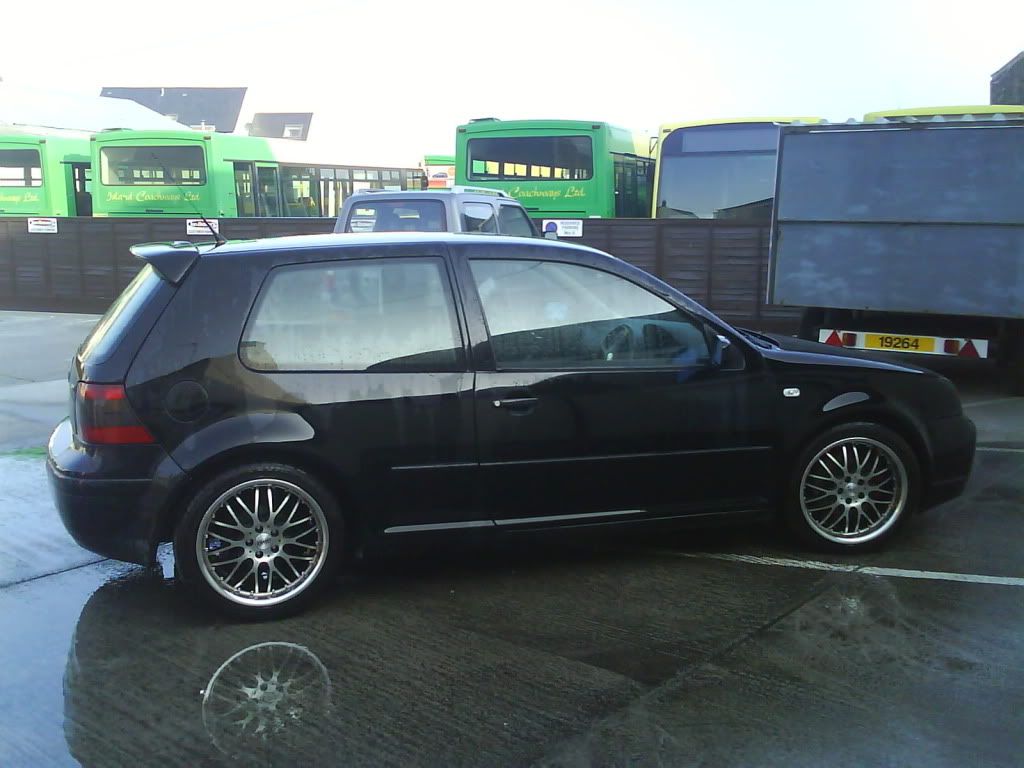

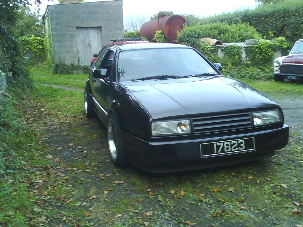

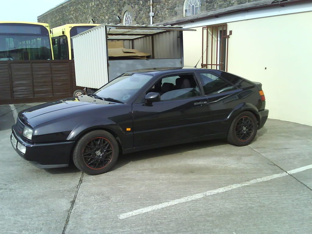

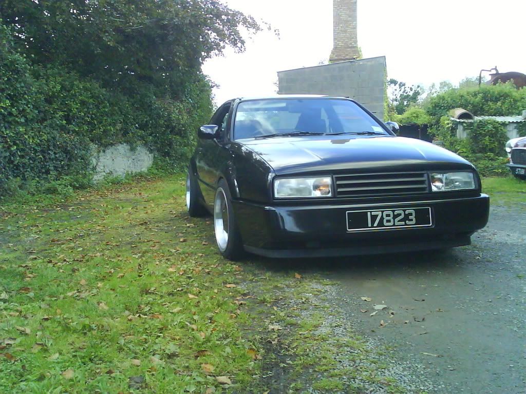

heres a pic of my old golf, far to reliable,started first time everytime, rust free! had to go! :)
this is what our works carpark is like on a good day! :)
my m8s mk2 golf,he also has 2 mk1 caddys and a mk1 gti campaign and my boss's camper on the right.

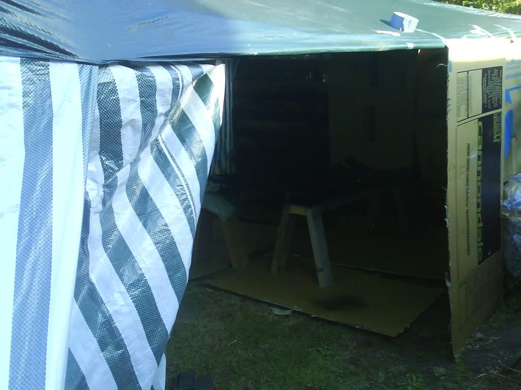

heres the spray{DeatH} booth from hell.
heres the underside before,
underside just blown over with the basecoat,
didnt take anymore spray pics in the death booth. i got orange peel prety bad on the lacqour, think it was down to my gun?

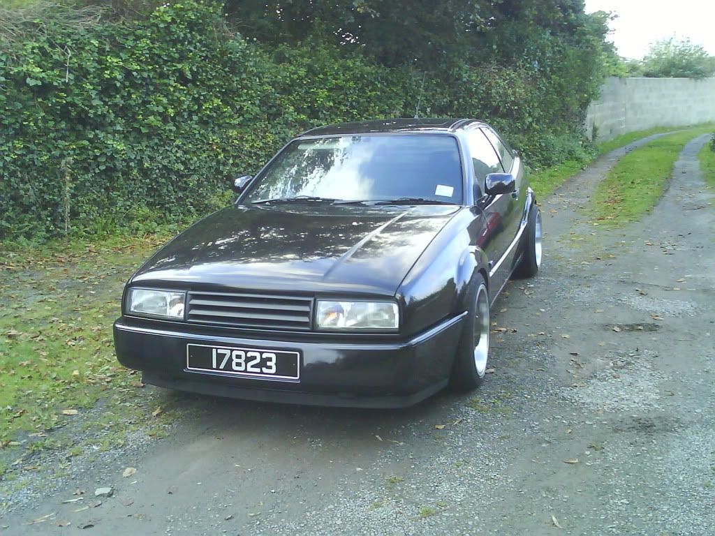

heres the finished peice,im realy pleased with how its turned out,considering it was done in my garden gazebo whilst constantly fighting dust and the wind/rain :(
deffinatly didnt save myself money by doing it myself, but i now have a compressor
and iv learnt abit about spray paintin so its all good! :) think it looks better without the vr6 badge?

very very good job on the spraying, and trust me give those weitec TX's about a 1000 miles and they will feel superb, had them on my old corrado and they feel softer but hold the road better than my current KW V1's
thanks bud,i brought the hicon gt's not tx's though,them kw v1's have the airbag for ride hieght?, i was actualy realy surprised with the ride comfort thought they would be a little harsher then standard but there spot on,still need to get wheel alignment just cant find motivation to jack the front up to change the track rod end lol even though its a 5min job,

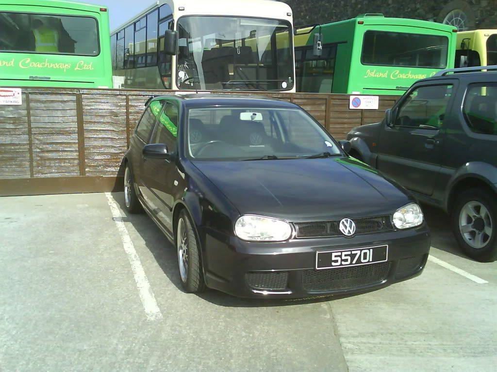

Nice rado mate, certainly doesnt look like a shed. Loving the shiny shiny bits too! :D
You've done a good job on the bonnet too. God knows who thought of putting an engine scoop on it!

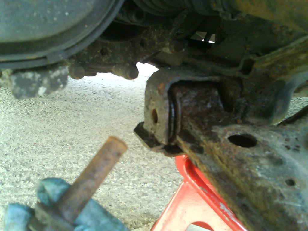

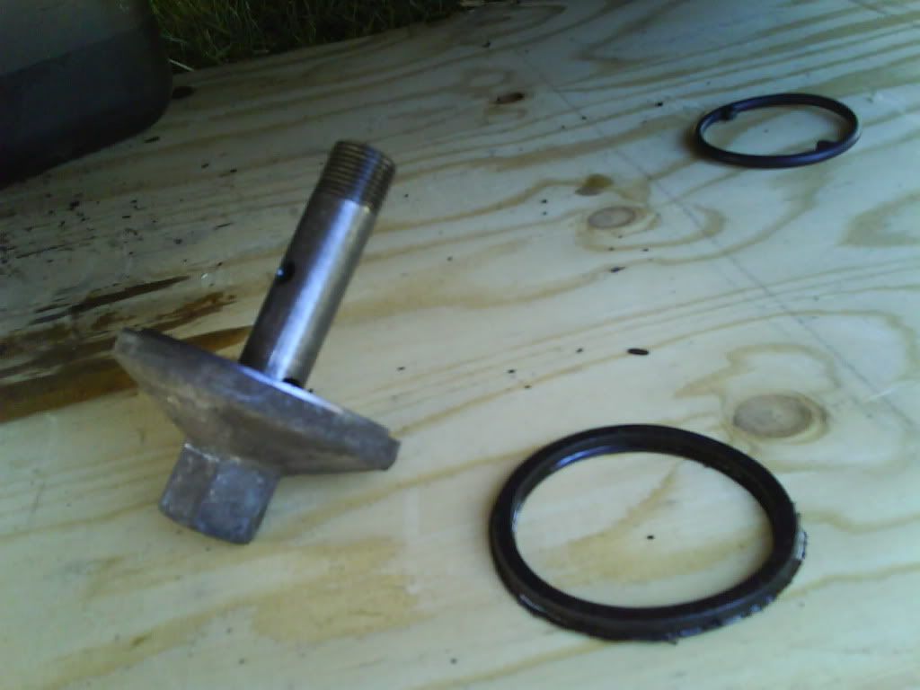

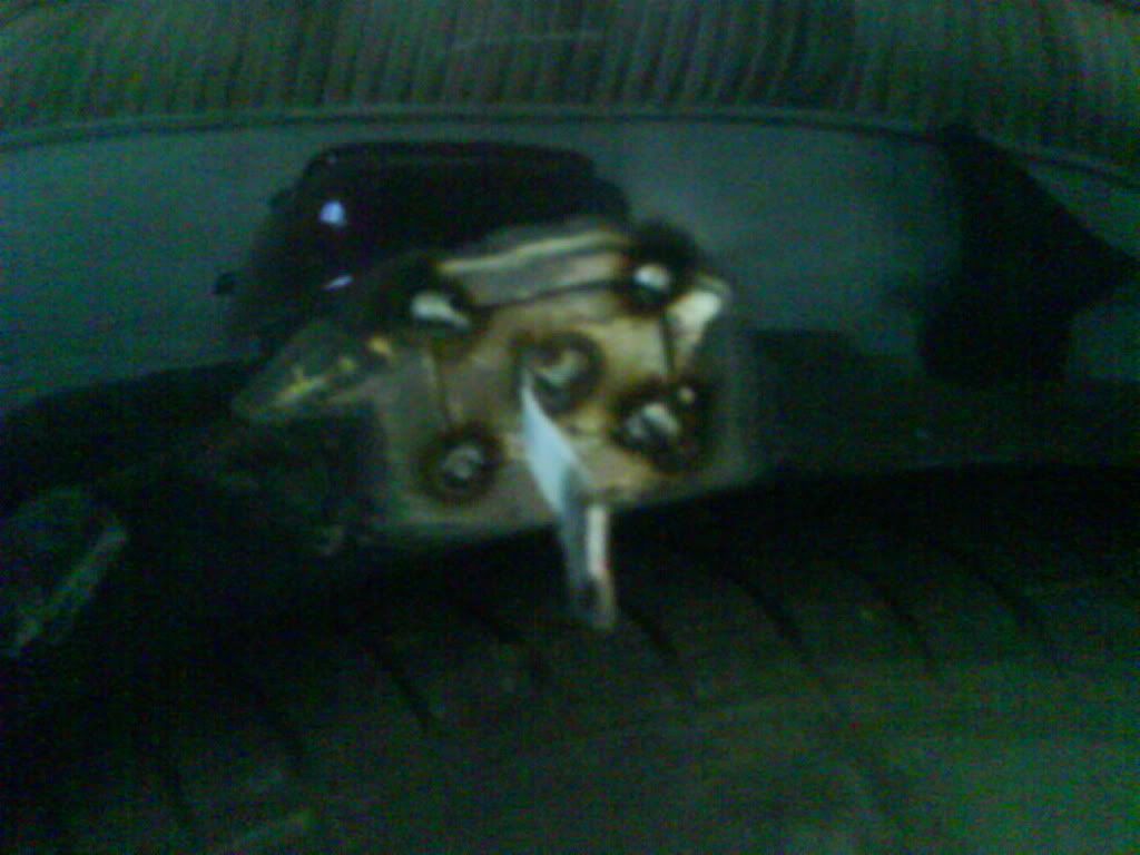

1:- drivers door hinge pin! , door pin has play and the door drags slightly on the sill, i also have a dent that has split the paint so its probably best i get the dent pulled and remove the door, press out or punch out the pin and sand out the split , prep then respray the door whilst its off.

3:-rust bubbling in either corner of windscreen, i realy dont know what to do here,

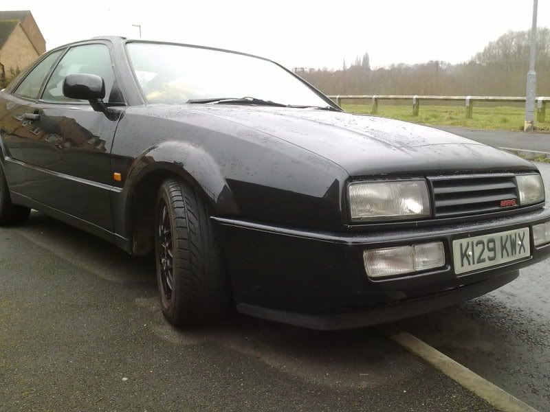

just stumbled upon a mk3 golf vr6 for £200 with 63k! advertised localy with a possible clutch problem. thought wow for £200 that might come in handy for spares, turned up had a good butchers and i spotted the driveshaft bolts had all come loose and as a result bent and sheered the bolts! also the fuel lines were perished and spraying petrol everywhere! he must of been useing it like that?!got my friend to tow me back to my works carpark and spent the evening replaceing the bent/snapped bolts,luckily i had a spare set of bolts which was for the corrado that i never used! Happy days :)
heres the culprit! when i spkoe to him on the phone he said he thinks the gearbox mount might of snapped? as he heard a loud noise, well this explains it!
its funny how things work out, i ordered these drivshaft bolts for my corrado a few months ago and kinda felt guilty that i didnt put them in but now i know why! :)

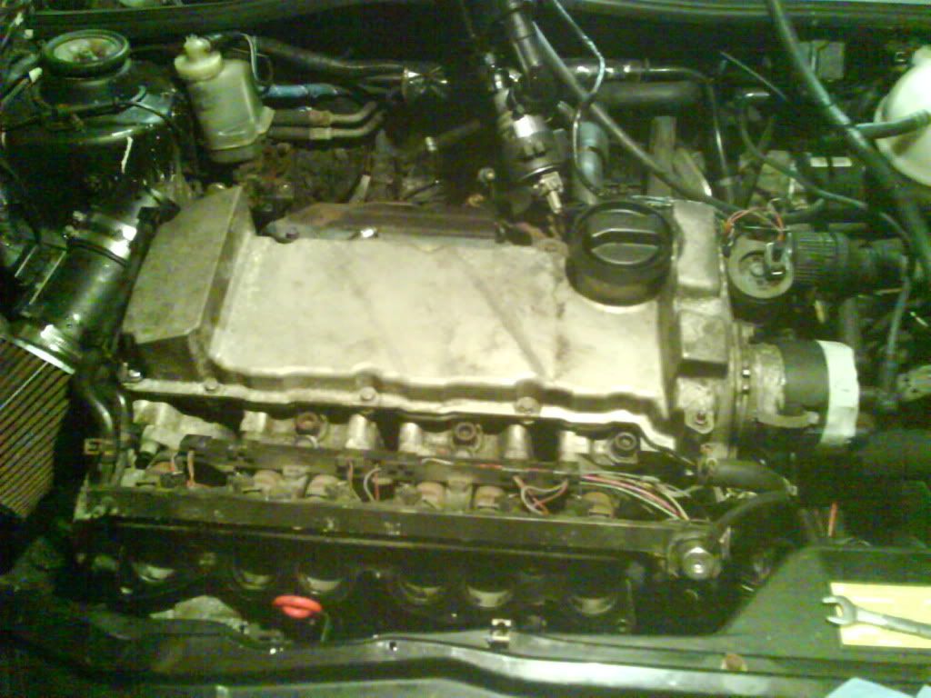

the vr6! apparently it had the head skimmed and the gasket replaced 2years ago, the coolant looks fresh as daisys!
all this motor needs is,oil change,oil cooler seals,rear disc pads,2 new tyres, engine bay fuel hoses{which i did today} and a blady good clean inside and out!.might just sort the problems out and put it out for £1000 as i dont need another car but i could hardly turn down a vr6 for £200!

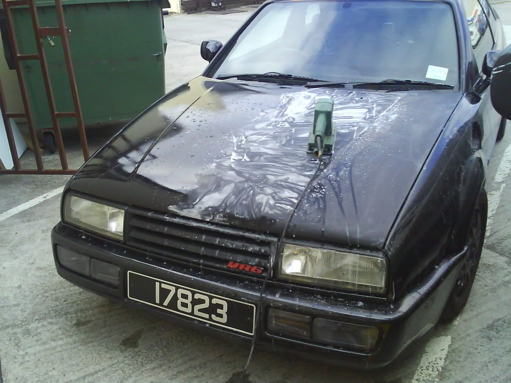

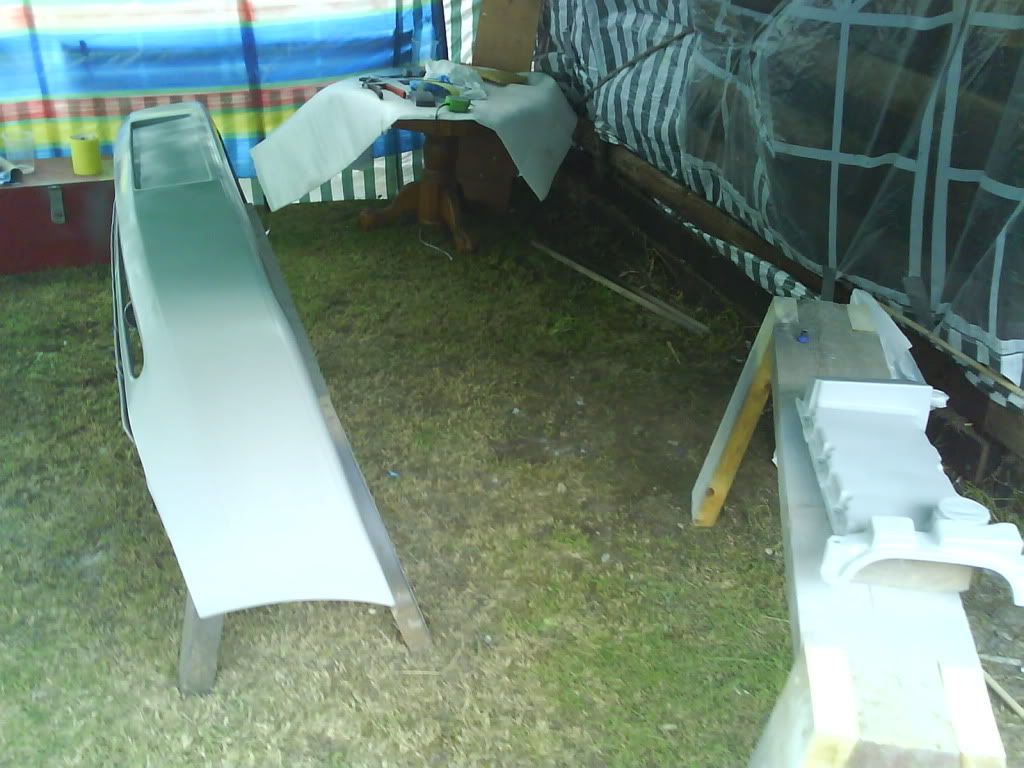

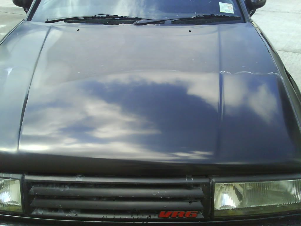

ah time to bust out the Death Booth from hell once again, i realy fancied the look of the smoothed bumper, except im keeping the number plate recess, sourced a bumper from ebay which to my surprise came with a 90mm splitter! shame i cant use it because of where i live/park.the bumper took me hours to prep as it was in prety poor condition,had to use a hairdryer to soften the plastic up so i could reshape it as the inside corner had been pressed in,anyway heres some pics so far :)

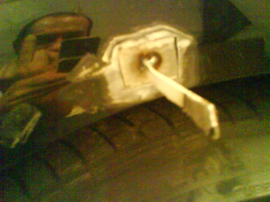

had to sand prety much all the lacquer off as you can see in the pic it was peeling badly,

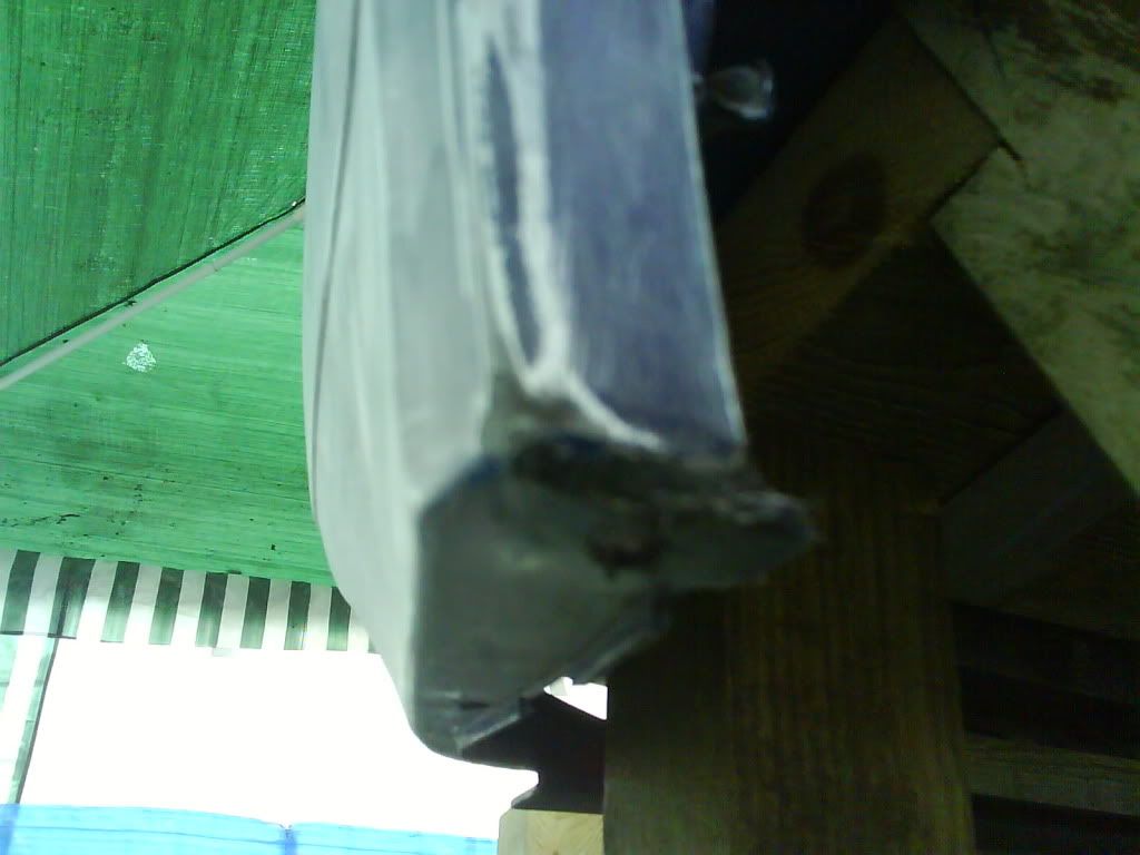

i had some plastic which i cut to size and useing a soldering iron and the offcuts as welding rods
i melted them together,prety sure you cant use just any plastic but the stuff i used worked an absolute treat!
btw the area to be melted is clean and paint free!
roughed it up with a dremel to allow better adhesion,

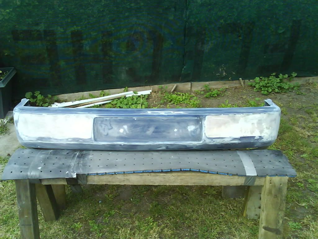

here it is all smoothed off, i used u-pol SmC which is plastic filler with carbon fibre thrown in, i then used a regular good
quality body filler for the top layer so it was prety smooth,and used a guide coat of black spray to get a good flat level area whilst sanding,
also melted this bottom corner back together is it was flapping all over the place,

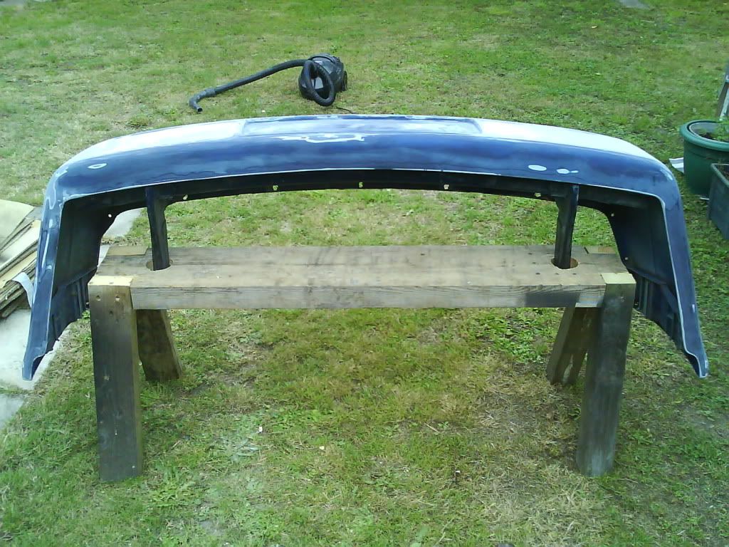

my improvised bumper jigg, my carpentry skills know no limits lol

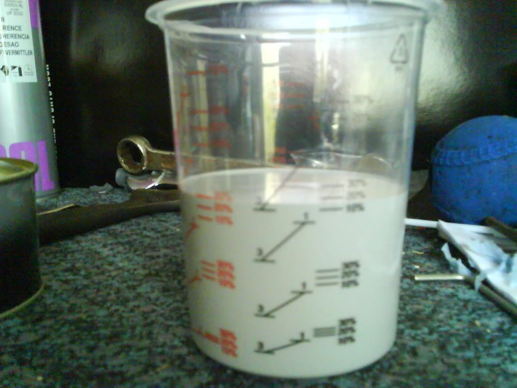

2k high build primer, this stuff is thick! mixing ratio 3:1 + a dash of thinners.

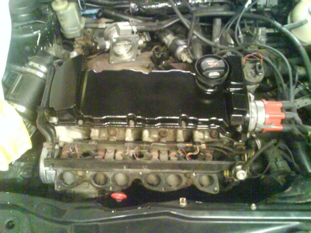

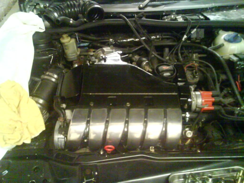

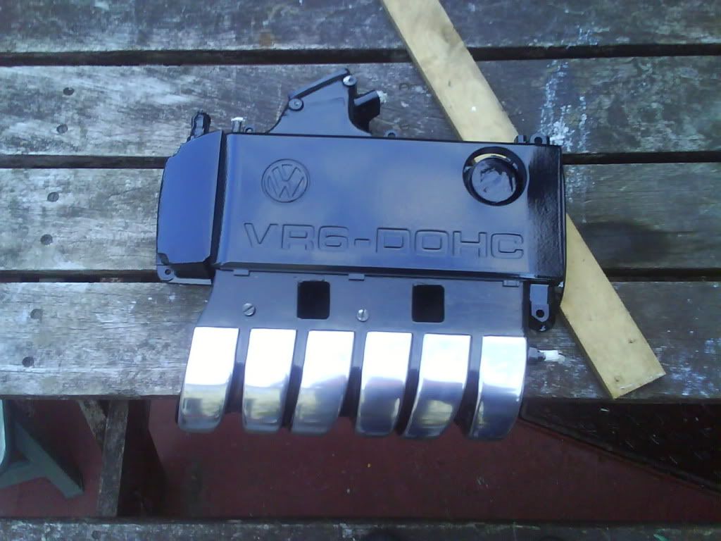

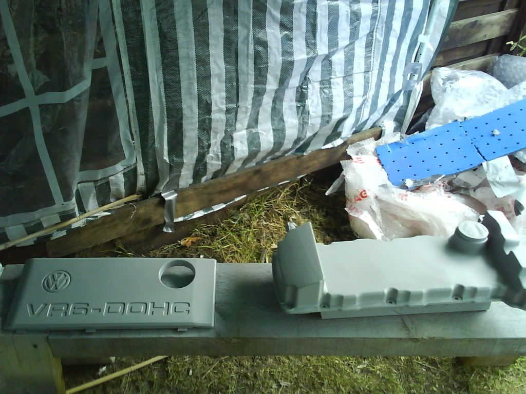

also primed my cam cover and engine cover ready for the basecoat LC9Z :)
so its all primed, just need a good day so i can sand a few imperfections out and maybe go over it again
and then give it some colour!!
going to try and fit some led indicators in the headlights theres a forum member that has done this,i was considering maybe looseing the highbeam and replace that with an indicator? here in guernsey most roads are litt up and to be fair you cant use highbeam over here for more then a 40 secs- 1minute as you allways come head on with another car, so the highbeams an option.

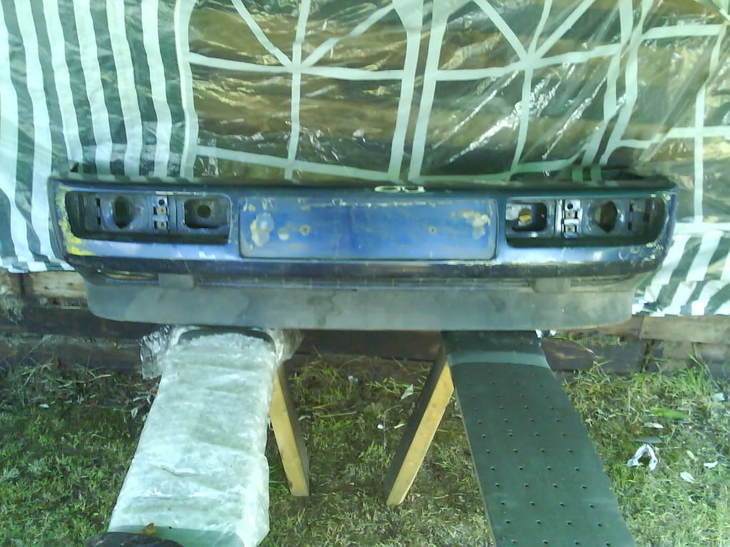

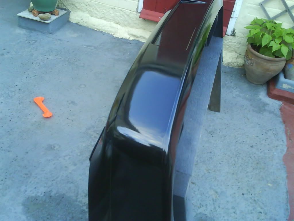

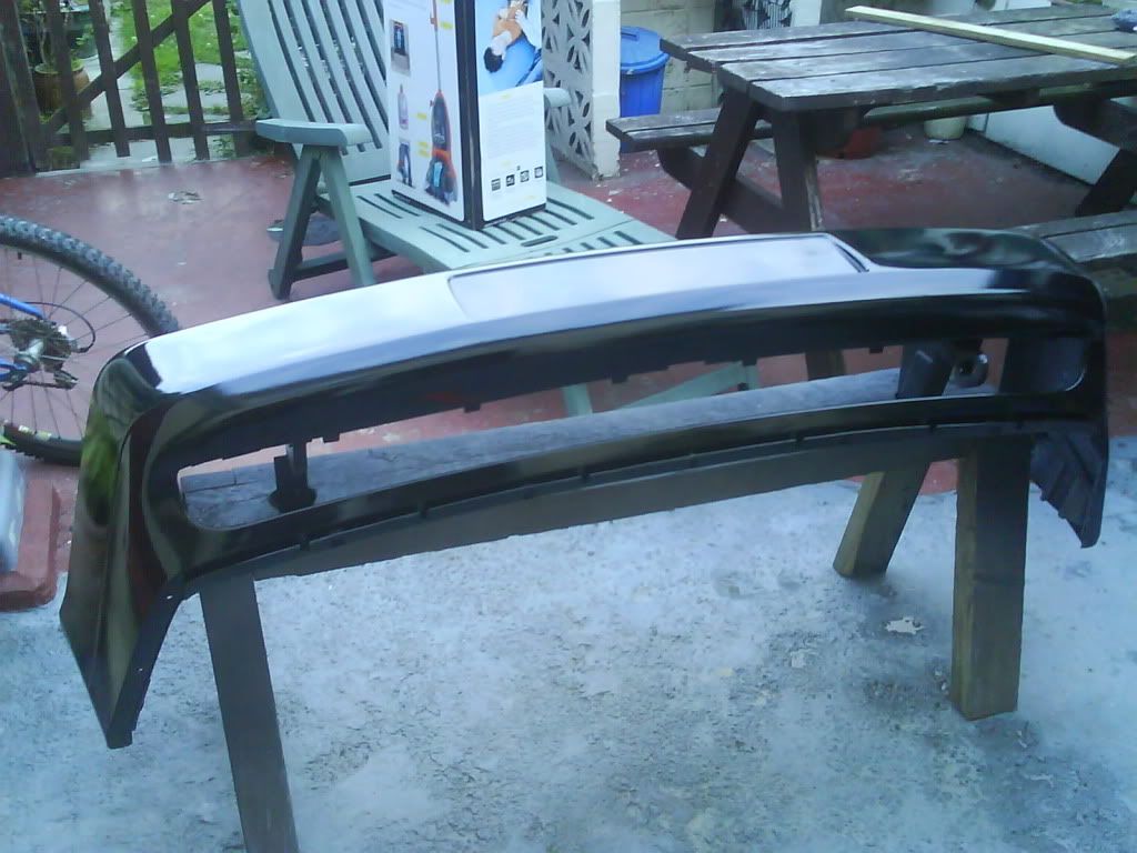

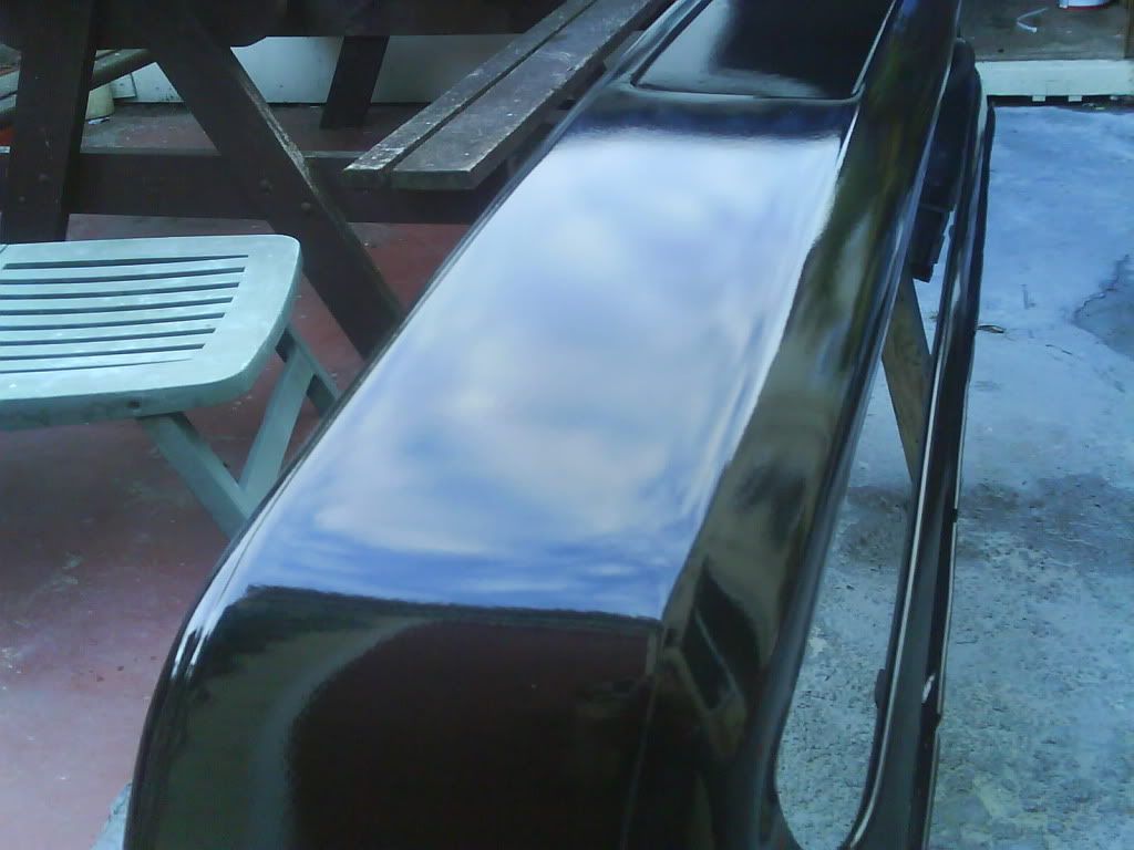

finnaly finished my bumper :) took a few weeks as i made a few skool boy errors and had to re do it a few times :(
realy pleased with how its turned out,only have slight orange peel in places which im not wetsanding any of it!!and you cannot see any filler dents or ridges etc so im well chuffed about that,

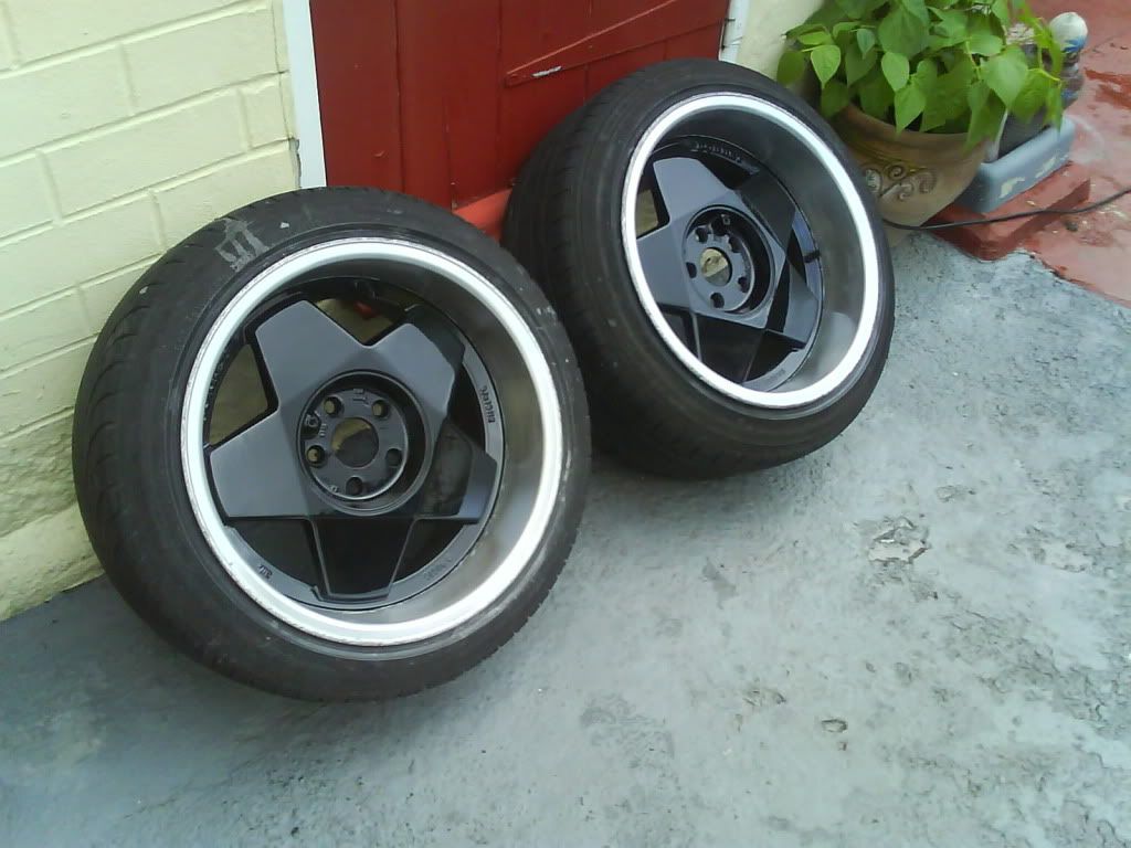

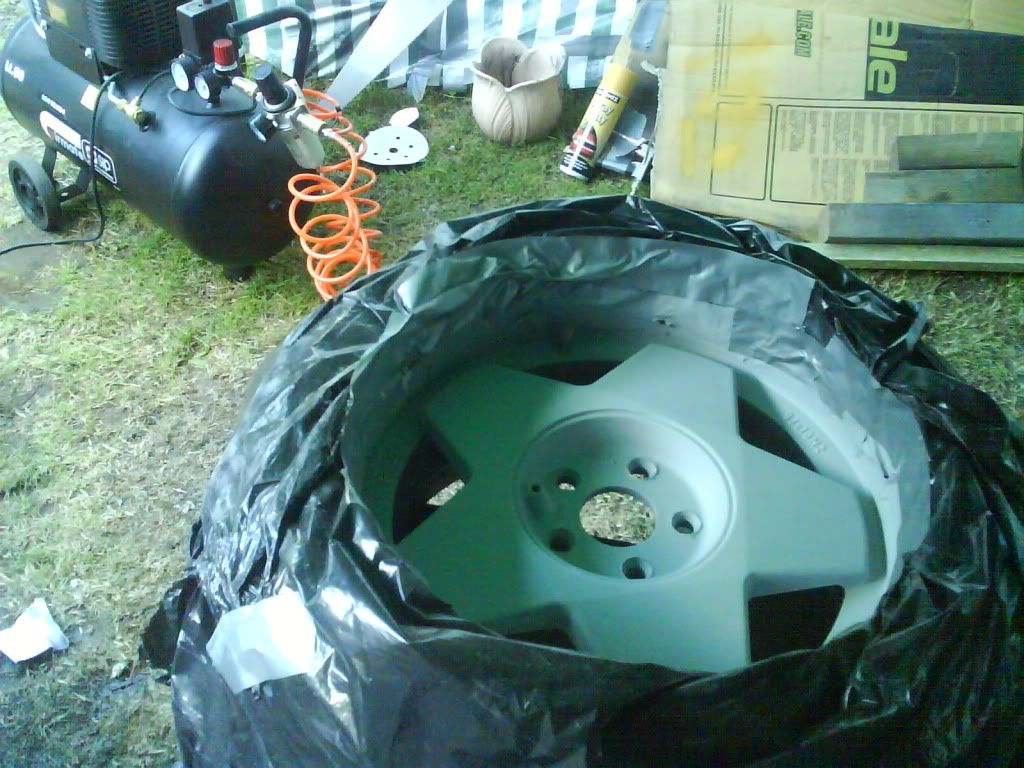

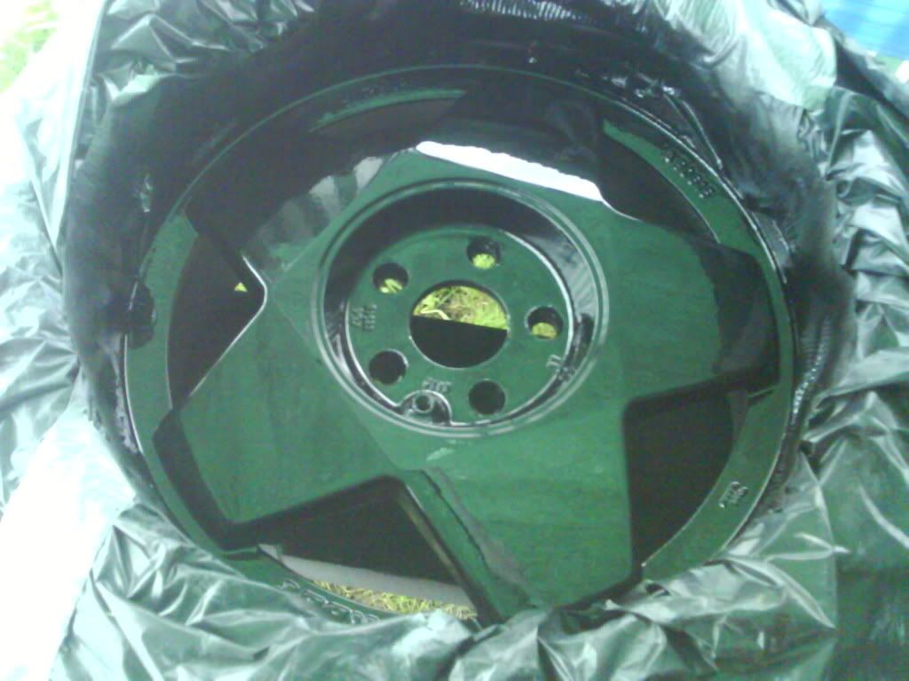

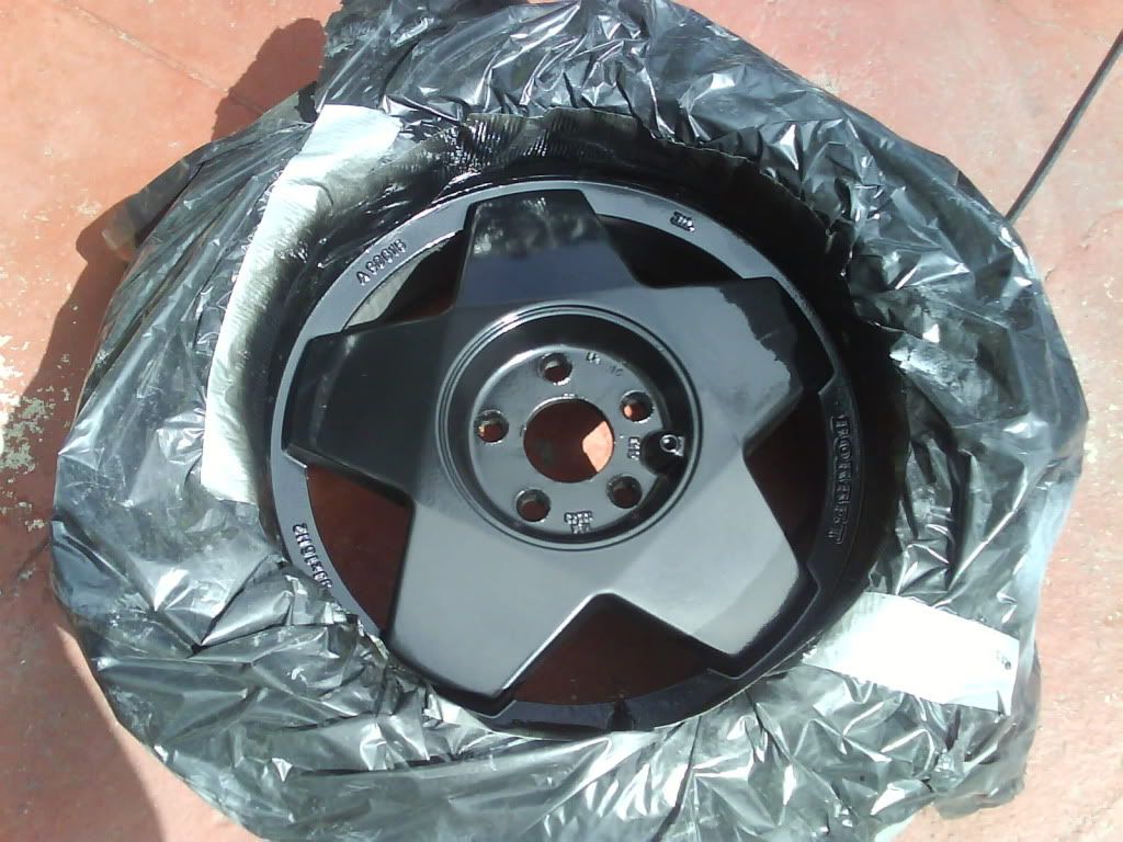

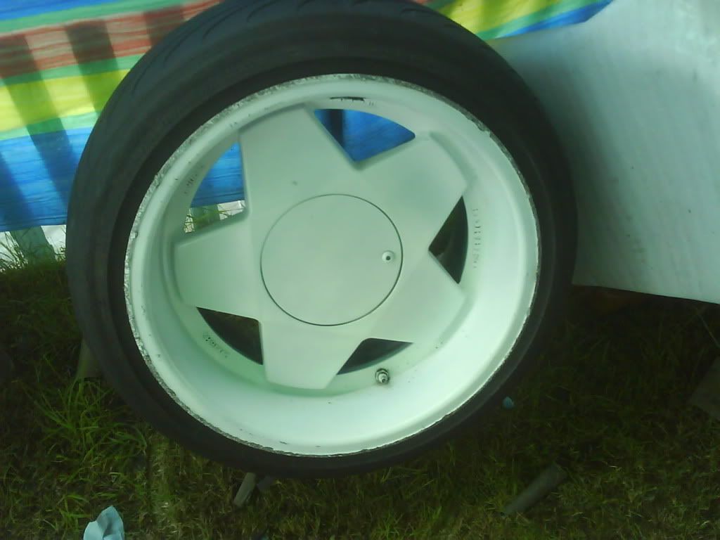

also got my hands on some borbet A's 9x16" which were spray canned matt white so i worked my magic with the Death Booth -..-
preped and primed :)
bascoat no clearcoat.
clearcoat :)
the wheels have been cleaned up since the pic above,There a perfect fit on the rear but up front they stick out way to much! as you also need to run a spacer for the wheel to clear the caliper,
couldnt source a pair of 5x100 7.5x16 30et A's for love nor money!! but i got exactly what i needed on german ebay!! for 200 euros new old stock ,
there with the machinists down the road gettin the pcd re drilled, cant wait to spray them up and get tyres fitted!!

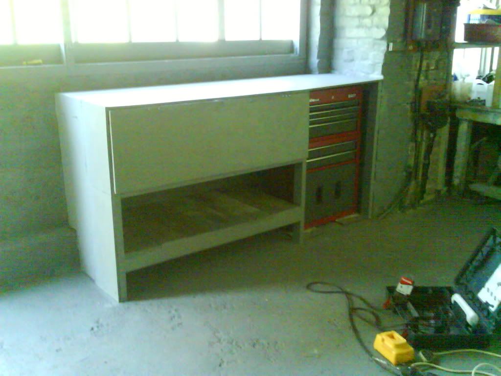

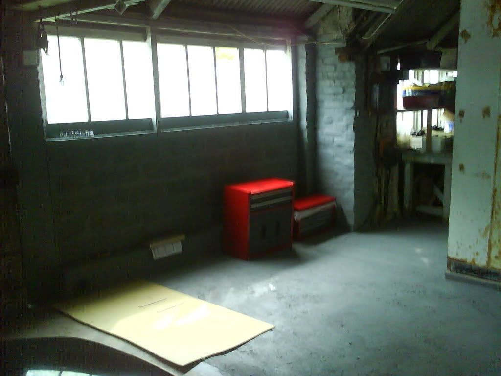

Also got my self an old shed which hasnt been used properly in 20 years! just been clearing it out and changeing the layout this past few weeks,
its gona be so nice being able to work on my car rain or shine with no wind!! or any pressure to finish it same day!!.
there was a massive old bench for packing flowers with tons of cobb webbs and more spiders then you can shake a stick at!
still need to finish painting the floor, the floors solid concrete roughly 4" thick so its ideal for cars,

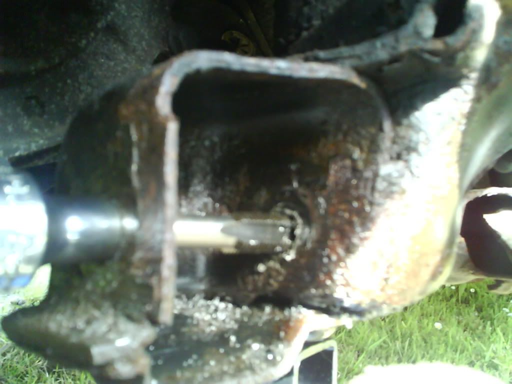

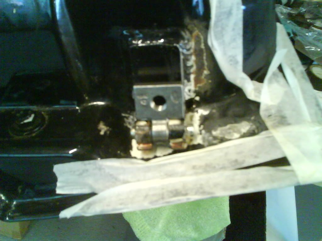

tackled my door pin last week! so happy with that, no more sagging door! door is realy smooth and shuts perfect!
also painted the damaged paint area afterwards.

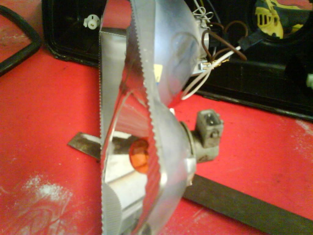

due to smoothing the front bumper i had to relocate the indicators, i decided to use the highbeam
bulb area in the head lamp for it, now here in guernsey in the channel islands you cannot drive with highbeam on for more then 30seconds unless your driveing around at 2am as you will allways dazzle other road users, our roads are very small!, anyway turns out that i still have a highbeam as it uses two bulbs so i can still flash but obviously wont be as bright as it was on highbeam,,
your thoughts on this? i love it :)

just need to smooth it and get ready for paint, windscreens comming out soon for the bubbles but they dont look
to bad, should just smooth out, {lol smooth out my axx! there gona be huge holes! gutted}

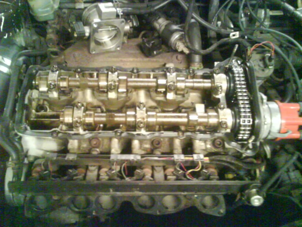

Photo 2 - charming! :D
HAHA you spotted it then,yea tbh guys i was very very close turning it away but i already paid for the ferry tickets and traveld from weymouth to guildford so i didnt realy want to come home empty handed, but all these things once sorted should bring the life back into it! and ive done prety much all the work myself apart from the exhaust fitting and a repair on a burnt wire by the hall sensor so its prety much labour free. iv loved every second driveing it! so it would be a shame to give up on it when its potentialy got years and years left in it, it will never be a show car but its my car! looking at my m8s mk1 caddy that he drives daily idd say this beast has another 20 years left before it gets to that stage lol... cheers.
