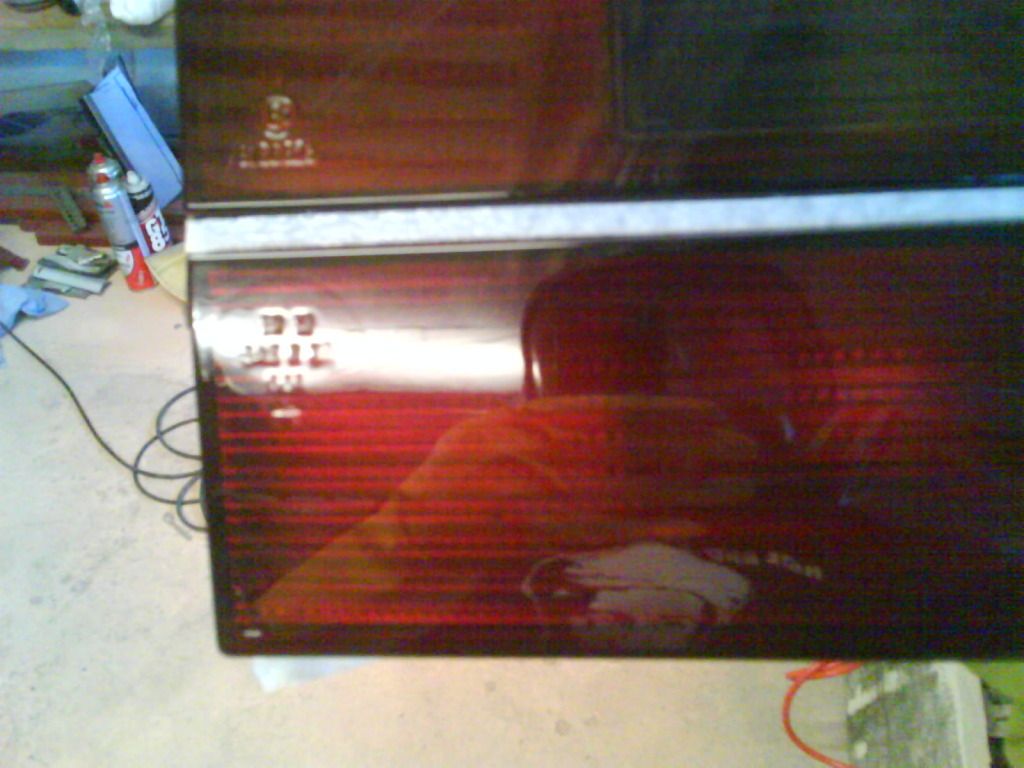

smoked rears for a friend, he'll be more then happy i recon :) and yes i am wearing marrigolds ;)

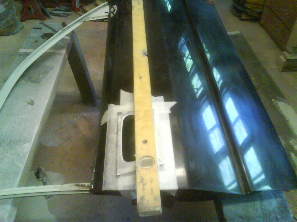

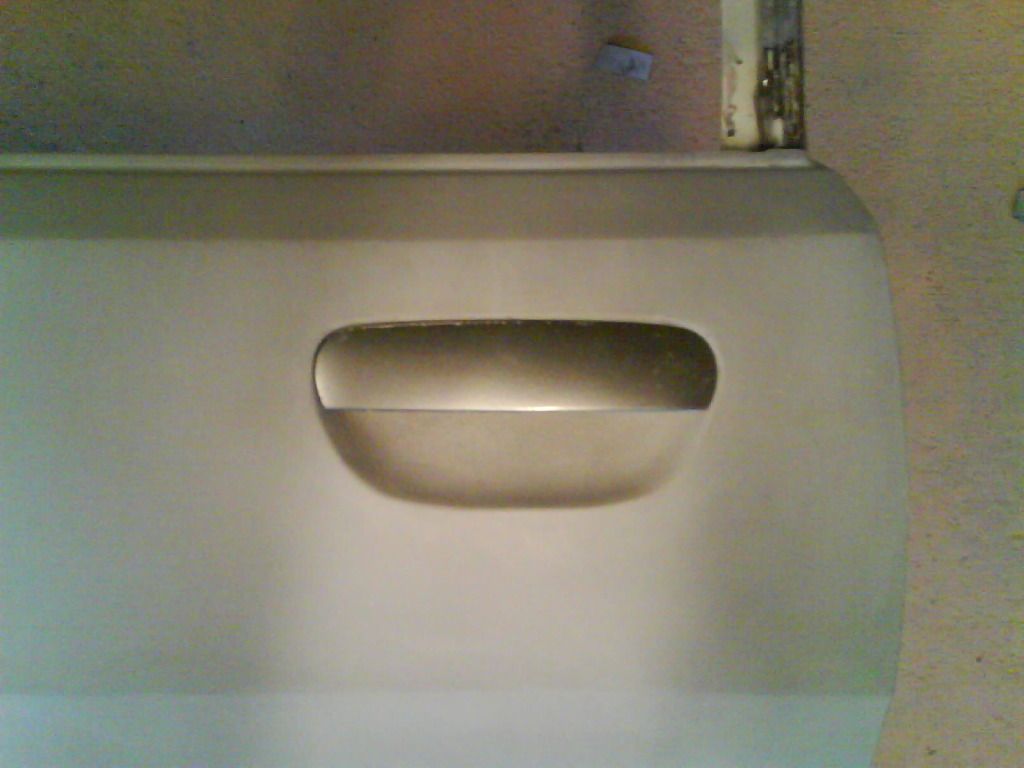

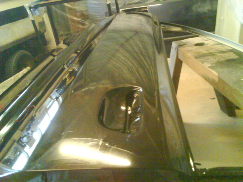

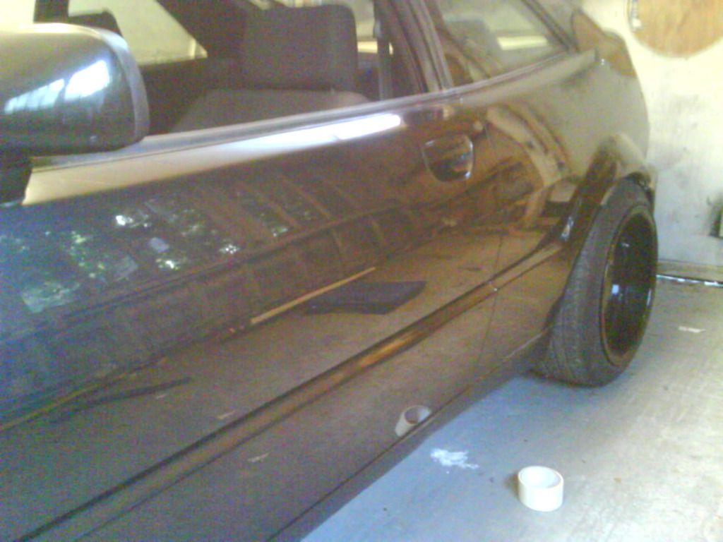

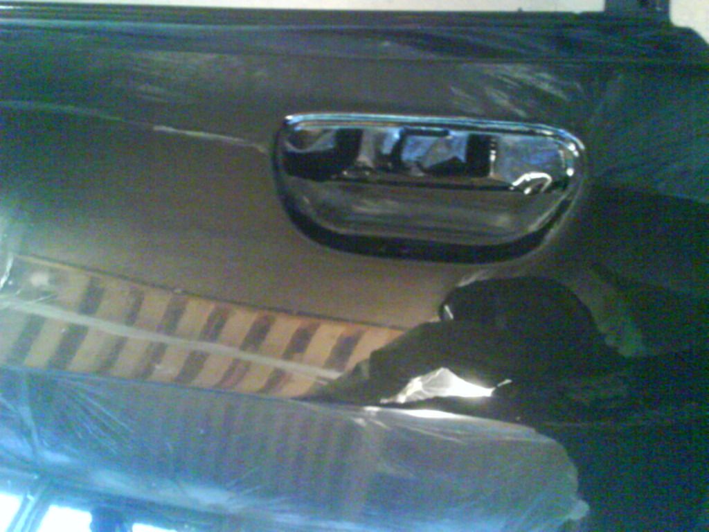

well had a lovely time playing bodyshop and finished my passenger door today, looks mint! realy realy happy with it,
cleaned up the green algee line on the window which is normaly covered by the seal also greased up the window rollers
so now my window is silky smooth :)

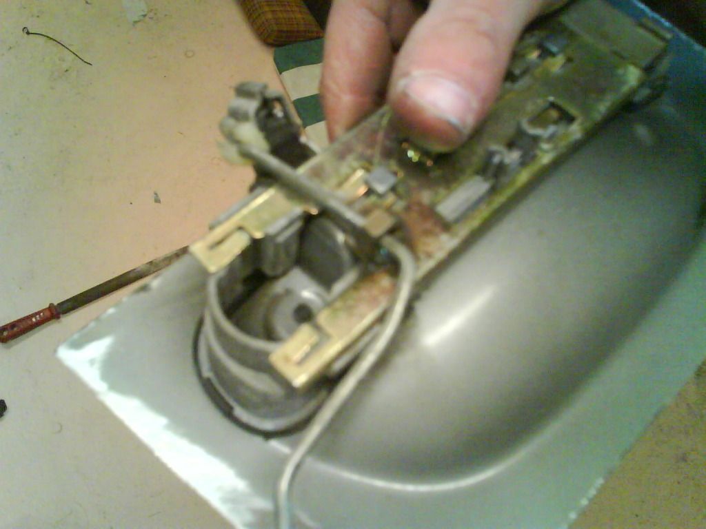

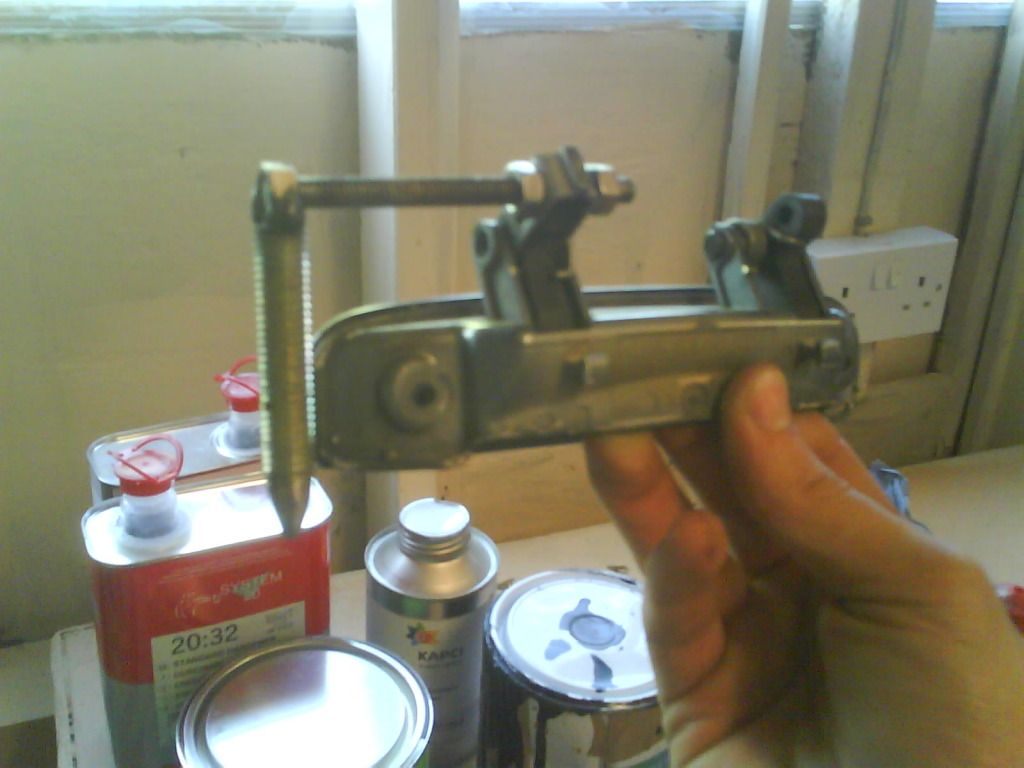

heres a shot of the linkage, basicly the nut thats welded on pivots on the threads when you open or close it, i tryed useing
wire bent to shape but it flexed to much and lost the travel required to open the latch,
this was the original which worked for a few pulls until it bedded in and couldnt open the latch anymore,

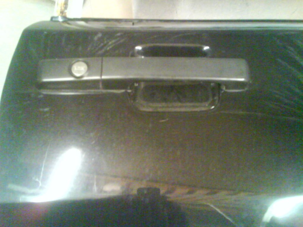

some pics that arent above and some tips for anyone wanting to do this themselves
old shoddy n dodgey!
cut out a sqaure thats big enough for the A6 moulding to sit in! from here you can
adjust your handle so its sqaure with the body lines,
getting it sqaure and in same position as passenger side { 75mm in and 35mm down from edge }then mark the outside!
cut on the inside lines for a nice tight fit!
now get the mechanism working ! as you can easily pop it in or out and make any mods,
far easier then when its all welded up, the space is very limited!

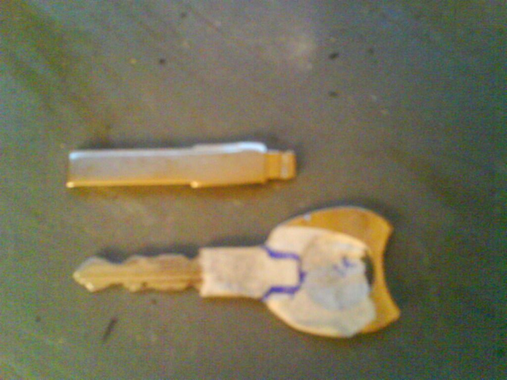

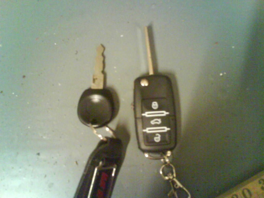

need to get the remote central locking kit wired up,
and its ready to rock!!!

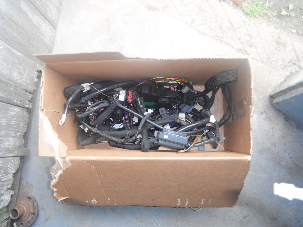

My wireing harness was finnaly posted out on weds and got here this morning! so stoked!
also sold my borbet A's to fund banded steels , which is what i wanted in the first place ,so hopefully the next time this car touch's tarmac its going to be exactly how i want it!,
posty dropped this off this morning :) , been a long time comming!

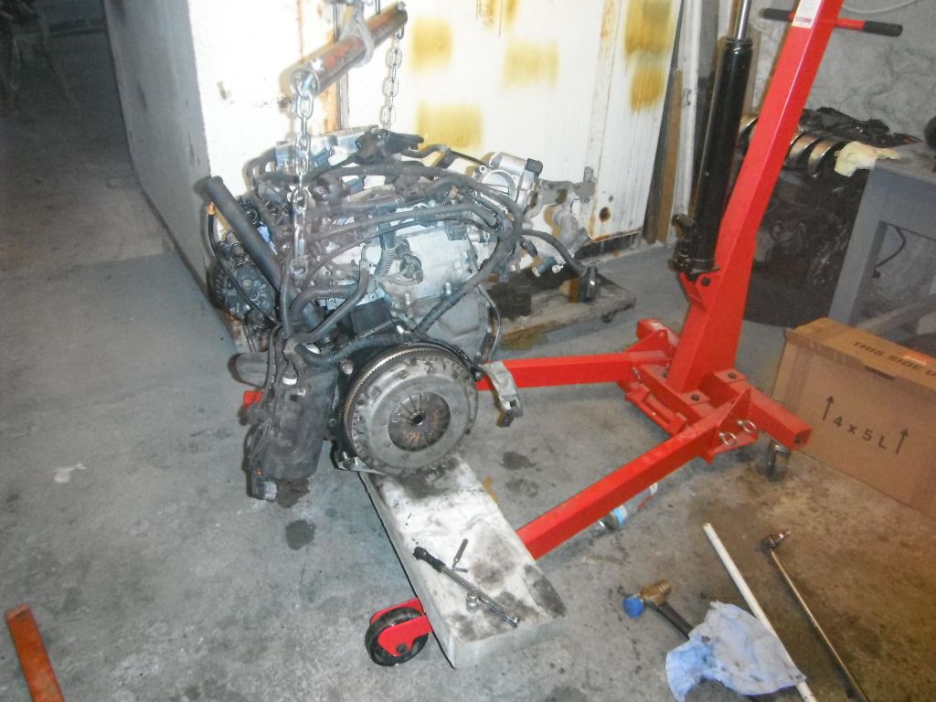

useing my old clutch, its a sachs clutch and still has quite abit of life left in it,
going into retirement ;)

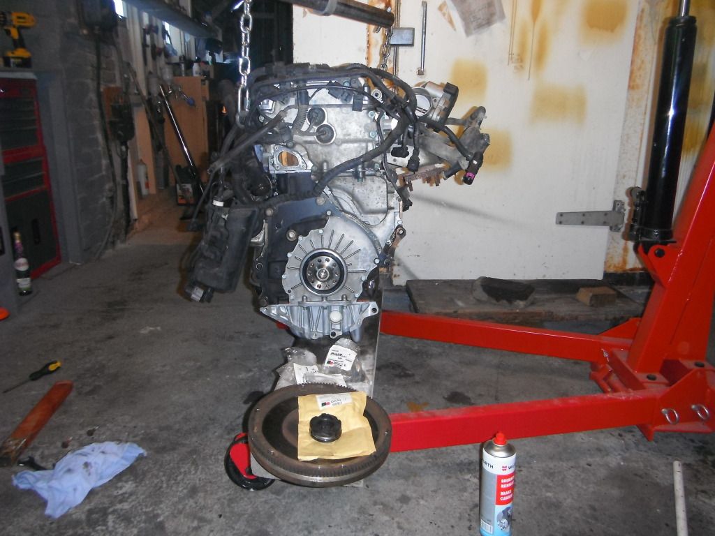

got new fly wheel and pressure plate bolts to go in along with a new clutch release bearing for the box,
made a clutch centering tool by wrapping electrical tape around the socket extension,

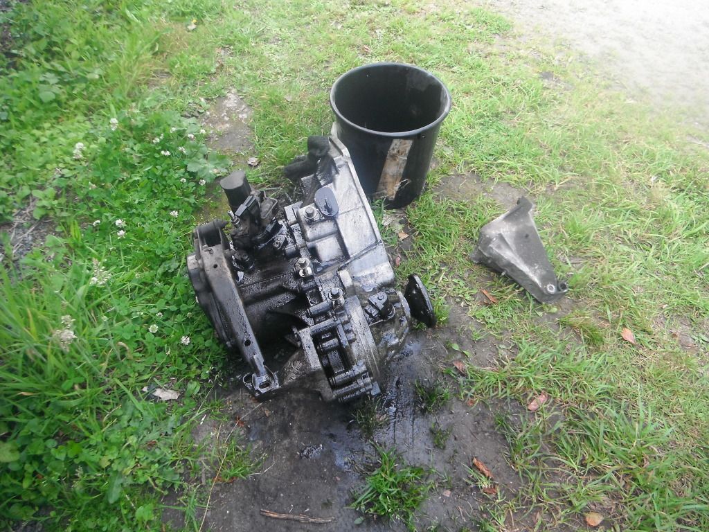

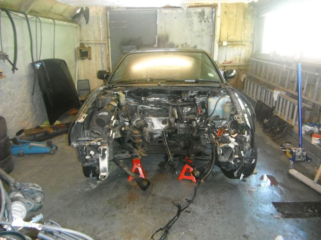

gearbox is filthy!! so going to clean that up tomo and get it fitted and test fit to see what the crack is with this down pipe, i thought idd be abit nervous as iv never done a conversion before but im not , im actually more concerned with how rusty the front cross member is! {the section with the pas pipe goes through}

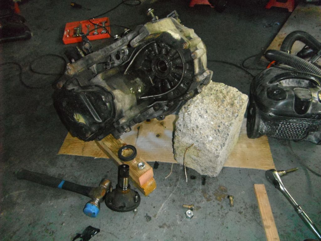

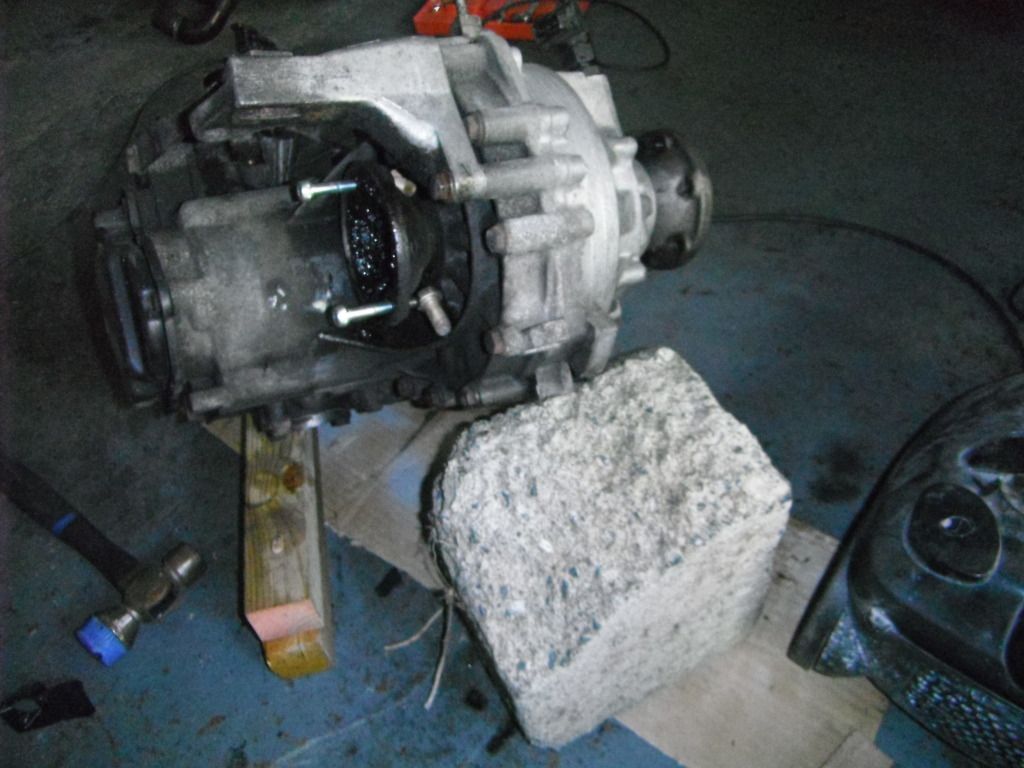

searching through a box of bits that iv slowly gathered over last year with the intention of fitting i came across a gearbox out put flange seal,
strange why there was only 1, so i fitted that to what i thought would be the hardest side,
pressed off fairly easy , although it wouldnt budge when i tryed to pry it off with a jack bar,
as it happens idd say this was the worst side any way ,

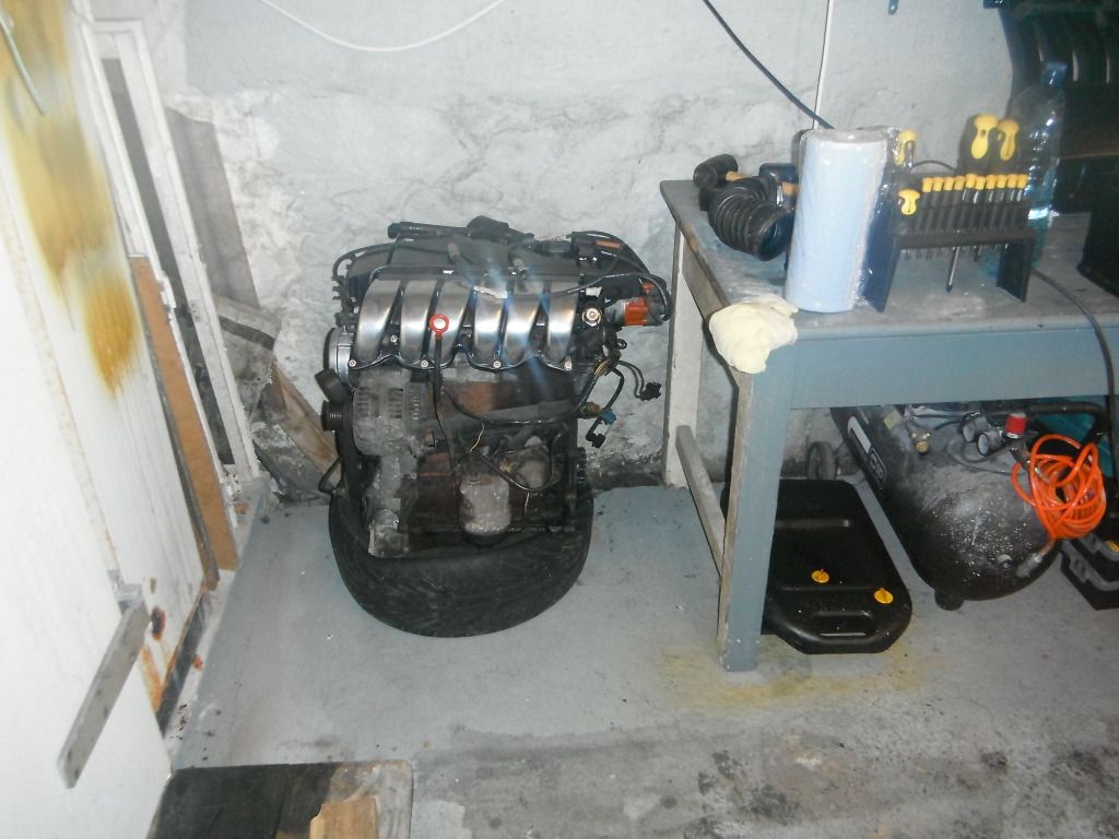

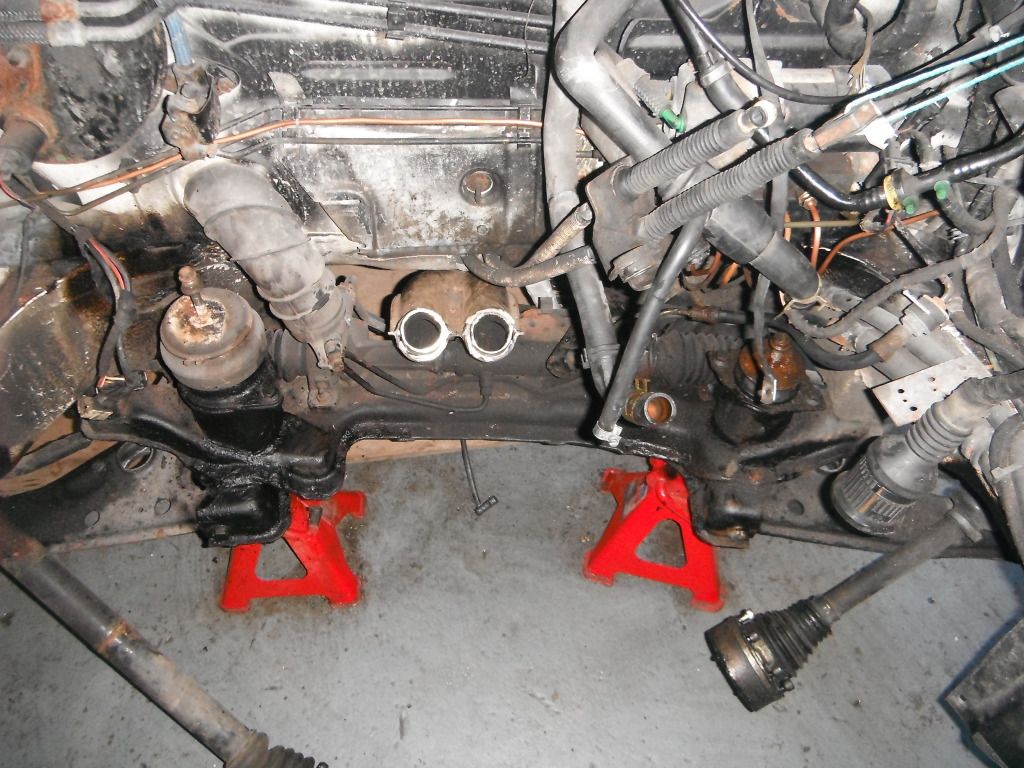

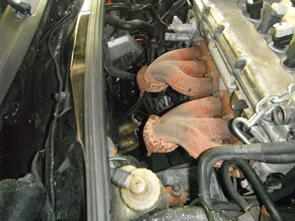

fitted the box & thermo houseing, removed the old mk4 header tank pipes & modified the front mount,
& fitted the rear mount, think tomo it should be sat in place for a look at the down pipe or i may fit new arb bushs!
had a quick sneak peek at the wireing loom, its all labled up nicley and all looks fairly straight forward, think matt @ OCD has done a good job with that!

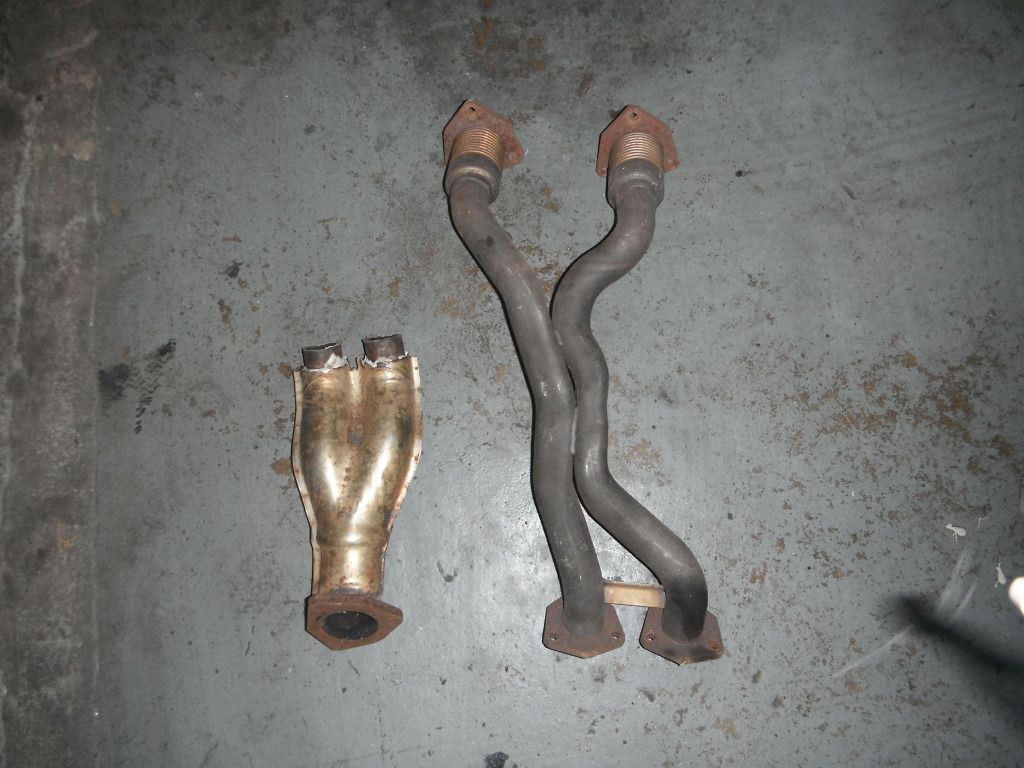

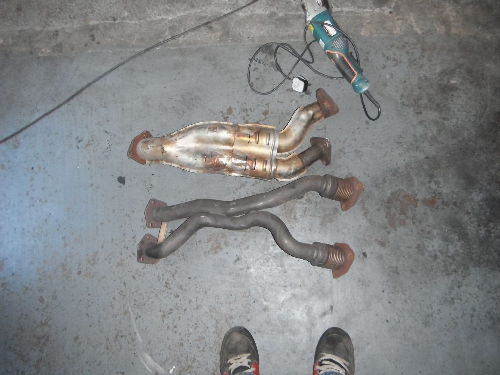

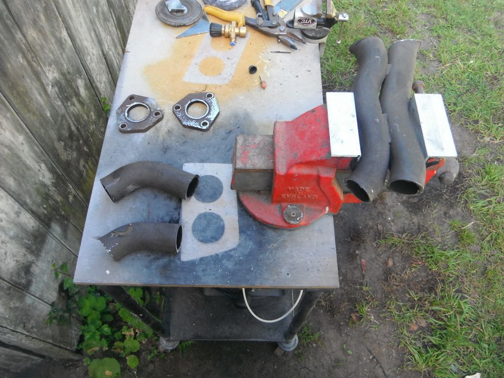

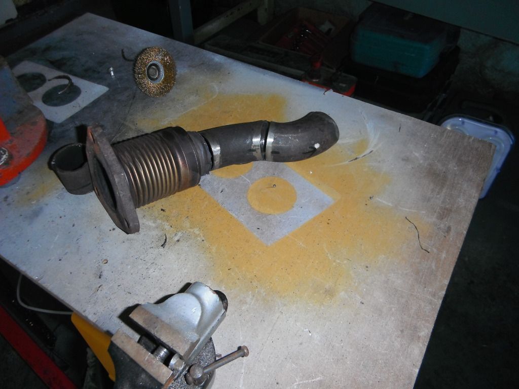

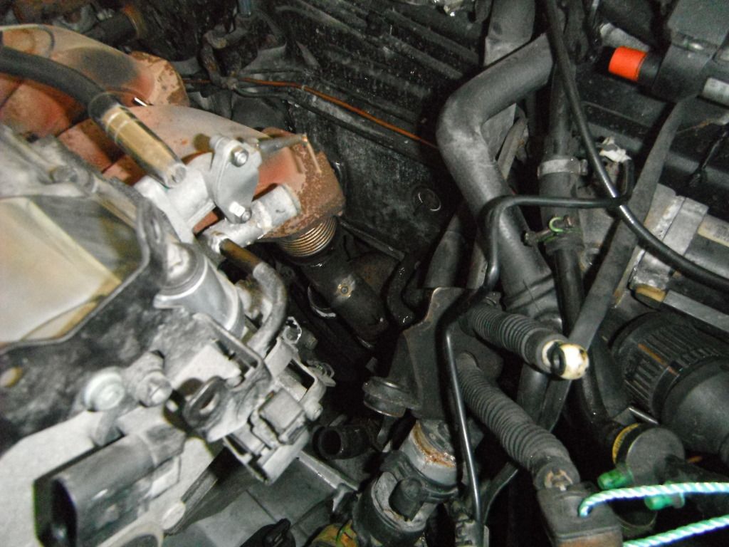

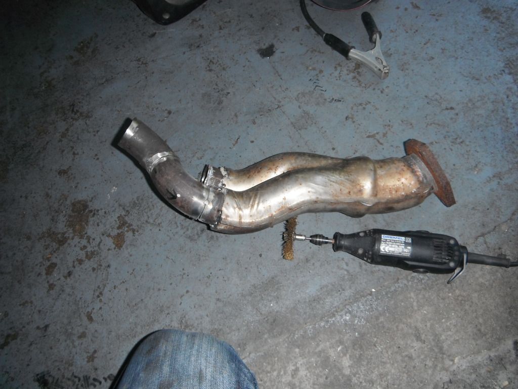

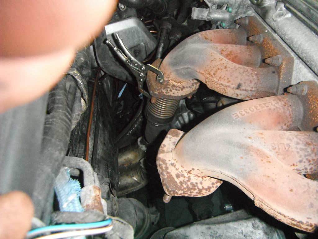

started on the down pipe this afternoon, damn its a ball ache!! probably wouldnt be as bad if i had a pipe bender and fresh tube to work with , all my bends/ tube are comming from both dp's cut up!
side by side

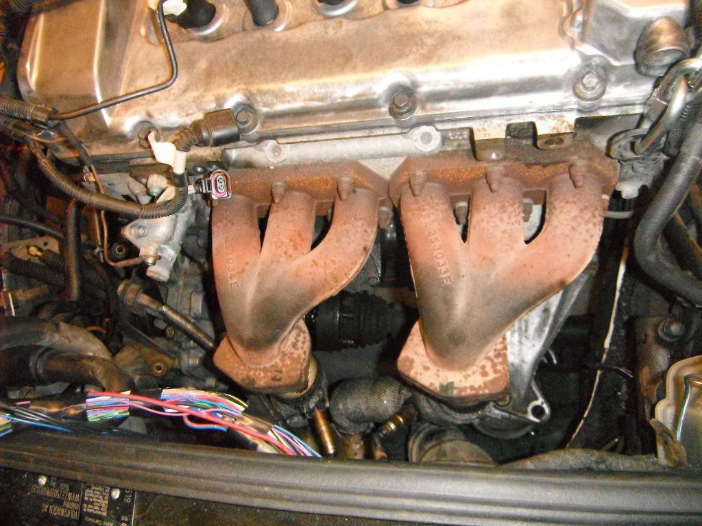

chopped the top half of the 12v dp
bolted it up and propped it up to exaclty where it needs to be.

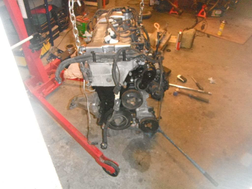

engine sat in place,
and heres what i need to fill in,
kind of figured out half of the right side,
thought this part was gona be easy but its gona take time! wouldnt be bad if there was loads of room but im just gona have to work through it no matter how long it takes,
well iv almost finished the down pipe, ran out of blady gas! damn that stuff doesnt last long!
just need to make a joiner peice and weld up a hole from where i cut out a lambda boss and then reposition them where i see fit,
then weld the flexy/flanges on , the main brain pita work is done so i dont have to work out which bends to use where etc etc
like i said all my bends and tube have come from both downpipes so iv had to make it all work ,
heres two 45's think i managed to get 5 in total,
took me awhile to figure it out but i got there
one leg prety much ready for welding, the flanges will be welded last as you wont be able to remove the DP easily , and its been in and out around 6 times,
Welded as much as i could, i ran out of gas so i had to stop , the big hole is from where i cut out a lambda boss, i will fit those at the end once everythings piped up just need to relocate them where i see fit, atleast this jobs almost done! Happy days :)

well finished my down pipe today, so happy with the out come, just waiting on the heat wrap to arrive so i can get it wrapped up,
i made sure that there was no bures or welding wire pokeing through any of the welded areas aswell,
welds dont look amazingly neat but iv got very good penetration.

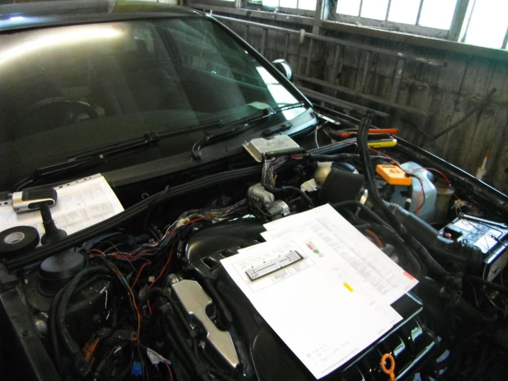

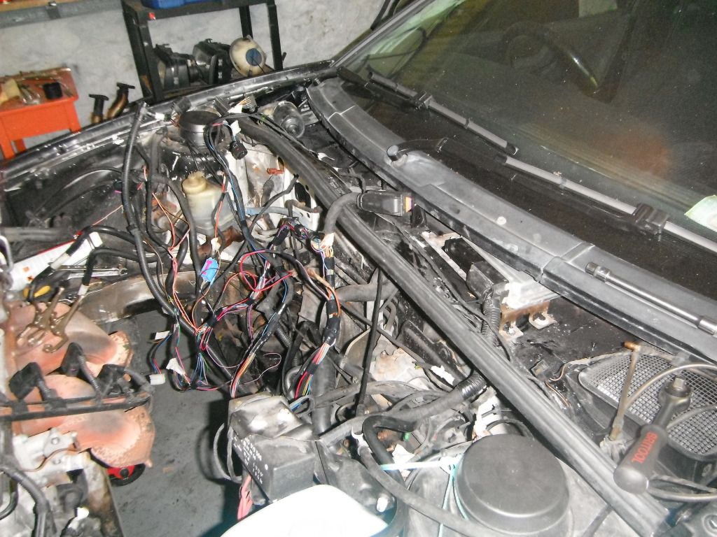

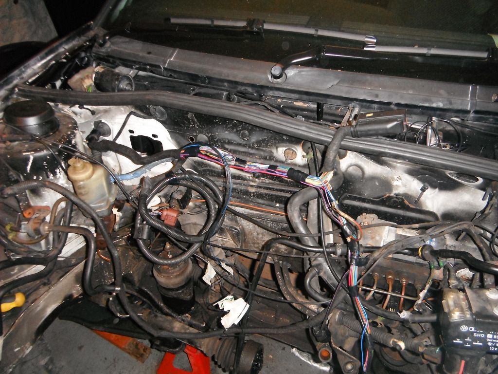

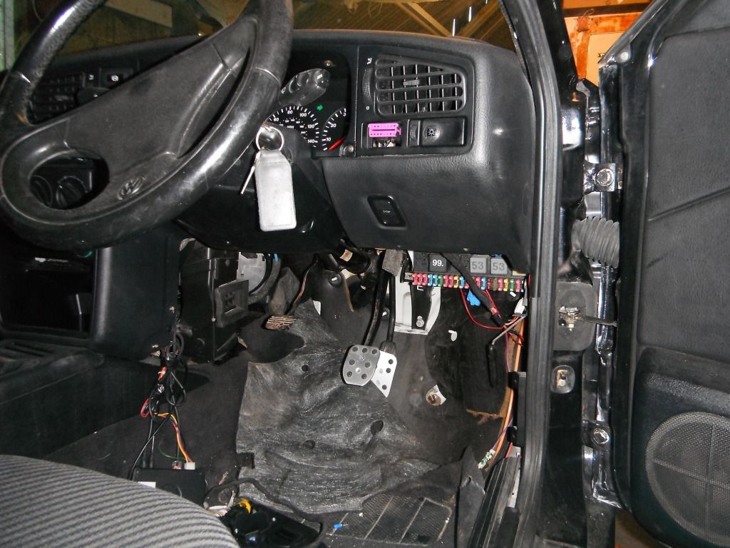

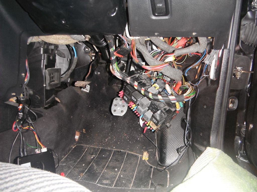

started prepping the wireing today , LOL took me like 15minutes to realise that the fusebox plugs are locked in place!!! i wasnt happy!
crammed in the foot well with a mess of wires! arghhh!! ahwell its a good experiance eh ;)
well getting there ,heat wrapped the down pipe the other day so thats ready,

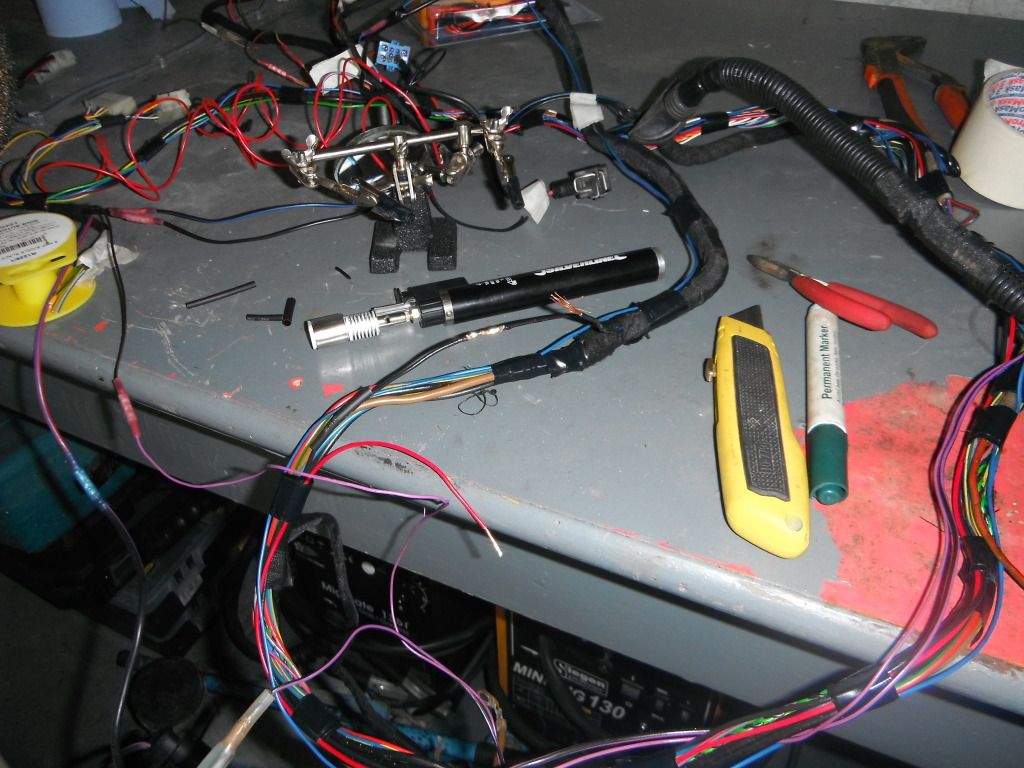

haha been playing auto electrician the last couple of days,
lmao!! had to get into the most awkward position possible to be able to see the plugs on the back, took me 15 minutes of pure struggleing to realise that the plugs are "locked"
in place by a bar! , lol i was like, surely these plugs cant be this tight!! ,
had to prety much re arrange the whole loom and make certain wires longer , , takes awhile especialy when your triple checking every wire you do,
brought myself a blow torch soldering iron, i use the bare flame and its Mint!! i use it with thin plumbers solder , then use heat shrink wrap ontop,
organised mess!! , the new ecu position, just goning to use a hot glue gun or some adhesive and bond the ecu to the bracket whn its in the right position,
so made the adjustments in the loom , and loom taped it up to just past the brake servo and plugged it into the fusebox, just got an ign live to connect up and hopefully electrics wise inside the car should be done!, the plug for the dbw pedal is there ready, just made a start this evening on the brakcet for the pedal ,dont know how other pedals are but mine is going to need chopping and re welding with an offset put in to bring it to the right a few inchs,
need to source a bracket for the diagnostic port aswell, its new home

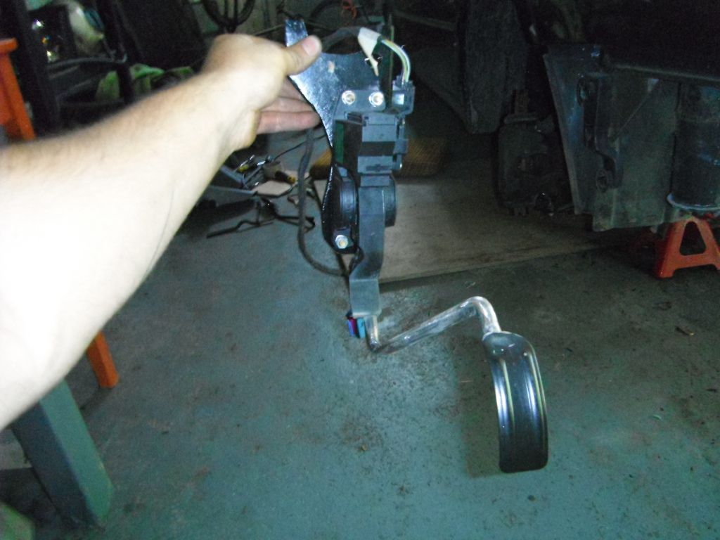

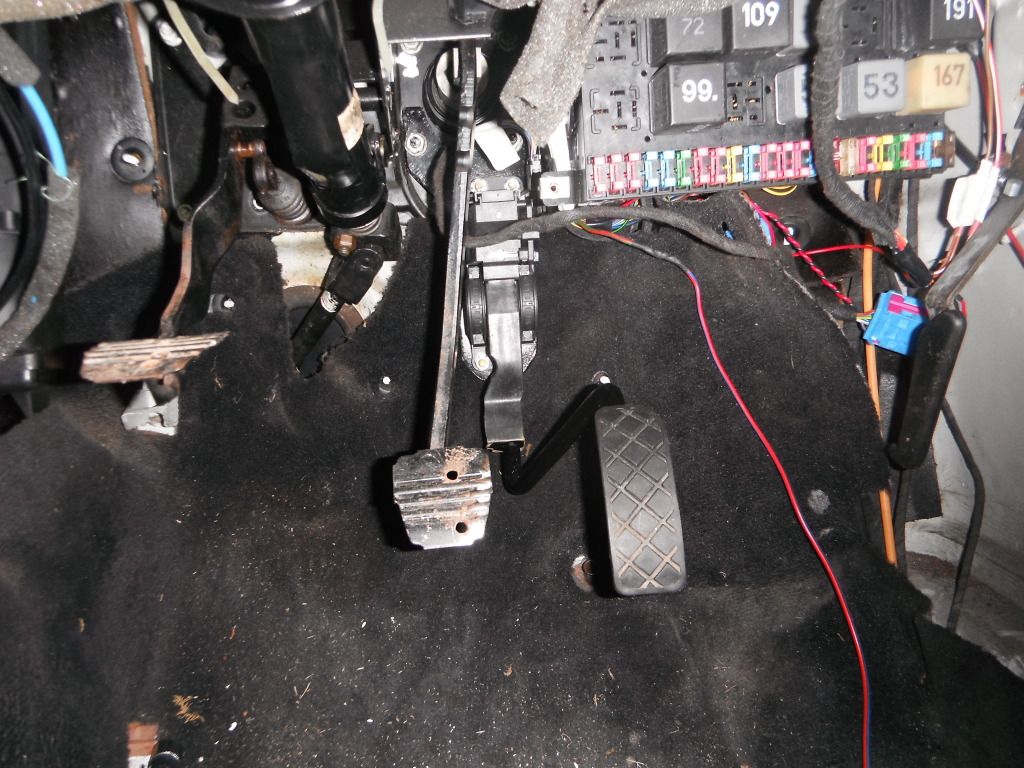

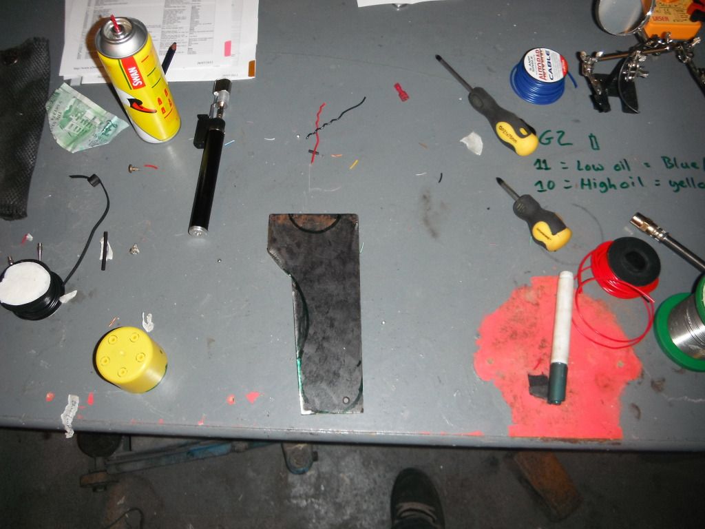

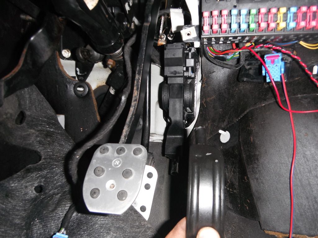

heres the plate im gona use for the pedal , just need to trim it here and there and drill some holes, hopeing to bolt it in with the 2 bottom bolts from the servo. gona use counter sunk bolts put in from behind the plate and tac weld the heads into the plate so its just three studs that the pedal bolts to , and then offset the pedal bar to bring it up and at 100mm center to match the old pedal
heres the gap that needs to be made up,
pedal finished, well almost ;)
i know some people have said how sensitive these pedals are especialy in 1st gear but i wonder how mines going to react now with it being alot longer then stock
might calm it down abit.

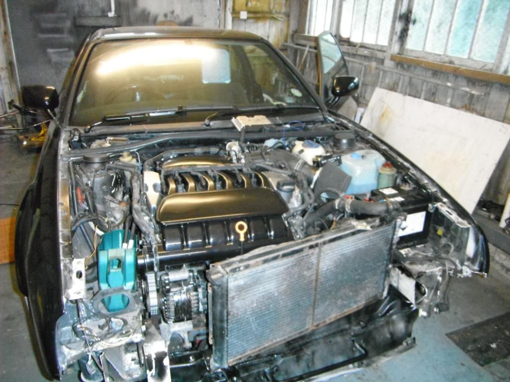

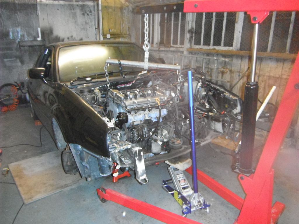

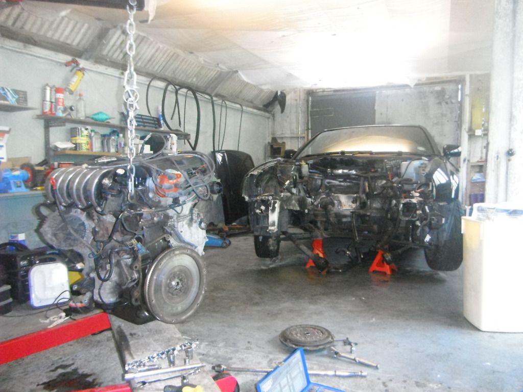

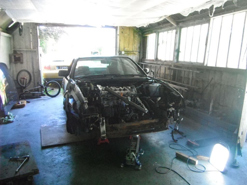

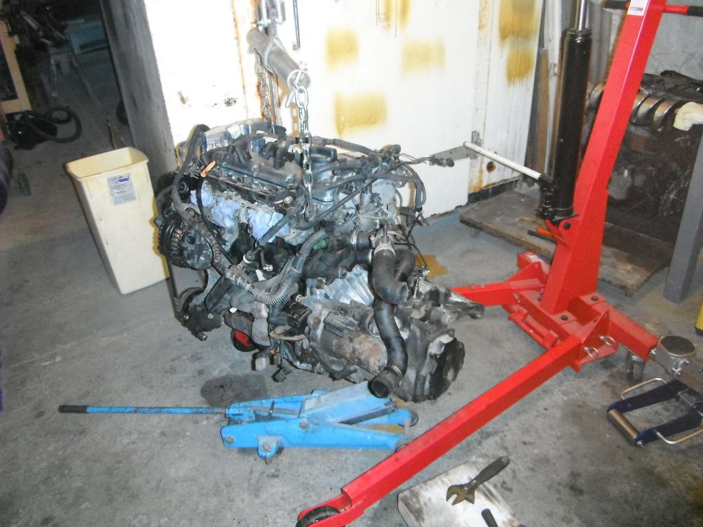

engines back in , hopefully for good this time! gear cables connected , clutch slave cylinders in,
got the brake servo and the clutch master cylinder back in {damn what a f-kn tight fit that is!!}, and the pedal arms hooked up,
found out that them two pedals sit slightly lower then what i used to measure up for my DBW
so as a result my dbw pedal sits slightly higher now,!! DOH! just need to chop 3/4" out the bar and re weld it ,

well its almost there!!
havent filled the cooling system yet,
just ironing out some wireing issuses at the moment, hopefully be sorted very soon,
cant wait to hear it running!,
well after hours of hunting down the wireing problem {an un connected ECU live } the beast fires up!
just need to tidey up the loom and replace a few perm lives for ign lives add a few wires here and there and bobs ya uncle i'll be the proud owner of a 24v corrado ;)
running like crap at the mo, need to feather the pedal otherwise it cuts out, so stoked on it starting though :)
