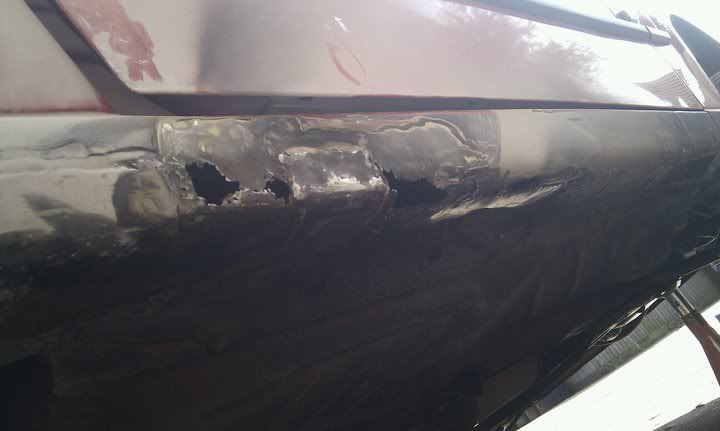

t700bes 1 Posted August 14, 2011 I bought a raddo with the driver side sill rotten... here are the pics: I have patched it up and will get the sill done at some point soon. People always say, oh no stay away... However if the car is £500 cheaper than another one and only the sills need doing, and the sills cost £300 to do, its £200 cheaper :) So depends really... Mine was £500, lots of problems, but when its mint, it wont of cost 3k and will be worth about that (I hope) Quote Share this post Link to post Share on other sites

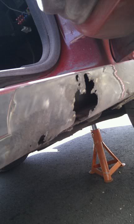

Jim Bowen 1 Posted August 15, 2011 just taking mine apart and finding the rust, can put my hand in the sill now, i guess the underseal had split i reckon it would be pretty impossible to find a corrado now that doesn't have hidden rust, unless its mega low miles and hardly been used ---------- Post added at 09:39 AM ---------- Previous post was at 09:33 AM ---------- mine: was no sign of rust on the outside, and underneath it starts to run along the sill join . all easy to fix though and no need to be scared of a little rust Quote Share this post Link to post Share on other sites

Jim Bowen 1 Posted August 15, 2011 think i saw a photo of a sill the other day and iirc its just the middle bit? not sure how to repair mine, will just try and shape some metal, i cut the rust out today Quote Share this post Link to post Share on other sites
