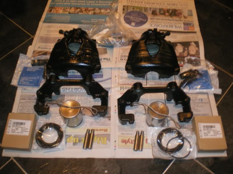

24V Renshaw 0 Posted September 27, 2011 More new bits.... Got myself some basically brand new MK4 front calipers, which combined with some brand new 312mm carriers, discs and pads I have will mean I have a complete new front brake setup to fit. The calipers are stripped and blasted and come will all new genuine parts, so should be perfect... Need to find some VR6 front hub carriers now to strip and rebuild to go with the brakes :) Jay For the picture whores... Quote Share this post Link to post Share on other sites

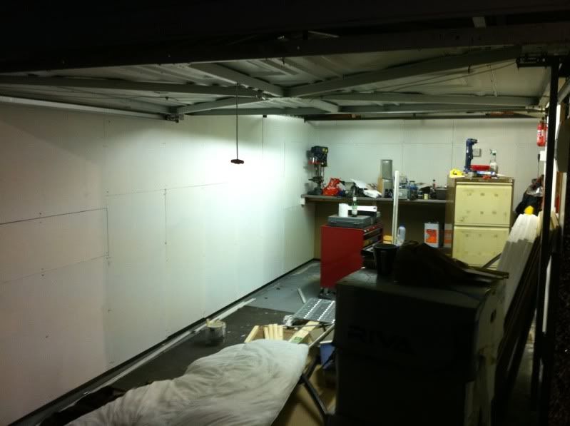

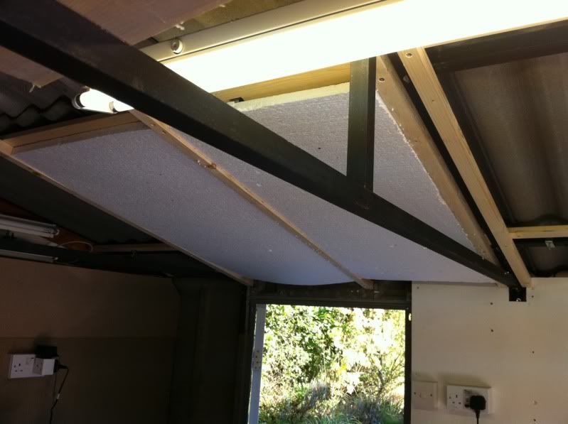

24V Renshaw 0 Posted October 1, 2011 Garage is progressing. Walls all insulated, boarded and now painted white to help with light in there. Insulation of the ceiling behind the panels should help nicely and prevent condensation. Just got to finish the ceiling panels and insulation tomorrow and tidy up, then the car can go in :) :) Jay Quote Share this post Link to post Share on other sites

MarkFoster 0 Posted October 1, 2011 You need to incorporate a vapour control line on the warm side of the insulation or you'll still suffer issues with condensation. Foil backed plasterboard (external use obviously) would do if you can't find the proper stuff. (Check RIW's website for some easy to install painted solutions.) Alternatively, you could just undercut your garage door to ensure proper ventilation but then that will rather work against the point of creating a heated space. Incidentally, you do have an insulated garage door don't you? Somewhat pointless otherwise.... Mark Quote Share this post Link to post Share on other sites
24V Renshaw 0 Posted October 3, 2011 Ideally I could have put a vapour barrier in but there is plenty of ventilation above the insulation in the roof so it will be fine without a vapour barrier. To be honest I am just looking to make it more comfortable while I work out there, a bit better for the car to be in and brighter too which it already is. I plan to insulate the garage door and also the side door, but they will be done later. Should get the car in tonight as I am just finishing the last bit of the ceiling this evening. Jay Quote Share this post Link to post Share on other sites

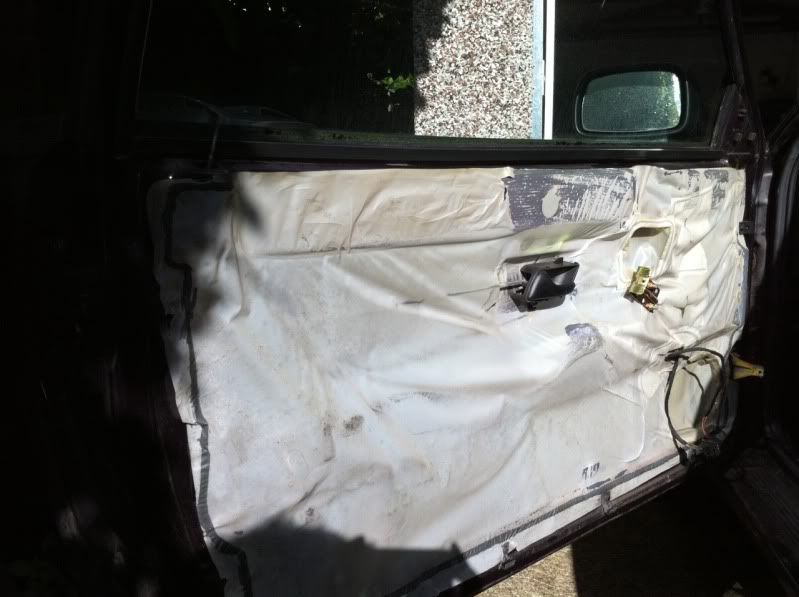

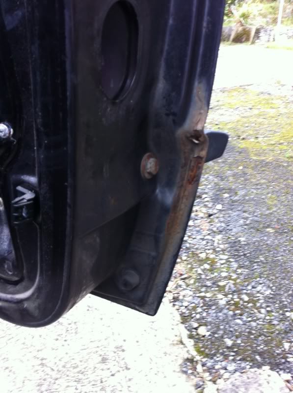

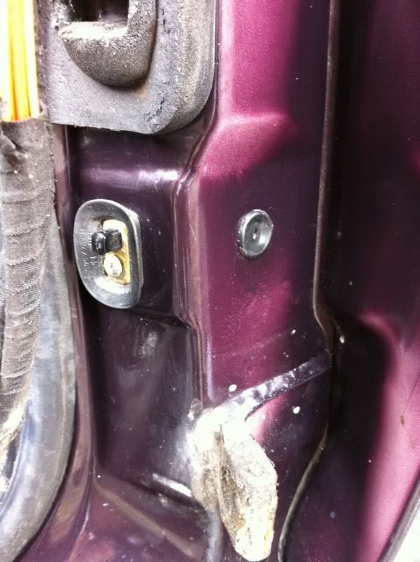

24V Renshaw 0 Posted October 7, 2011 UPDATE: Finally got round to spending a bit of time on the car today after all the efforts in getting the garage sorted. I had previously picked up a pair of Dark Burgundy Pearl Doors as when I bought the car I noticed some quite bad damage to the trailing edge of the drivers door and some significant parking dents in the passenger door. So this afternoon I removed both of the doors off the car and replaced them with the new pair I had waiting. The nice thing was when I removed the door cards from the car the membranes on both sides have never been removed and I managed to carefully get them off in one piece. Also every, clip, screw and trim bit was there and had never been taken off. So I will be putting them back together very carefully once everything is reconnected. A couple of pics showing the state of the original door. The un-touched membrane and the excellent condition of the A pillars behind the doors :) Slow progress really but, so far so good... Quote Share this post Link to post Share on other sites
boost monkey 0 Posted October 8, 2011 Flash on the last picture? Looks more like blackberry than DBP. Good work with swapping the doors though. I'm still after hens teeth early DBP wings. Quote Share this post Link to post Share on other sites
Jim 2 Posted October 8, 2011 DBP does look like that though under bright light... certainly thinking of seeing Supercharged's car in sunny light, I've seen it look like that from some angles! Quote Share this post Link to post Share on other sites
boost monkey 0 Posted October 8, 2011 Really? I can't get mine to look that bright! looks a much darker colour like the first two pics. Maybe it needs a scrub! Gorgeous colour though, like all the pearls. Quote Share this post Link to post Share on other sites
24V Renshaw 0 Posted October 8, 2011 There was some good sunlight on that bit when I took the picture, but it certainly shows the pearl thats there. Car is now in the garage so I can start working through everything. One of my key things is to ensure every clip on things like the door loom is back exactly where it should be, as there are some really hidden ones up inside the door which are obviously there for a reason and is one reason why this car is still so tight! Hopefully get a bit of time on it tomorrow. Jay Quote Share this post Link to post Share on other sites

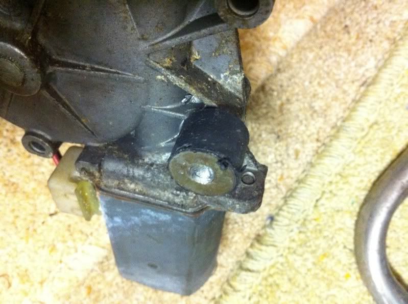

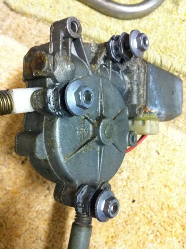

24V Renshaw 0 Posted October 12, 2011 Tiny update. I managed to get literally 10 minutes on the car this evening and spent it sorting out the window mechanism mountings. In order to remove the window mechanism from the old doors I had to drill out the rivets. This meant the rubber bobbins which support the motor were ruined. So I bought some M6 exhaust mount bobbins, which are a perfect replacement for the riveted bobbins. They screw straight in the existing M6 holes in the motor and will bolt through the door where the rivets previously were. I have not fitted them in the door yet as I did not have any time, but I am happy they will work and will be easily removable if necessary. Jay Quote Share this post Link to post Share on other sites
davidwort 0 Posted October 13, 2011 With those motor mounts you can drill the rivets right out and then cut a small slot in the side of the rubber with a sharp stanley blade, pop the old end of the rivet out of the slot and super-glue the rubber back up, worked a treat on several I've done and the rubber hasn't split again. Have to say I prefer bolts to rivets though, why they riveted the originals I don't know, so cheap and nasty and it's not as if they rushed building the corrados anyway. Quote Share this post Link to post Share on other sites

24V Renshaw 0 Posted October 13, 2011 I cheated and just got new rubbers from the dealers ! Trouble is if you ever need to remove it again, and let's face it, it's a Corrado so you will, you have to drill the rivets again. This way it's just 3 nuts :) I am going to be so fussy about every clip on this car, normally I am "customising" things so I make it the best possible I can, but on this one VW have already done it all for me so I will just make sure everything goes back as it was if not better ;) Quote Share this post Link to post Share on other sites
Jim 2 Posted October 13, 2011 Nice idea Jay.. as you say, riveting the thing back in is a total ball ache - this is far more elegant! Though I guess it does mean they could work loose and rattle...? Quote Share this post Link to post Share on other sites
