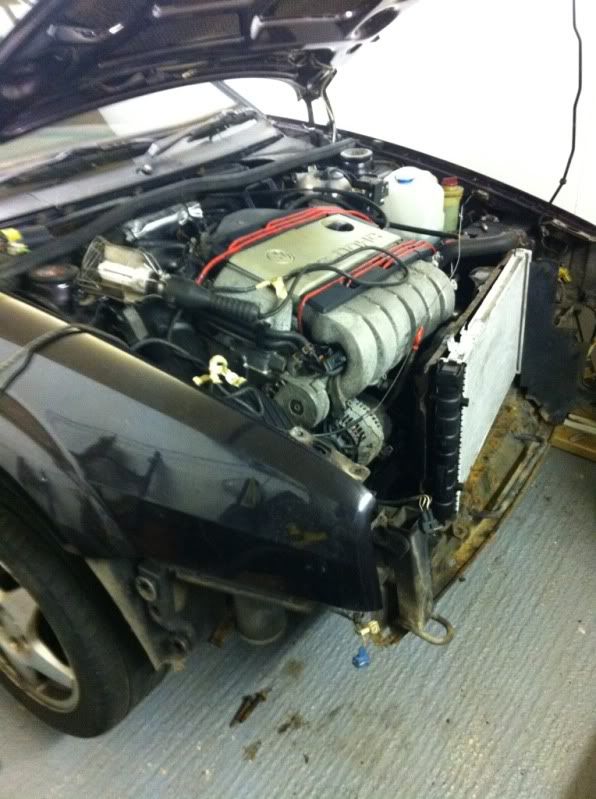

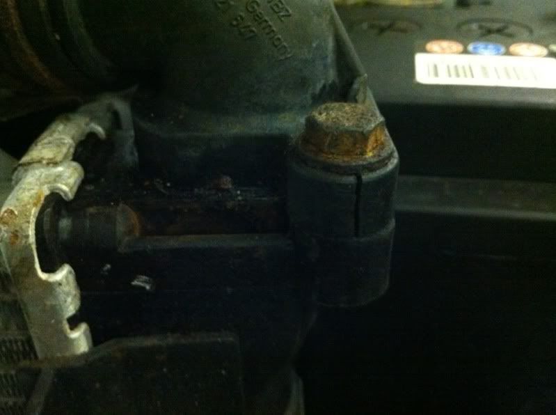

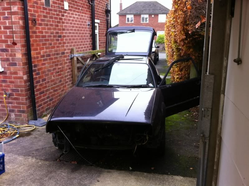

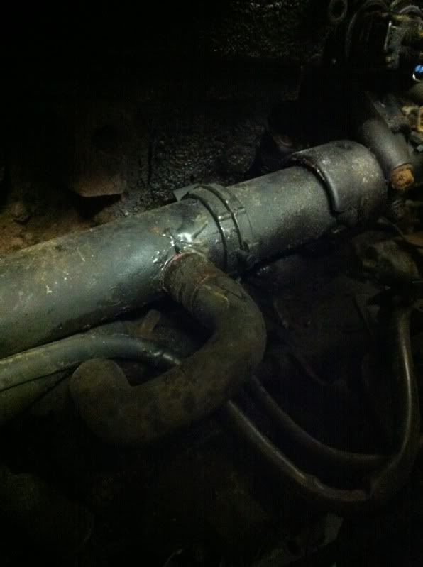

24V Renshaw 0 Posted November 8, 2011 A bit more progress tonight. Removed the front bumper and the front panel which I am replacing with a tidier one as this one has some dents and damage which I don't want. Upon investigation of the basics I am pleased with almost everything, even the lower panels are not the worst I have seen. Did notice a crack on the rad top pipe so that will be replaced, also I have spotted a repair to the crack pipe so that's another part to replace ASAP. Some little pics... Jay Quote Share this post Link to post Share on other sites

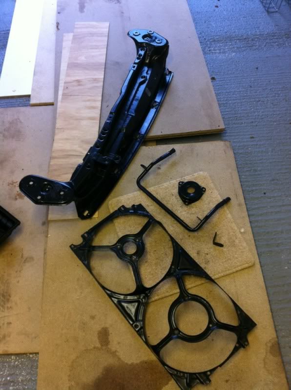

24V Renshaw 0 Posted November 14, 2011 Dropped off a pile of bits to the powder coaters this morning including the fan cowling, the lower front panel and cross member bits which need doing before i start using the car as they will be a pain to replace when i do. Should have them back on Friday, so have this week to progress with replacing the urgent bits in the engine bay, putting the doors back together and generally tidying up a bit. Got the first of my new bits to fit... Jay Quote Share this post Link to post Share on other sites

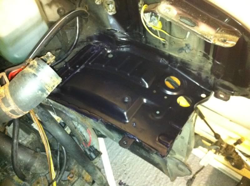

24V Renshaw 0 Posted November 16, 2011 Being as I am doing the group buy on the poly engine mounts I figured I should smarten up my mount parts ready for the new inserts, so a lick of paint was applied ready for the how to photos. It is satin so will look OEM when it's dry :) Also after a bit of grinding, rust treating, etch priming and then base coat dark burgundy pearl I have a battery tray which should do until I ultimately no doubt do a full bay paint one day... Just a coat of lacquer to finish Will it be mobile for the rolling road day a week on Sunday? Hmmmm? Quote Share this post Link to post Share on other sites
Redfox 10 Posted November 17, 2011 Hi, Just a sugestion: you could stick on a few cut bits of clear selfadhesive plastic like the one you can wrap around plastic, to protect the paint from the battery diging into it again. Also give the battery one or two vent tubes to prevent the rust again. I did, and no more problems in that area. Cheers, Redfox. Quote Share this post Link to post Share on other sites
24V Renshaw 0 Posted November 17, 2011 Not a bad idea with the protective plastic. Jay Quote Share this post Link to post Share on other sites
24V Renshaw 0 Posted November 20, 2011 Got a day on the car today and was able to clean down the engine bay a bit more, nothing major, just trying to get rid of the worst of the grime. Also managed to get the doors built up with everything apart from the interior trim, which will go in later in the week. Spent a lot of time making sure everything was right and clipped in properly and hopefully it will result in it all being rattle free once its all finished. Got my bits back from the powdercoaters, but I have noticed I am missing the battery clamp which is annoying to say the least, so hopefully they will have it somewhere.... Will it be ready for the rolling road day on Sunday?..........hmmmm Quote Share this post Link to post Share on other sites

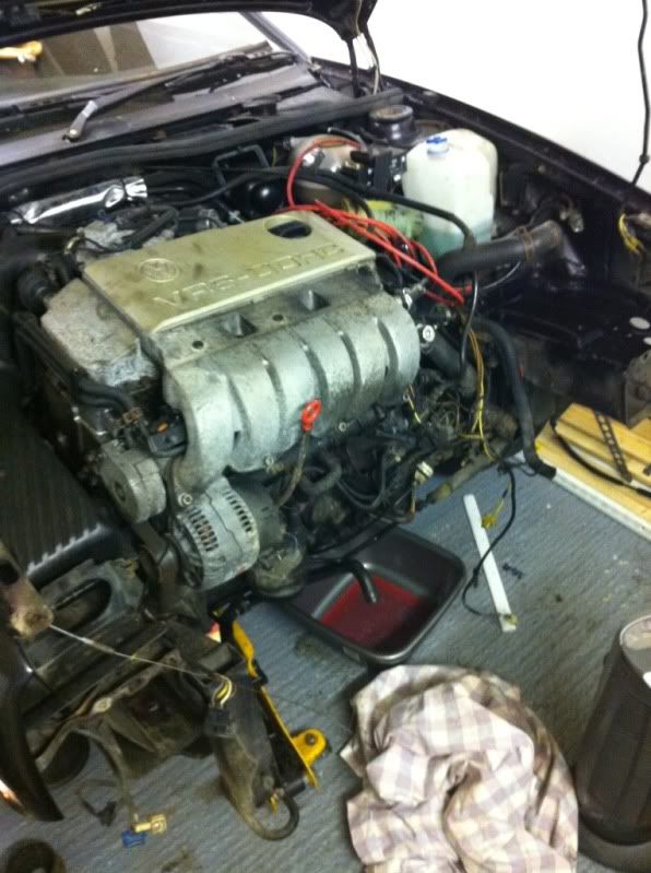

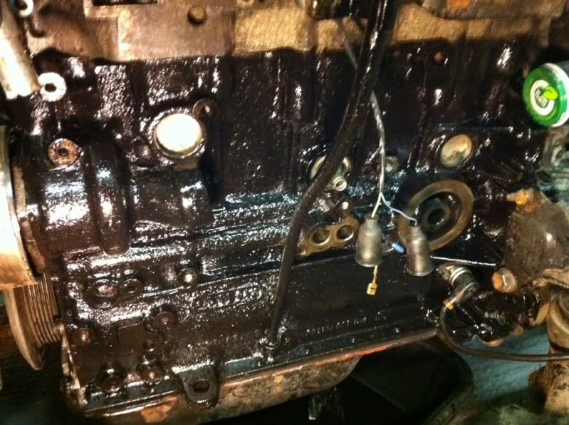

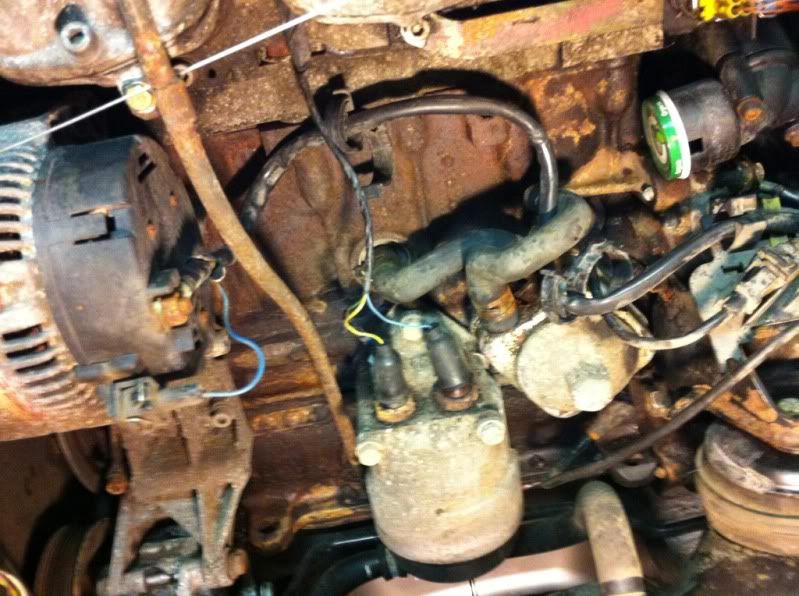

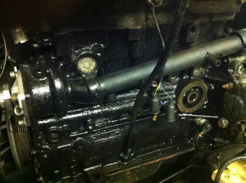

24V Renshaw 0 Posted November 21, 2011 Instead of starting to put the engine bay back together, like I probably should be to get it back together for the weekend, I couldn't leave the block looking so grubby and rusty while I was in there. So I stripped off the oil cooler, alternator bracket, filter housing, and all the other bits. Cleaned down the block and painted it in clean fresh black paint, just so it's all tidy and I can easily pin point any leaks when it's all back together. Now I obviously have to clean up and tidy the brackets, filter housing, oil cooler etc to match. :) LOL Jay Quote Share this post Link to post Share on other sites

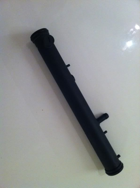

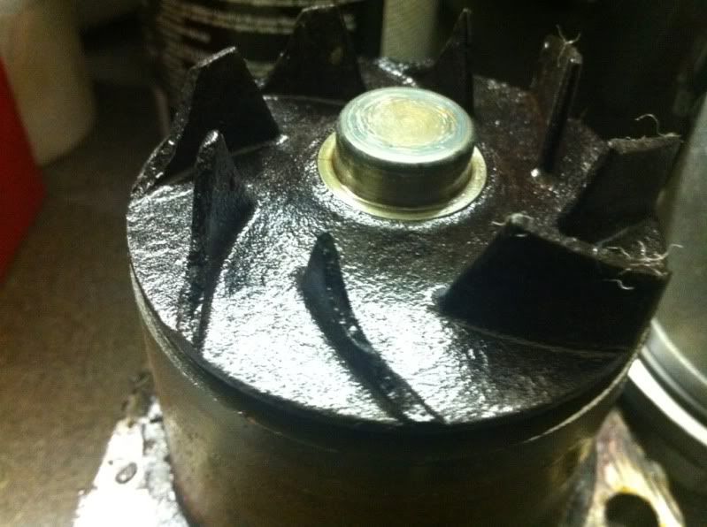

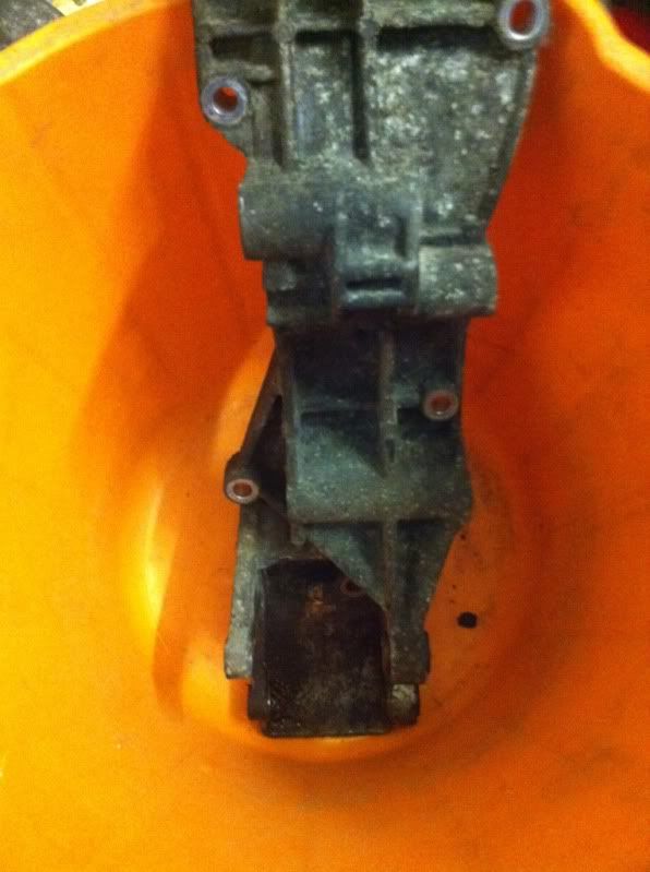

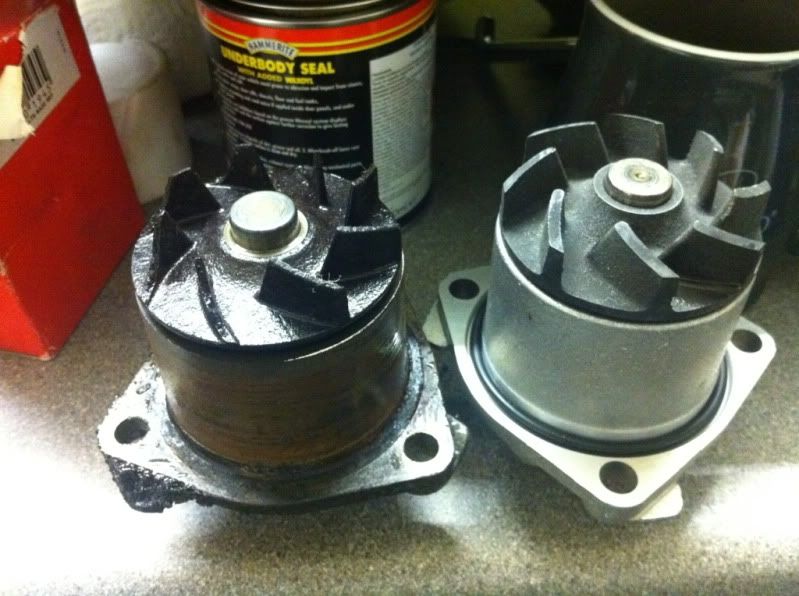

24V Renshaw 0 Posted November 23, 2011 (edited) Tiny bit of progress tonight. Was in two minds about replacing the water pump, but again thought while I was there it would be silly not too. So with some wriggling and pulling I removed the old one to find this... Lots of the blades damaged or completely missing. Not exactly efficient cooling!! Compared to the new one it looks positively knackered! All installed along with a new crack pipe. The aluminium brackets and housings are too marked with oxidisation to bother cleaning them up, so I am going to have to paint them to a bare finish. So having cleaned them and removed all the crud any suggestions for the best OEM look silver paint? Jay Edited November 23, 2011 by 24V Renshaw Quote Share this post Link to post Share on other sites
Jon_vr6 1 Posted November 23, 2011 Yeah id say silver paint would be best. How did you find removing the old crack pipe, took me ages when i did it and my arm for the following day or so ached really bad? Quote Share this post Link to post Share on other sites
24V Renshaw 0 Posted November 23, 2011 The crack pipe literally fell to pieces in my hands, it broke up and I had to then clean all the pieces out of the hole in the block to leave a nice clean seal for the new one. Jay Quote Share this post Link to post Share on other sites

James. 9 Posted November 24, 2011 I found eastwoods aluma blast from Frost restoration to be the closest match. Used an airbrush to get in the nooks. Quote Share this post Link to post Share on other sites
