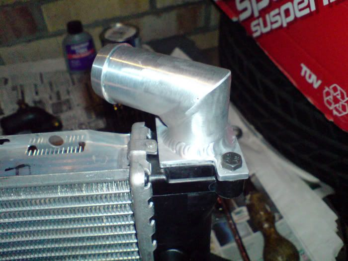

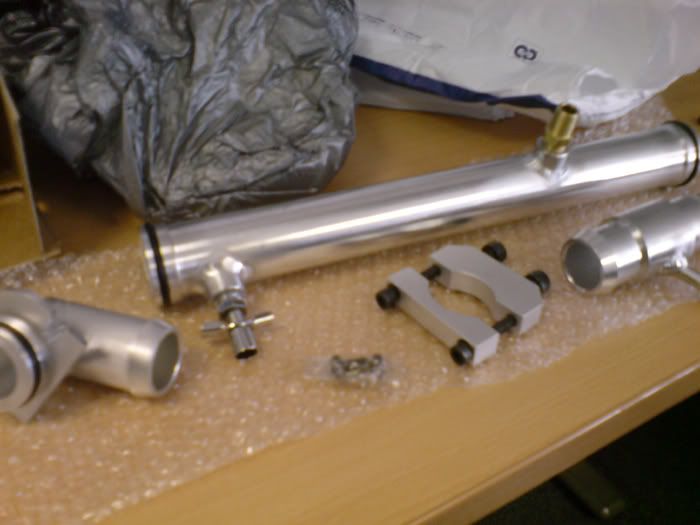

24V Renshaw 0 Posted March 3, 2012 Yesterday i was reminded of the joys of running a corrado as a daily... But also the fact I love the cars because they always get me home somehow! Having just popped round to Andys to drop off his orbital polisher and admire his spotless car, I pulled onto the motorway and heard a pop and then had a nice steam spray up the bonnet. I knew what it was and the coolant level light confirmed it, so I pulled over straight away and popped the bonnet expecting to see a burst pipe and found the top radiator elbow plastic pipe had neatly split into two short lengths.. I managed to push it back on loosely and actually limped to the garage round the corner before it popped off again under the rising pressure, but the temp never went over 120. At the garage I managed to undo the jubilee clip with my house keys (no screwdriver in the boot or for sale in the garage!! Doh!!) and removed the piece of plastic from inside the hose. I then pushed the pipe onto the 10mm or so of remaining plastic pipe and tightened the jubilee clip with the key again. I then bought 4L of nice spring water from the shop and filled the car up and it managed the remaining 20 odd miles home no problem! So I need a new top elbow, which as I found out today is obsolete! Great! So the choice now is a pattern one or a billet one... Typically when I was sorting out the engine a few months back I couldn't get a new elbow in time for the rolling road day so kept the old one on... So I only have myself to blame :) Jay Quote Share this post Link to post Share on other sites
Jim Bowen 1 Posted March 3, 2012 Although they say corrados are unrealiable, i've only ever been stuck and needed recovering once, i quite enjoy the adventure of fixing it and getting home. I have the gruvenparts one on mine, its nicely made but quite expensive, but i figured its never going to need replacing again. Think i got a deal as i ordered a few VR6 parts at once, still got some golf part i never needed. Quote Share this post Link to post Share on other sites
Redfox 10 Posted March 3, 2012 Good to hear that you managed to get home. I am actually getting a bit worried of VW's rather ugly stand to refuse to supply even the most well-known spares. Even mazda does not do this. I'll try to source one here, if I can get two, I'll drop you a pm. Cheers, Redfox. Quote Share this post Link to post Share on other sites
24V Renshaw 0 Posted March 3, 2012 Managed to find a brand new genuine one on EBay. Expensive at £30, but the last one has been good for 17 years so it's worth the money. Jay Quote Share this post Link to post Share on other sites
joebloggsVR69 0 Posted March 3, 2012 You can still get the rad elbow, several of us have bought them recently from VW Heritage or Classicparts DE, cost around £20 I think ---------- Post added at 10:37 PM ---------- Previous post was at 10:34 PM ---------- Actually, looking at the invoice, it was £6 :) Quote Share this post Link to post Share on other sites

Jim 2 Posted March 5, 2012 Jay - get in touch with Pat_McCrotch... we just bought a load of radiator elbows from Germany through Classic Parts and as has been said they were something like £6! :) Pat_McCrotch (Neil) works for an Audi dealer who have become the first official VAG dealership importer for Classic Parts in the UK so he should be able to hook you up! :) Quote Share this post Link to post Share on other sites

24V Renshaw 0 Posted March 5, 2012 Jay - get in touch with Pat_McCrotch... we just bought a load of radiator elbows from Germany through Classic Parts and as has been said they were something like £6! :) Pat_McCrotch (Neil) works for an Audi dealer who have become the first official VAG dealership importer for Classic Parts in the UK so he should be able to hook you up! :) Damn it! I have already bought it as there was no availability on Neil's group buy. Oh well, at least I will have it, thanks anyway Jim Jay Quote Share this post Link to post Share on other sites

bristolbaron 11 Posted March 5, 2012 bugger! i should have read this sooner, i have two spare elbows sat at home.. needed to order one from classic parts, but as the postage takes up a decent % of the cost i ordered three! Quote Share this post Link to post Share on other sites
