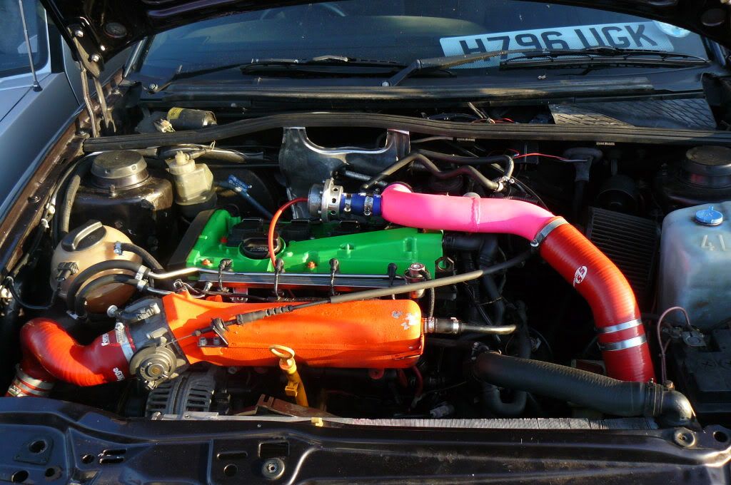

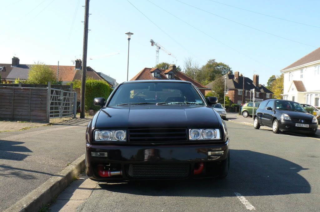

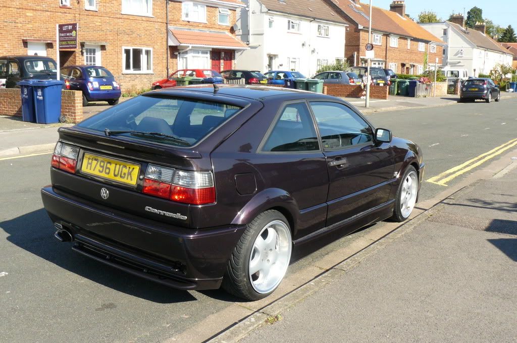

Dlicence 0 Posted October 6, 2011 (edited) cheers for the link! some really good info there. here are some pics of it: so today i put a new crank sensor in and it didn't make a difference. what a waste of time, it was hard to get out but to put it back in I had to take the radiator, oil filter and oil cooler off, friggin nightmare. right, temp sensor next :( Edited October 6, 2011 by Dlicence Quote Share this post Link to post Share on other sites
VW_OwneR_85 2 Posted October 6, 2011 looks clean!! funky looking engine bay! like a 90's disco :) do you know if theres a diagnostic port? also did the previous owner mention anything that may indicate a problem? Quote Share this post Link to post Share on other sites
