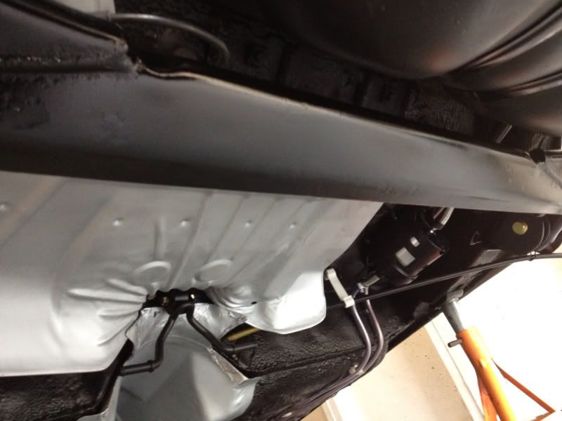

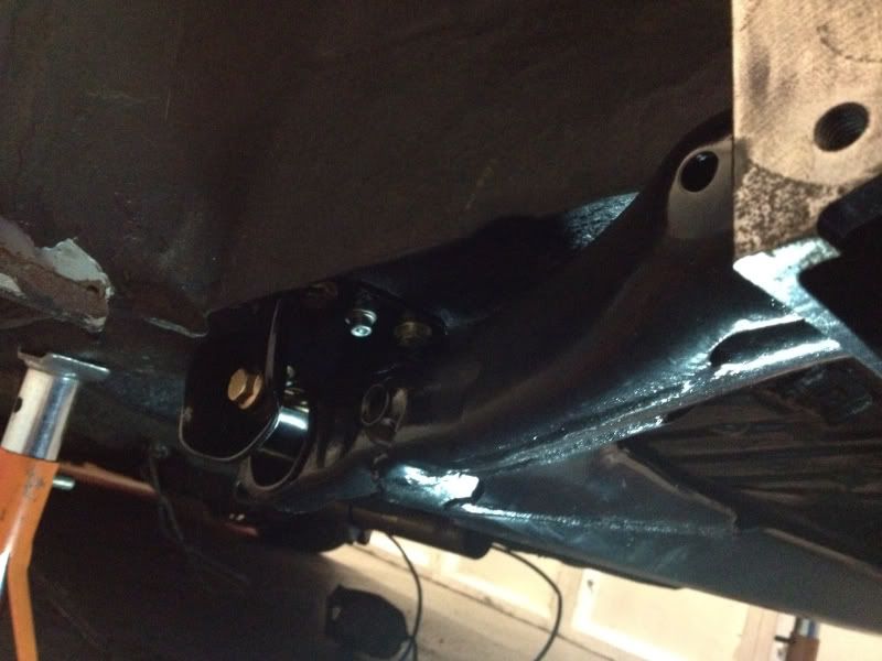

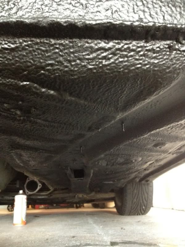

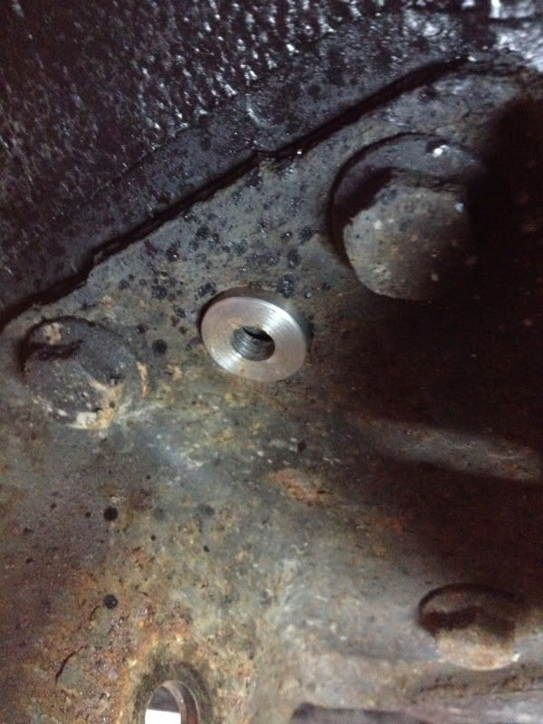

Overmind 10 Posted April 10, 2012 So last weekend I removed the fuel lines, brake pipes and various plastic clips from the rear floor section, then cleaned the rear floor pan and removed all surface rust, then painted it with a corrosion inhibitor and schutzed it. I have been thinking about removing the rear beam mounting brackets for a while to get them powder coated. However the problem is they are slotted to allow adjustment of the rear beam, so getting them back on in the correct position can be difficult, even if you scribe around them before removal. So I have machined a small spigot and bolted it to the car which will enable me to remount the brackets more accurately, so I only have to rely on scribing marks for axial twisting of the brackets around the spigot. Im happy this method is accurate to half of a millimetre or so, but I will set the wheel alignment up afterwards to be sure. The rust in the above picture will also be treated prior to the brackets being refitted. Quote Share this post Link to post Share on other sites

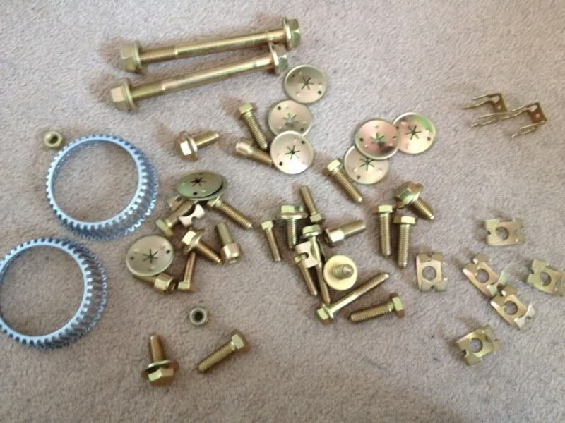

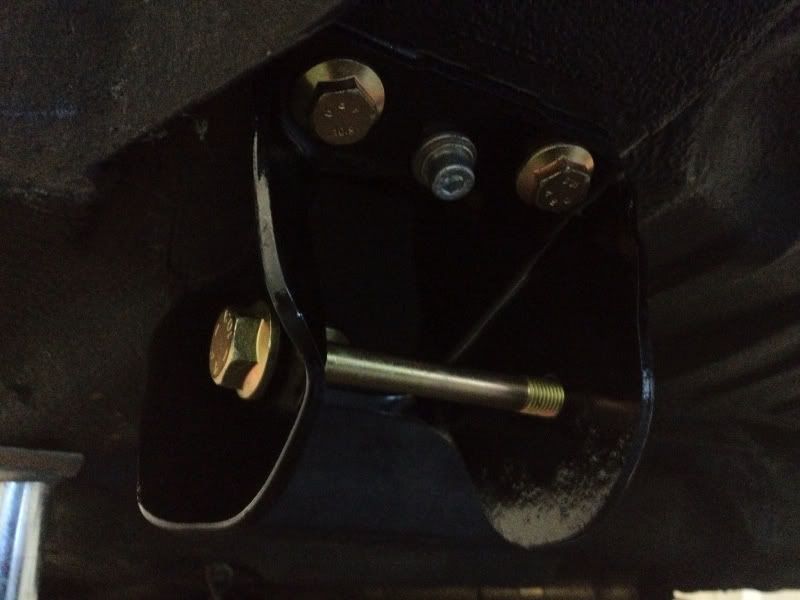

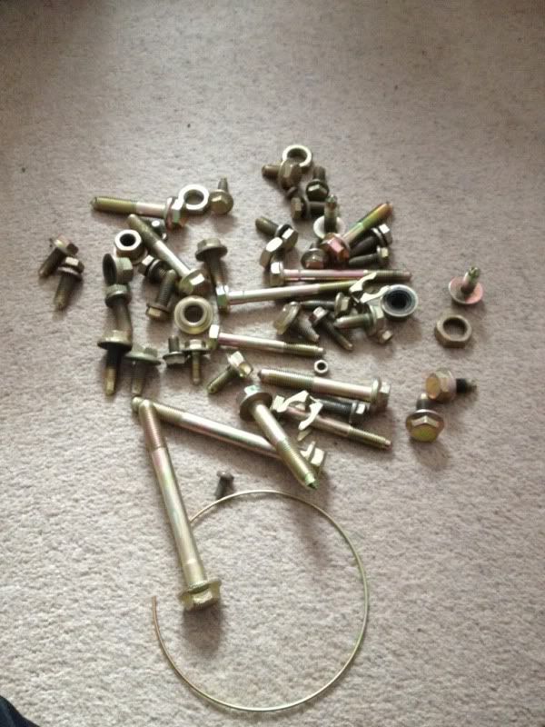

ChrisL 20 Posted April 25, 2012 Next chapter. Most of the bolts and fixings I should need to put the back end back together.. Cheers. Bryn. awsome work. Are those new bolts and fixings or have you had the original parts re-plated? Quote Share this post Link to post Share on other sites

Overmind 10 Posted April 26, 2012 awsome work. Are those new bolts and fixings or have you had the original parts re-plated? They are new parts that have been gold zinc plated mate. As the majority of corrado bolts were gold plated from the factory and replacement parts now come with some weird Matt silver zinc coating. I wanted to go for an original finish. Thanks for the kind comments guys. Progress has slowed as I'm currently on holiday in turkey :thumbleft: lol. But I'll have another update ready next week. Thanks. Bryn. Quote Share this post Link to post Share on other sites

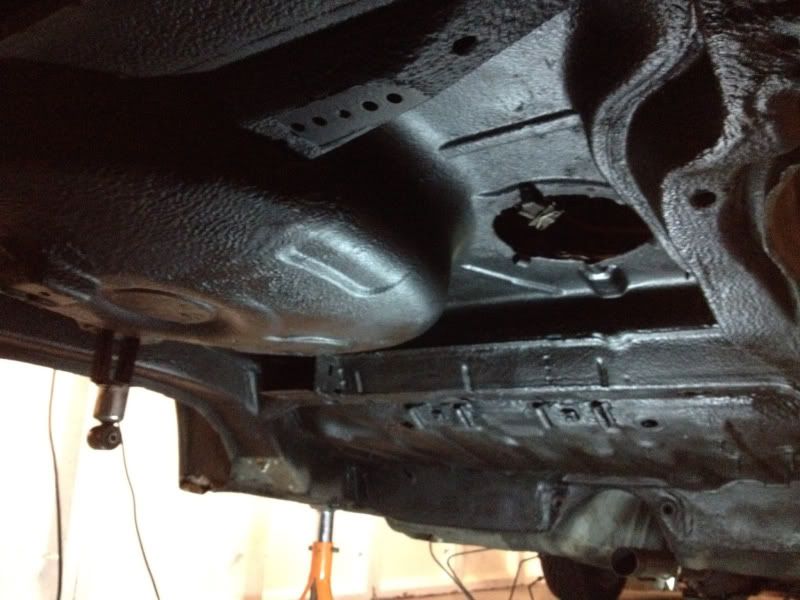

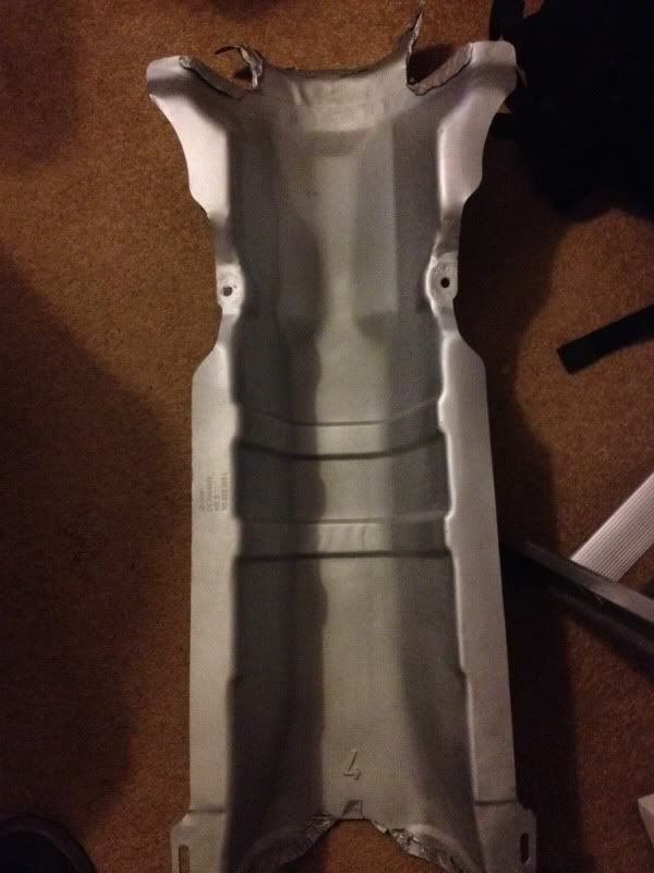

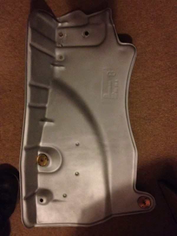

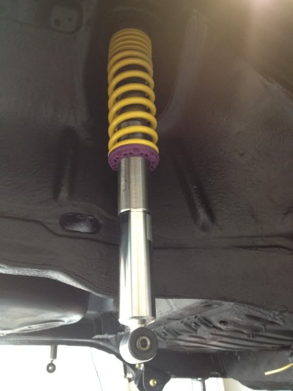

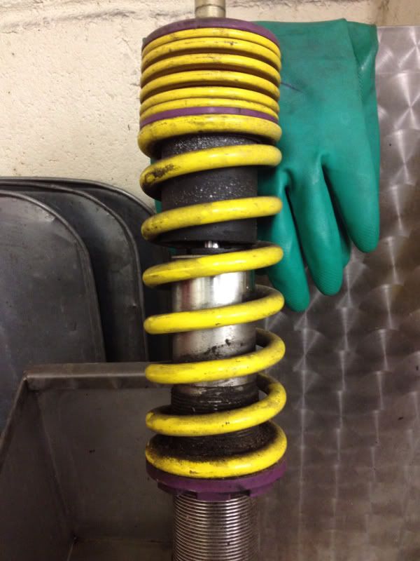

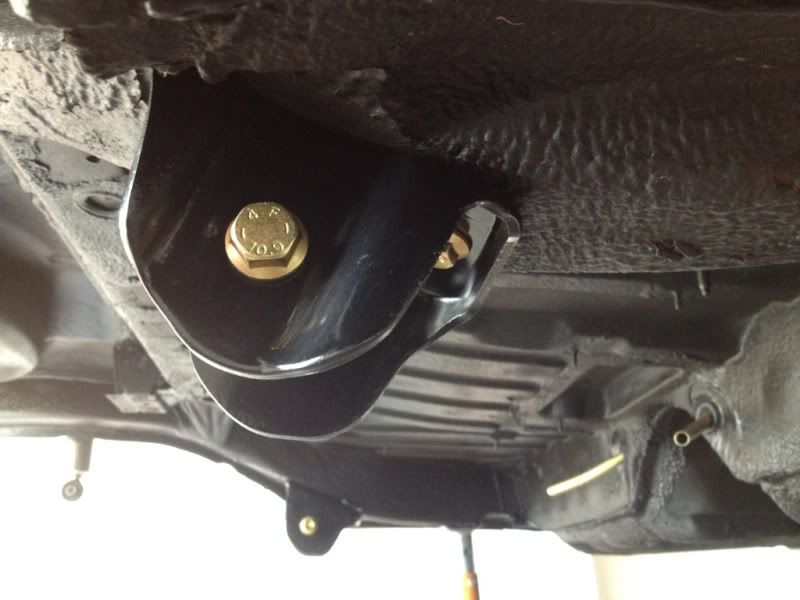

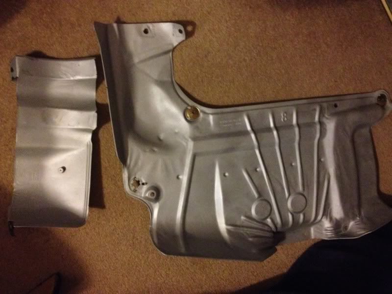

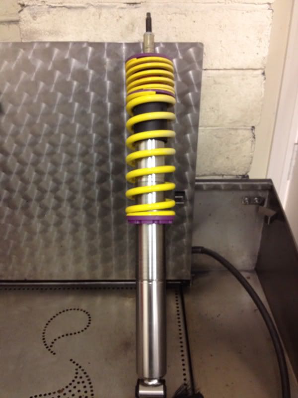

Overmind 10 Posted May 15, 2012 Quick update I have completely removed the bracket for the bias valve from the rear beam mounting brackets. They are now painted and back on the car, im very happy with how they look with the new bolts. I then trial fitted the rear beam so I could start working out the routing for brake pipes and abs wiring etc. Again I am very happy with the finish so far. I also removed the rear coilovers and gave them a spruce up. The rear exhaust heat shields have been sand blasted and painted with a zinc based paint, this should give them some protection for the future. Next steps: Clean the fuel tank inside and out Finish painting the rear arches and refit the shocks Final fit the rear beam and get the car back on its wheels. Cheers guys. Bryn. Quote Share this post Link to post Share on other sites

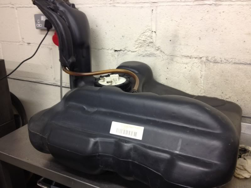

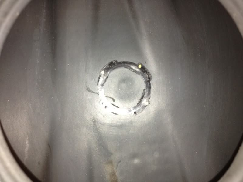

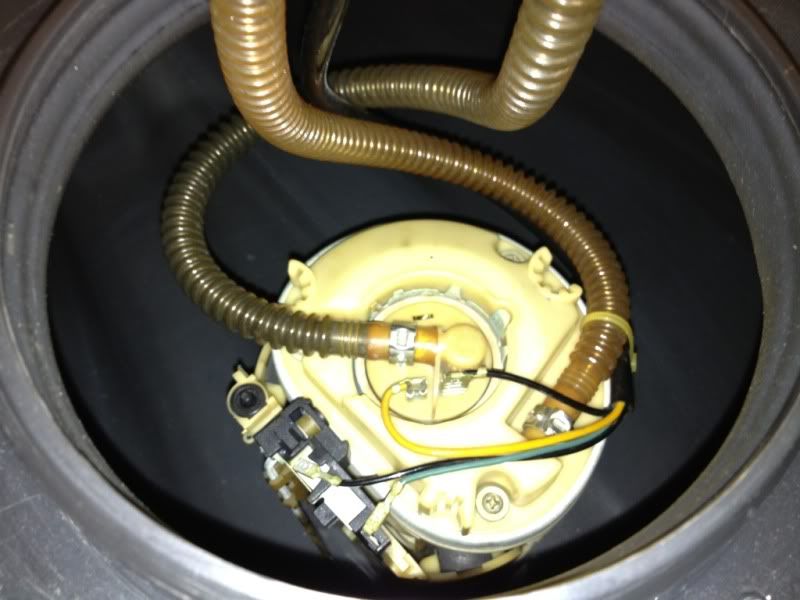

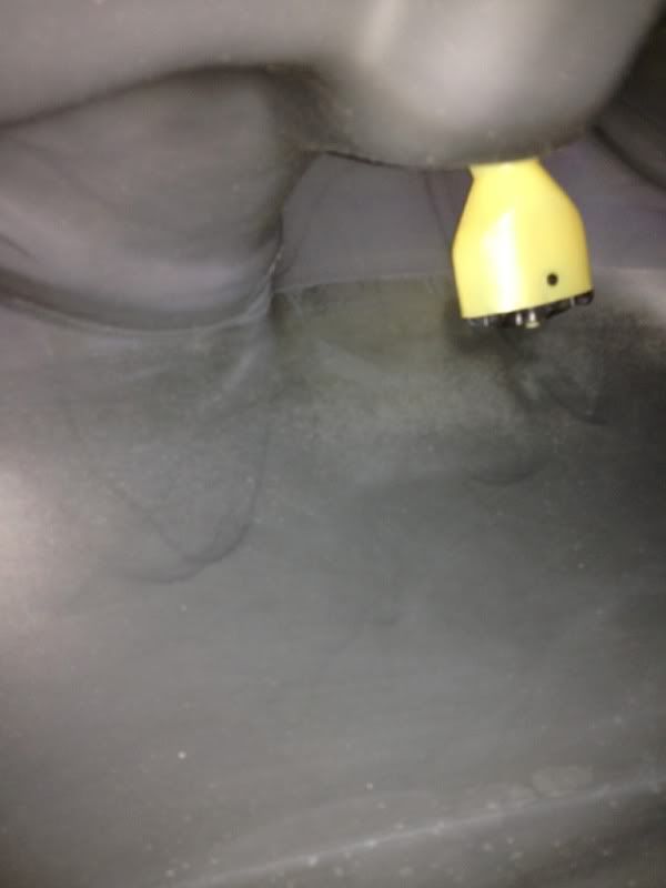

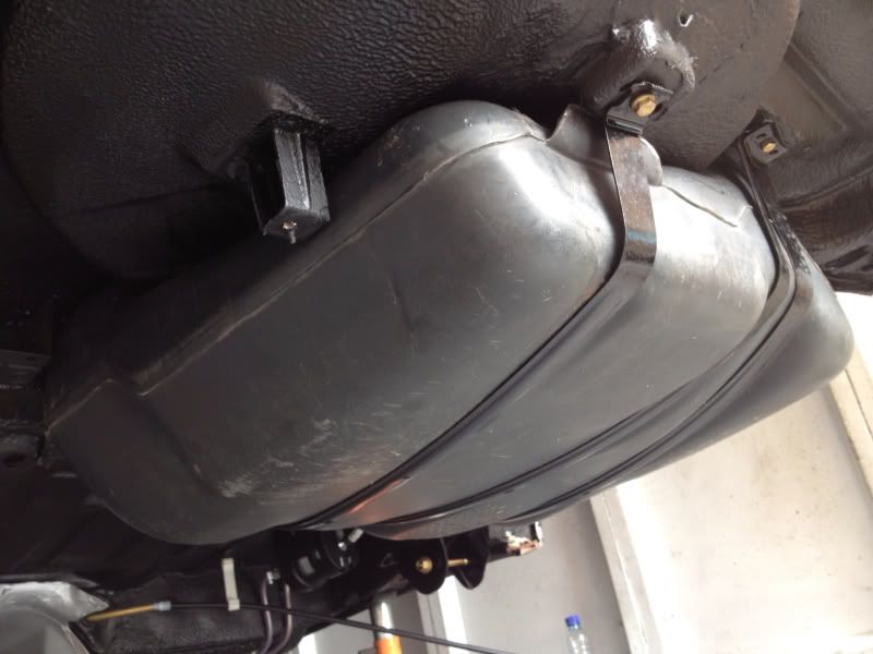

Overmind 10 Posted May 15, 2012 I gave the fuel tank a good spring clean today. I wanted to check the pump and clean out any debris inside as well as removing the years or soil buildup on the outside. Pump removed Inside all spanky clean Pump refitted Exterior all cleaned up Quote Share this post Link to post Share on other sites

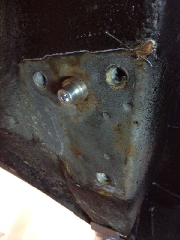

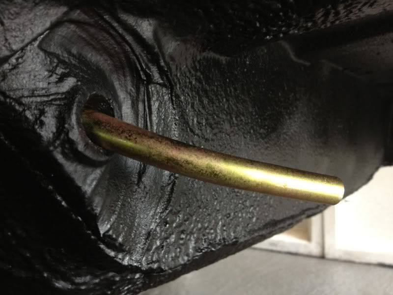

ChrisL 20 Posted May 16, 2012 I have been thinking about removing the rear beam mounting brackets for a while to get them powder coated. However the problem is they are slotted to allow adjustment of the rear beam, so getting them back on in the correct position can be difficult, even if you scribe around them before removal. So I have machined a small spigot and bolted it to the car which will enable me to remount the brackets more accurately, so I only have to rely on scribing marks for axial twisting of the brackets around the spigot. Im happy this method is accurate to half of a millimetre or so, but I will set the wheel alignment up afterwards to be sure. The rust in the above picture will also be treated prior to the brackets being refitted. THe locating pins you made, are there some threaded holes on the car already? Did you want to sell me them when you have finished???? Quote Share this post Link to post Share on other sites

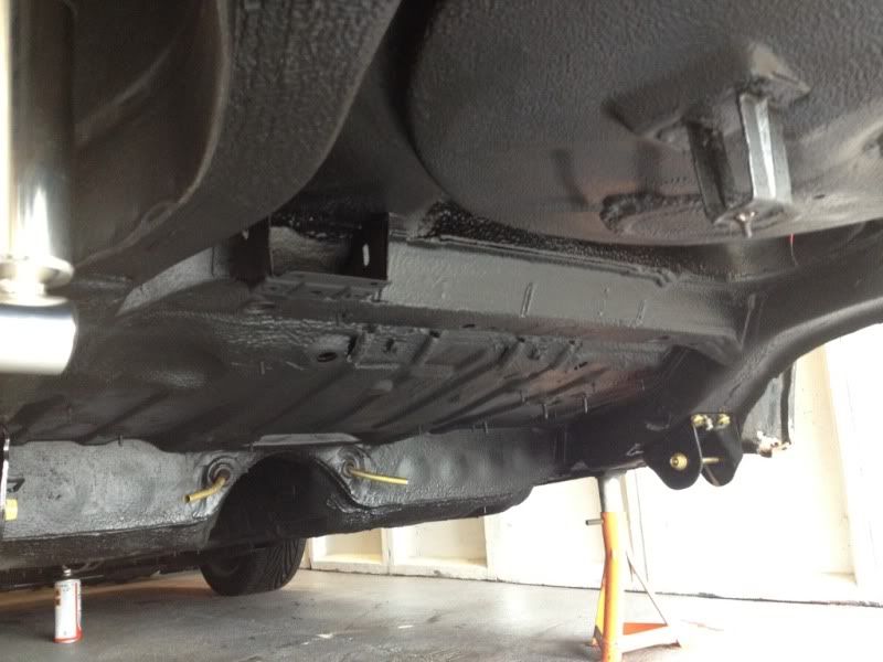

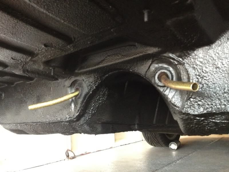

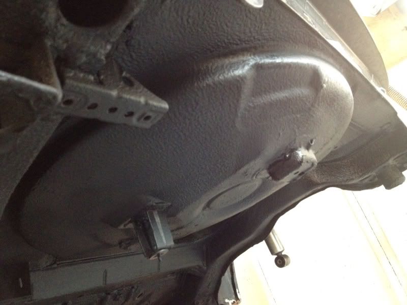

Overmind 10 Posted May 16, 2012 There are not any holes there originally, I had to precisely measure and drill my own and then fit a temporary riv-nut (although to be honest the metal is thick enough you could probably tap a thread into it and seal it up with a bolt when you are finished.) I will be keeping these ones, but im more than happy to make you a couple if you are still interested. Update for tonight: The rear arches are now cleaned up and the couple of spots of surface rust removed, then red oxide primed and sealed with stone guard and schutz. I also removed the fuel lines from the car (I will be replacing these with 7.94mm kunifer pipe, in my oppinion it looks a lot better and will not degrade in the future.) and I have de-rusted all of the studs that hold the clips for the fuel lines onto the car and treated them. Next jobs: Give the floorpan and arches a final coat of schutz Refit the rear shocks Fit the rear beam bushes and fit the rear beam Build the rear beam up and make the brake pipes Thanks for all the great comments guys. Quote Share this post Link to post Share on other sites

ChrisL 20 Posted May 16, 2012 Cheers but don't want to drill into the car! Looks brilliant what your doing, cars going to be a minter when your done. What wall thickness is the kunifer pipe please? Quote Share this post Link to post Share on other sites
Overmind 10 Posted May 16, 2012 I have not bought the new bias valve yet, however I will do soon. There's no going back to the old setup now mate haha :-). That's fair enough matey, to be honest I wasn't too happy about drilling holes but short of making a very elaborate jig it is the easiest way to retain the original geometry. The kunifer fuel pipe has a 0.71mm wall thickness. I work restoring classic Porsches for a living, and often use this to make up new fuel manifolds for 356 race cars. I find covering it in 8mm PVC washer hose looks quite nice and protects the pipe from abrasion and corrosion while providing a wipe clean finish :-). Quote Share this post Link to post Share on other sites

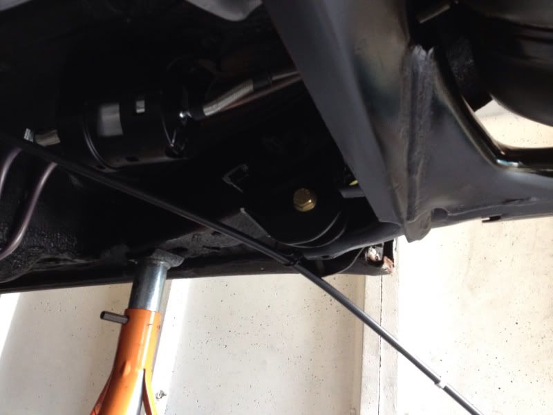

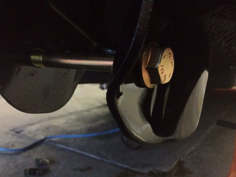

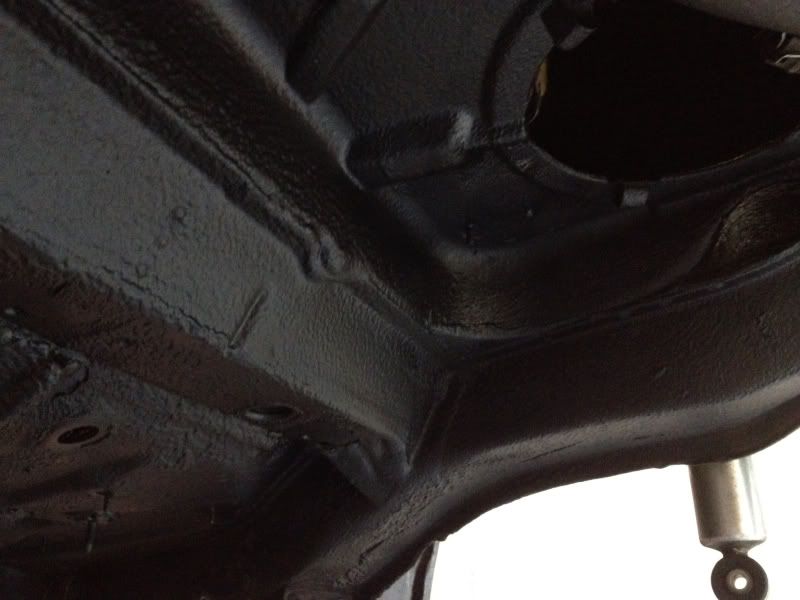

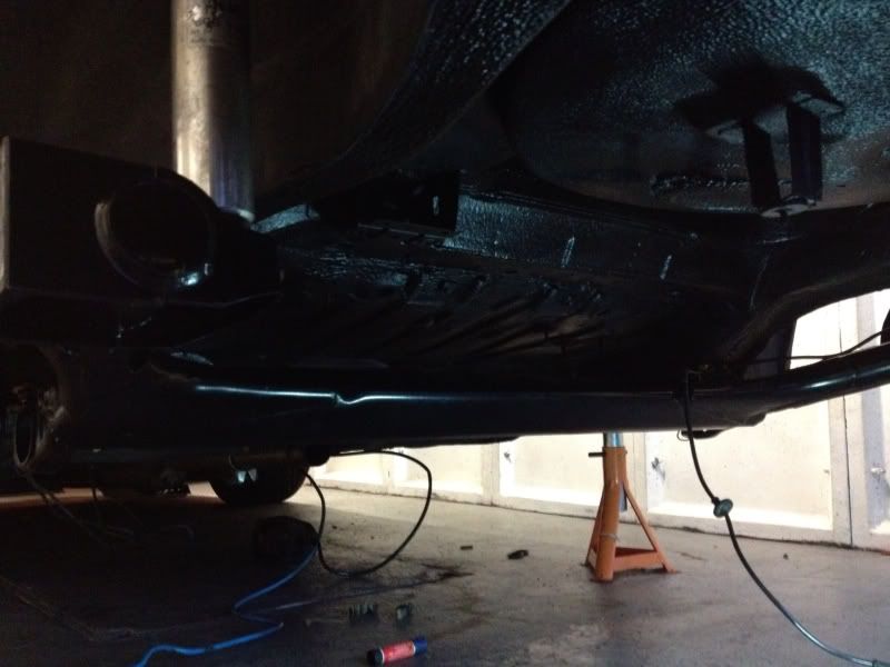

Overmind 10 Posted June 5, 2012 Small update. I have had another load of fastenings plated, these are all original, just cleaned, blasted and replated. I have removed the front to rear brake lines completely, both fuel lines and the exhaust from the manifold backwards (found a broken wire to the lambda which I will need to repair at a later date.) The rear floor pan section is now fully sealed and I am happy with the finish. Freshly plated handbrake cable guides. Offside floor pan stripped, rust repaired and re-sealed Arches sealed and shocks back on The rear beam has been removed again so I can fit the new bushes and then it will be refitted and I can build it back up. Quote Share this post Link to post Share on other sites

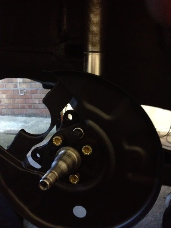

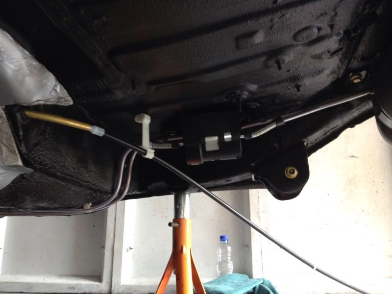

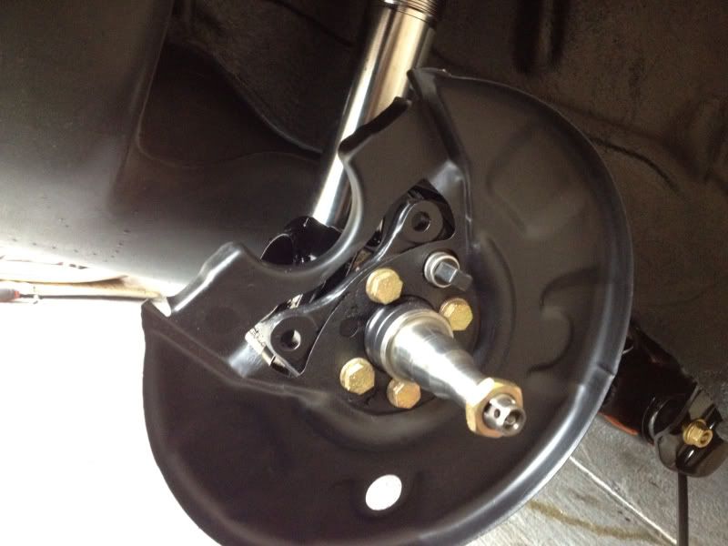

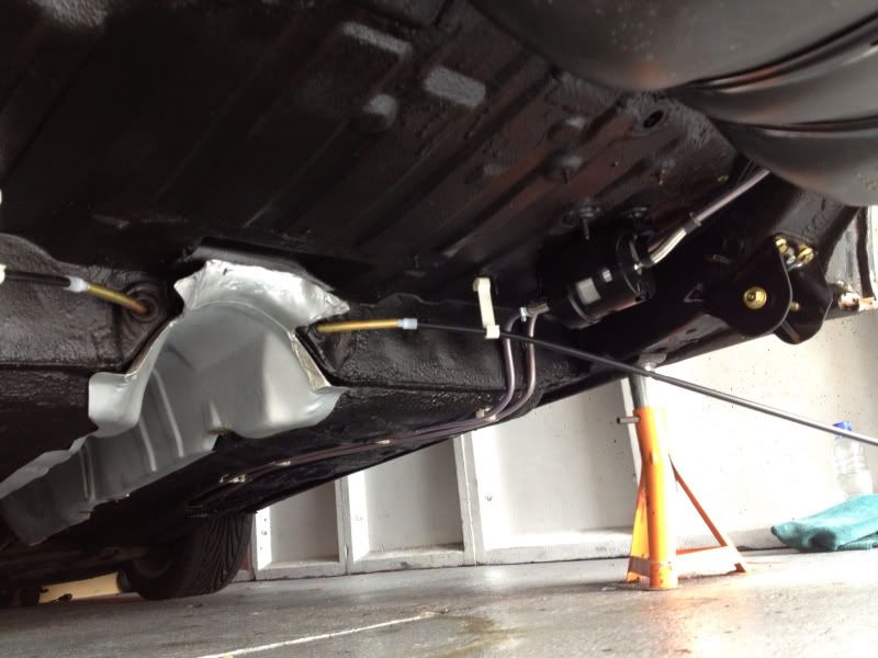

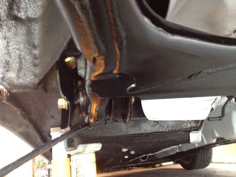

Overmind 10 Posted June 22, 2012 Won't be long mark, I will finish prepping your rear beam next week. Give me a shout when you are ready to do the other bits. Update time. New fuel lines made up and fitted, there's a few small bends in the pic which I have now straightened out. Fuel tank back in, just waiting on the proper bolts to come back from the platers And the beam is finally back in! I fitted new genuine rubber bushes which turned out to be a bit of a headache, but it's all worth it to see it back in now :) Also bolted on the rear spindles, I've just got to modify the new spacer ring that sits behind the disc and fit the bearings and the car could go back on its wheels! Next jobs: Modify the rear disc spacer rings Make the solid brake pipes for the rear callipers and mount them with the abs wiring on the rear beam. Fit the heat shields for good once the new clips come back from plating Fit the rear bearings to the new discs and fit to the car Fit the rear callipers and adjust the handbrake. Quote Share this post Link to post Share on other sites

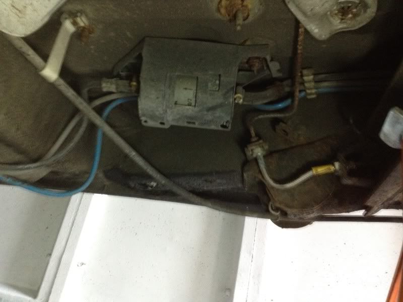

iR6 0 Posted June 22, 2012 Really looks like an amazing job, fair play :thumbleft: Have you replaced everything, or are some parts cleaned up, such as the white brake cable clip and the filter housing? Quote Share this post Link to post Share on other sites
Overmind 10 Posted June 22, 2012 Thanks mate :) Most of the parts have been cleaned up, the brake pipe clips have just been sand blasted to remove the yellow staining and grime, they were perfectly reusable so I didn't see the point in buying new ones, same with the fuel filter housing. Quote Share this post Link to post Share on other sites

ChrisL 20 Posted June 22, 2012 Thanks mate :) Most of the parts have been cleaned up, the brake pipe clips have just been sand blasted to remove the yellow staining and grime, they were perfectly reusable so I didn't see the point in buying new ones, same with the fuel filter housing. Wow!! those plated bolts are fantastic (i'm easily pleased) and really stand out against the black. so have you sand blasted the plastic cover that goes round the fuel filter? what is the blue pipe and are you putting it back? Have you got any new clips for the metal brake pipes on the beam? Cant wait to get mine done, had the beam shot blasted and collected parts but not gone any further yet. Quote Share this post Link to post Share on other sites
