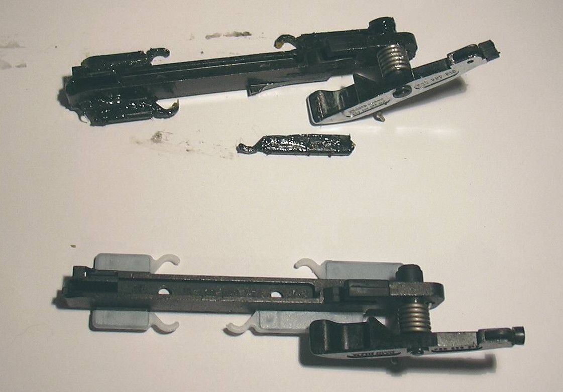

swiftkid 1 Posted February 19, 2012 Hey, I'm hoping someone has a knackered sunroof just kicking about that I can pilfer parts from. I need the mechanism from the passenger side of the sunroof (the actual slider bits) from a late spec sunroof. Alternatively, if someone has a full late spec sunroof near to Hull for not a lot of money I could be interested, don't need the motor, just the sunroof. Cheers, Dave Quote Share this post Link to post Share on other sites

swiftkid 1 Posted February 19, 2012 dunno, what are you thinking? At the moment I'm trying to figure out what is causing the problem and I think I've narrowed it down to the slider. Quote Share this post Link to post Share on other sites

nrc 0 Posted February 26, 2012 I need the same part as Swiftkid (I think) - the cable guide on the passenger side. It's the bit that's snapped in the picture. Can anyone help? Ta, Neil Quote Share this post Link to post Share on other sites

swiftkid 1 Posted February 26, 2012 Right I've been lazy and not sorted this out so I need this part (picture I found on google but its passenger side one I need). Stu thanks for the offer but seeing as you have a sunroof that almost works no point taking it to bits, in fact if you let me know what you need I should have it, unless its the bit I need lol Quote Share this post Link to post Share on other sites
mattyattitude 10 Posted February 26, 2012 Well I've had a look at mine there and the parts I assume are the ones in your picture look fine so if you want it it's yours as I don't need it. Quote Share this post Link to post Share on other sites
swiftkid 1 Posted February 26, 2012 That would be great! Just need that part so postage will be pence, let me know how much you want. cheers Quote Share this post Link to post Share on other sites

nrc 0 Posted February 27, 2012 I've found a proper picture of the bit I'm after and it's not the same as what Swiftkid needs. Do you have one of these too? The picture is from a left-hand drive perspective so I need the opposite side! I'm not sure if the cable can be detached. Quote Share this post Link to post Share on other sites
mattyattitude 10 Posted February 27, 2012 I've just stripped mine down and that's the part that's broke on mine NRC the cable doesn't come off unless it's snapped off which is sadly what's happened to both of mine. Quote Share this post Link to post Share on other sites

swiftkid 1 Posted February 27, 2012 I think I'll have that bit NRC, I'll take a picture if I remember tomorrow whilst I'm down at my lockup. Quote Share this post Link to post Share on other sites

mattyattitude 10 Posted February 27, 2012 o yea sorry yea the part you showed me the pic of is fine, i got slightly confused which side is which so im gonna send you both then i know you got the right part, pm your adress and hopefully ill get them sent out tomorrow night Quote Share this post Link to post Share on other sites
fendervg 33 Posted February 28, 2012 Not much point in using old parts for this repair - it will only break again - you can still get everything from VAG, and they do a reasonably prices repair kit that comes with both cables and guides. Once this is fitted, make sure you keep it well lubed with the proper stuff! The hardest part is getting the sunroof cassette out and back in. Quote Share this post Link to post Share on other sites
