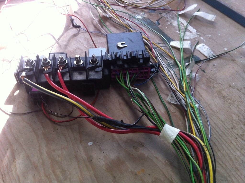

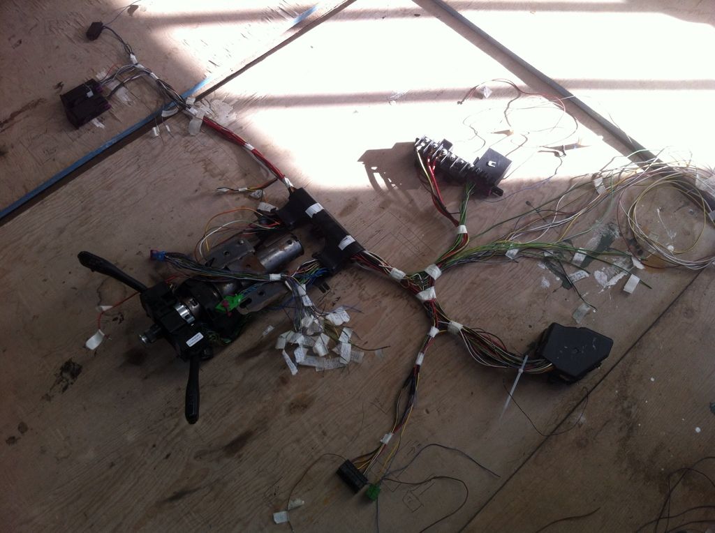

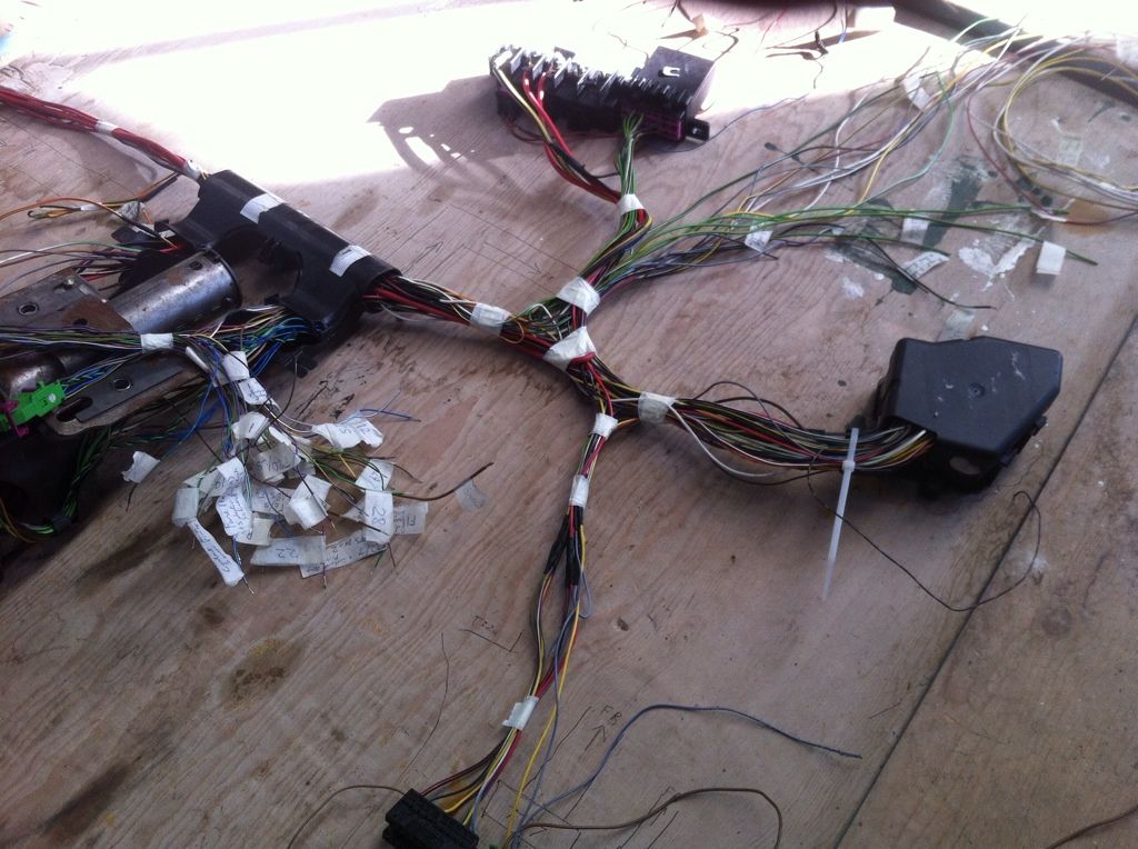

Wiring is a bit of a headache. Need to really sit down and get it sorted soon but the cabin to engine bay looms are nearly all done. Next will be the mounting of the mk4 fuse box and relay plate and i'll try and suss out each switch that's left. Working on the clock wiring at the minute too.
I got the ABS controller tidied up and a few bits braided last night and I now have all the looms set where I need them to be.
I've got a bit mixed up with a couple of plugs from the fuse box so I need to go over a few diagrams again but it sjould be easy enough to sort out as I think it's just the horn, and washer bottle and stuff that I need to plug in.
All the braided looms now come in from the passengers A pillar, run along below the cross member, behind the center dash vent adapter and will run through a plastic conduit bracket on top of the steering column and go over the top of the fuse box and plug in as normal. The dash switches and clocks etc will have a slightly more seperated loom but will run along the top of the steering column with the rest of them and down into the corrado fuse box and part will go to the MK4 fuse box.

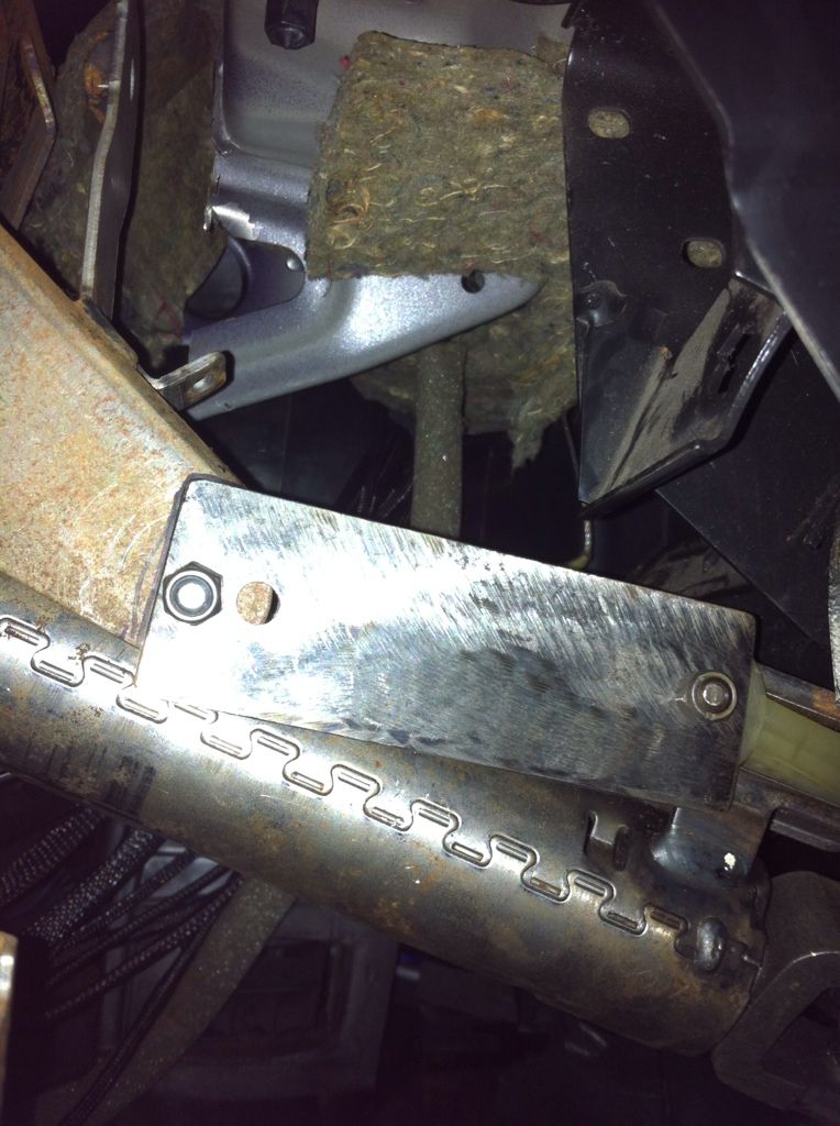

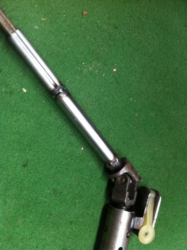

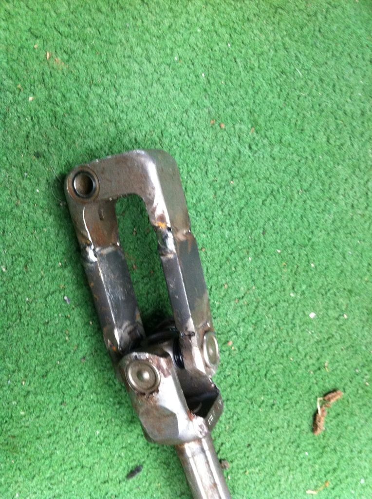

Steering column took a bit of work but it's getting there.
By using the original MK4 mounting points I had to add some length to the main shaft to reach the firewall and a wee bit extra to the joint at the end so it reached down to the rack.
6" extra on the main shaft. 40mm on the joint.

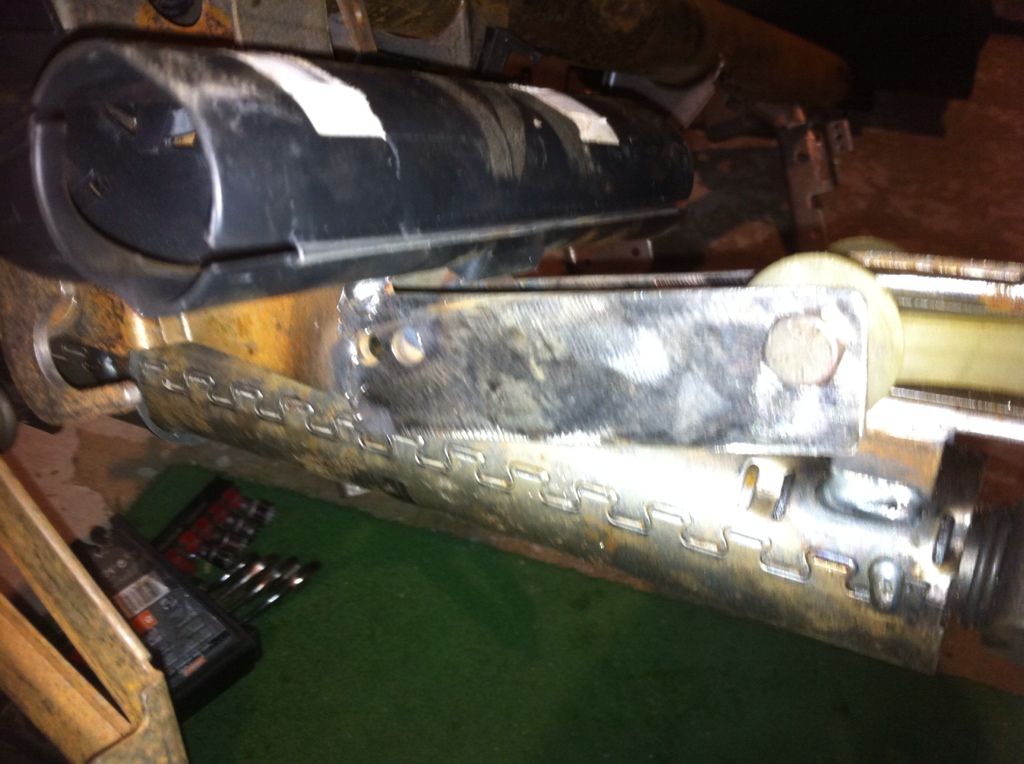

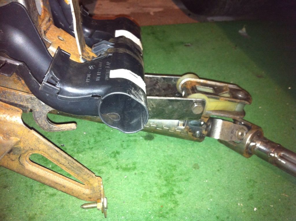

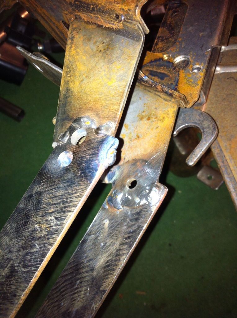

When This was test fitted the shaft was too low at the end and the joint was binding because of the tight angle meaning the steering could only move a few mm. To sort this out I had to move the back mounting point of the column. Here's a couple of metal strips I used to mock up the fitment. I'll weld proper bars on when it's ready to mount properly. You can see how far forward and how far up it moves the angle.

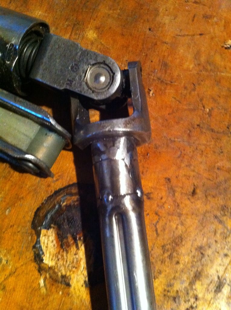

To make this meet at the end properly I had to shorten the shaft extension as well and after a couple of test fits and rewelds I ended up being able to get away with a small 1" extension. It's just tacked in this pic for test fitting.

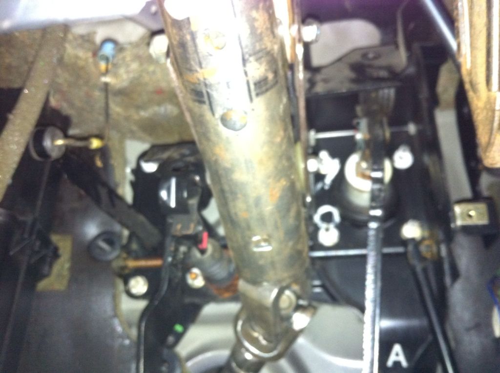

Decent amount of clearance (or just enough).
The first couple of pics of the column is my mates welding. He just tacked them together after he cut the metal for them. The bit with the smaller piece is my welding as I was cutting and refitting to test to make sure everything was where it should be.

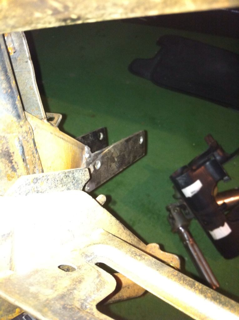

I got a couple more bits fitted last night. I took the dash back out and removed the crossmember. I welded on the 2 brackets for holding the steering column rear mount further forward. It's a bit agricultural but it's structural so I just made sure it was on without warping it too much. I think I'll send the whole cross member to get blasted now just to tidy it up a bit to blow off the surface rust. I'm sending the subframe and control arms etc all to get powdercoated anyway.

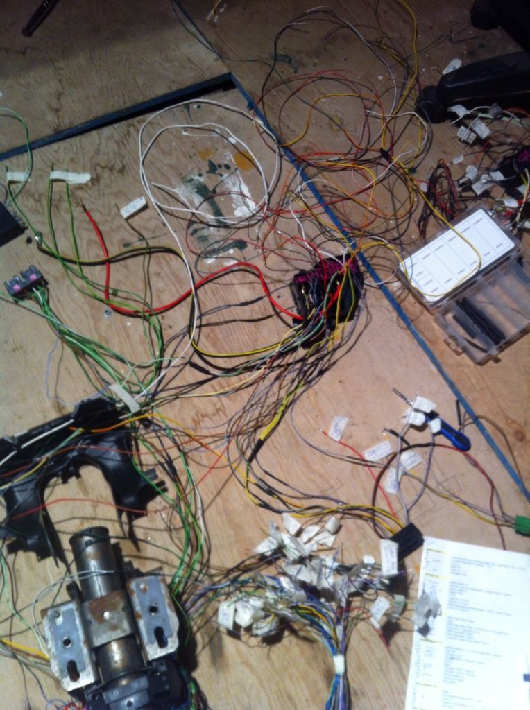

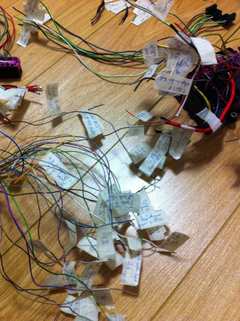

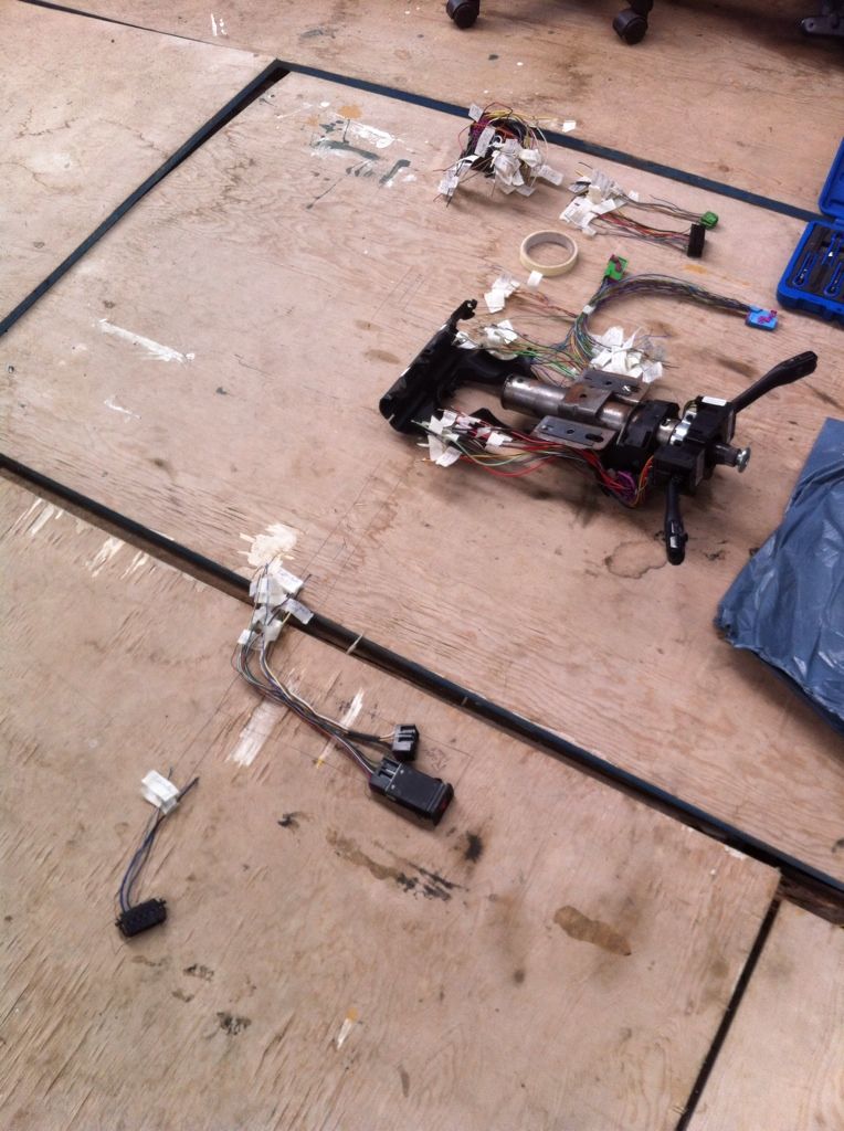

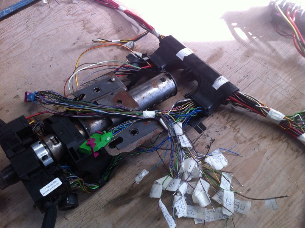

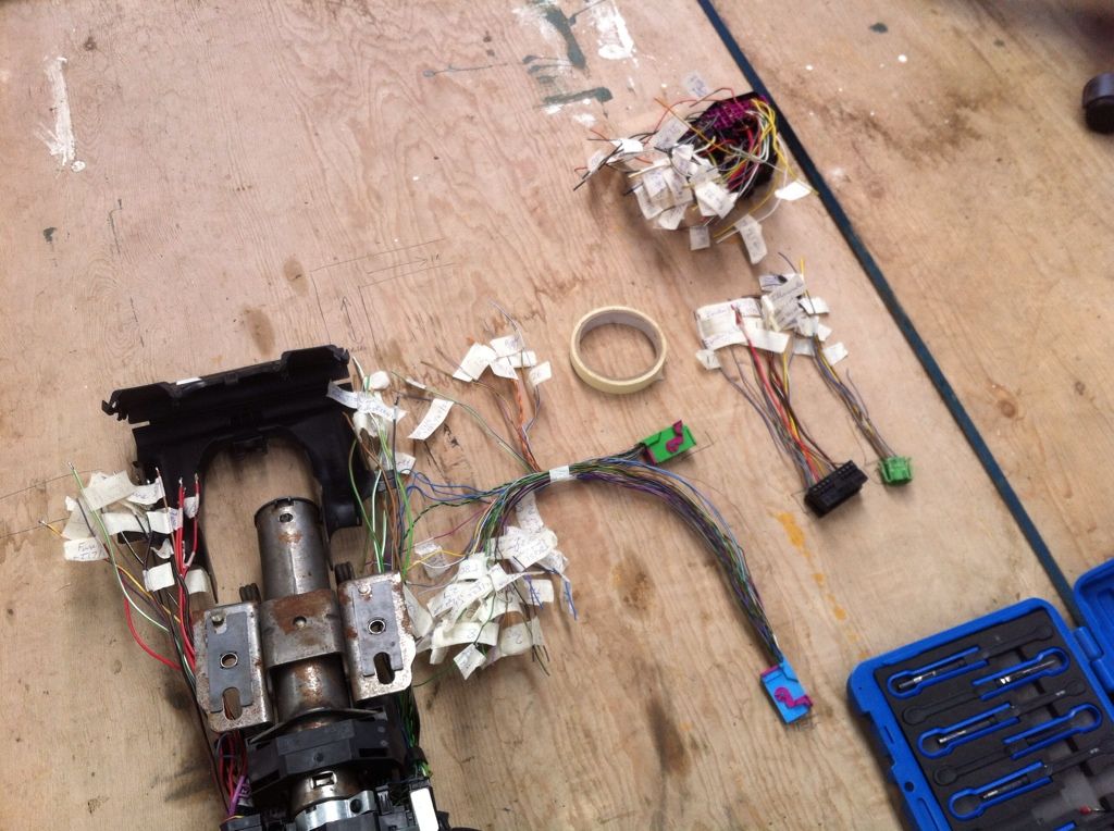

I've also started labelling up all the wiring for the dash instruments and switches again. Need to really get my head round it this time. I'll be using a spare MK4 fusebox as well as the corrado one. The MK4 one fits in nice and slick and tidy and stays out of the way. I might even swap over some stuff from the corrado box over at some stage.

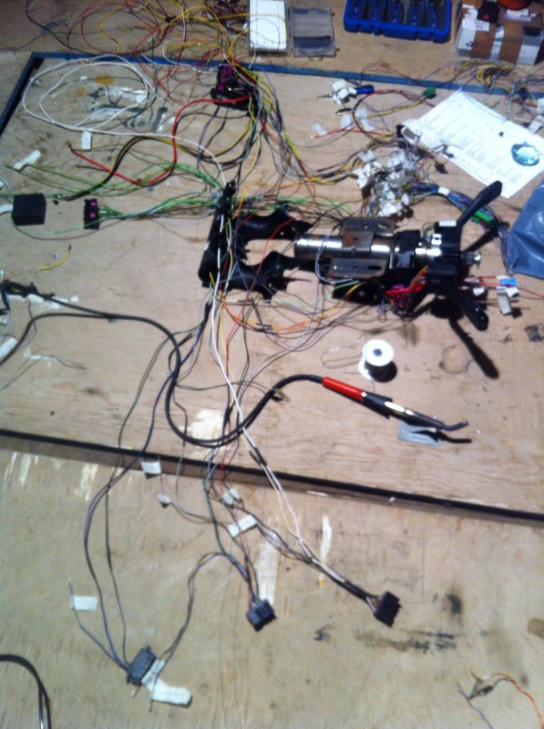

OK so all the switches and column laid our where they should be looks a bit like this below. I'll post up the full lists later hopefully of what each pin goes to on a standard MK4 setup.
Tonight I'll be filling in the gaps for all the wiring to and from the fuse box and steering column. I still need to seperate what will be left after that and i'll make up a loom to suit all those connections. I don't think there's anything major that I've missed but i'll fill in the last few connectors as I get to them.

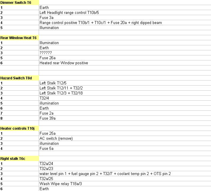

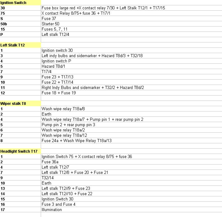

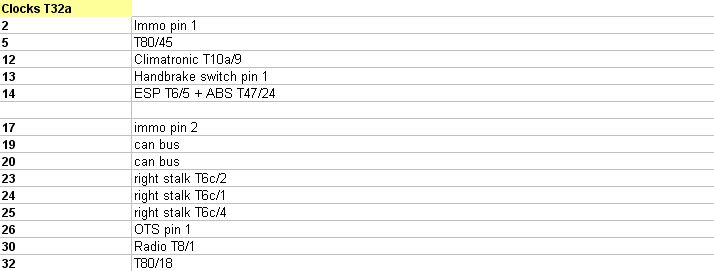

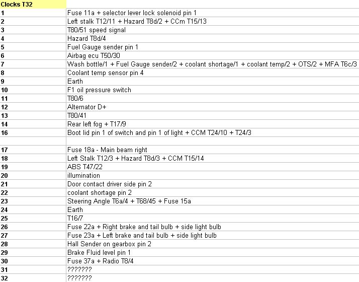

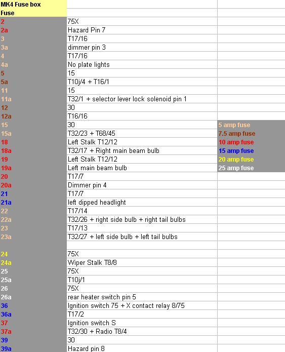

These are the standard MK4 pin and wire positions for all the switches and clocks. Obviously I still need to work out what is left to connect to the Corrado wiring system for the actual swap but having the MK4 list is a good start.

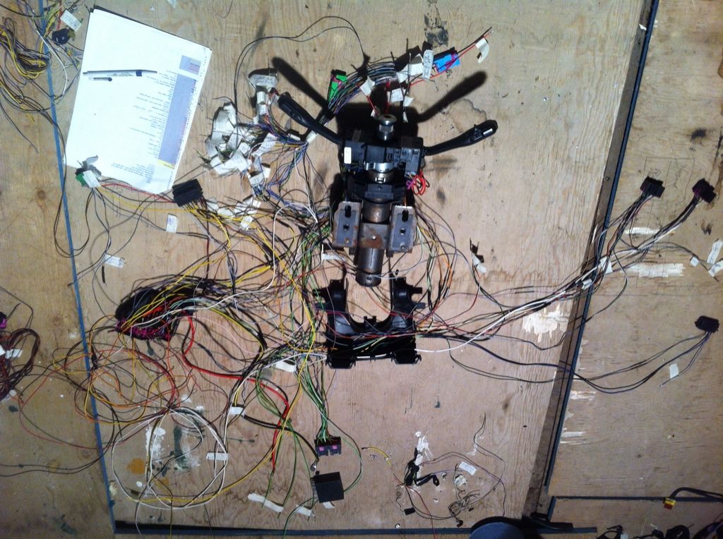

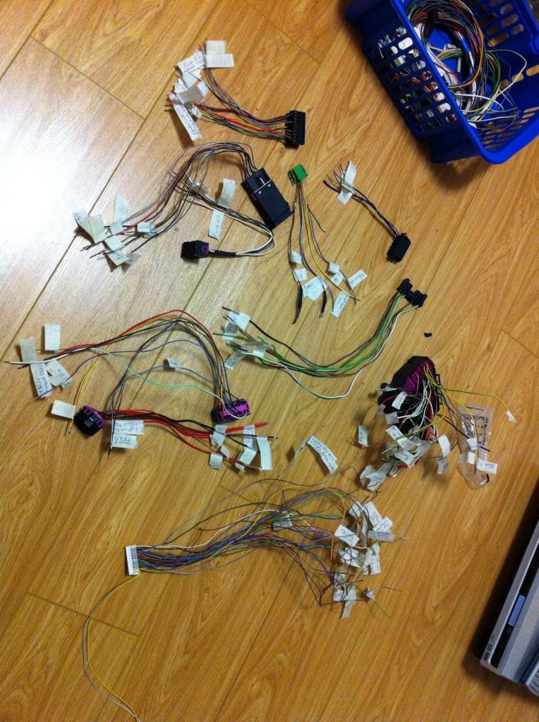

ok so here we are after a good few hours more put into the wiring mess. I will update the images above with all the new info as soon as I get a chance but for now I'm just trying to get the basics all finished. I only really have the illumination and the earths to wire up and then a load of the wires from the T32 and T32a connectors for the clocks, and a couple of other strays. I have 2 or 3 more connectors to add to the list that I forgot about but they'll be easy to add in.
During:
And as it sits now.

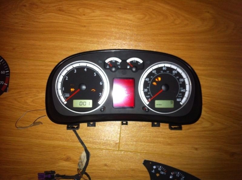

ok so all the plans I had of doing work tonight went out the window. Got my clocks back and put them together and tested. LCD is sorted.
allsortsuk2009 from ebay - Thanks very much, did a great job. Supplied and fitted the lcd for just over £70. It was something I could have done without but money well spent to get the clocks sorted.

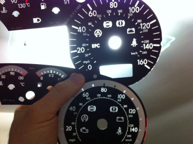

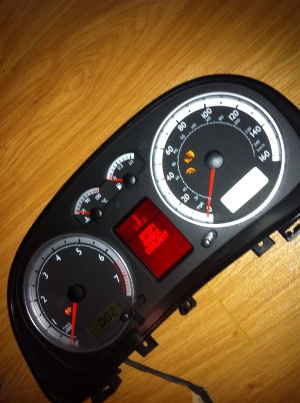

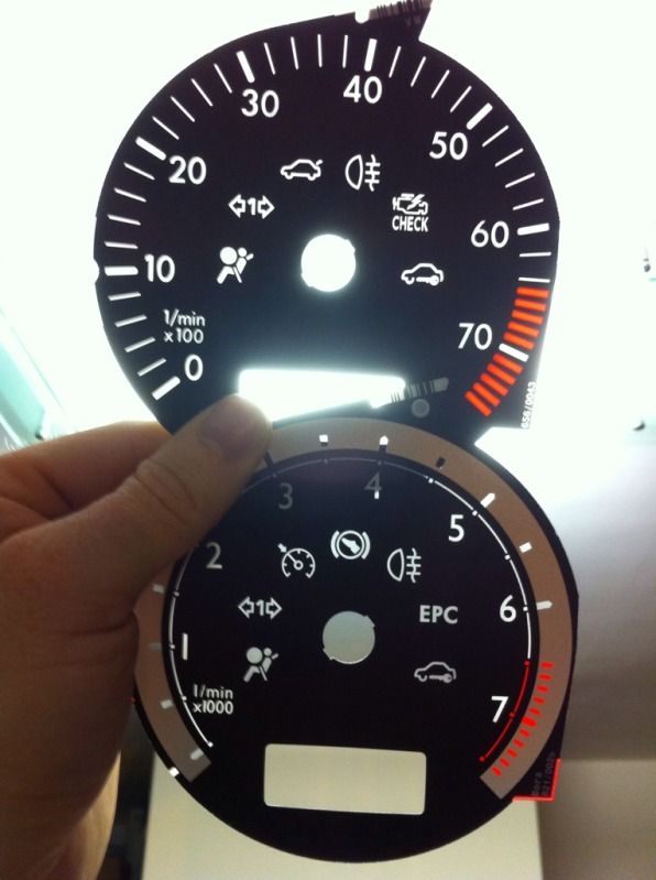

One thing I want to do with them is to turn them into the sport clocks. As these are a really rare set of clocks anyway it wasn't going to be straight forward. Here's a few pics why. Have a look at the icon alignment. Sorry but these pics are really crap. I may need to have a dig around and see if I have any cluster foils that'll fit straight in there. If not it's no big deal but would have been nice to have the sport style foils. As long as the clocks are working again I'm happy enough.
Original on top and Immo 2 bora sport clocks on the bottom.

I have an idea about modifying those foils to fit as well if I can't find anything to fit.
Looking really good, my mate has a set of sports clocks from the V5 Bora which I nicked the climatronic out of, I don't know if they're the sports clocks you're referring to but he's probably selling them
The problem is the rarity of the non can FIS clocks I've got there. It's the only set i've ever seen. A couple of mates who work with vws every day said they didn't think they existed. I need to find foils that match the LED and icon pattern of them. I have a few spares so I just need to sort through them and see if anything is the same.

Problem is i'd need to see them switched on to see where the icons are. I've done a lot of sport clocks, trip computers, cruise control installs etc for people so the clocks and parts have just gathered up. I need to sort them out and sell what I don't need.
