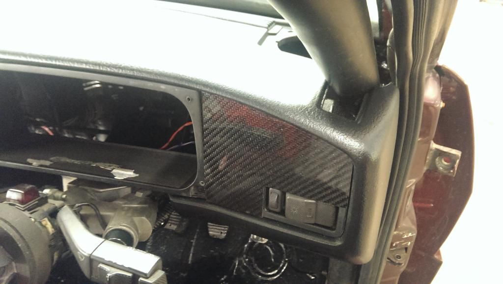

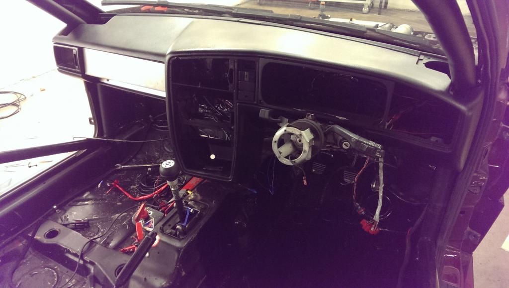

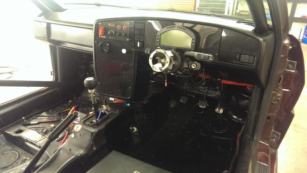

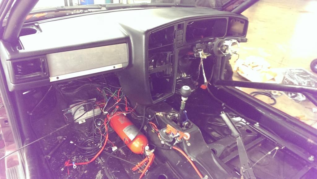

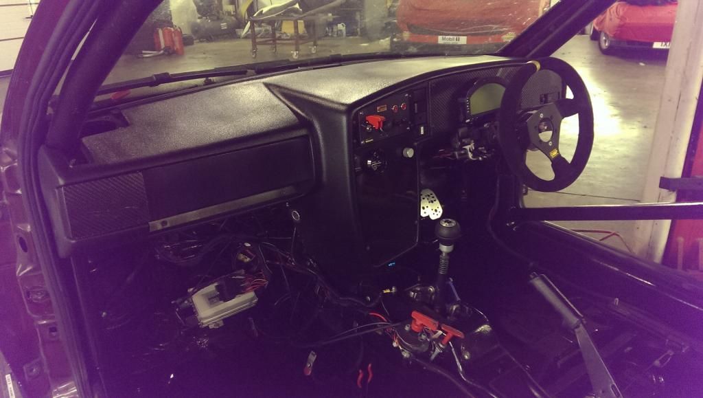

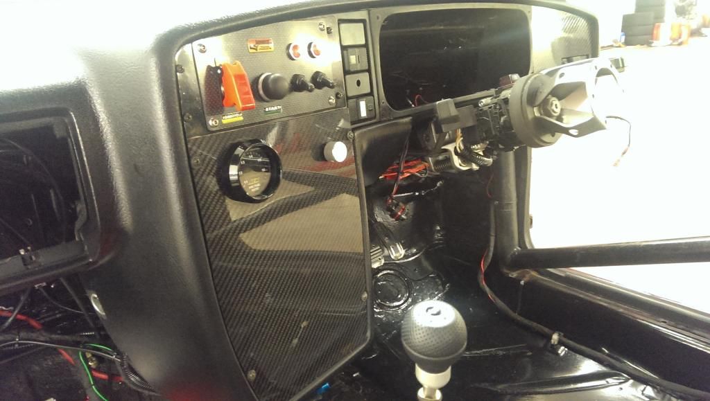

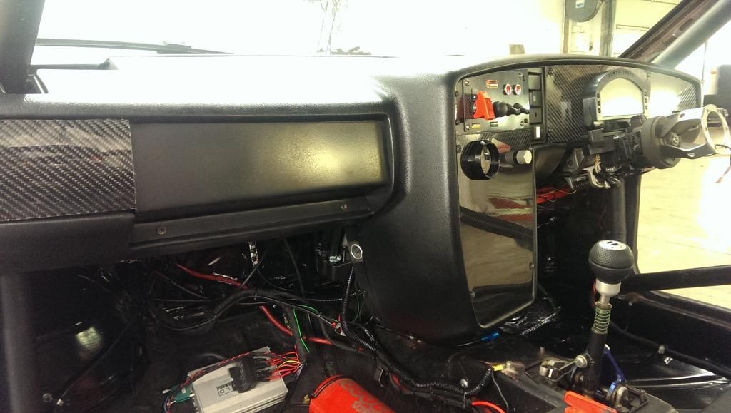

HummuH 10 Posted November 11, 2014 Not much to report as progress is slow even though there's been many hours spent on it! After installing the new heater set-up, next job was to do some painting of the interior and then to a tidy up of the wiring in behind the dash. Once that was complete, we got the butchered and painted dash back in: Then I spent far too long cutting carbon fibre to fill the blanks now left in the dash. For ease, we decided to keep some of the original switches: I can now plough on and finish off the rest of the interior painting and general tidy up. Should hopefully be finished with the internals later this week so will update further after that. At that stage, we can weigh it again and see how much weight has been saved from the dash butchering and new heater installation. Quote Share this post Link to post Share on other sites

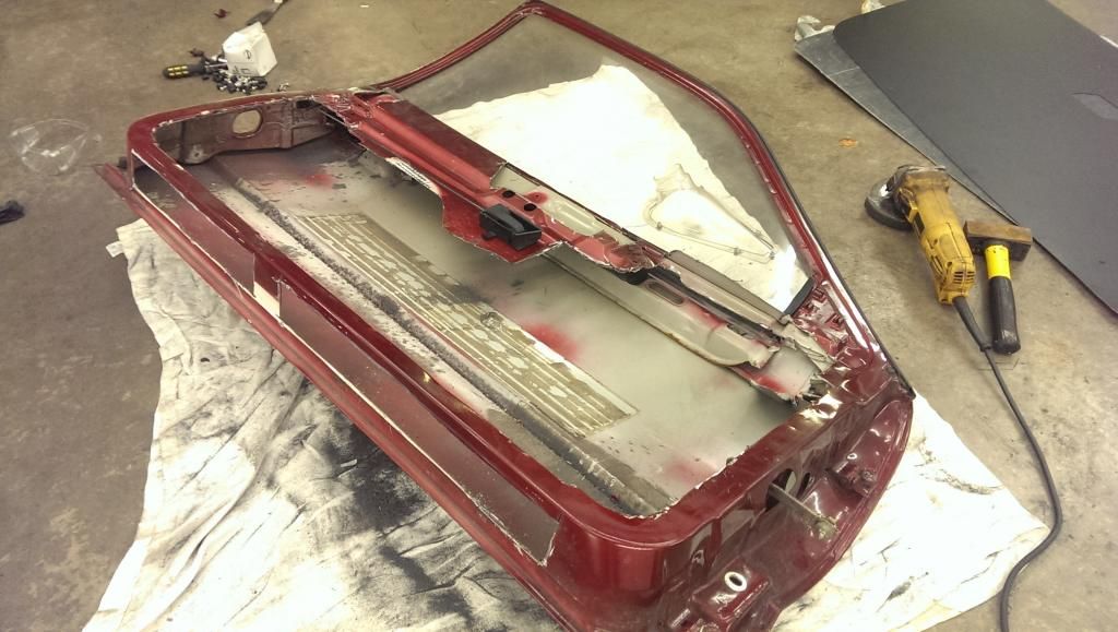

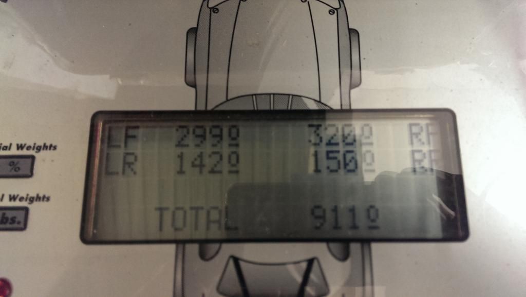

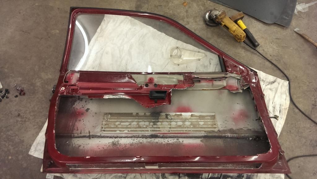

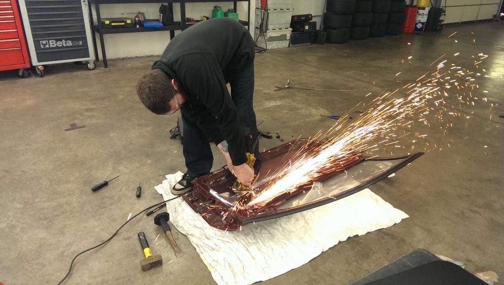

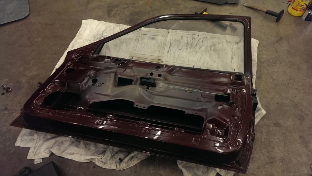

HummuH 10 Posted November 13, 2014 OK, starting to see some actual progress. Now the interior is almost done (for this year anyway) we could start to figure out how the weight saving was going. So, up onto the scales to find out how much weight we had saved from removing the heater matrix and chopping up the dash. To be honest, I wasn't expecting much, probably trying to limit expectations more than anything. So, in the same state this is what the car weighed before the matrix/dash work: This is what it weighed after the work: So, 922.5kg down to 911kg, an 11.5kg saving. Have to say, I was delighted with that. To put that into context, at Knockhill I'm told it's generally considered that a 10kg loss equates to 0.1 sec gain in lap time, in theory of course. A big hill to pull yourself up and heavy braking zones mean weight is critical to a good lap time. Might sound irrelevant but when your competing against folk who are consistently 0.2 to 0.3 secs a lap quicker it starts to make a difference over the course of a 12 to 15 lap race. Anyway, now that we had seen some "achievement" from our graft, we could start on other aspects of the weight loss. The doors were getting it. The weighed in at a massive 22kg and 23kg when we removed them, still can't figure out why one door is 1kg heavier than the other but hey ho. So this is what an unmolested (almost) door looks like: So, Scotty got all excited and unleashed the angle grinder. After being deafened for a couple of hours, this is what we were left with: Two doors butchered. I will smooth the cuts out and got some nice door cards to install from LWS Design. On initial weighing, we've cut 6.5kg out of each door so roughly 13kg saving across both doors. So, in the initial phase we've saved 24.5kg already. Other items that will further reduce weight and guestimated saving: GRP bonnet: 10kg GRP tailgate: 8kg Race battery: 4kg Bumper reinforcement: 2kg Conservative estimates I hope but we'll see. A couple of other random pics of the newly tarted interior, sorry for sharty quality, the workshop lights are a nightmare: Quote Share this post Link to post Share on other sites

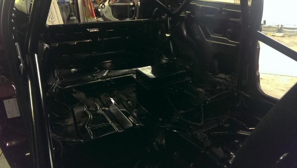

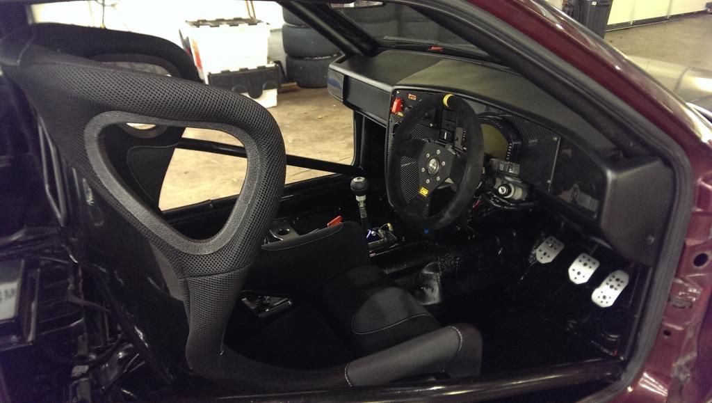

HummuH 10 Posted November 18, 2014 Interior pretty much done now, new seat and a few other bits and bobs back in. Just need to install something to protect ECU from passenger feet and that should be it for the inside. Quote Share this post Link to post Share on other sites
