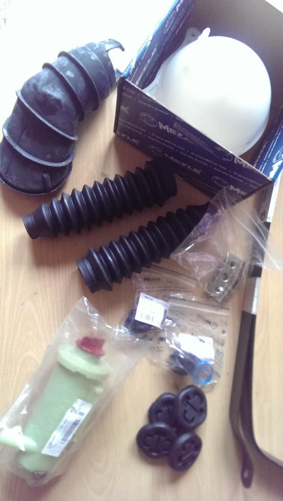

HummuH 10 Posted September 26, 2014 And so it begins.... First of about 20 packages has arrived, this one from VW Heritage. I'm like a kid in a sweety shop. This is how she currently sits: Major overhaul this winter. Wanted to get a year under my belt with the new engine before thinking about going bonkers. JabbaSport have built a truly awesome unit so not too much fannying about required under the bonnet. Summary of winter 2014 plans: * Body - fit Berg Cup arches, LWS GRP bonnet, custom side skirts, new front splitter and rear diffuser to be fabricated and installed. Remove sunroof and re-skin. * Full respray - L041 Black. * Weight loss - delete heater matrix/blower, trim loom, butcher doors, remove any internal/underside non-structural metal etc. * Internal - full paint job inc. cage, new switch panels, fit LWS GRP door panels, install new seat. * Front end - lower 10mm to 15mm, fit SCCH ball joint and Track Rod assemblies. Full hub and wishbone refurbishment. New drive shafts, bearings and CV's. New gaiters on everything. * Rear end - lower 10mm to 15mm, refurbish rear beam. * Brakes - Install new front AP Racing kit (4 pot - 305mm/330mm, AP Racing brake bias unit, new lines throughout. * Gearbox - install longer 2nd gear. * Wheels - Pro Race 1.2 17x8, 4x100, ET20 running 235/40/17 Kumho V70. * Setup - corner weight. * Engine - JabbaSport health check, install push-to-pass button. Last race is 5th October and can't wait to get cracking ASAP after that. Will do my best to keep updated with progress. Quote Share this post Link to post Share on other sites

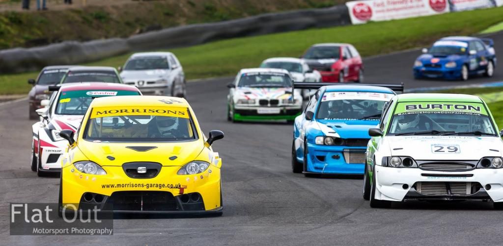

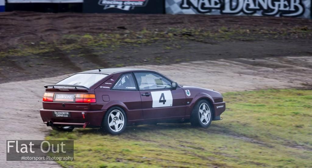

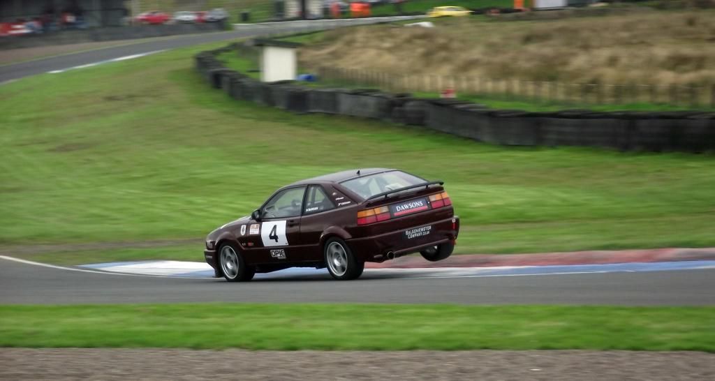

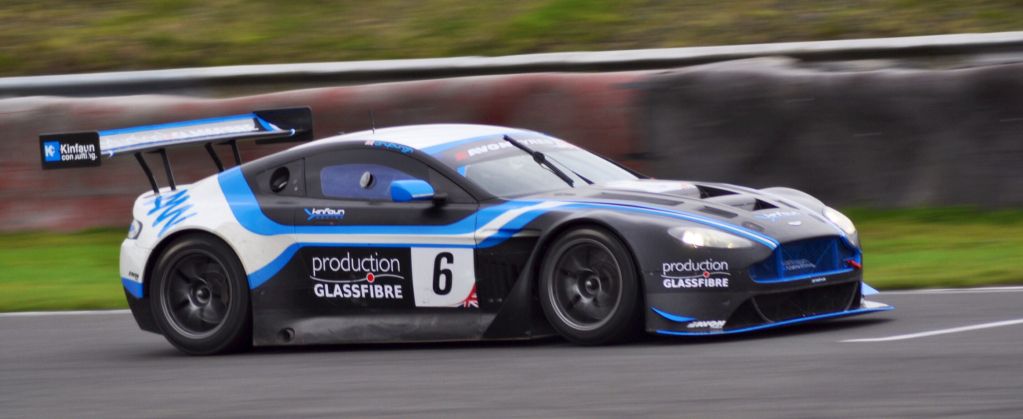

HummuH 10 Posted October 6, 2014 Was the last race meeting for us in the Scottish Sports & Saloons and the season finished with an awesome finale. Managed to bag two Class wins which was not bad at all given the issues we had throughout the weekend. We had some very special cars out with us, see below. The Corrado getting some two wheel air action at the chicane: Battling with another Corrado 20vT. The obligatory woopsie moment: We had a great field out with us, 27 cars lined up on the grid for race 1: Phil Dryburgh's Aston Martin V12 Vantage GT3 car, you cannot begin to imagine the sound this thing made, fully de-restricted: Also, Stewart Whyte brought his Honda Accord BTCC car out to play: Finlay Crocker brought his spanking new Seat Leon Eurocup car along, what a piece of kit this is: Really looking forward to getting to grips with the car over the winter and coming out lighter and faster next season. Quote Share this post Link to post Share on other sites

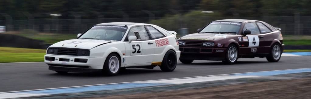

HummuH 10 Posted October 7, 2014 Race 1 - Knockhill October - Corrado v's Corrado On the grid knowing I had a bent drive shaft and worn CV's, gulp, whole car was vibrating. Went easy on the start, paid the price, lost places to a BMW M3, a Subaru Impreza and Chris in the other Corrado 20vT shot off into the distance. Got it together and had passed the Impreza and M3 by end of 1st lap. Closed in on the other Corrado and although he was out gunning me in a straight line, got past after a couple of laps. Went on to take Class win. Wheel fell off returning to paddock. Oops. https://www.youtube.com/watch?v=IryIr8ORBRo=24 Quote Share this post Link to post Share on other sites

Hairyarse 10 Posted October 7, 2014 Great video and nice driving ;) That was a great tussle with the other C in race 1, nicely passed too. Did you have other cars up your chuff when you were trying to pass him? Shame about the wheel but at least it didn't happen during the race! Quote Share this post Link to post Share on other sites

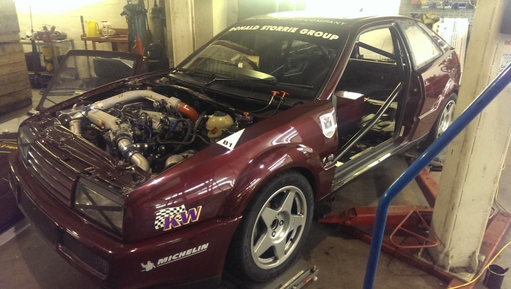

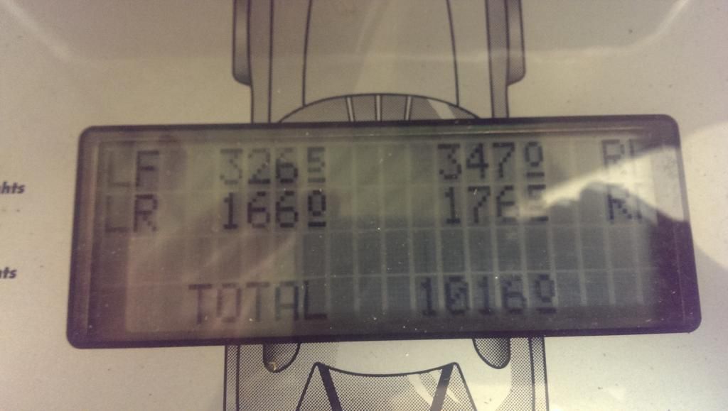

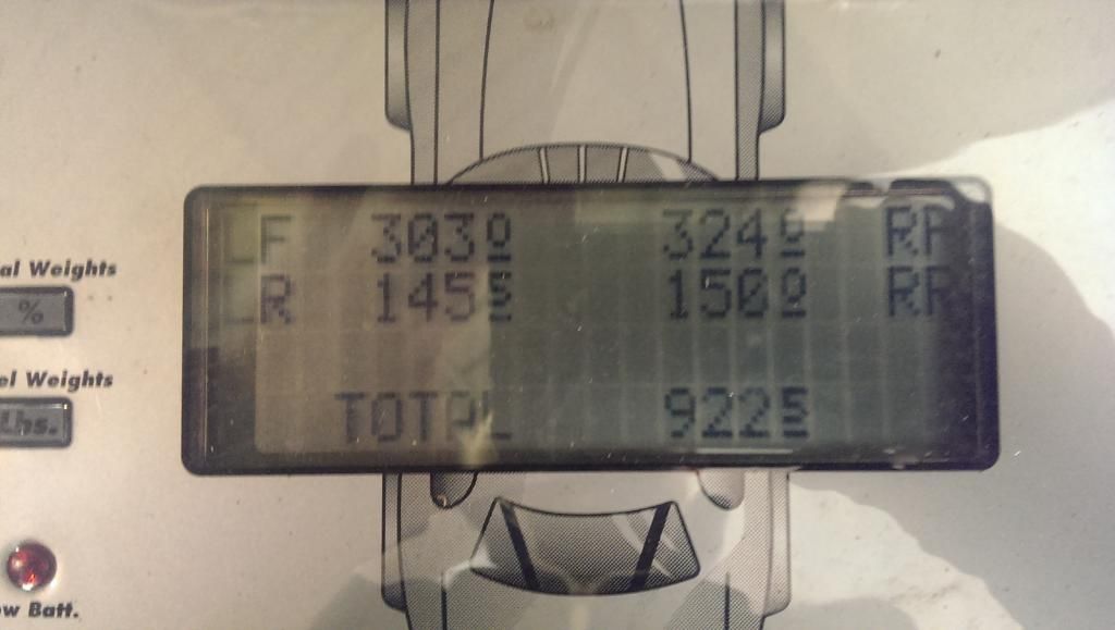

HummuH 10 Posted October 15, 2014 Ok, started the winter strip last night. First thing to do was put the old girl on to the scales: So, 1016kg with about 15l of fuel in there so as I thought, prob bang on a tonne dry. That's roughly a 66:34 F/R split, would ideally like to have that down to roughly 60:40 with corner weighting to tweak. So, in preparation for various bits arriving we started removing bits from the car that we knew were heavy to get an idea of what each component weighed. By the end of the night, this is what the scales were saying: 922.5kg. Bits removed were: Bonnet: 13.5kg (was already partially butchered - 14.5kg with hinges, bolts washers etc) Tailgate: 17.5kg (with Lexan) Pass Door: 22kg (with Lexan) Drivers door: 23kg (with Lexan) Seat and Mounts: 15kg The doors were the biggest surprise, can't believe how heavy they were but quite a bit to butcher so can hopefully get them down a bit. Next step is the heater matrix and all other useless gubbins behind dash before the interior gets a tart up. Hoping that will cut c. 10kg but will see when complete. Gonna be a busy winter :) Please excuse the sharty pictures, lighting wasn't helping! Quote Share this post Link to post Share on other sites
coullstar 0 Posted October 15, 2014 Lol yeah they parts are heavy old beasts. I couldnt believe how much a door was either until I tried to pick one up. GRP bonnet, doors and tailgate are they way to go. Annoying thing as you will know is suspension will need dialled in again after that weight removal. Quote Share this post Link to post Share on other sites
HummuH 10 Posted October 16, 2014 Lol yeah they parts are heavy old beasts. I couldnt believe how much a door was either until I tried to pick one up. GRP bonnet, doors and tailgate are they way to go. Annoying thing as you will know is suspension will need dialled in again after that weight removal. Can't do doors unfortunately but if I could I would. Roof skin and bumpers would be done as well, bit of weight there too. Think you can get them down to around 910kg with all the bits done, maybe less if you go full carbon. Quote Share this post Link to post Share on other sites

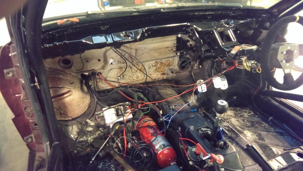

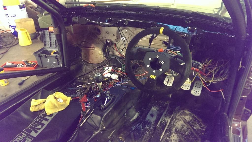

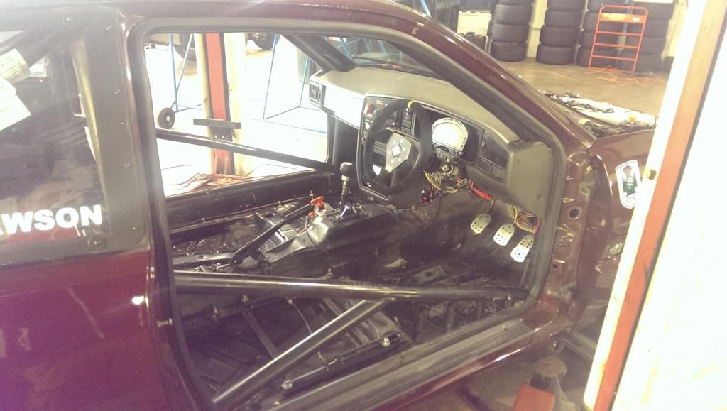

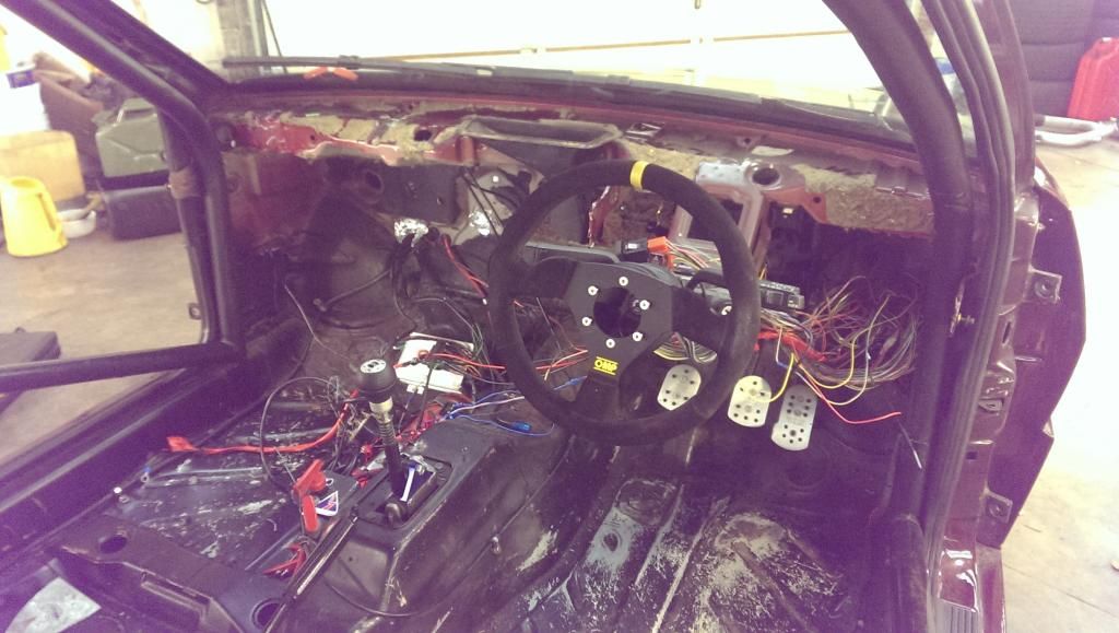

HummuH 10 Posted October 29, 2014 So, with the nights drawing in I thought we'd make a start on the hard stuff. First task I wanted to tackle was removing the heater matrix, blower, fan controls etc. So, dash was coming out. Having a full cage didn't help but we got it out and were presented with the usual array of nightmares lurking behind. After we had removed the matrix and pulled off as much of the foamy insulation sound deadening type stuff this is what we were left with: Mmmmm, nice. So, I got some tunes on and set about the worst job ever. The heat gun and I were now good friends. Foamy stuff gone, bitumen sound deadening gone, quick lick of paint and just the glue to remove, which would prove to be the most annoying part of the job. With the heater matrix gone, I was left with the problem of how to de-mist the windscreen. I wanted to keep that function but ditch the weight of the full matrix. I found a very neat solution from T7 Design which was basically a radiator and high flow fan that you would normally find in a PC, with 2.5" outlet mounted to a bracket to allow fixing to the bulkhead. When we removed the matrix, we had to fabricate an aluminium panel to fill the hole in the bulkhead and to also fix the step down coolant pipe fitting, again, T7 Design provided that solution: Looking at the fan, I was a bit dubious about the volume of airflow so we hooked it all up, fired the car up and let it get up to running temp. After a few mins of putting the system to high pressure to check for leaks all was good so we fired up the fan. Really impressed with the output. We retained the OEM dash windscreen vent ducting and sealed a length of 2.5" duct into it. I would guess the airflow would be comparable to somewhere between setting 3 and 4 on the OEM Corrado set up but obviously only blows hot air. Quite a neat and very light solution: Next step is to lighten dash, paint and reinstall. We will find out at that stage exactly how much weight we have saved by doing this. Quote Share this post Link to post Share on other sites
