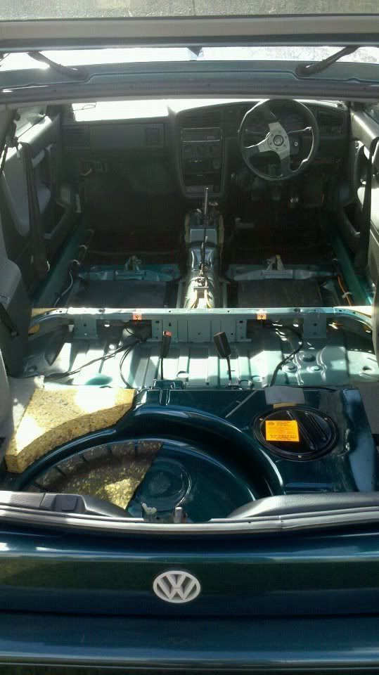

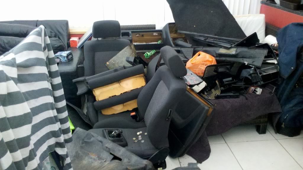

The interior was looking rather dirty though so that was the first job, pull the interior out to give it a damn good clean:
And loads of change under the carpet:
I put all the carpet in my conservatory ready to steam clean and shampoo them, the misses wasnt too happy:

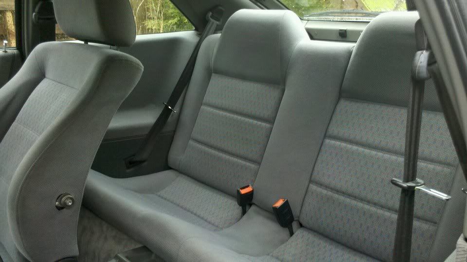

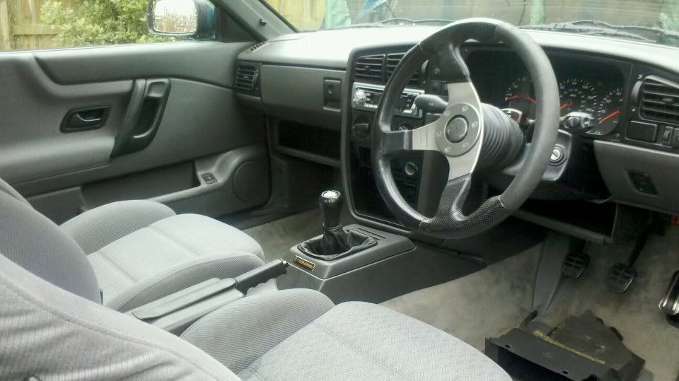

A few more pics with the interior back in after its deeeeep clean:
Sorry about the dodgy pictures, it was raining and I had rain on the cameraphone lens!! This was also the first time the car had been in the rain for 3 years so i thought i'd check for any leaks half way through the day! Unfortunatly the sunroof is leaking like a sieve!! And the water dripping on my newly cleaned interior. Noooooo!
But I know it will be an easy fix, so for now I have put a cover over the roof to prevent any more water getting in.

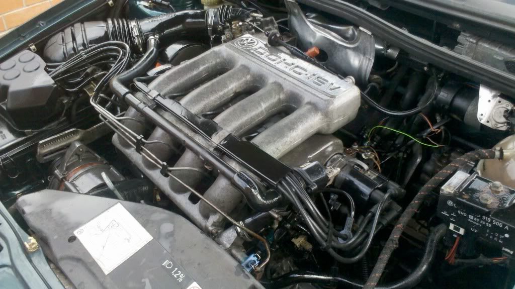

Im also missing the grey parcel shelf if anyone has a spare, and Could anyone tell me what this cable and connector are used for?
The connector was on the block but I removed it prior to the photo, it connects to one of the sensors on the right of the engine block, the cables were completely detached but the engine seems to run fine?
I will upload more pictures in the next few days. :)
There are 2 knock sensors on the front of the block. The blue plug shown is connected to the knock sensor nearest the gearbox. The cable should have a male connector and connect into the blue plug. Youll have a similar arrangement for the other sensor on the front of the block, ie the other side of the distributor.

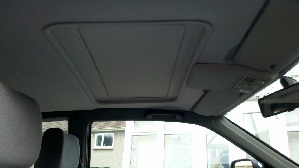

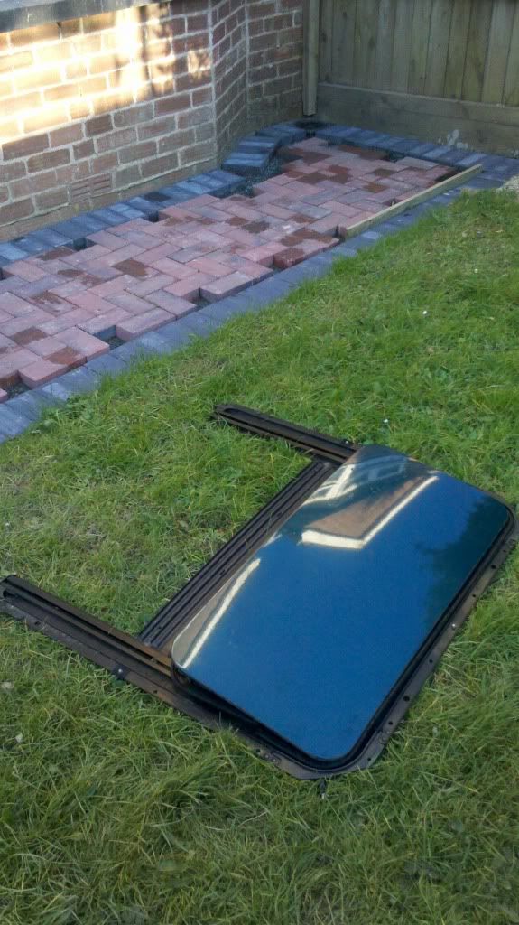

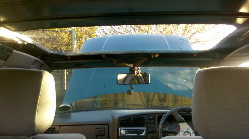

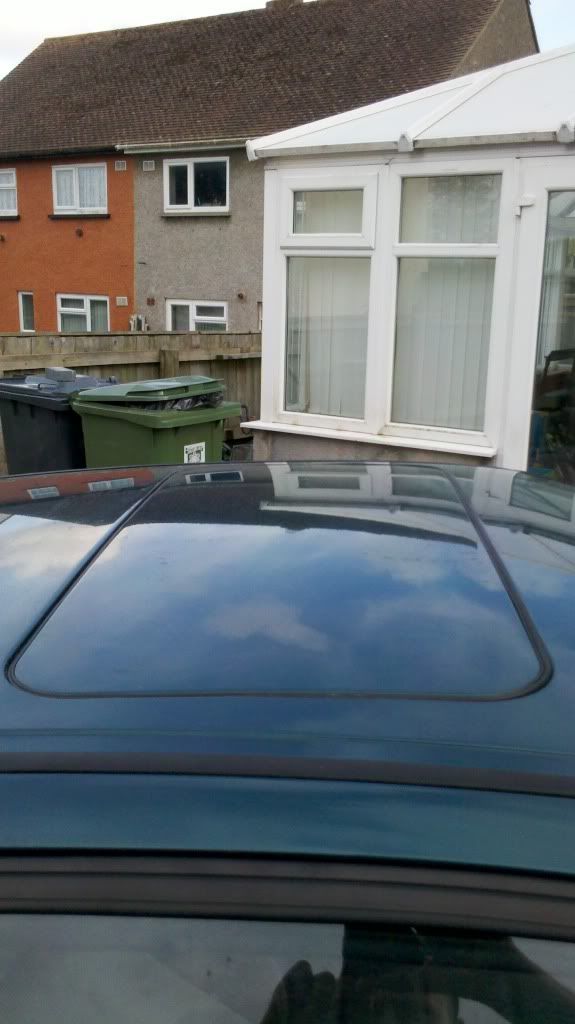

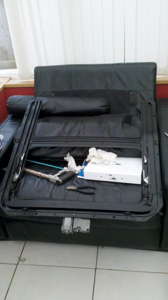

Right thank you for your comments so far. Ive been a busy boy the last day or so and decided to tackle the sunroof as it wasnt sliding back as it should. I was planning on taking the head lining out anyway for cleaning, so I thought it was the perfect time to get the sunroof out also:

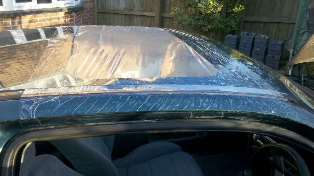

And then i wrapped the roof in carpet protecting film the prevent rain water getting in,as I wasnt sure how long the sunroof would be out of the car:

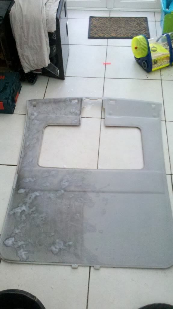

A picture of the head lining half way through cleaning(big difference):

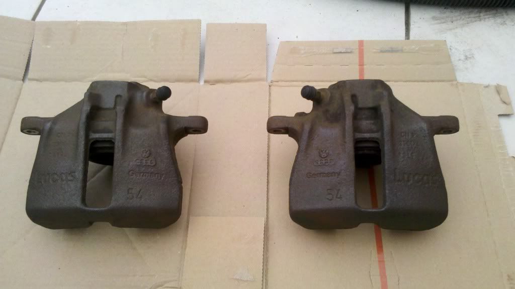

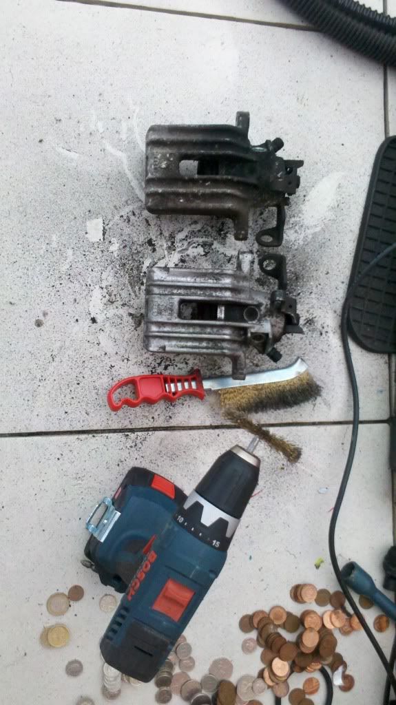

Also started cleaning the MK4 calipers ready for the conversion:

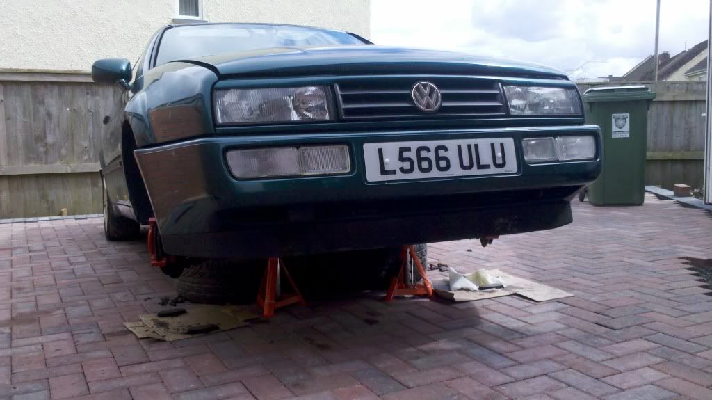

I will be reinstalling the sunroof and headlining today and then the car will be getting put on axle stands, this is for two reasons, one is so it makes it easier to get the brakes done next week and the other is so I can refurbish the wheels.

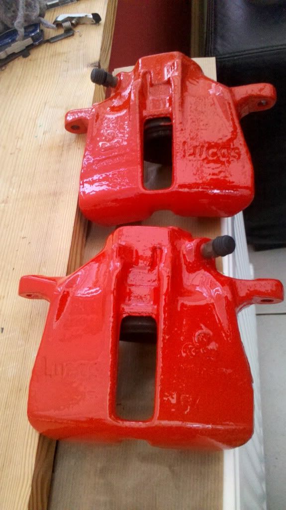

Another busy day, mainly concentrating on the brakes as a friend of mine is popping round during the week to bleed the whole system and sort the brakes out good and proper. :) Im still in the middle of fixing the sunroof, but still havent managed to obtain the replacement parts yet. Whilst the front wheels were off i decided to take off the plastic under the wheel arch off any check for any previous damage or rot, and was really happy to say that it is totally solid under there.
Brakes, mk4 calipers first:
Front calipers:

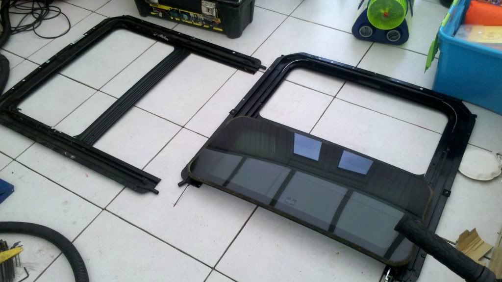

I stripped the sunroof rail ready for when I get the replacement part and also removed my old sunroof seal and replaced it with a brand new one:

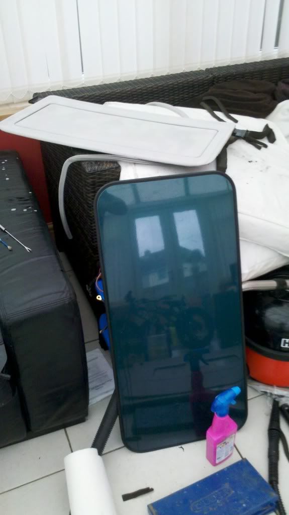

Small update. I managed to find a MK3 golf with electric sunroof at my local breakers yard, I got the whole mechanism including motor, switches and glass roof, I also got some parcel shelf straps from a VW polo and a couple of other small items all for £12! :) I brought it home and swapped the glass for my metal sunroof panel and refitted everything, and it worked perfectly first time! The mechanism was like new, and once tested I refitted the roof lining and all the trims. The whole job to refit only took about 45 mins.
New mechanism and the old one(the new one has the glass panel):

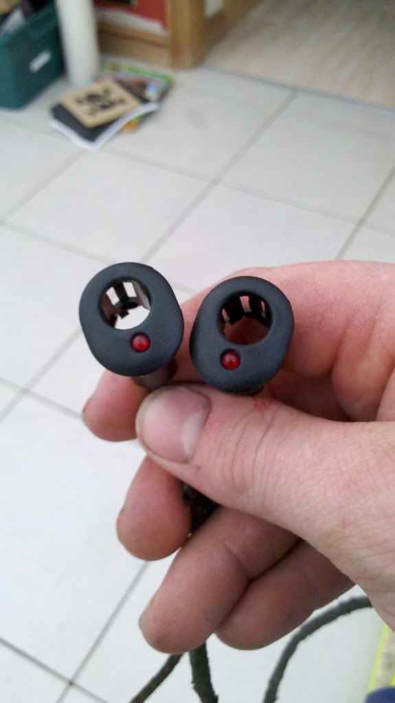

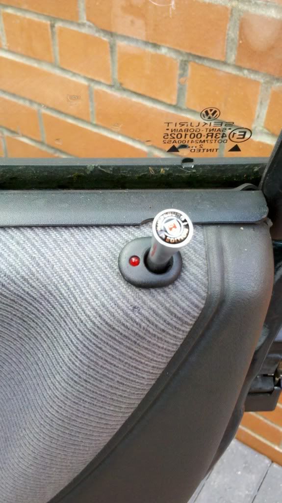

Also got a couple of flashing LED door pin surrounds from a MK5 Golf, which I will be wiring up next weekend:

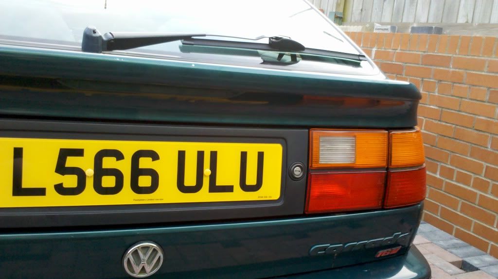

And final job for today was to fit the rear Aero wiper which im very impressed with:

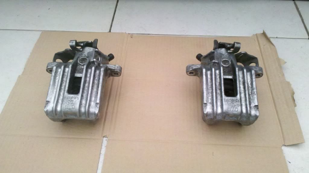

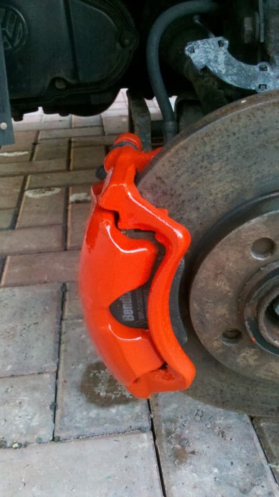

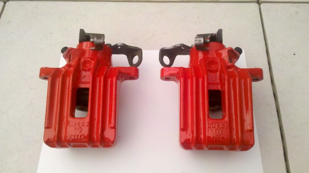

A very small amount of progress this week:
Rear calipers back on:
Front calipers:

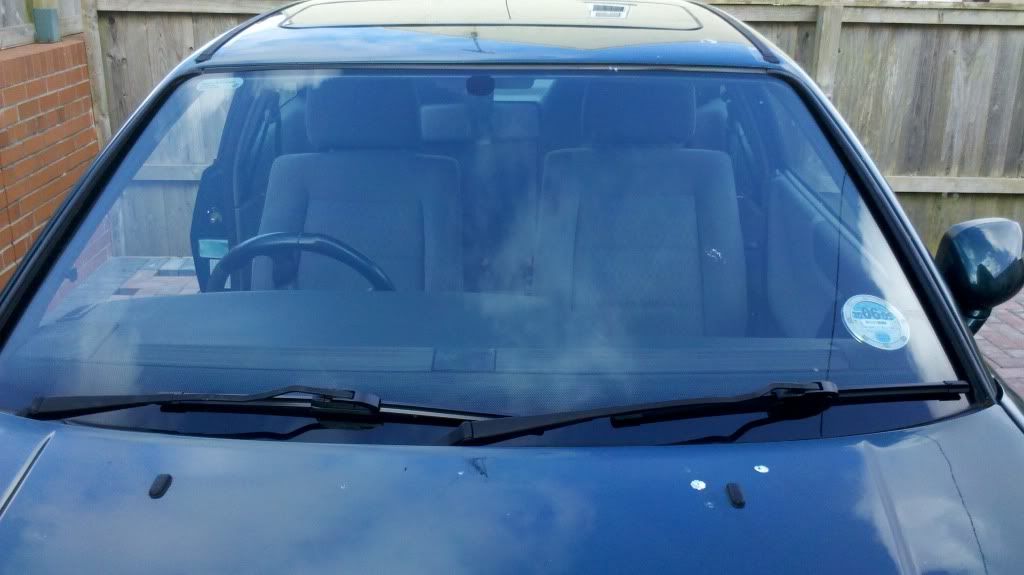

New Bosch Aero wiper blades up front:

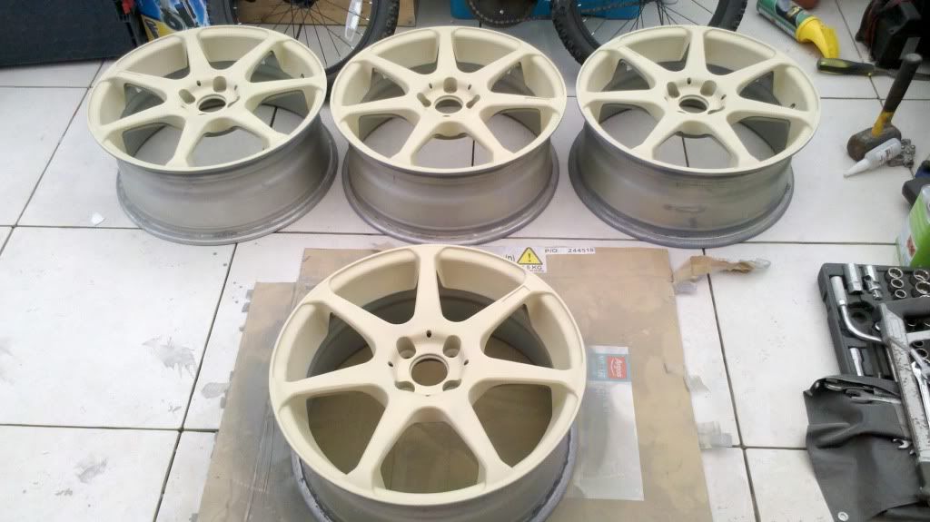

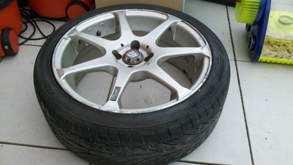

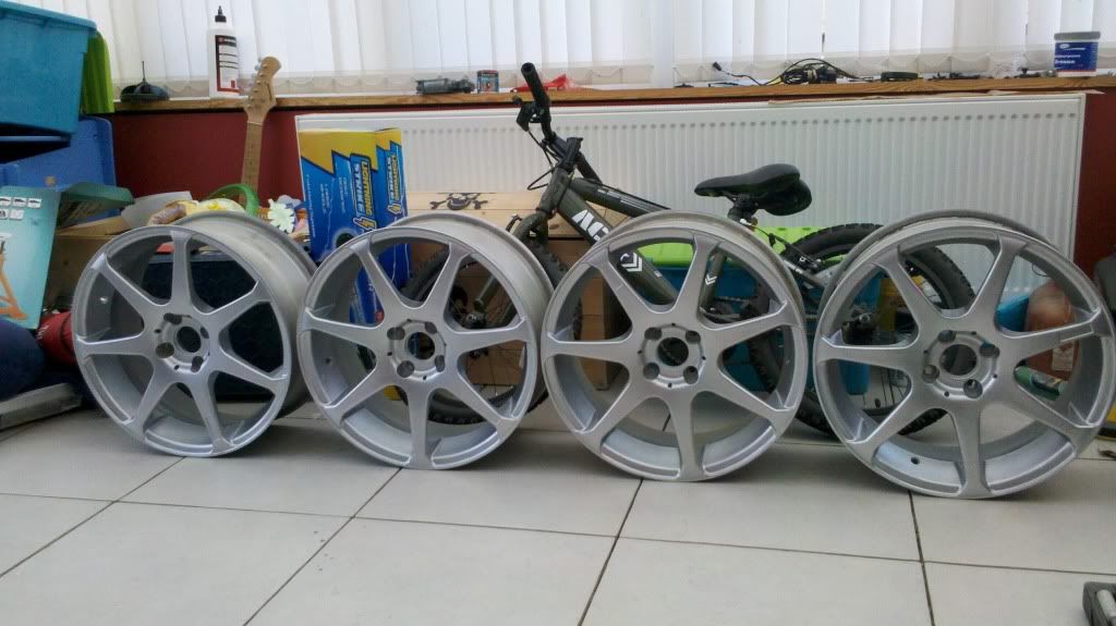

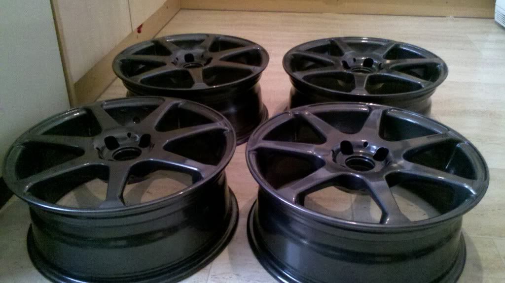

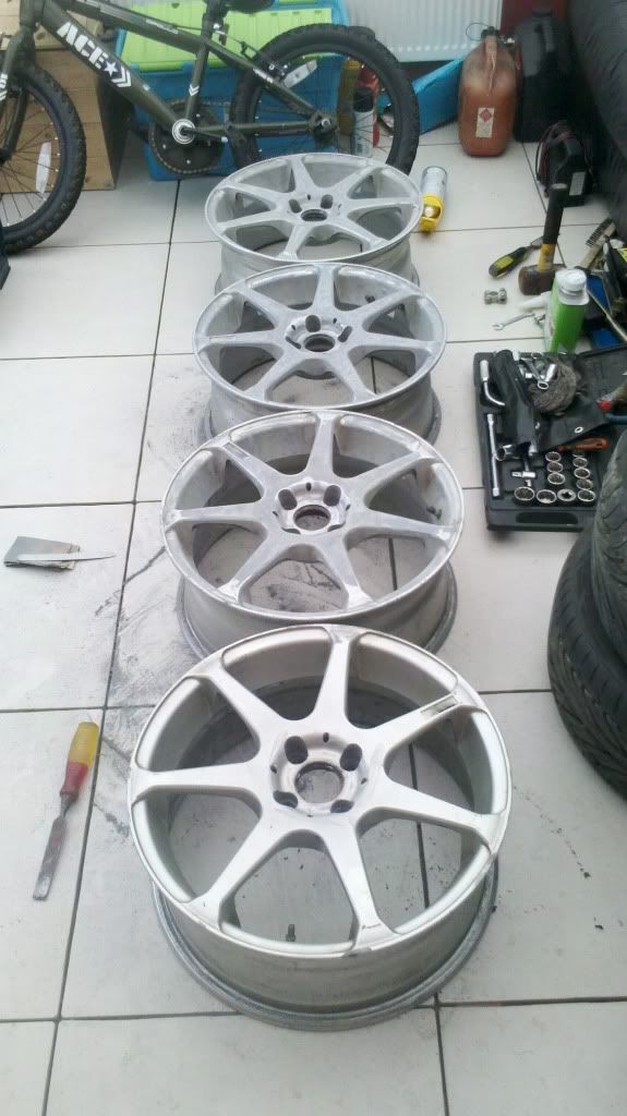

And the progress on the alloys:
Tyres off:
Primer after rubbing down:
First coat of paint:

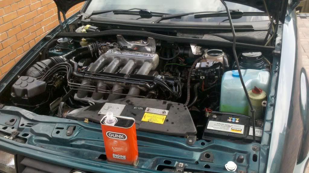

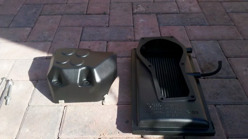

I wanted to tidy up the engine bay as it was covered in oil and grease, and the airbox and some of the plastic trim had discoloured, so I removed some items to clean them, painted some of the plastic trim, and degreased the engine with 'Gunk'! Im really suprised at how tidy the engine looks now, and theres not a splatter of oil or grease anywhere to be seen.

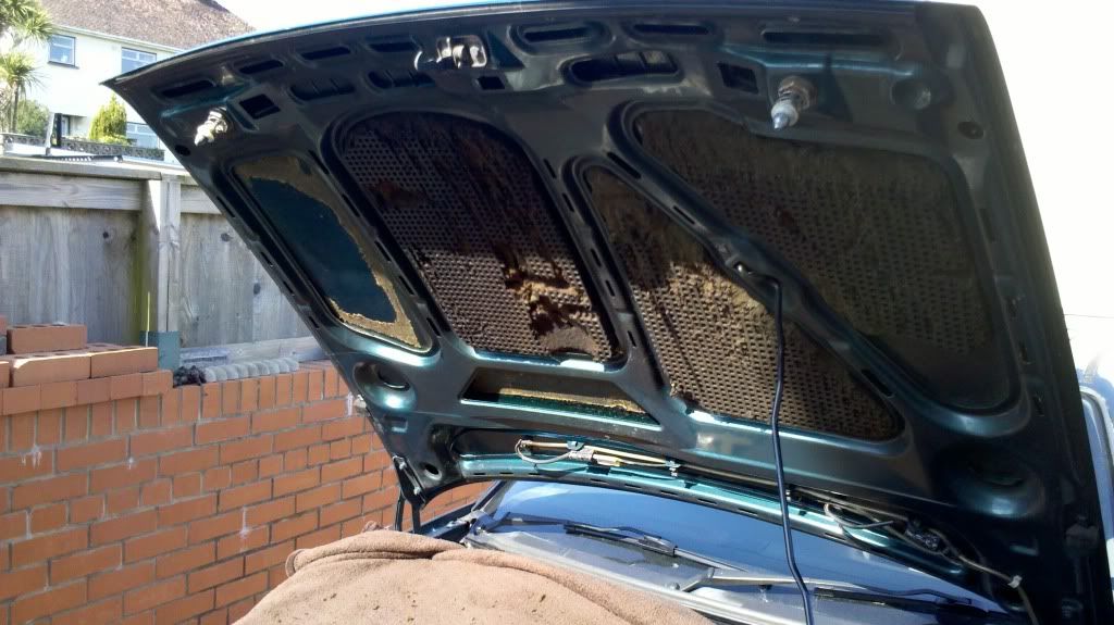

Next job is to remove the sound insulation on the bonnet as its all crumbling:

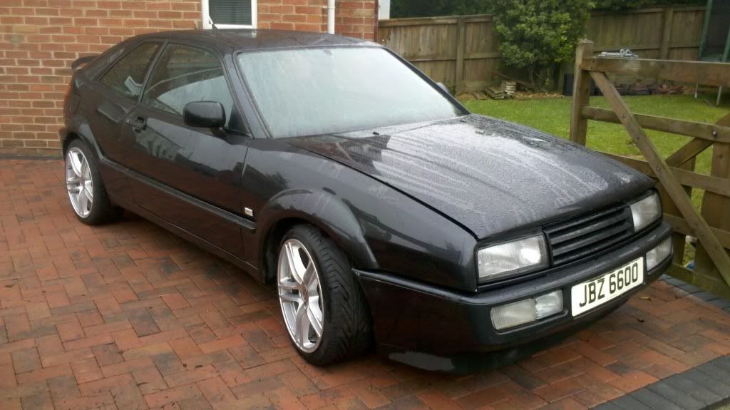

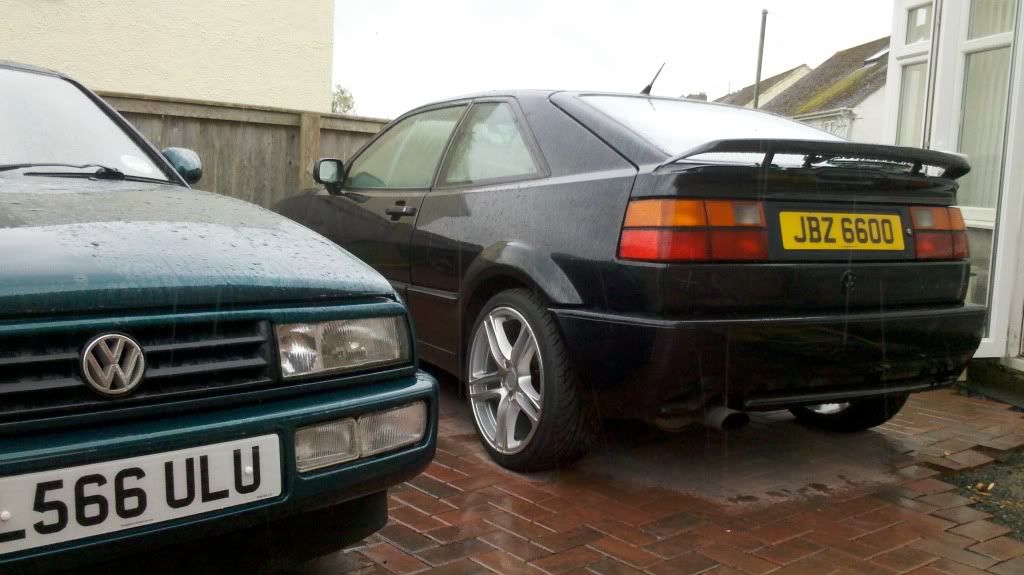

And oh I nearly forgot to mention I won another Corrado on ebay lastnight, it needs abit of work but overall I think its another bargain:
http://www.ebay.co.uk/itm/130700129496?ssPageName=STRK:MEWNX:IT&_trksid=p3984.m1439.l2649
you now got a 2 corrado with a bit of work and parts you could get the 2 on the road , just put 17in alloys on mine today handle better too still got to do a few thing to mine but overall kit did a fab job for me use it as my daily driver from home to work in hereford
Another update:

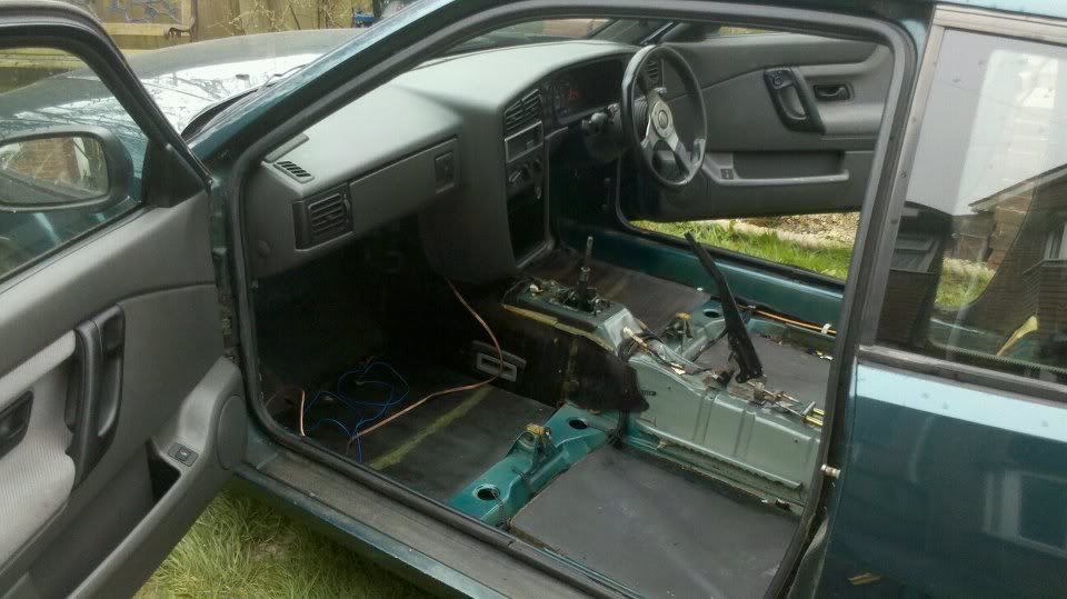

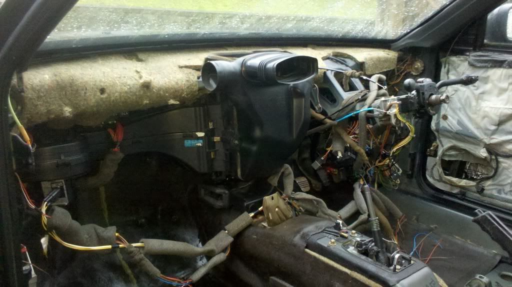

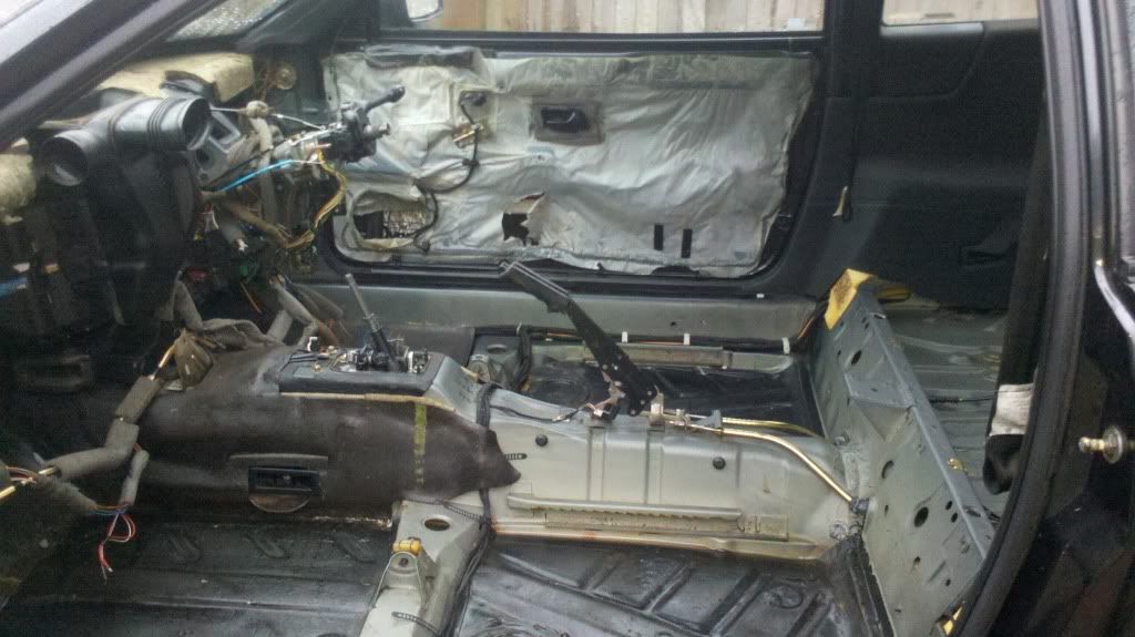

My latest purchase, my Corrado VR6 arrived this morning on the back of a lorry. The weather was crap but I decided to start on sorting out the car as I couldnt resist seeing it on the drive without doing something with it! I knew when I bought the car that it had an electrical fault, so I thought the best plan of action was to remove the whole interior to see if there were any hidden surprises. I already knew some of the wiring had been cut behind the dash but it was slightly worse than I was expecting. I removed a bag full of stereo wiring from the boot, under the seats and inside the door cards!! The interior was very messy and as luck would have it, I bought exactly the same interior a couple of months ago in perfect condition, so out with the old, in with the new. Progress so far:

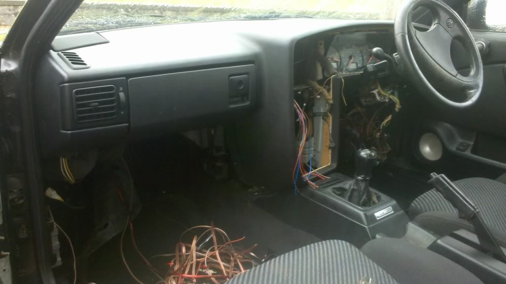

Wiring thats no longer needed, including the Clifford alarm:
Interior out:

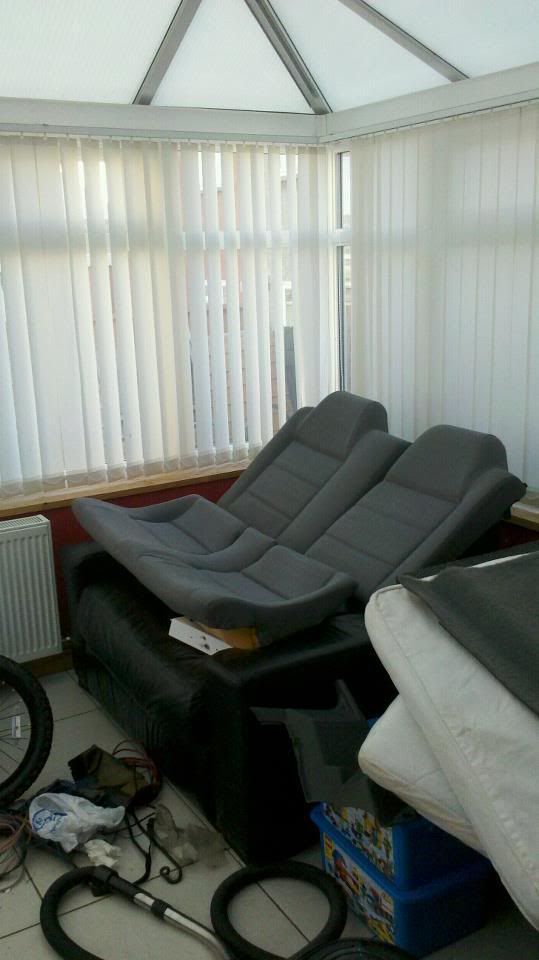

And the mess in my conservatory(again):
I ended up putting the alloys off the 2.0 16v in for refurb and they will be ready to collect this week. So I will update this thread once I collect the wheels and get on with sorting the VR's wiring.

Small progress as usual. I retumbled the locks on both the 16v and the VR6 last week which makes it so much easier to have just one key fit all the locks. I also picked up the wheels after the refurb and fitted them back on the 2.0 once the tyres were refitted and balanced. Im pretty happy with the finish of the wheels, and they only cost £30 a corner to powder coat them.
I recieved my new wiring loom for the VR6 on Thursday and have been busy fitting that and sorting out the central locking which wasnt working! I managed to fix the central locking after findind a break in the door cables and it works like new since fixed.:)
Ive just ordered a new sunroof seal for the VR and new center caps for the wheels on the 16v. Hopefully the next big hit is to get the interior refitted into the VR and tidy up the engine wiring.
Broken central locking cables:
Soldered back into place:
