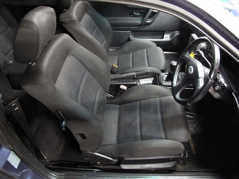

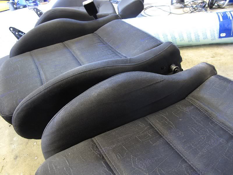

Here is some typical wear you see on a driver's seat (lower half). Passenger one on the left:

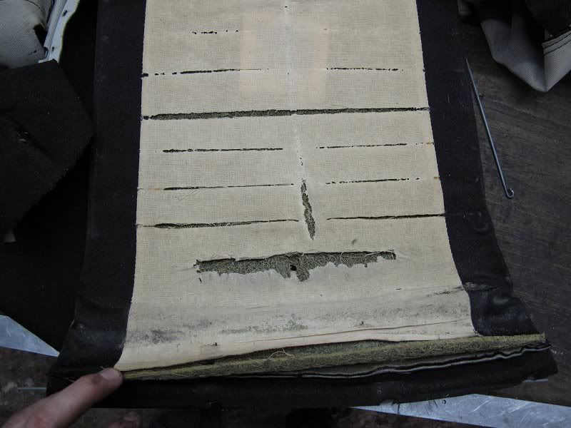

Once the foam loses it's strength and shape, the material starts to go to:

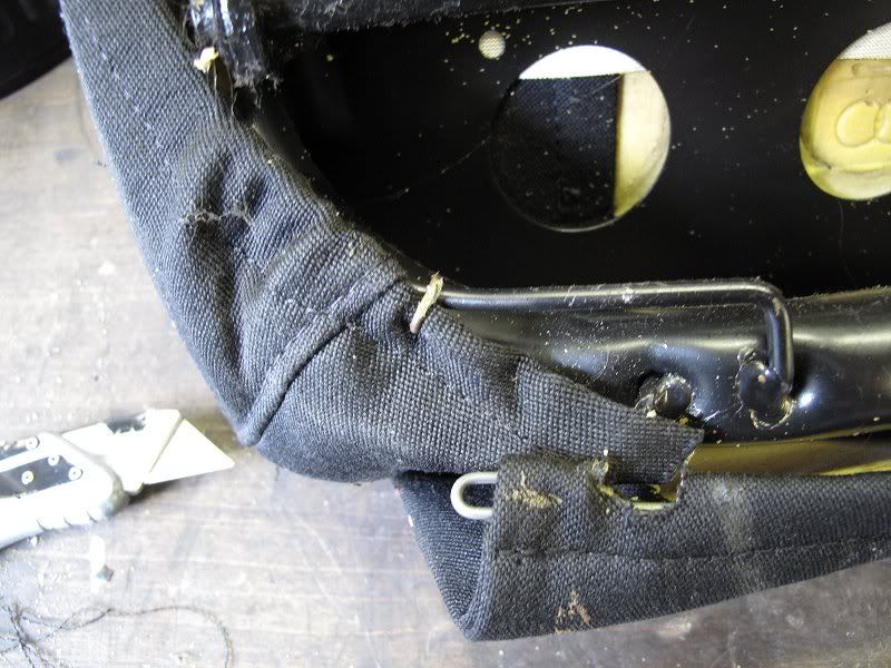

Now you need to remove all these wire retainer clips by twisting them apart with decent pliers.

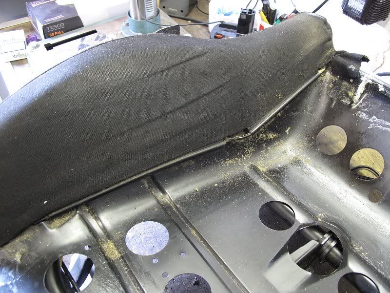

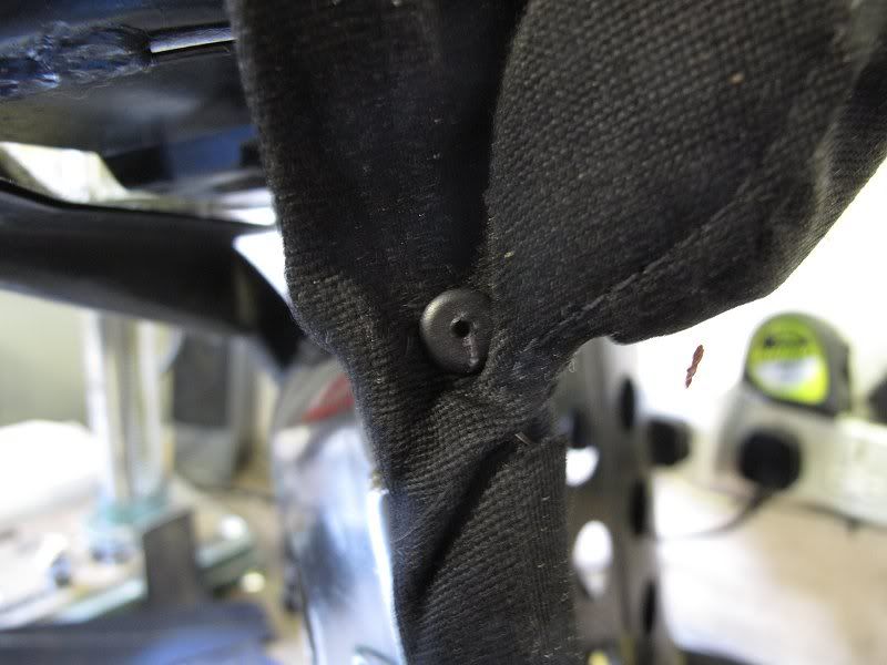

The back of rear part of the bolster cloth is held onto the seat fram by these rivets. I used a 3mm drill and drilled them out.

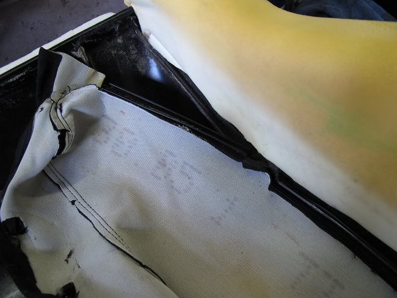

Now remove the bolster cloths. These are held in place by U shaped plastic strips as well as the wire clips. Fold the cloth over like this and then detach the plastic clips.

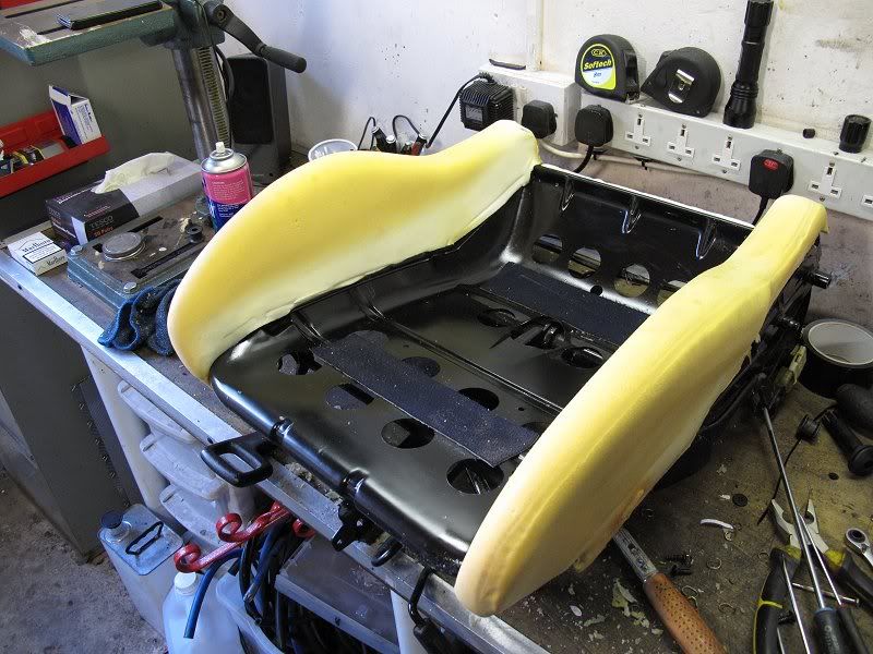

Now carefully ease the foams off the frame slowly by working your fingers along to break the glue seal. Even if you are binning them you should still do this to minimise the amount of foam left on the frame. Some seats don't use much glue. Mine came off easily with not much residude.

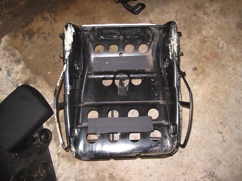

Repeat on the passenger seat and you will be left with a bare driver's frame and pile of soft furnishings from the passenger seat.
Clean up the frame to remove any glue and old foam. I used glue thinners.
Then take your passenger foams and and shove them on basically. You'll notice the right side is slightly different, but we'll come to that in a bit.

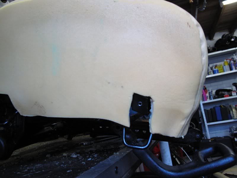

This is the main difference. You just need to notch a section out of the foam as this is where the plastic side trim will attach later. I recommend a scalpel for cutting the cloth and foam, or a very good stanley knife.

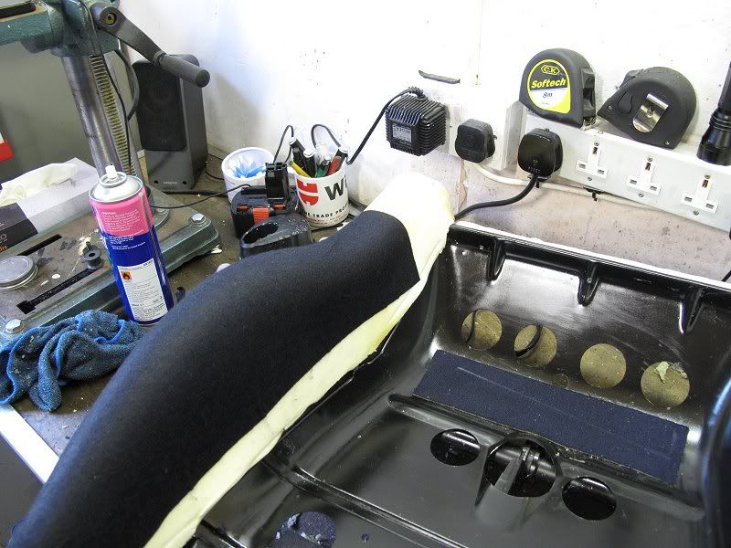

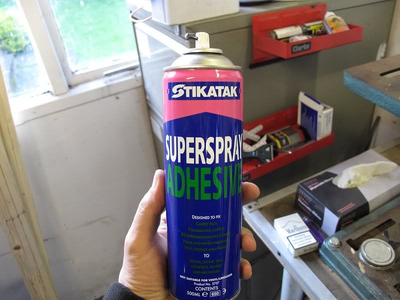

Don't glue the middle of the bolsters onto the frame or you'll struggle to get them on. Instead, fit the bolsters, then spray glue onto the frame and the foams just at the front and back. I used this glue, which you can get from B&Q. When the glue has air dried, press the foams firmly onto the frame to stick them down permanently.

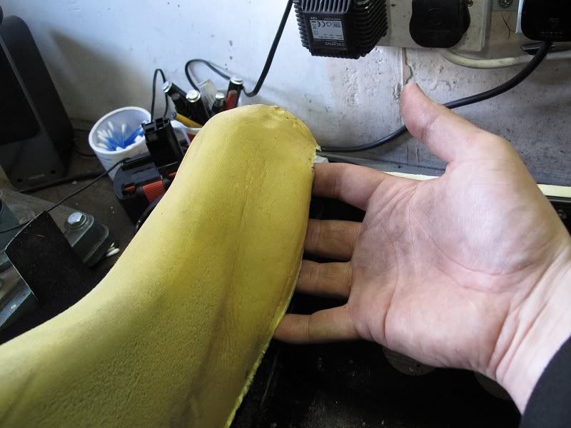

I always like to improve, so I reinforced the right bolster with some self adhesive felt, which John Lewis sell by the meter. This makes the bolster feel much firmer and also stops it going out of shape and crumbling to bits.

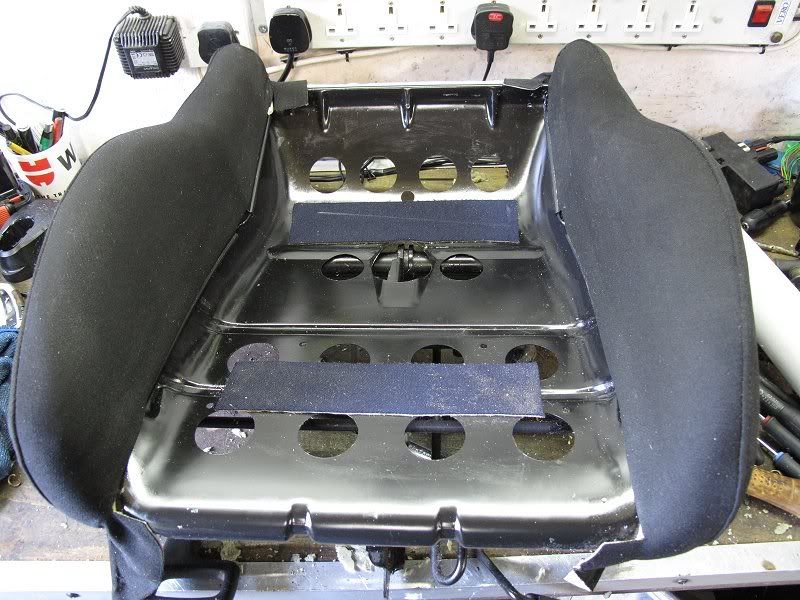

Stick the other foam on and then put your passenger side cloths on
On the right side cloth, you will need to make the highlighted cuts to accomodate the side trim. The cuts on the other side of the seat won't be visible as the transmission tunnel plastics nicely hide them :D

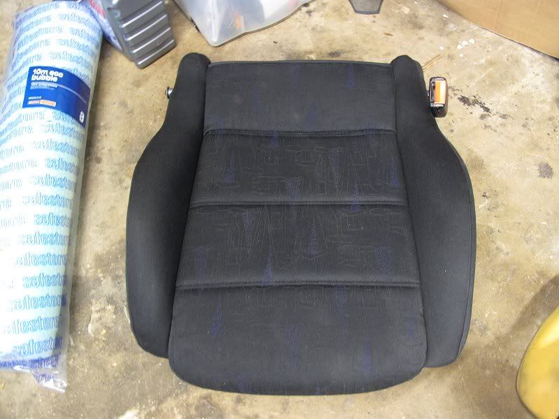

Refit passenger side bum pad and you have a nice new looking driver's lower half :D

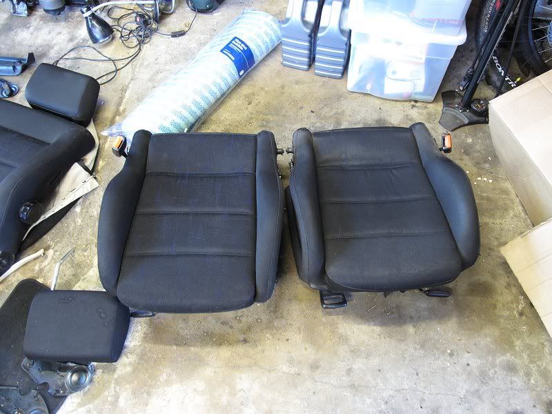

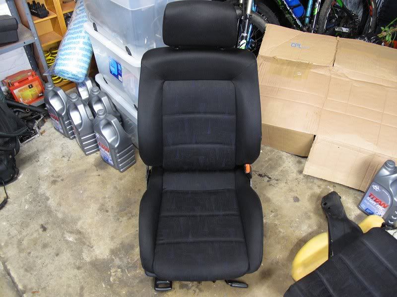

One completed seat, made up of all passenger soft furnishings on driver's side frames.

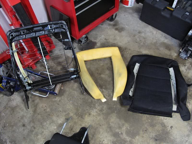

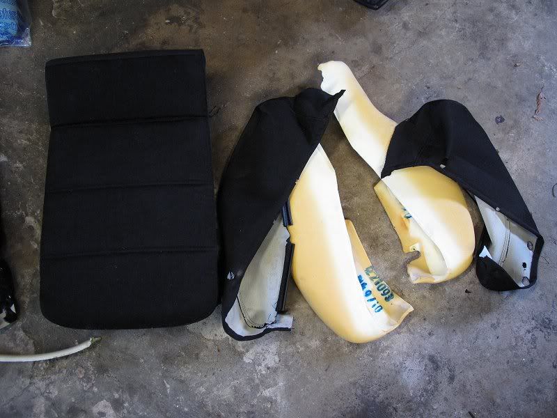

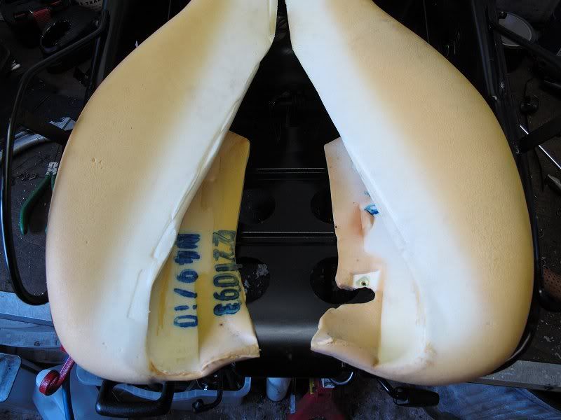

I have skipped over rebuilding the upper half of the seat but it's the same process. Here are the core sections.

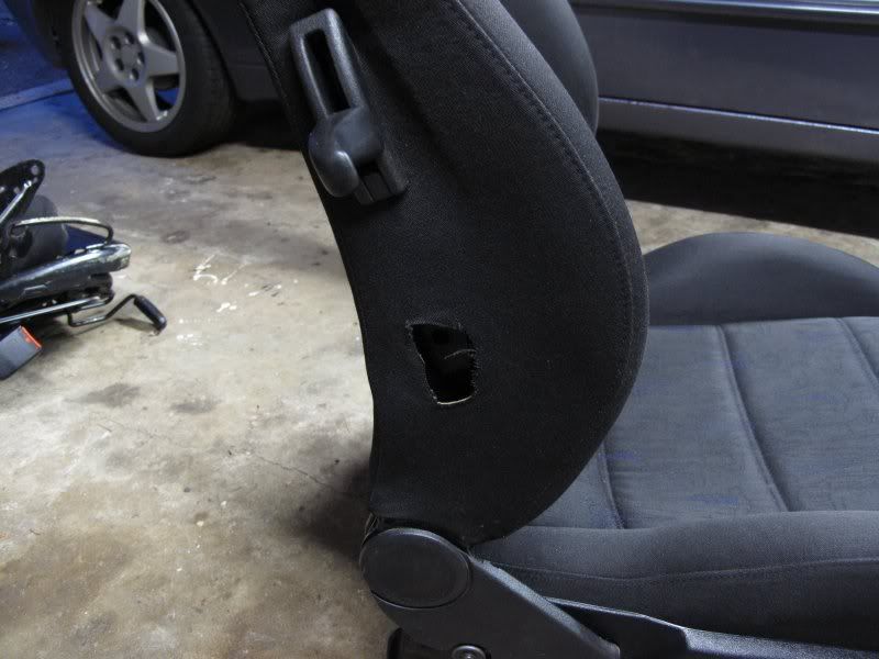

And here's the reason I rebuilt my upper half. Very little lumbar support due to collapsed padding which had gone all flat and manky. I also reinforced the wire frame with loads of duct tape in that area.

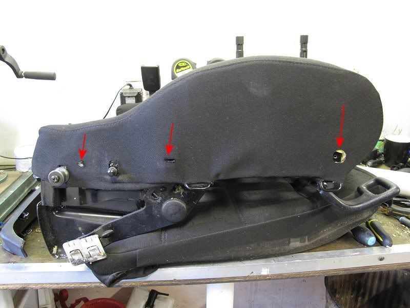

As previously mentioned, the only downside to doing this is holes in the upper half.
But when the final result is two 'as new' looking front seats, that does not bother me :D
I will cover the holes with some spare material as neatly as I can and update the thread with what that looks like.
