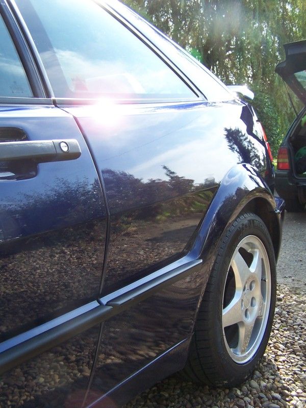

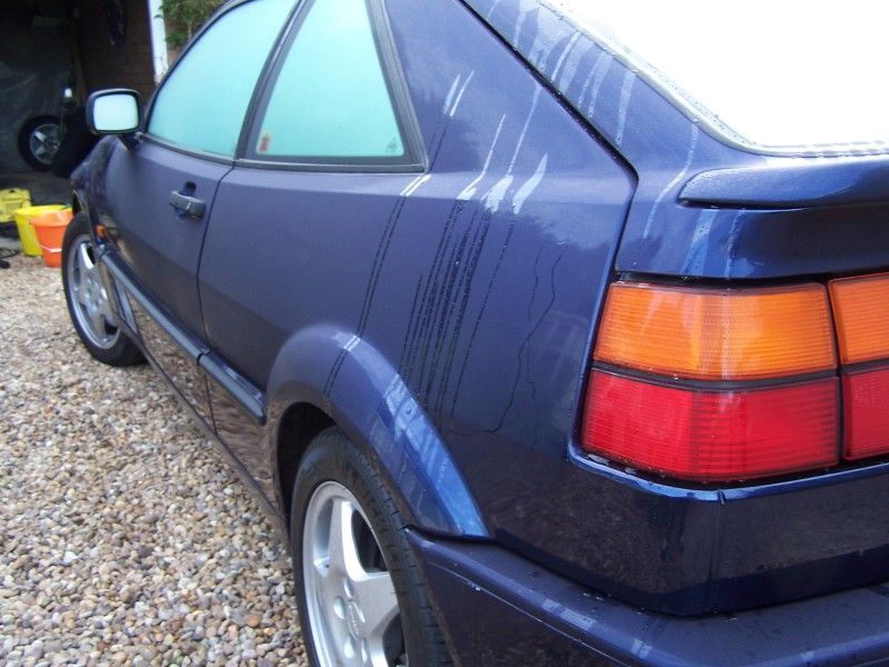

This is how the car was when I arrived.

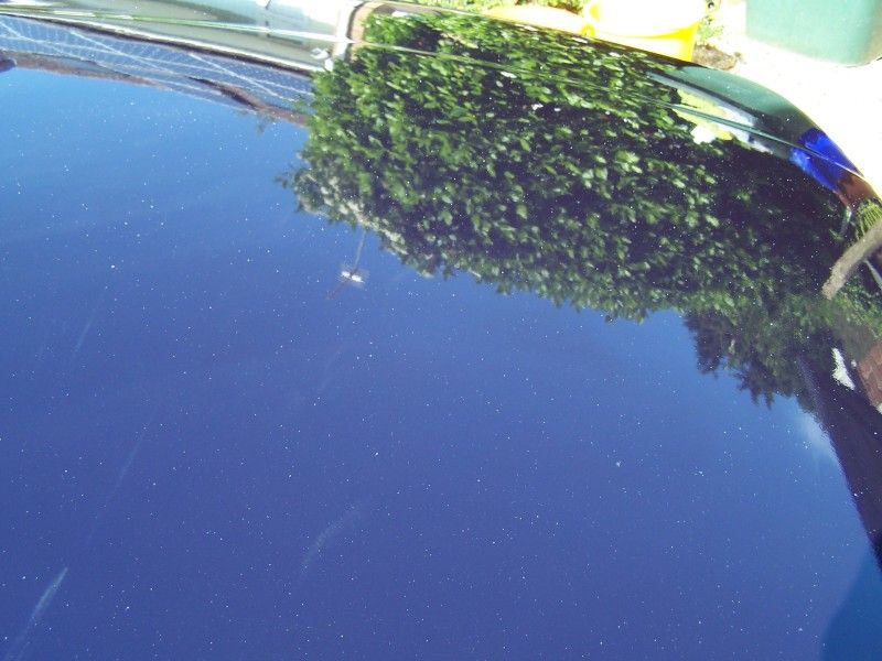

First off was a clean followed by a clay bar. Was really impressed with how little was coming off on the clay bad as the paint was very clean as it was.

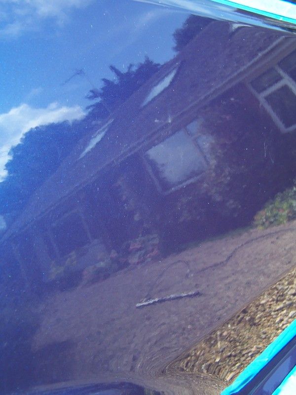

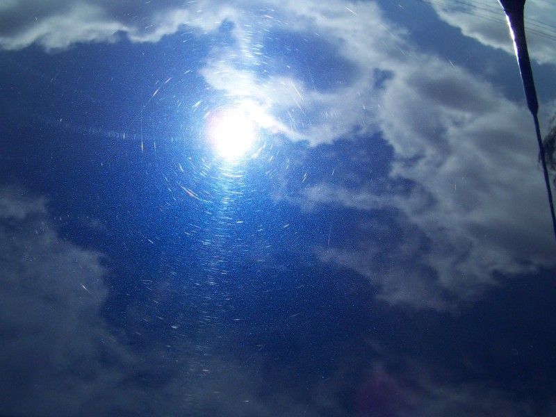

Can see a few swirl marks.

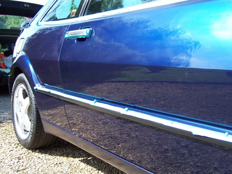

Next the plastics were all taped up ready for the machine polish. Each panel was given two passes with the machine polisher followed by a hand polish. As stated in the original post I was only using the finishing pad and speed glaze past. So I would not of been able to remove the swirl or scratches but it would improve the overall appearance of the car by rounding off the edges of the marks, which would scatter the light better and there for improving the look of the car.

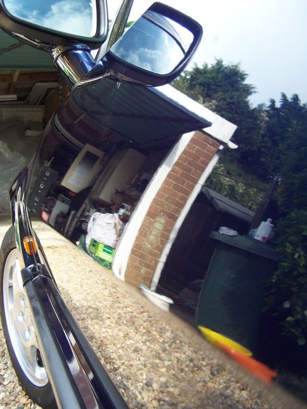

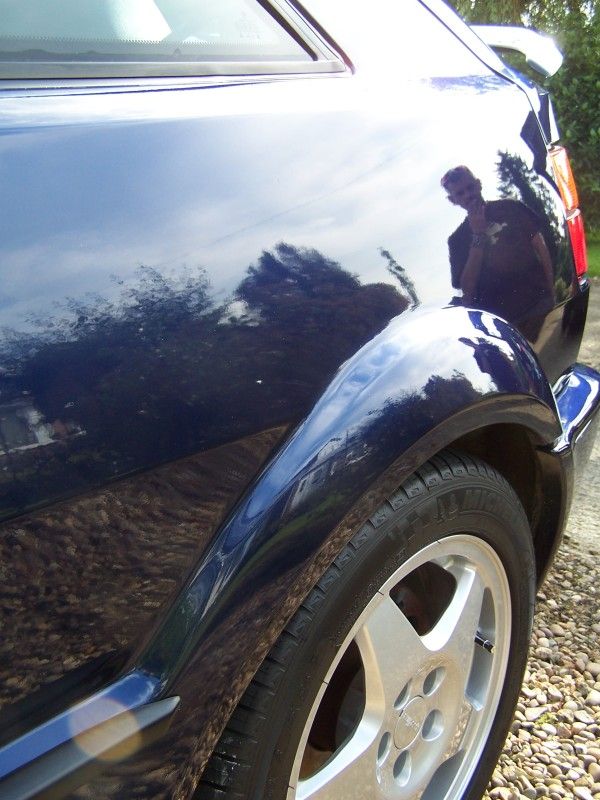

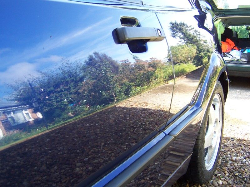

After the tape was removed the whole car was then given a going over with Poor boys black hole, AG paint sealant then Collinite 476 wax to seal in and protect the paint.

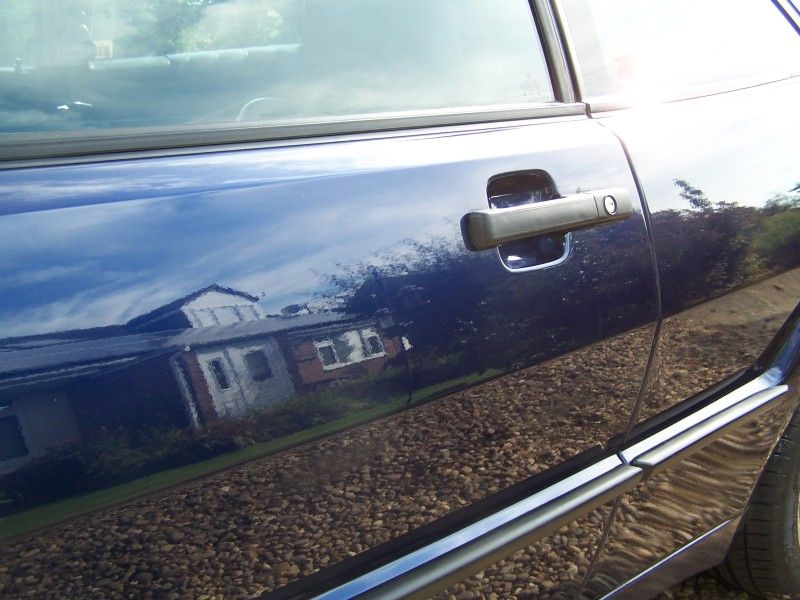

And here is how the car looked at the end. Really loved the colour in the sun once finished and the blue flakes whilst in the sun are absolutely amazing.
Dude VR6 in the reflection :cool:
The little helpers :D
And the money shots.
I was really pleased with the way the car came out and also very impressed with the overall condition of the whole car considering the mileage.
Also a big thanks to Wendy for the bacon sarny and pizza to keep me going and Dude VR6 for spotting the odd bit of dust I missed :thumbleft:
