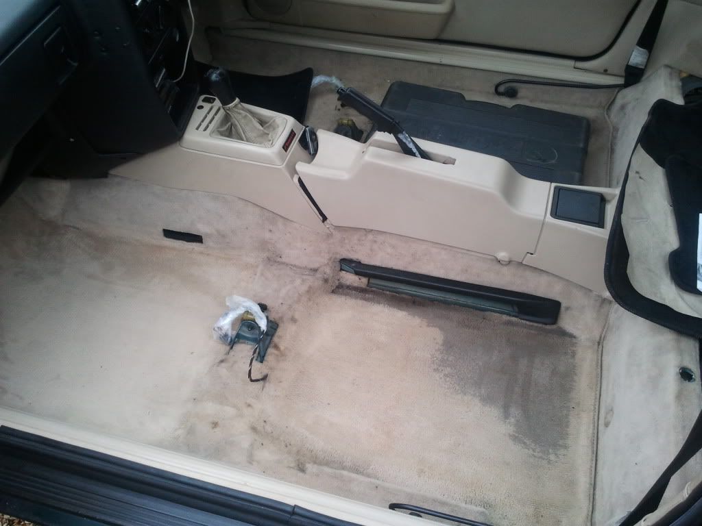

n3p 3 Posted September 24, 2012 Good afternoon all, Firstly, it's nice to be back! After what seems like an eternity of working away I'm finally back to see the forum looking completely different (for the better so far). In the unlikely scenario that anyone was wondering what happened to me and my Corrado, it's still here and finally getting some TLC. Back on topic (already used forum search btw). The car did previously have a leak through the scuttle blower area, which in turn killed my ABS ECU and relay. That's been fixed now using generous amounts of silicon, new gasket and an SWG smooth scuttle for good measure. Now, the rear passenger footwell always gets wet in the rain and for the life of me I can't find where the f k it's coming from. Here's a picture: Things done/checked: - Sat in the car for 15 minutes whilst it was being hosed. Nothing comes through at all! - Took the passenger door card off, the membrane is all intact and everything feels dry/clean. - Removed rear seats and doorcard, dry and clean - Checked front sunroof drain channels, clear - Checked the puddle, it's water not coolant - Checked rear badges and lights, the boot is dry I've yet to check the rear channels, would i have to remove the headlining or do the channels run down a pillar trim somewhere in the back? Looking at the picture it would appear that it's leaking from above, but the headlining is dry and unstained plus I'd probably notice water dripping down... Anyone got any ideas or experiences as to where the water is getting in? I've just had to replace the entire alarm as it was false alarming... I'm hoping it wasn't due to water damage because that would mean my alarm would be next! Next weekend I'll be removing the carpet as there's probably a nasty mess lurking beneath! Cheers, Nick Quote Share this post Link to post Share on other sites
fla 9 Posted September 24, 2012 Is the car parked uphill? It looks like its leaked from the front and has run back and collected in the passenger footwell. Unless there's some ingress from underneath, which i hope not... Can you remove the carpet and underlay? If so, that would give you an indication of where it is coming from. Quote Share this post Link to post Share on other sites
n3p 3 Posted September 24, 2012 Hi there, thanks for the reply. Sorry, I should have mentioned that the car is parked on a flat driveway. For good measure I have been alternating which way I park just in case any slight angle would affect it. I will be removing the carpet hopefully this weekend but was wondering if anyone had a similar problem. The front is dry, even when stomping on the carpet to try and get anything soaked up! hear it's worth talcing the floor once the carpet is out so maybe that'll tell me what's happening. Carpet is due a clean anyway! Quote Share this post Link to post Share on other sites

Human Joist 10 Posted September 26, 2012 No one answered the hole you mentioned in the passenger footwell. That could well cause the problem. Do you get water ingress when driving in the rain or when its sat in the wet. I have seen more water in a car from the same sort of size hole. It's a pain but a good idea would be to leave the carpet out of the car and all but the drivers seat and then use it in the wet. You may see where the water comes in from. Try talcing the base and the sides of the car without carpet at least you will see where gets we first if its a running down leak. Also check the drain holes from the sunroof, if you have one. There are two channels, one each side. They run to the back of the car and the pipe sticks out behind the bumper. You could let water run down them and it should drip from behind the rear bumper. But plug that hole as it should not be there. Also two other places to check are under the car I case you have lost a grommet from there and inside the rear arches to ensure you have not rot holes lurking in there that allow water in when driving in the rain. Quote Share this post Link to post Share on other sites
n3p 3 Posted September 26, 2012 Thanks for your input - I will find something strong to plug that hole up in that case. The car has been sat for the past couple of days (in the rain) and it has soaked again. I've never noticed any ingress while driving but it'll be worth doing a stripped down road test once I collect my seats. The front sunroof channels are clear, the rears seem to be escaping fast enough too, but I think I may be closer to finding where the leak is coming from. Here's the passenger rear, as you can see the water has pooled in the areas highlighted. It appears to be running along the blue marks parallel to the centre tunnel as previously thought: In my haste a couple of days ago I forgot to remove some more padding on the front side as you can see (already removed 2 sheets, there was more under it!) so apologies for that. Also excuse the snapped plastic ABS ECU cover remains...that's going to be fun finding a beige replacement for that! Anyway, the purple area is completely rotten, this could be from the previous scuttle area leak (more padding to remove!), The yellow area is rotten, but strangely enough the orange area is dry, although the padding below is wet too. I think the best thing to do when I get more time is to remove the padding (sound proofing?) I overlooked and start pulling the dashboard out. It's going to be changed anyway but I think I have enough evidence to rule out the door membranes, rear lights and badges. Will also remove the pillar trim as suggested before. Will update the thread once I've made progress, but I'm really not looking forward to doing this job! Clearing up the talc alone is gonna be crap! Anyone know if the floor padding stuff is still available from VW? If not can I just get some from another VW and cut to suit. I guess Dynamat wouldn't be a good enough replacement? Nick Quote Share this post Link to post Share on other sites
