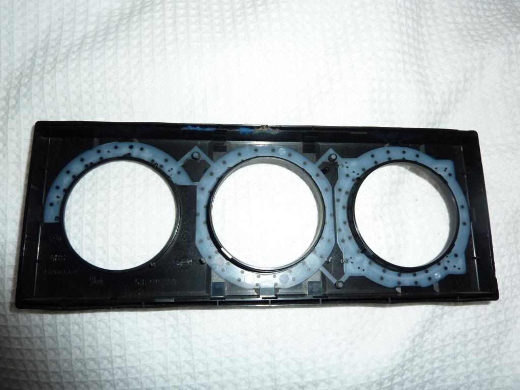

5dOt1 0 Posted October 28, 2012 Here the pics I've talking about: Later style: General: The set (this is what you get) 1x PCB with ca. 50 SMD-LEDs (ready soldered of course) 4x special knob LEDs (one for spare) 2x knob LED wires 1x knob LED connector 1x connector for voltage in 1x assembly instruction 1x "the making of" Video-DVD (not needed, but nice to see...) Green V2.1 PCB off PCB on completed Blue V2.0 PCB off true color maximum brightness Red V2.0 PCB off PCB on completed So guys... These parts are all of LHD of course. To make PCBs for the RHD I need help. I don't have ever seen a RHD unit. so I need a good and clear photo from a unit with a demounted bezel and I need a 300 dpi scan from the backside of a bezel without the inner parts like this scan from the LHD bezel: CLICK I need it, because I'm not sure about some holes and the final positions for some LEDs. Pics about the earlier style HVAC will you get if anybody will answer my question (3th try...): Is the LHD and the RHD heat/ventilation Unit identical? I think yes, but I want a simple shot to get sure. Thanks in advance! Quote Share this post Link to post Share on other sites

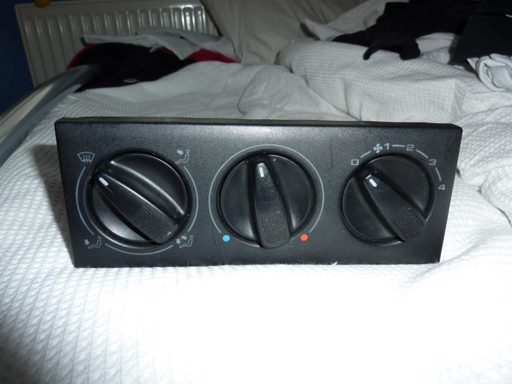

Jon_vr6 1 Posted October 28, 2012 Ive got pictures of the bezel etc BUT having trouble scanning the bezel as my printer is an all in one printer so it focus's more on the edges of the bezel than the bits in the middle. ---------- Post added at 1:00 PM ---------- Previous post was at 12:23 PM ---------- Quote Share this post Link to post Share on other sites

Dude VR6 0 Posted November 3, 2012 I've sent Dirk a heater control unit for him to get started on this. The fan switch is on the other way round on the UK spec unit, so he's got a little bit of work to do, but he's on to the case. Quote Share this post Link to post Share on other sites

5dOt1 0 Posted November 3, 2012 (edited) Hello guys, now I want to update you ;) Yes, Miles has sent me a complete HVAC unit of a RHD. That absolute freaky!! The trust in me is incredible! It's most appreciated. Thanks a million! Now I've started the project RHD-HVAC At first I've taken a photo from the 2 units, the LHD and the LHD. Here it is (left is LHD you can guess witch is the RHD :-) ) At next step I've scanned the backside of the RHD-Bezel. I've imported the file to an graphic program and I've added the right LED-Positions to get a homogeneous illumination. This positions are only for the red PCB. So I've to build a file like his for the green and the blue PCB's. Then I will start to draw the schematic circuit diagram for each color. After this I will import the outline with the LED-Position into the CAD-Program to draw the conducting paths. I will inform you about the next steps. When I have ready all 3 layouts with the 3 "CNC-Milling-Files", we can start the group buy. As God wills next weekend. :dance: Edited November 3, 2012 by 5dOt1 ...horrible spelling mistakes Quote Share this post Link to post Share on other sites
