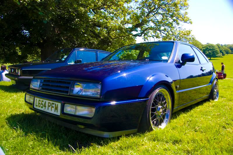

neil20vtc 0 Posted December 3, 2012 i had these on my old corrado i had to use 4x100 to 5x120 adapters got mine from concept but you can get them from g23 engineering in the uk now, mine were a staggered set 7.5 front and 8.5 rears i had no fitment problems and ran pretty low but my arches had been modded to accomodate the 16x9 borbets i ran before the bmw bbs Quote Share this post Link to post Share on other sites

VW_OwneR_85 2 Posted December 3, 2012 looks good! is that a vr6? they got wider track so might stick out abit more on mine , iv just brought one rc041 for now off ebay at a good price posted, so ill use that and see what needs to be done, you have 40 profile tyres? Quote Share this post Link to post Share on other sites

neil20vtc 0 Posted December 7, 2012 VW_OwneR_85 said: looks good! is that a vr6? they got wider track so might stick out abit more on mine , iv just brought one rc041 for now off ebay at a good price posted, so ill use that and see what needs to be done, you have 40 profile tyres? it was a 16v but converted to 20vt still on narrow track, i ran 205/40/17's on both the rc041's which are the fronts and rc042's rears, tyres were what i would call normal on the front and a sensible stretch on the rear not sure off the top of my head what size adapters i ran but i did have wider rears to fill the arches i could find out if you want but not sure if it would benefit you as previously mentioned my rear arches had been rolled and pulled and fronts rolled and glad some parts of the old girl still live on bill that car had a real sentimental value to me which is why im glad the seats and engine albeit looking a bit different are living on in my mk2 neil Quote Share this post Link to post Share on other sites
