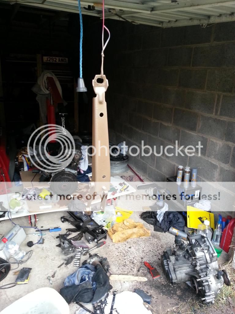

Smiithy 10 Posted January 21, 2014 Morning guys, Thought it was about time to start updating my build and making a proper thread of it so I have extra imput of all you guys who may have done similar before and as a record of what I have done. So the corrado as you can see below in its previous guises started to annoy me with leaking KE-jet heads etc. First Guise when I put my stamp on it (sorry if pics repeated) Seccond Guise (borbet wheels instead of fake bbs) So this happened because of KE-jet messing me about From here I plan to make abit of a N/A fast road / track car. Plans -2.0 stock 9a bottom end (as I know its in very good tight order) -KR head, ported and fully rebuilt and skimmed -ABF inlet , KR exhaust cam. (will be making my own vernier pulley at work) -Megajolt Ignition -R1 carbs -Upper and lower front strut braces -Rear strut brace -Volk Racing C ultra 3 spoke wheels in 16x7 and 16x8 -MK3 Golf GTI rear beam, polybushed -Full widetrack MK3 GTI front set up. -G60 clutch plus other maintenance items. Rear brace installed : Volk lightweight wheels: Colour Wheels and bay accents will be going (comments welcome) Thanks for looking, Comments, criticisms and advice very welcome. Quote Share this post Link to post Share on other sites
