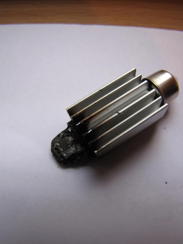

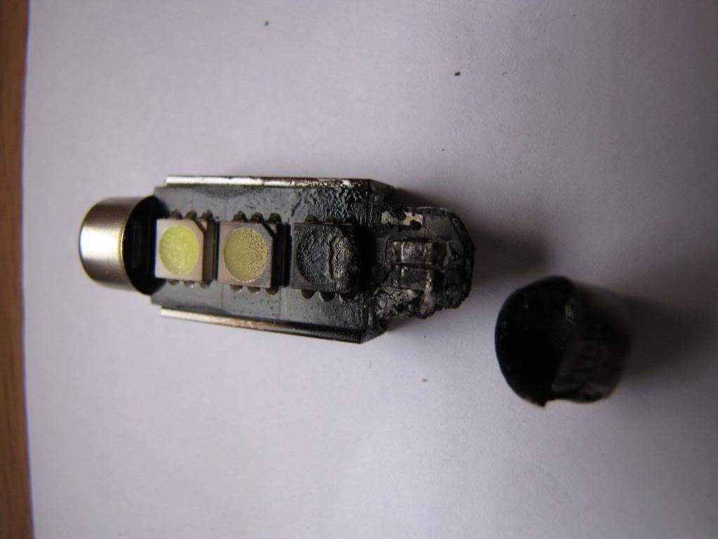

Jamie 1 Posted February 6, 2013 Got in my car this morning and noticed a really foul smell and a weird sound. Took a few seconds then noticed the LED bulb in my interior light was alight, not just smoking but properly on fire. Managed to rip it down and put it out before it got very bad but still a bit worrying. Didn't think this could happen with LEDs tbh but it's one of the canbus error free smd type bulbs and it looks like one of the chips has overheated. Probably a freak one in a million chance of it happening but just thought I'd let people know... PS Not my Corrado, the family Truckster Quote Share this post Link to post Share on other sites

dr_mat 0 Posted February 7, 2013 The problem is that a 1w LED bulb produces half a watt of heat, but distributes it over a tiny tiny area, leading to a really microscopic hot spot. If you use the high-power LEDs then you need a carefully designed heat distribution package for it. The lamps that use "many" low powered LEDs (20 or 30) are much more reliable because packaging is much less critical. Quote Share this post Link to post Share on other sites
Jamie 1 Posted February 7, 2013 (edited) VAG-hag said: Did you post this on detailing world too? if not then thats 2 this week I have read about! No wasn't me mate* The real ****er for me is I deliberately went for the more expensive ones from a UK based supplier, although I know they pretty much will all come from the same Chinese factory. *Yes I have posted it on DW and also Talkaudio ---------- Post added at 4:05 PM ---------- Previous post was at 3:11 PM ---------- Pics of it Edited February 7, 2013 by Jamie Quote Share this post Link to post Share on other sites
davidwort 0 Posted February 7, 2013 :shock: have you got a 32Amp fuse or something in the interior lights slot! Quote Share this post Link to post Share on other sites
Jamie 1 Posted February 7, 2013 davidwort said: :shock: have you got a 32Amp fuse or something in the interior lights slot! The fuse kept blowing so I put a paperclip in instead :D It's a 5 amp as per the manual... Quote Share this post Link to post Share on other sites
dr_mat 0 Posted February 7, 2013 THat's quite a large heatsink. Apparently not enough though .. Quote Share this post Link to post Share on other sites
Stonejag 10 Posted February 8, 2013 5A is way over for a single LED bulb, does it really need 60+W?! I'd swap it for a 1A fuse (or 2A, if the 1A one blows). They don't need much power to run, that LED probably failed short...the board's current limit will be less than the fuse rating, allowing it to get hotter and hotter. Remember a 5A fuse is rated to continuously supply 5A, not to blow at 5A! The trip current is a good bit higher... Stone Quote Share this post Link to post Share on other sites
Michael'durham' 10 Posted February 8, 2013 I'd just like to ask, how long was the interior light on for? Had you been working inside the car,.? Scary pictures tho, I'm just thinking of getting a few. [cough cough] think I'll leave we'll alone.... Wonderful post cheers for heads up. Quote Share this post Link to post Share on other sites
Jamie 1 Posted February 8, 2013 Stonejag said: 5A is way over for a single LED bulb, does it really need 60+W?! I'd swap it for a 1A fuse (or 2A, if the 1A one blows). They don't need much power to run, that LED probably failed short...the board's current limit will be less than the fuse rating, allowing it to get hotter and hotter. Remember a 5A fuse is rated to continuously supply 5A, not to blow at 5A! The trip current is a good bit higher... Stone 5A wasn't my idea squire - that credit must go to the good people of Volkswagen Audi GmbH of Vee Double Ewe Strasse, Wolfsburg, Greater Germany. Michael said: I'd just like to ask' date=' how long was the interior light on for? Had you been working inside the car,.? Scary pictures tho, I'm just thinking of getting a few. [cough cough'] think I'll leave we'll alone.... Wonderful post cheers for heads up. Walked up to my garage, unlocked the car which activated the interior light, opened the door and got in. That's when I heard a weird noise, dodgy smell and it took a few seconds before I noticed the light was burning. Quote Share this post Link to post Share on other sites
GrahamU 6 Posted February 9, 2013 That looks more like a short circuit from the terminal to the heatsink Quote Share this post Link to post Share on other sites
