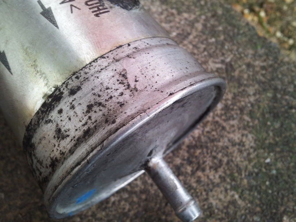

seanl82 23 Posted October 29, 2013 Did you have to replace the line Rob? Where did you get if from mate? Quote Share this post Link to post Share on other sites
robrado974 1 Posted October 29, 2013 (edited) Just reread your post , sorry mate i thought you meant the fuel line by the air filter as i comes up to the rail , mine was rubbing on the line and put a hole in it . When you say by the fuel filter is it the hardline you are talking about ? Edit my brains not working ! .You should only need a new length of fuel pipe and a connector mate and i remember now i did have a leak there too .Available from halfords and the like . Edited October 29, 2013 by robrado974 Quote Share this post Link to post Share on other sites
seanl82 23 Posted October 29, 2013 Ok mate thanks. I'll have a proper look at the weekend, but I think it's coming from the crimped part of the hose just after the filter. It's spraying upward I think so I couldn't see exactly where it's coming from. I'll have a decent look before worrying too much. Pretty sure worst case is a new fuel pipe and filter so not the end of the world. Quote Share this post Link to post Share on other sites
CazzaVR 0 Posted October 30, 2013 You might get away with just trimming the end of the hose. Quote Share this post Link to post Share on other sites
seanl82 23 Posted November 2, 2013 Just found the problem with the fuel leak. Turns out it was a fracture on the filter itself. Genuine filter too and its a bit of a strange one. I've never seen it happen before but I guess its been constantly resonating against the underside which has caused it. Happy enough though as everything came off really easily so its nice simple fix. You can see the small crack in the centre where the lip is. Off to get a replacement this afternoon so all should well. Quote Share this post Link to post Share on other sites
delfinis38 1 Posted November 2, 2013 turn it round so the cracks at the top :) Quote Share this post Link to post Share on other sites
seanl82 23 Posted November 2, 2013 turn it round so the cracks at the top :) It was at the top, I think it had been vibrating on the underside that had caused the problem. Housing cleaned up with the fuel from the old filter and looking nice and clean now, new filter fitted and all good. :smug: Quote Share this post Link to post Share on other sites
