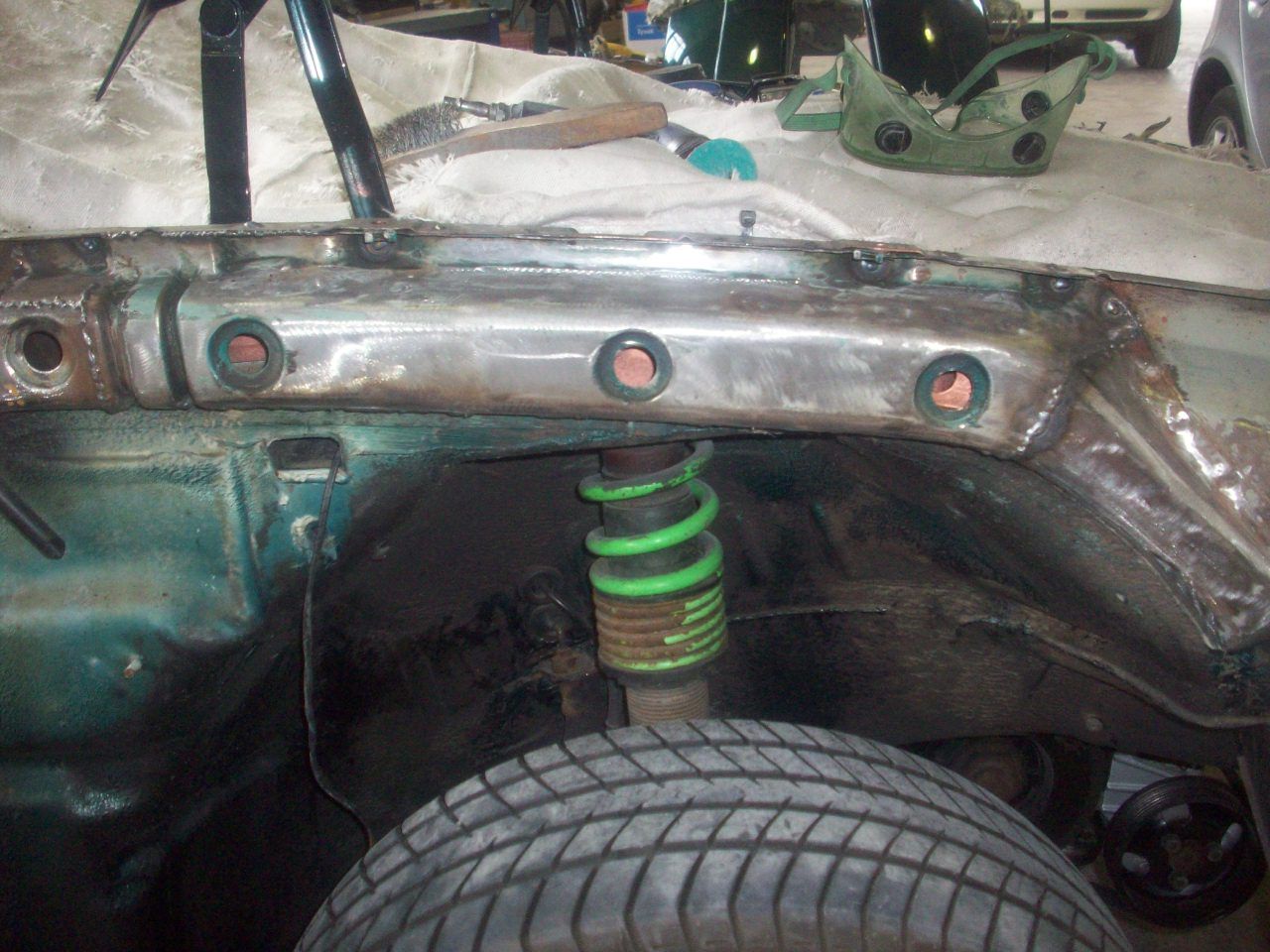

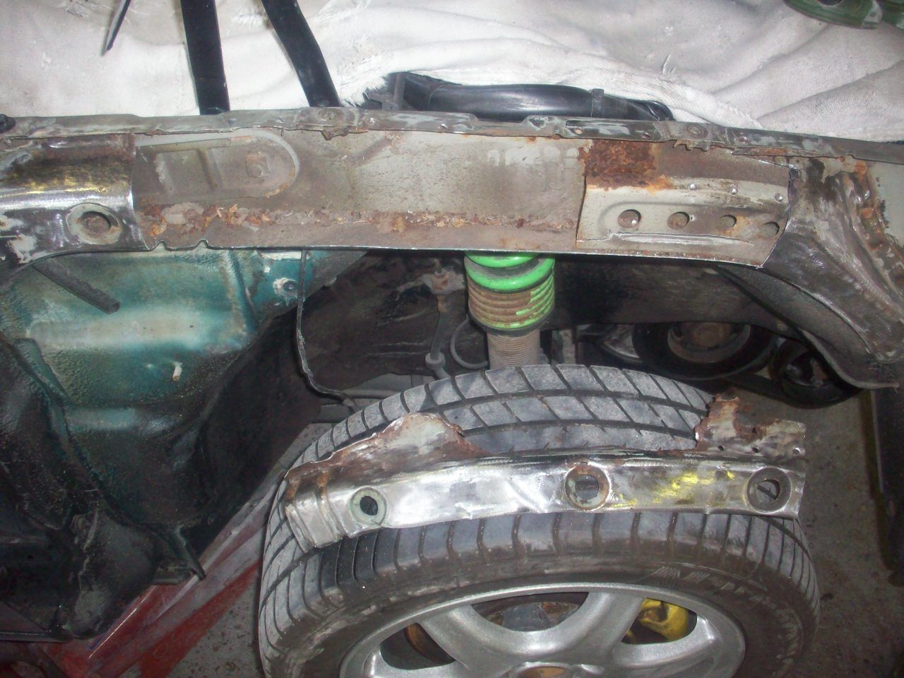

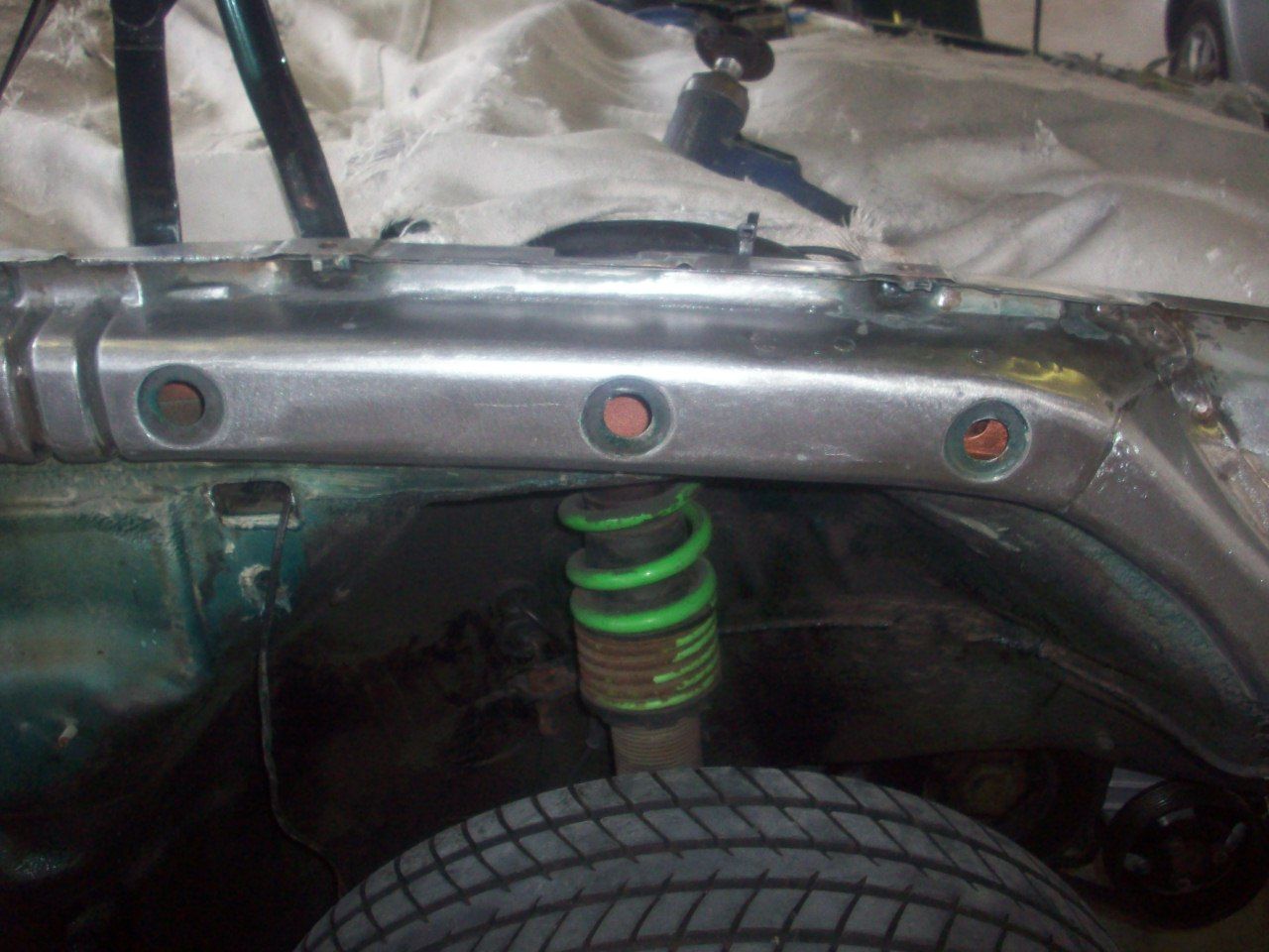

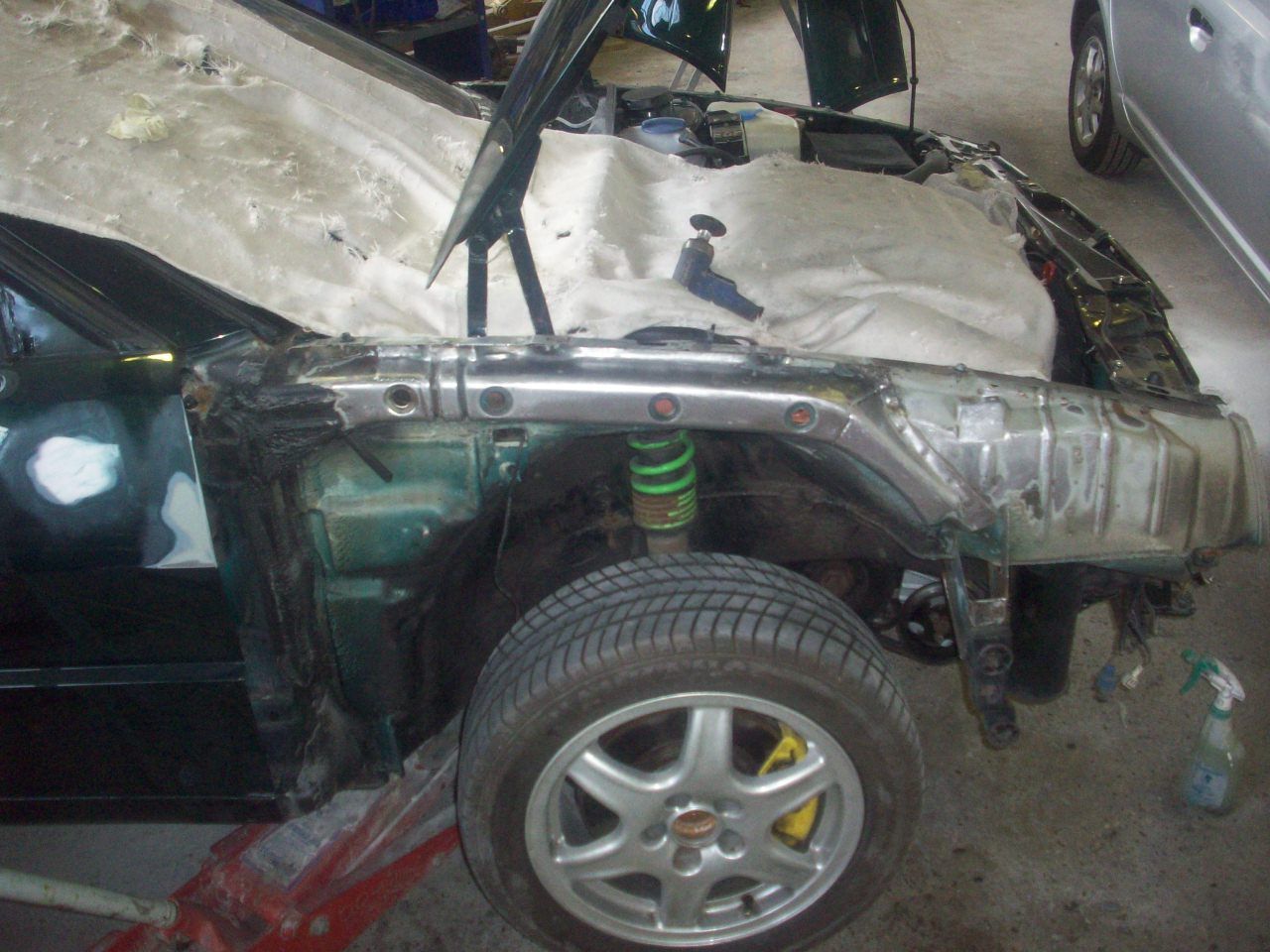

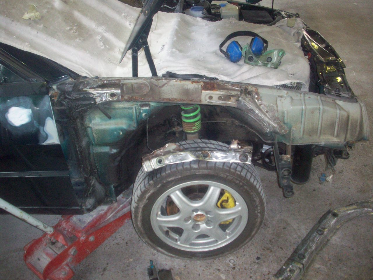

seanl82 23 Posted September 5, 2014 (edited) Little to report on paint front, progress seems very slow although they seem to be doing it properly which is encouraging. They sent me a few pics of the inner wing that they've now done last Friday, and they had the wings and bumpers on the stands ready for prep, which the assured me they were ready to crack on with this week. They said it had taken longer to do the inner wing than anticipated, as the repair panel I sent them was both inner and outer skin. They drilled out all the plug welds on the car and the repair panel, then welded the good stuff in. Apart from that and a bit of filler work, not much else had happened. I'm still accumulating parts, and I've had a good clean and prep,of parts ready to go back on. All exterior plastics received a coat of CarPro Dlux which looks fantastic! Just got to see how it fares for longevity. Should be somewhere between 18 months to 2 years though. Interior has had another clean and a couple of coats of protection, and the 288s I got from Harrier have had a coat of my signature rape yellow paint ready to be fitted when I get the car back. Ive got a replacement sunroof motor, an entire car loom thanks to Vr6gar to replace my chopped to bits one, and I went to see Rams last weekend where I acquired a rear beam, a set of front hubs, drive shaft, arb, and a few other bits and pieces. Got my fingers in a few other bits which I'll hopefully get over the weekend, but I'll update on completion. Kind of twiddling my thumbs now though, keep going into the workshop at lunch times and just sort of moving stuff around..............need the car back so I can get stuck in! Lol Edited September 6, 2014 by seanl82 Quote Share this post Link to post Share on other sites

seanl82 23 Posted September 18, 2014 (edited) Just had a chat with the bodyshop. Still not a great deal done, although there was a little bit of rot at the bottom of the rear arch joining the sill which they've cut out and welded in new. All glass is now out, and bonnet and wings are now bare metal. Should have a couple of photos tomorrow. Although not particularly impressed with the amount of time it's taking them, the level of extra work they're doing in compensation evens it out a bit. Certainly no rush now though as in other news, I'm off away in April for 9 months so not sure if the car will see public roads for about 18 months. :( Bit of fun in the south Atlantic though so not all bad, and it'll give me a nice bit extra to save for the underside and engine work. Edited September 18, 2014 by seanl82 Quote Share this post Link to post Share on other sites
