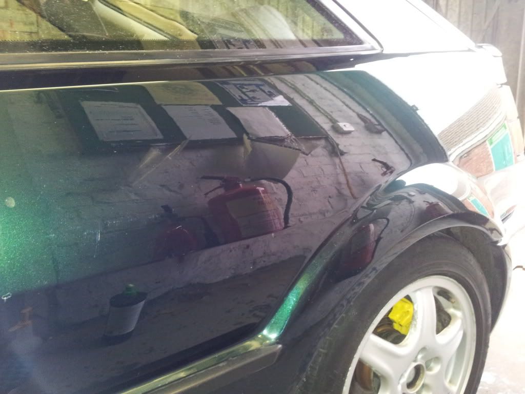

Pearllllllllllllllllll reflections!
I do mate! It looks like there are a few marks in the pic, and I didn't notice until I posted teh pics up. The marks are on the camera lens, or its just polishing dust I think as the paintwork is coming up really well, although there are a few deep scratches that I'm not comfortable cutting back without a PDG, and a few areas of lacquer peel that I can't do much about. I'll bang up some completed pics when its finished and list what I've used to get there.

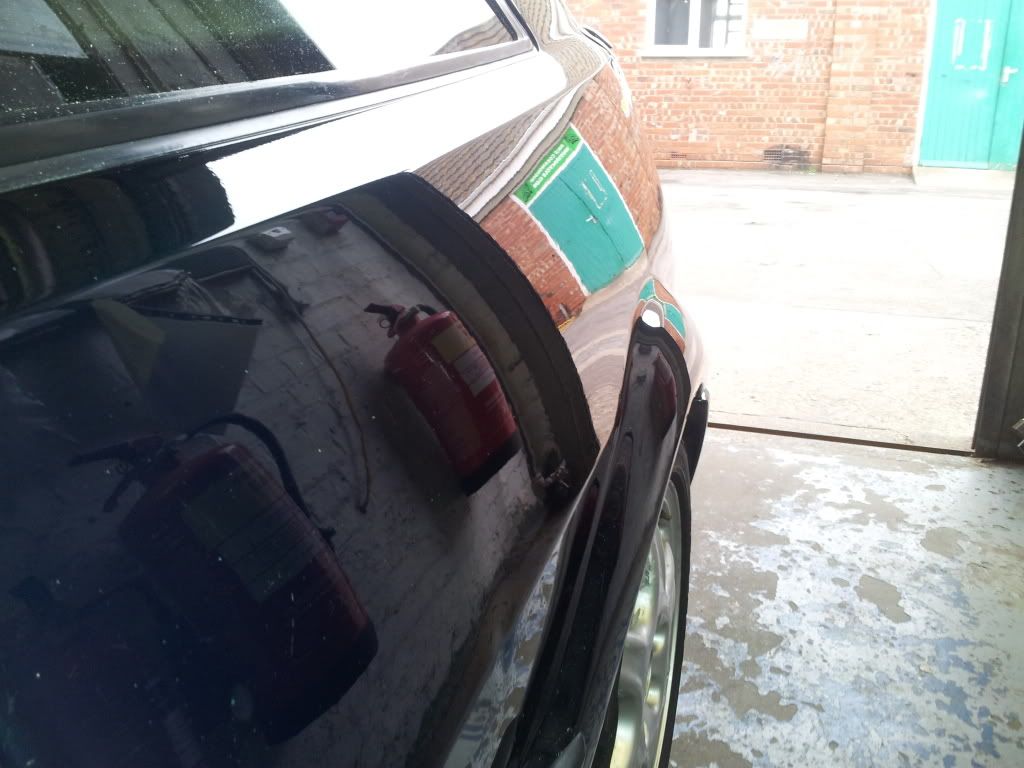

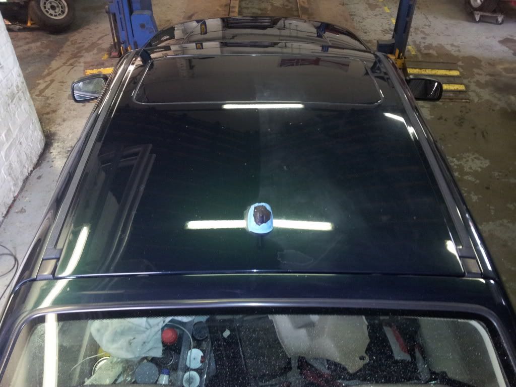

Now finished the bodywork detailing stage, pretty happy with the outcome!
The paint is too far gone in a few places, but at least the polishing removed a few of the scuffs that were mostly made up of paint transfer so not quite as bad in a couple of areas. Electrical and mechanical problems need to be sorted first though, so dash out time and wiring sorted next.

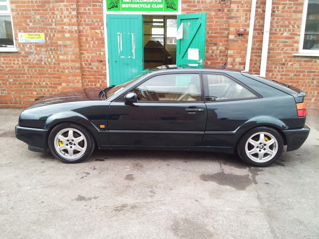

Some pics, although its pretty overcast so no real reflection shots unfortunately.

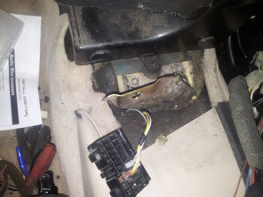

One last thing, does anyone know if this first pic is right? It looks to be the wiring coming from the OBD port, but it looks like it terminates at this box...............
