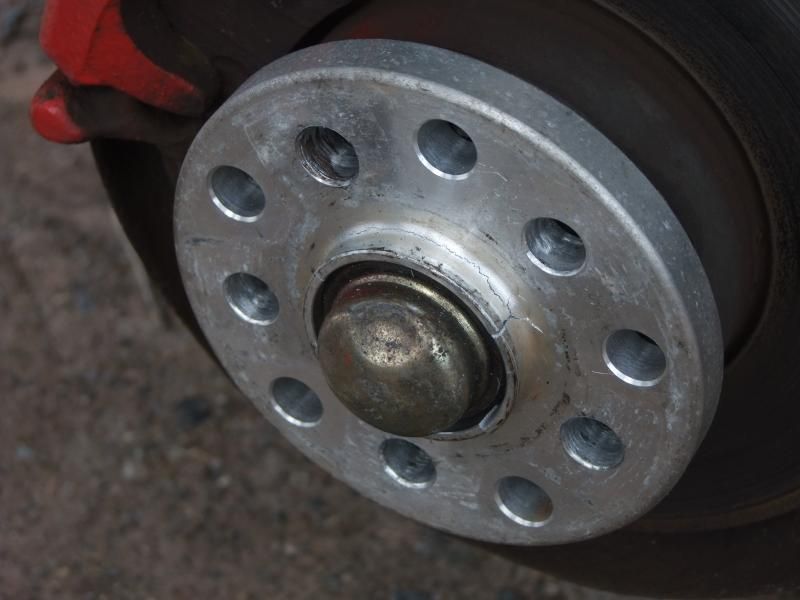

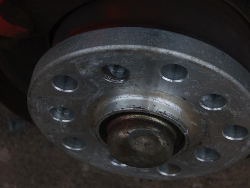

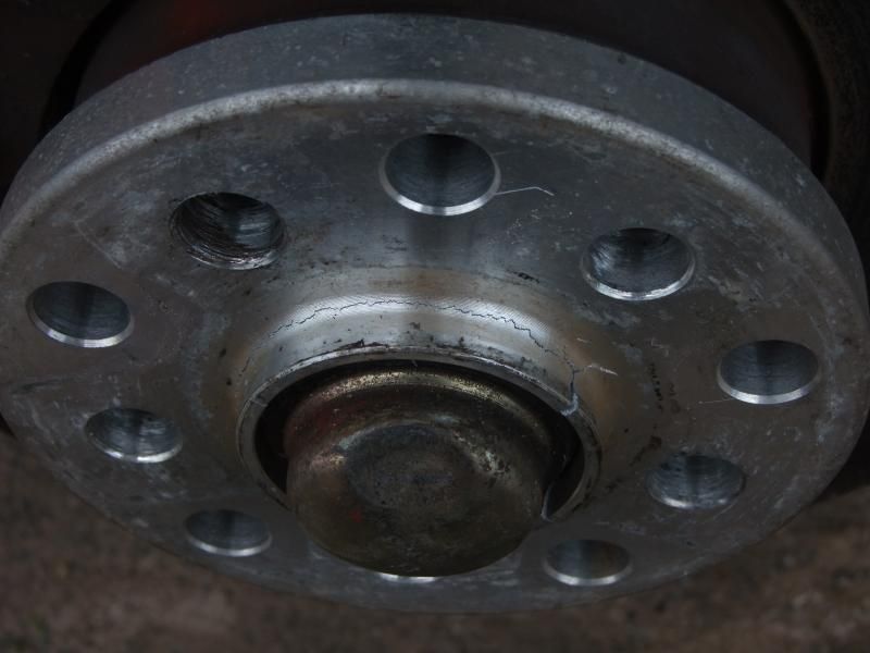

I don't like wheel spacers, although i'm sure lots of people will say there is nothing wrong with fitting them I just think they are a bad idea, so when I noticed they were fitted to the Corrado i'd just bought I decided to remove them and this is what I found -
The other side, not pictured, basically fell apart in my hands and is in bits. I'm not sure what exactly would have happened if they had decided to disintigrate at high speed but I wouldn't want to find out. So they are in the bin and I feel a little safer.

Had the same thing happen on some I tried. They were a bit tight going on and then did that when I torqued them up - rubbish. FK's for the record, so even some of the well known brands can be suspect...
the torque from 5 wheel bolts crushing down on the ally spigot because the wheel spigots to small would easily do that to the best of them, im not for or aginst wheel spacers, iv used them and have had no problems,

I had exactly the same spacers as the OP (look not make) and the fronts were fine. However on the rears, like on the pic the centre lip part of the spacer had sheered clean off!!!
