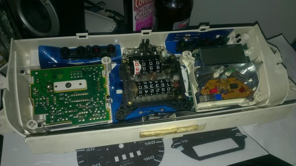

Odd place to start, but after snapping cartilage from working on the corrado, I've had to take a bit of a lighter set of tasks.
I like the corrado dials, but they really date the car. Nothing much I can do about the analog speedo, But I'm damn well gonna try.
Dials look a bit crazy without the fronts... and sadly I snapped the tacho needle trying to pry it off..

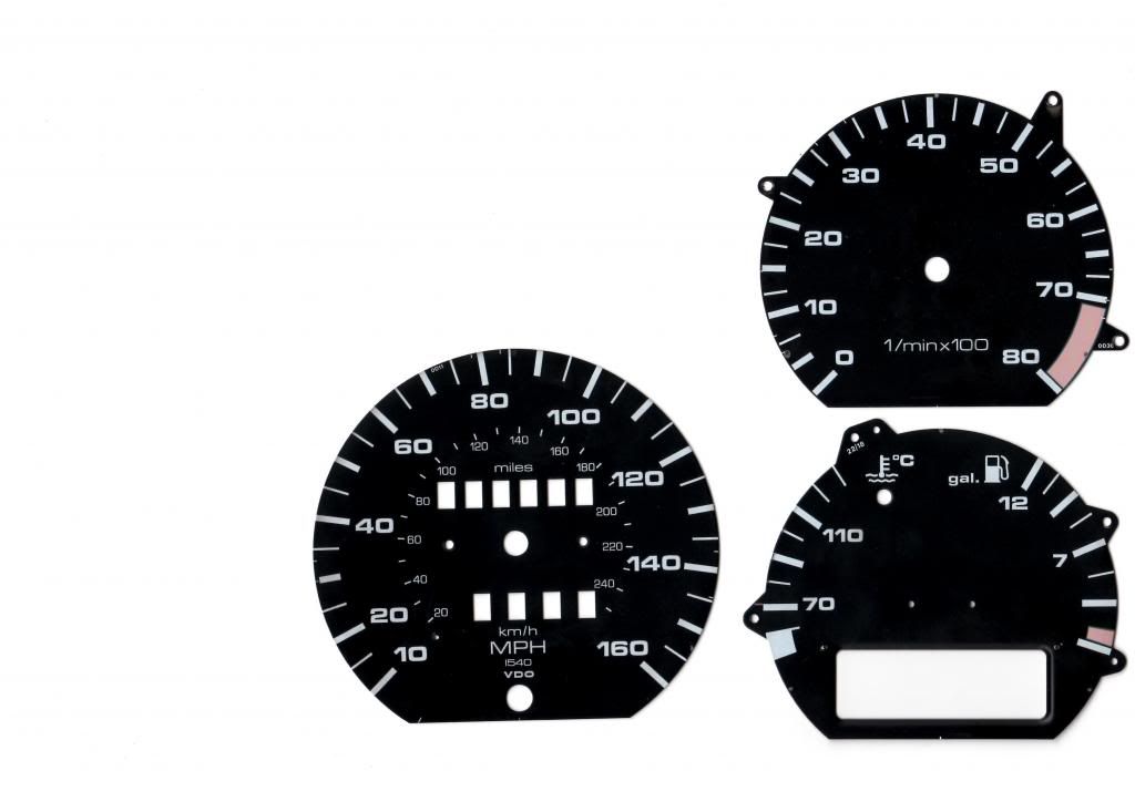

This should help anyone looking to custom create their own dial facings for the early 'rado's.

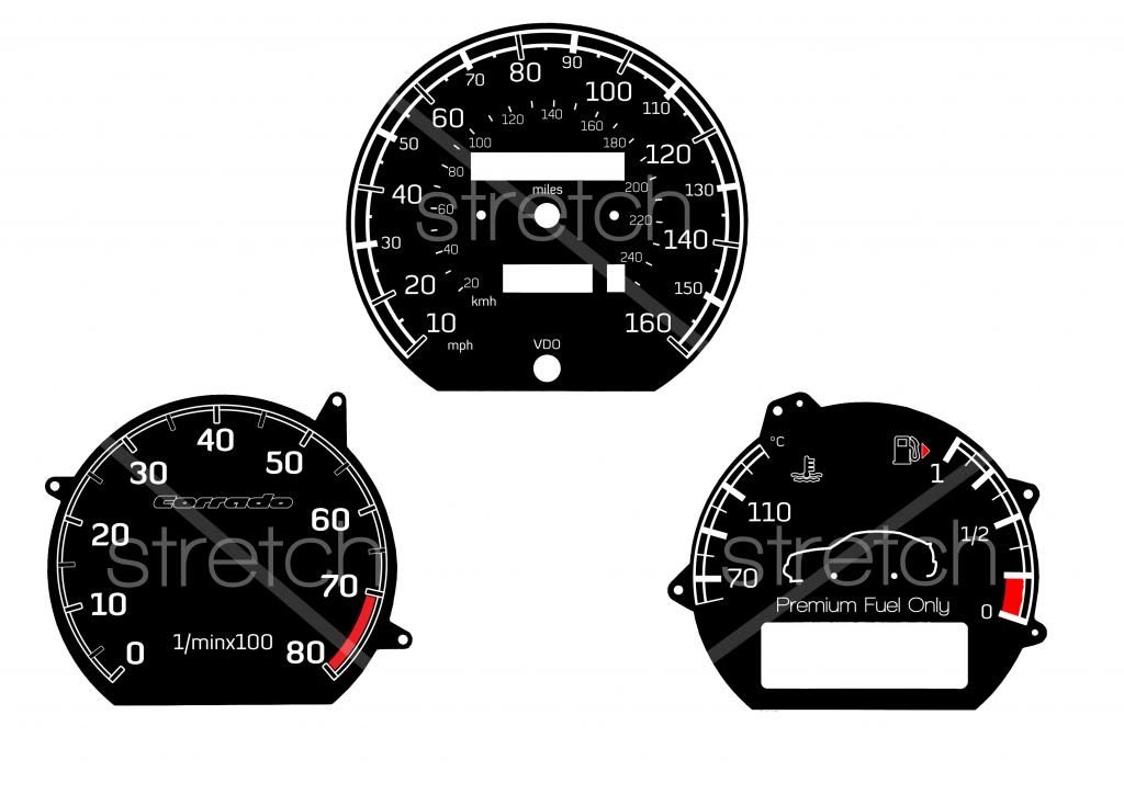

And what I am to have them looking like.
All the white area's will be back lit, there's room in the dials to mount a few ribbon led's, or maybe even set up a nice pcb to mount some SMD's to.
Also, going to be re-working the bottom row of warning lights, so they'll be back lit icons, like on more modern cars.
The plan is to print them on transparency film, like the type used in overhead projectors, any portions I want a different colour for, I can change with coloured film.

Thanks, just used Photoshop, some people who've done the same to other cars have used illustrator, but I stuck with what I;'m comfortable with.
The first successful print was unsuccessful!
It printed and dried perfectly, but the size was slightly out, and the colour was patchy and semi transparent at best, I'm going to try and fix the size issue, then try multiple overprinting.
---------- Post added at 11:36 AM ---------- Previous post was at 11:58 AM ----------
7 Complete overprints seems to be the right kind of amount for the printer I'm using to get the opacity level I want,
Edited by stretch.
Okay, well the dials are pretty much finished now, after going through about 7 different designs, 3 black ink cartridges and umpteen sheets of PHP paper.
The visible front should be printed in reverse, I tinted it 3 times in total.
Next, I printed a black and white copy onto some decent quality paper stock, I overprinted this twice to get a true black colour.
The two were then.carefully joined together, with an additional blank transparency behind to protect the paper. and the gaps for the odometer, screws and needles was then cut out.
A word of caution here, do not use more spray mount than necessary, otherwise the ink on the paper and the visible transparency will bleed.
These cut outs were then used as stencils on a sheet on electro luminescent paper to provide the backlighting.

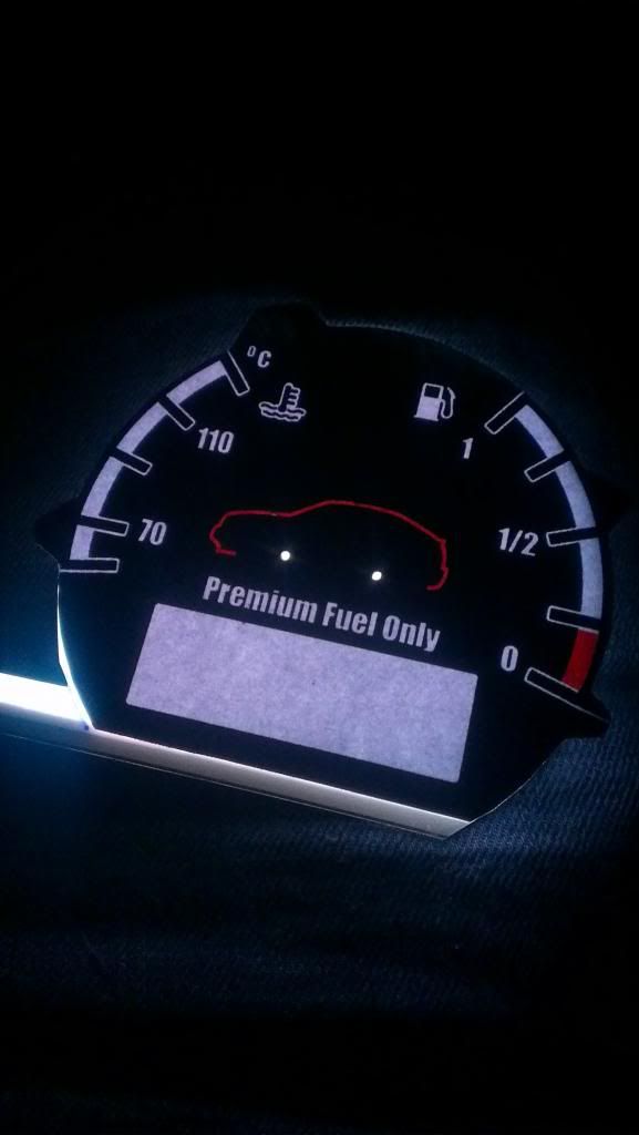

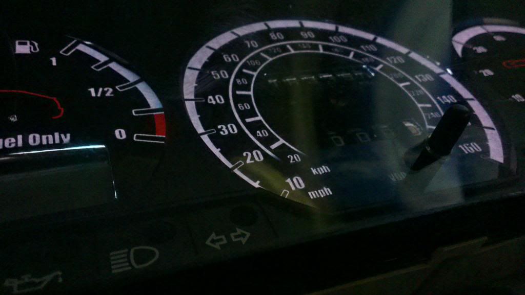

First of all, a few shots I had on my computer of the lit dials:
They look nice, but I’m not 100% happy with the execution, but it was an admirable first try.

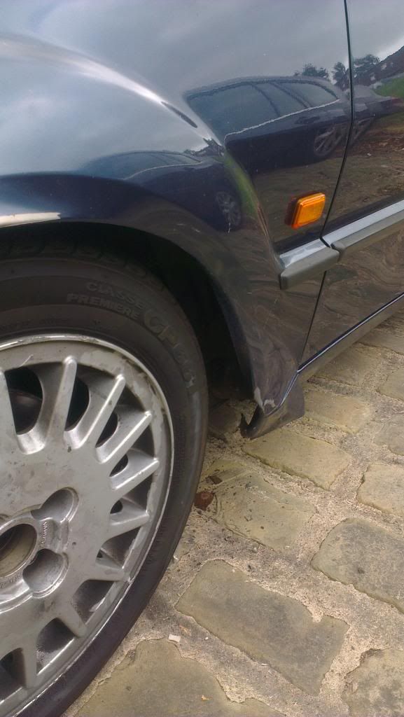

Then, the wheel fell off.
Not figuratively, literally.

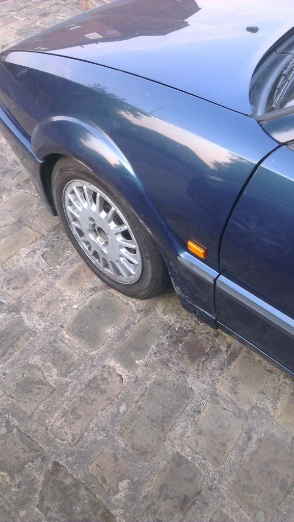

Gutted. This was the only decent wing on the whole bloody car!

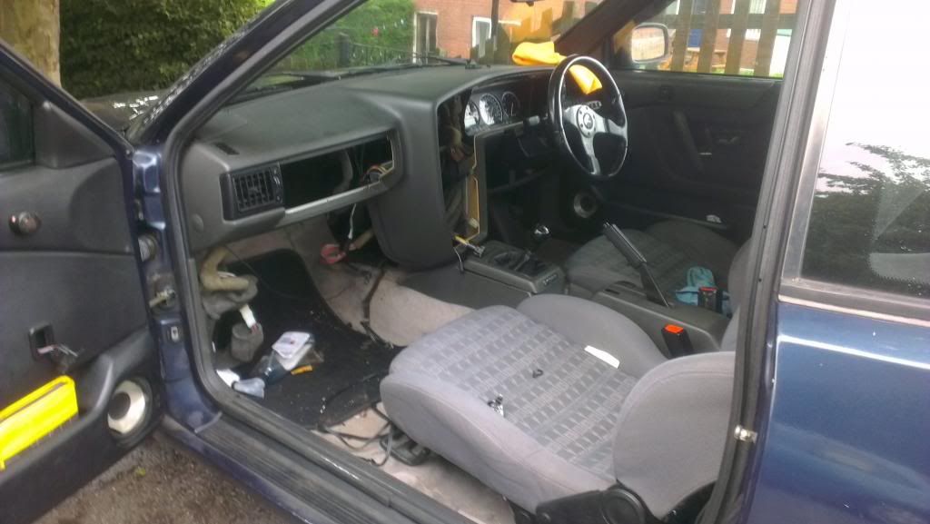

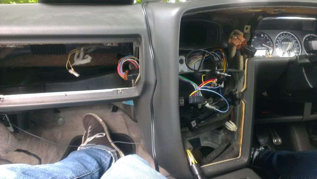

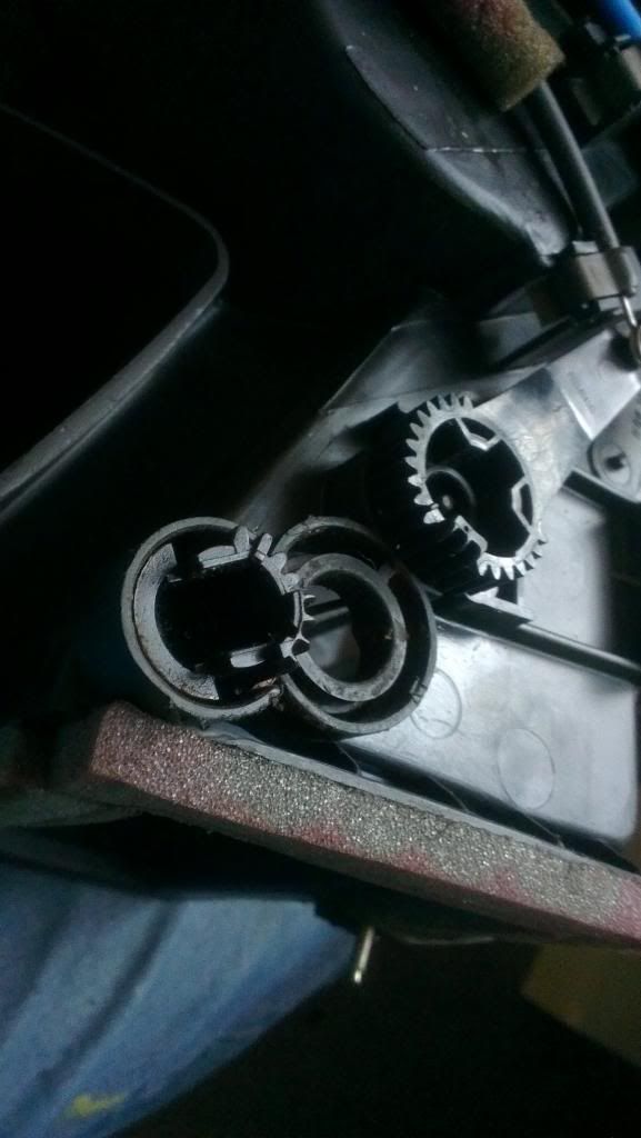

While I was waiting for those to turn up, I decided to make a start on the heater matrix. So I studied up, read the guide on how to do it (without removing the dash) backwards and forwards about 100 times, which didn’t take long, as it’s only about 6 bullet points (warning sign!)
After 8 Hours, I have this:
Not too bad, for a ham fisted person like me! Except, scraped knuckles and the worry of remembering where the bajillion fixings went back wasn’t my only issue.
Oh no.
The hot air exchanger box (air box, interior air box, heater box, stupid ****ing flappy thing) control cog had disappeared somewhere. Which is odd, as I remember everything working, albeit that was over a year prior to this point when I last had working heaters.
I managed to get a replacement heater box from Luke at Obsessive Compulsive Dubs Disorder (OCDD).

[*] N/S wing fitted and painted
[*] O/S wing straightened and repainted

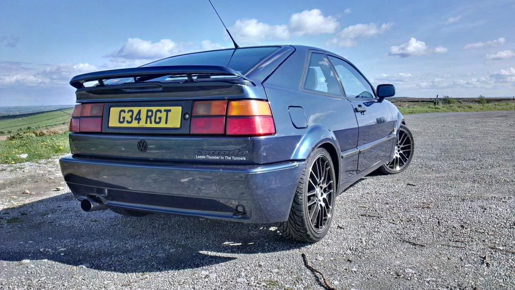

Here’s a pic of the car after the respray,
Just need to find another centre cap and nut now, as one of the local rapscallions has had away with one.
