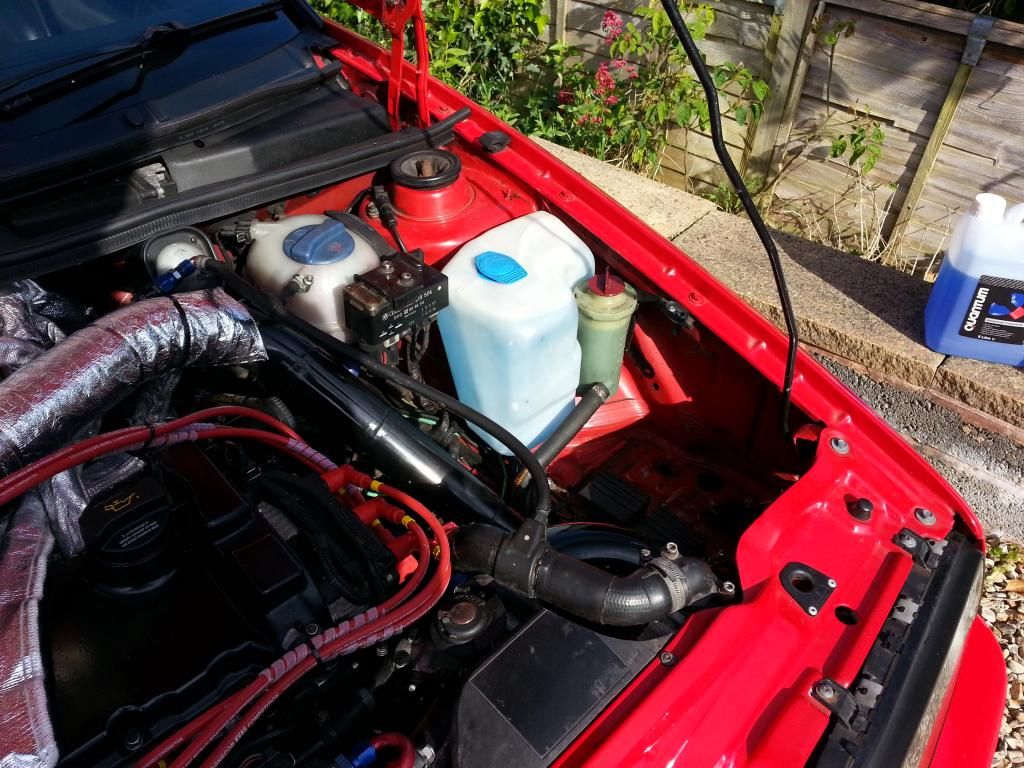

Blew the heater return hose whilst cruising along at 70ish. Pulled over just before all the water had emptied itself from the engine, so no damage done.
The hose was a Samco and hadn't enjoyed its life next to the turbo. When I went to undo the small jubilee clip off the thin diameter pipe a bit of the pipe just fell off. As such I went with an OEM replacement made by Meyle.

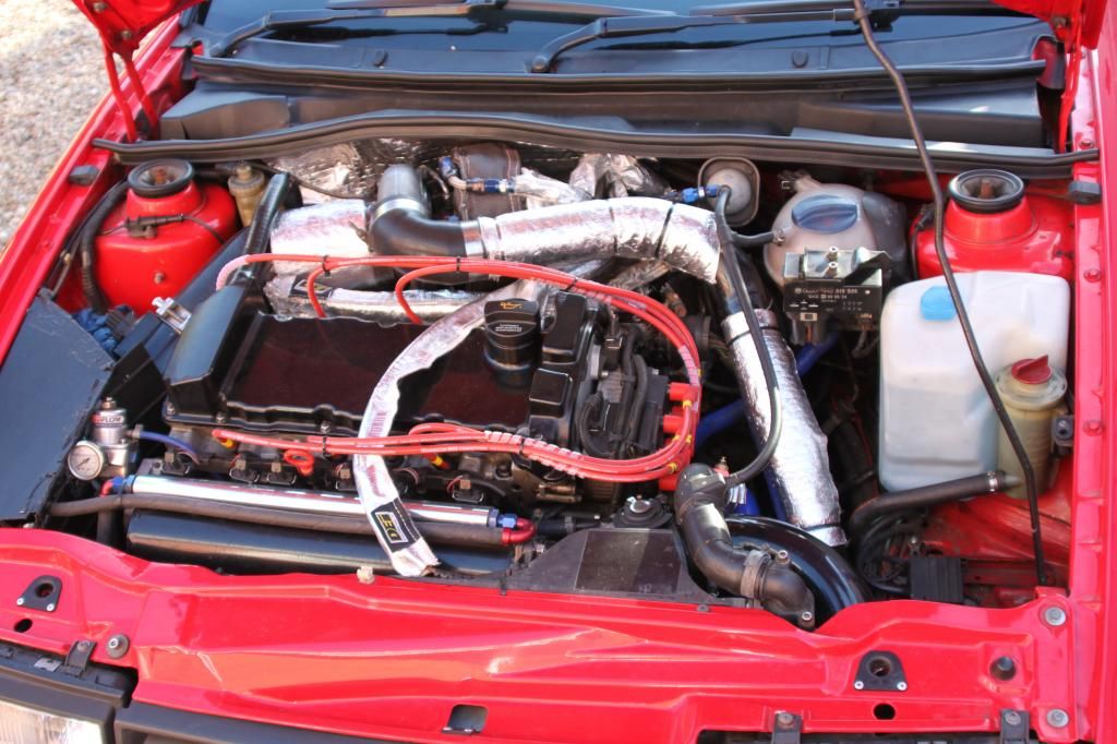

All of the heat sheath and mat around that area was really manky and most of the reflective surface had flaked off. After spunking £60 replacing a lot of it the engine bay is now a lot tidier looking. Ordered a Turbo blanket too, but that may take a few weeks as it is coming from China.

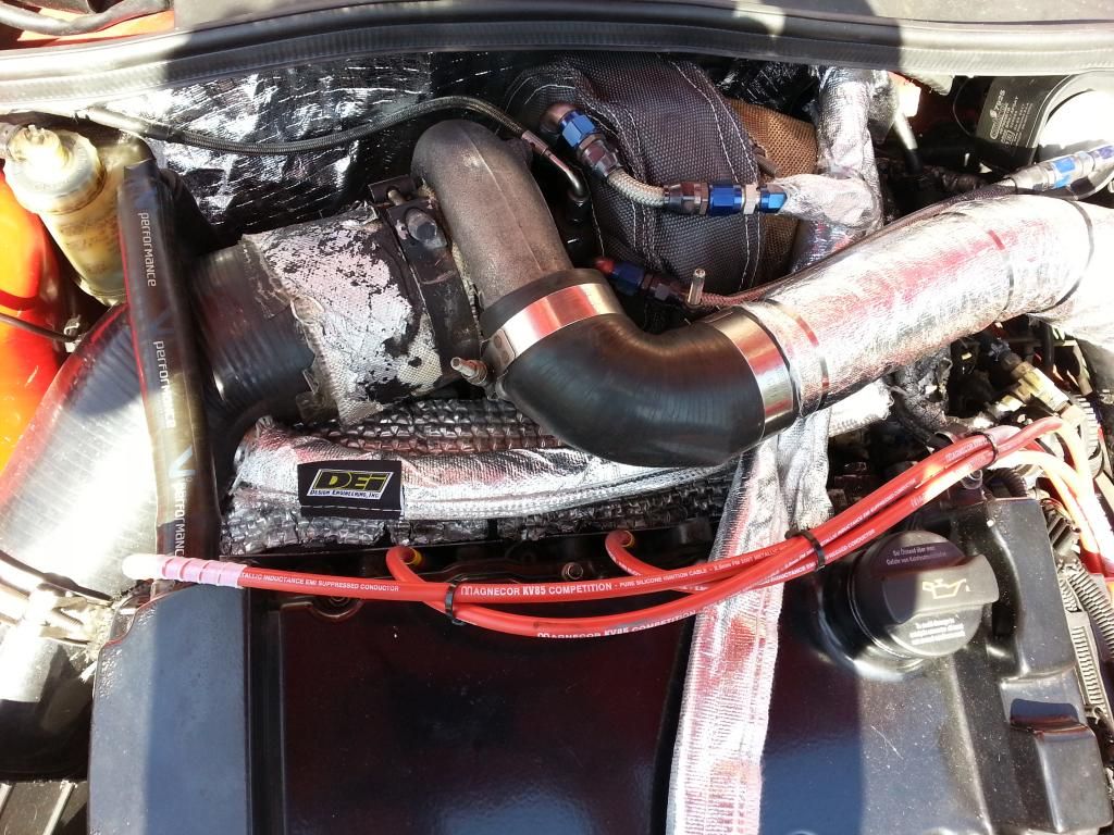

Turbo blanket arrived from China today. Took just over 2 weeks which ain't too bad and they put gift and $2 value on it so no import charges. :thumbleft:

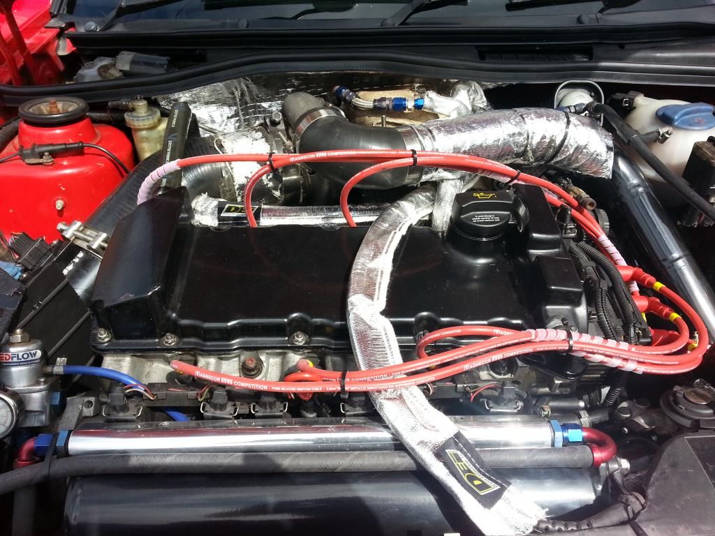

Having removed some corrugated heat shield from the turbo to fit the blanket I gave it a quick scrub and fitted it above the existing manifold heat shield to try and further help intake temps.
Also had the wash bottle off as it had some black crap growing in it. Quick blast from the hose didn't shift it all so I managed to jam the dish brush inside to give it a good scrub, along with the outside as well.

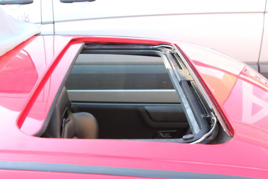

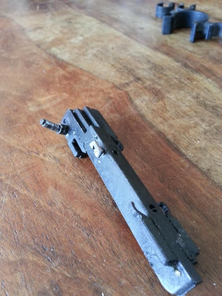

Fixed the slide on the sunroof. Much easier than expected even though I had to repair a rear slide with a screw then grind it down.
Doesn't quite go all the way back but only did this 2 weekends back so not had a chance to investigate why yet.
