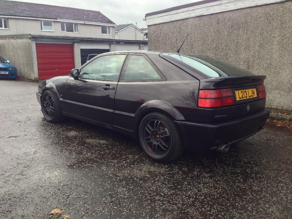

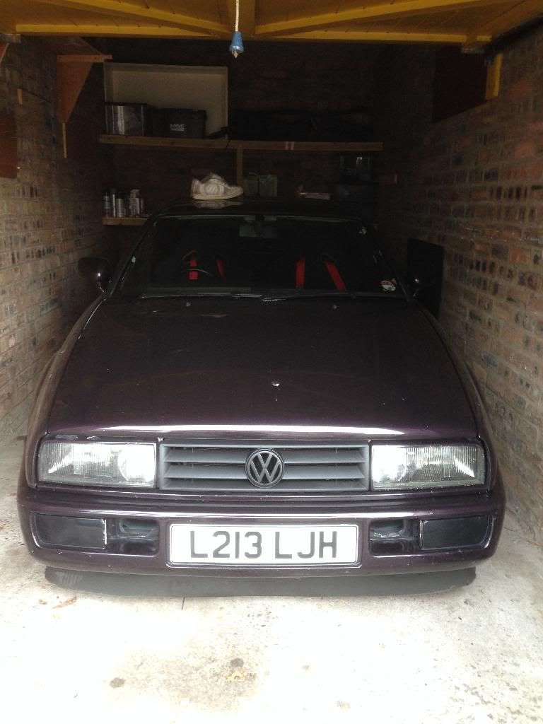

Pics of how I picked it up.
Cheers J
Cheers Lee.
Been a busy bee yesterday.
ReFitted all red rears, 20mm rear spacers, my vw contours, stubby aerial, lowered the front about an inch, got rid of the carbon in the bay, not to my taste. Went for oem caps and battery cover.

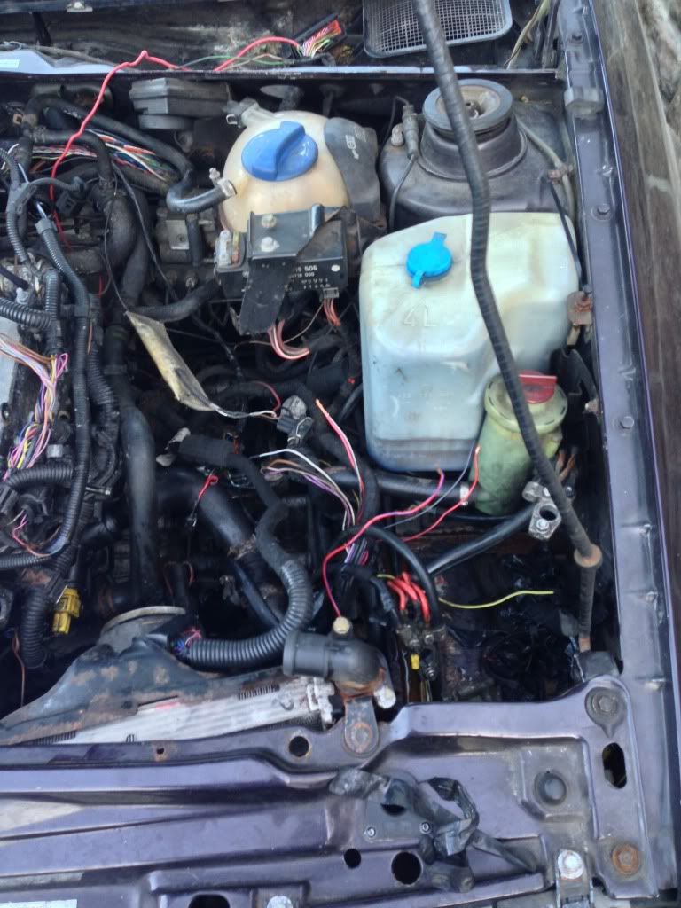

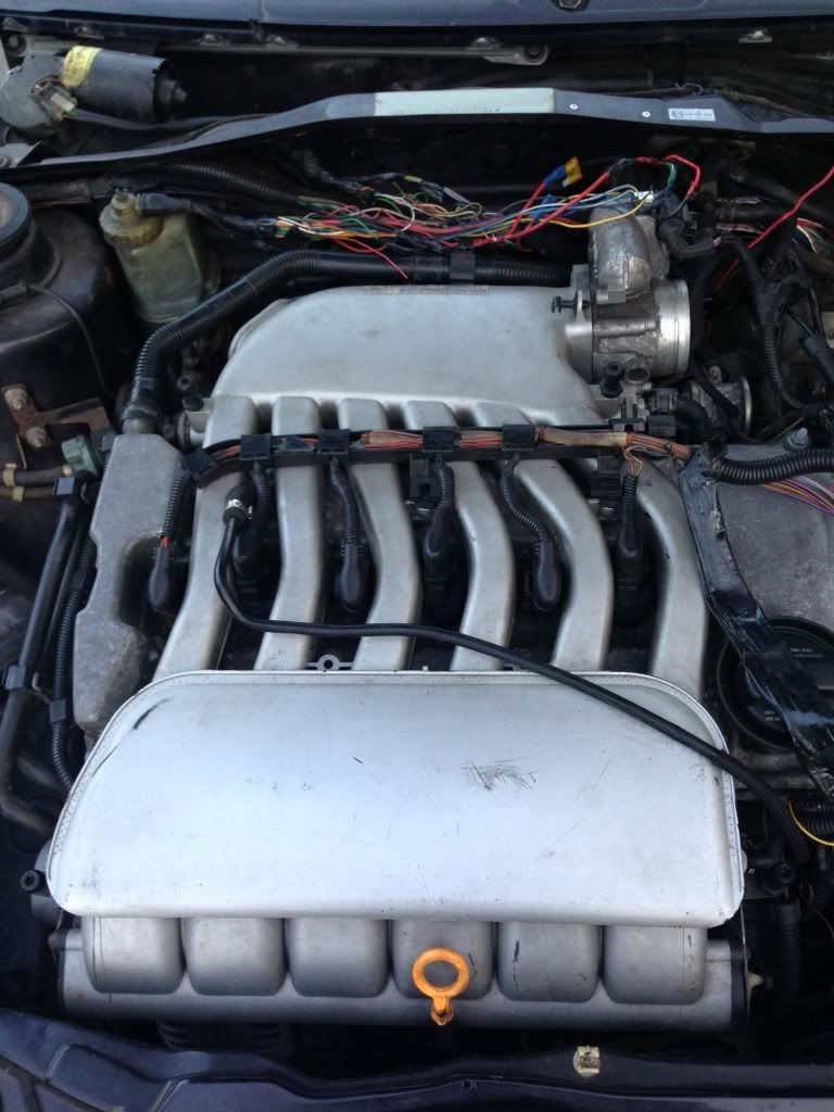

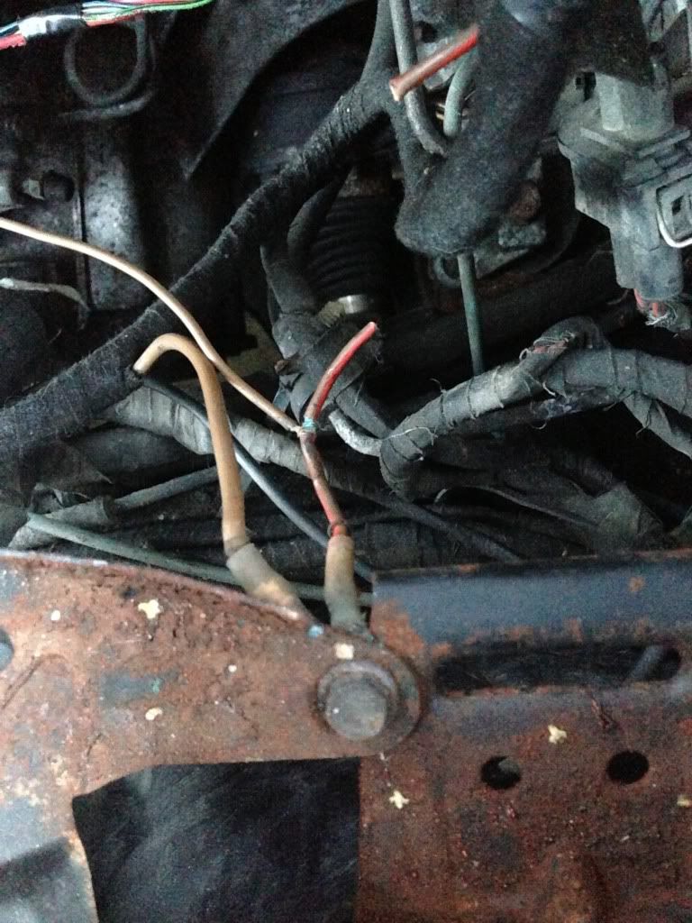

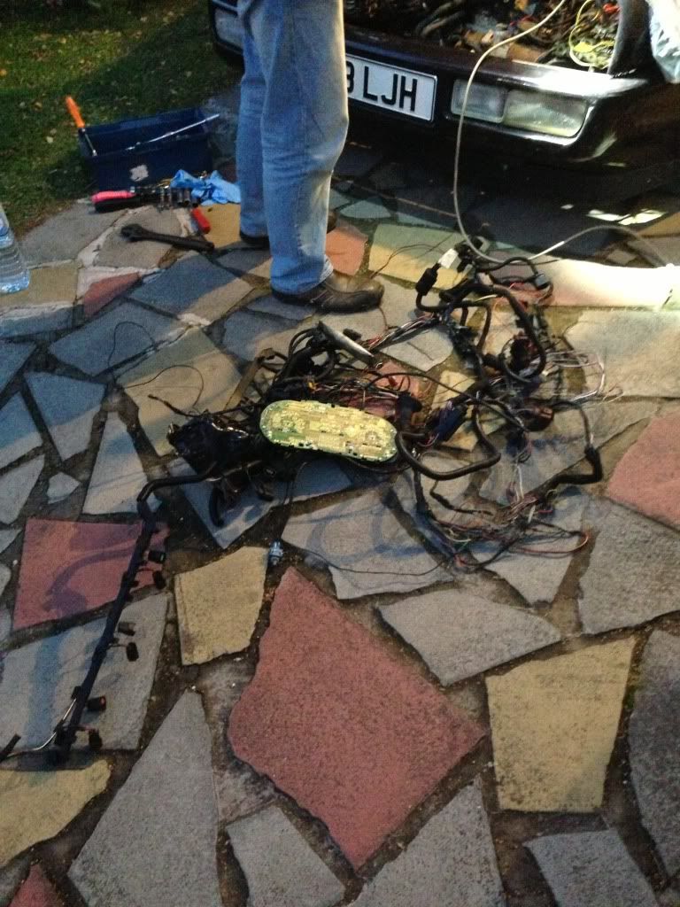

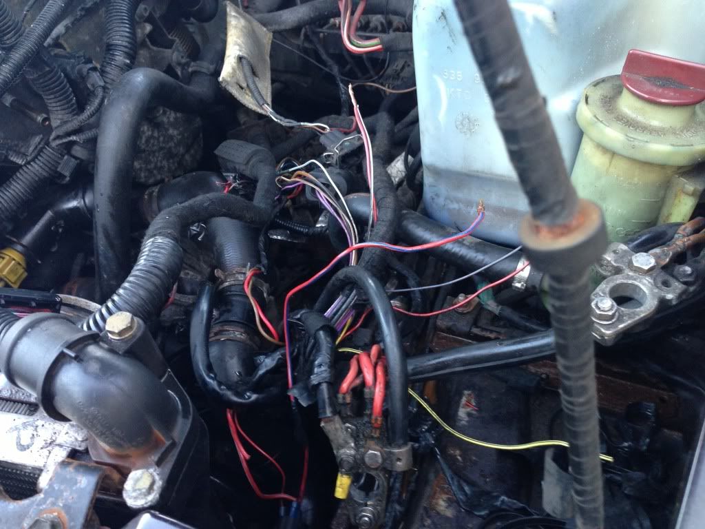

Well a lot has gone on since I was last on. Mostly the car set it's self on fire due to a completely bodged engine loom.
Full new loom, new fusebox, replacement ecu, alarm removed and she's back on the road!
I'll let the pics do the talking.

Jay, you've missed the one with the MK4 clocks still connected and stuffed up inside the dash :shocked!:
That's how the experts used to suggest it was done so you didn't need to pay for immo removing.
Looks like some nasty joins you had there, glad your getting it sorted
After getting the car back from willy it still went into limp mode. He kindly took another look at it and found psi hadn't bothered to fit brake or clutch pedal switches, so it kept going into limp mode. William fired some switches in and wired them up. It's fecking awesome now, the love is back!

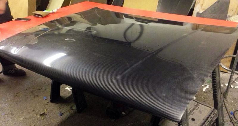

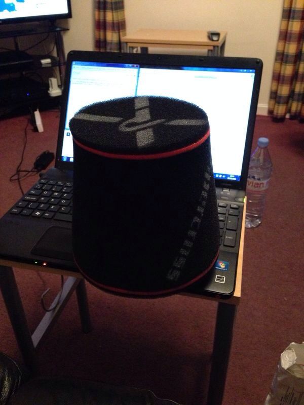

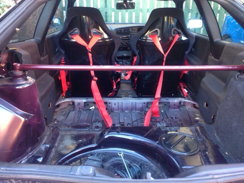

Been busy few weeks got some stuff did, 288mm brakes, huge filter, stripped out and seats in. Has since moved the harnesses as they were at the wrong angle. Waiting for carbon bonnet to come. Perspex windows next
