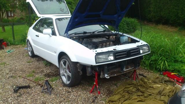

Jon_vr6 1 Posted June 11, 2013 (edited) Yeah i use a weight lifting bar when removing them bolts goes over the breaker bar and sticks out far enough in front of the car to saves climbing underneath, used it on my car and the GFs VR and has worked a treat everytime [ATTACH]74679[/ATTACH] Edited June 11, 2013 by Jon_vr6 Quote Share this post Link to post Share on other sites
