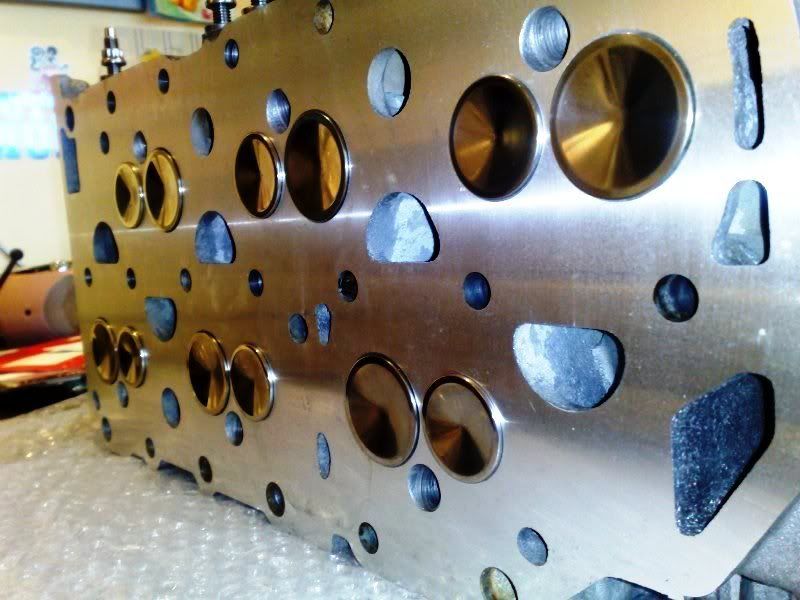

If I may ask - what oversizesize of valve did you select on the BVH?
thanks phil
bvh is schimmel built, 1mm ferrea oversize valves + loads more quality is superb

bvh is schimmel built, quality is superb
I can second that

SPEC:
1mm oversize Ferea Inconel valves
Corrosion pits filled with JB weld then a full skim
3 angle valve cuts
Valve stem diameter reduced
Titanium spring caps and retainers
Heavy duty 7500rpm springs
Port matched intakes
Uprated exhaust studs

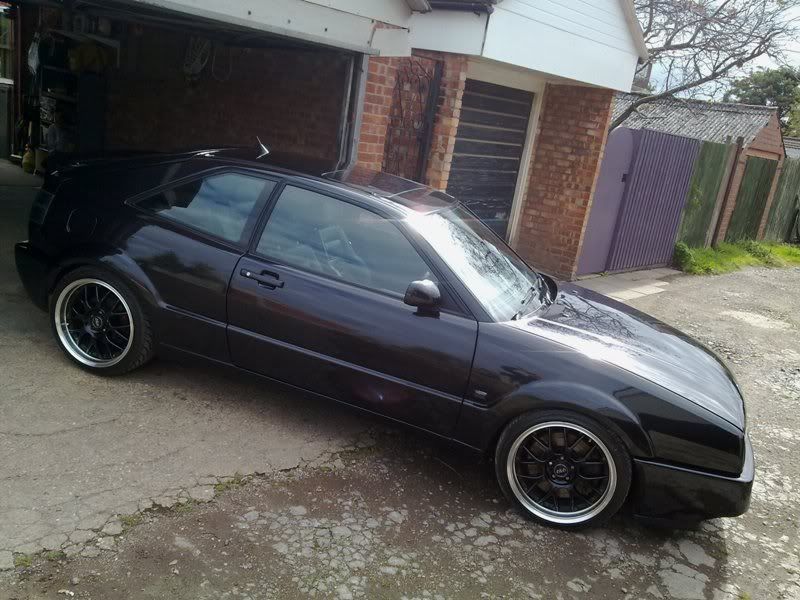

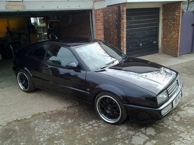

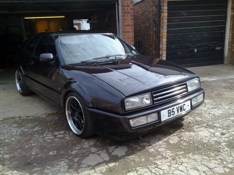

Came back from Edition38 today was a good show thought I would add some pics of the car for a change - cleaned it properly for first time in 2 years...
