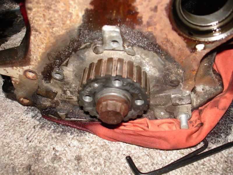

mrbeige 0 Posted September 6, 2007 Tom, this is the 2e piston.... This is the 9a piston.... So we have to change the crank pulley, intermediate shaft, oil pump, dizzy block-off plate. Here is a piccie of the two intermediate shafts. They are pretty much identical apart from where the pulley mounts.... Intermediate shaft bearing shell a lot more healthy looking that the 9a one :D The crank pulley has to be changed along with the intermediate shaft to allow the 16v head and cam pulley to work. Here is the 2e one... And here is the 9a one, note the 9a one is wider... Two oil pumps are different. 9a one is at the front... Also removed the carbon canister and some of the wiring not needed and discovered this.... Clearly there has bee a problem with shorting out and funnily enough it is the wiring for the headlights! A lot of the wires underneath that manky insulation tape, the insulation has completely disintegrated! :shock: Quote Share this post Link to post Share on other sites

mrbeige 0 Posted September 16, 2007 Managed to get some more done on the project (need to keep my enthusiasm up) Eventually, after 6 separate attempts, I managed to finally get the crank pulley bolt out. I'm sure someone had welded it in and the put some threadlock from hell in there! So with that out, I could take the pistons and rods off the crank, then remove the crank. The main bearing shells look in good shape, but I think I'm going to use diesel bearing shells. Conrod shells look good too. Pistons looked a but shabby, but after a quick clean with some degresser and a washing up sponge (you know, the yellow ones with a scrubbing side, from Tescos! :lol: )......Think I need to get a stiff bristled(sp?) brush, to get into the grooves where the rings sit though. Before After The is an odd mark on one of the bores, but I'm wondering if it a fix to the casting? Had a go at cleaning the block up too, looks mightily better already Just need to give the bottom edge of it another go with the 'Tetroclean' and a wire brush, then sort out some paint! Decided to go for the OEM look on the install, so the block with be painted silver (although still toying with doing it black). Quote Share this post Link to post Share on other sites
