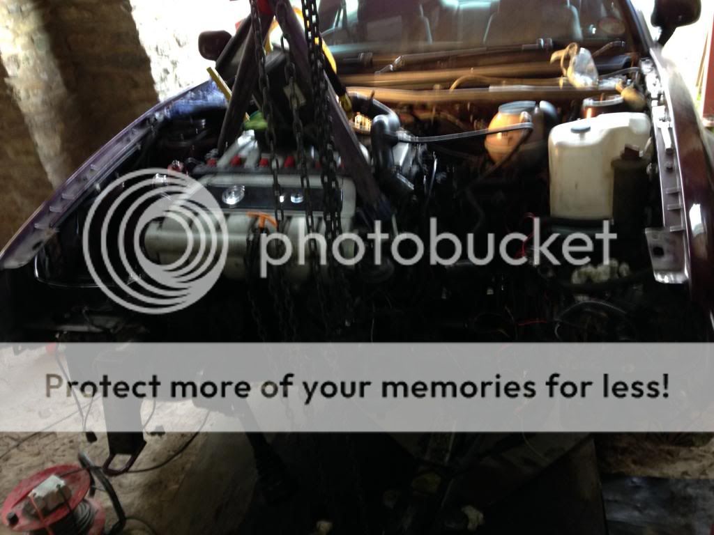

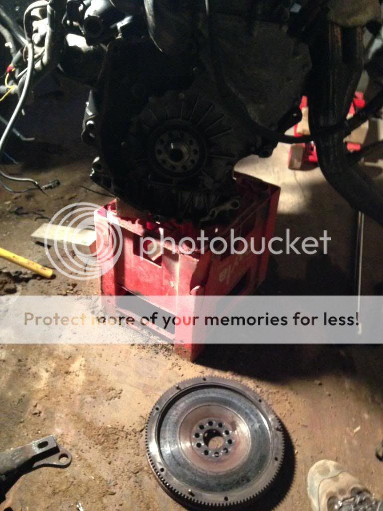

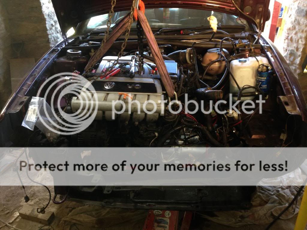

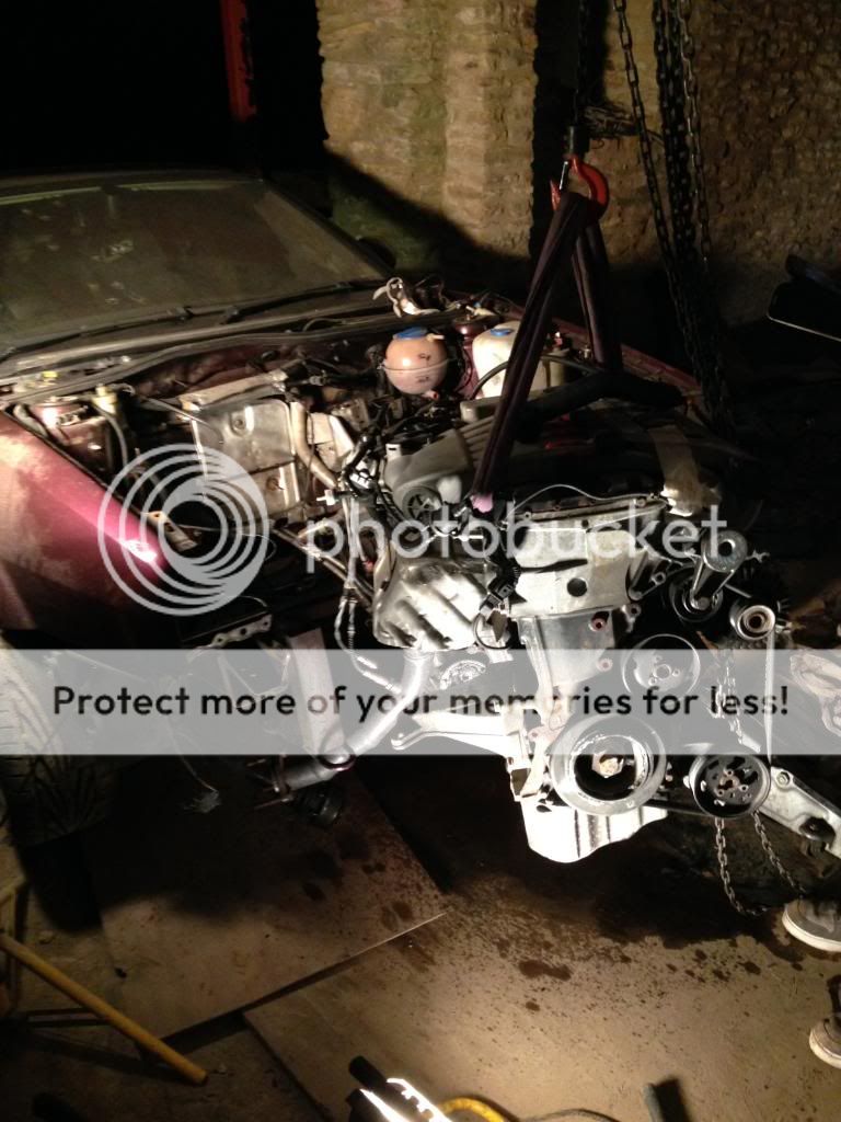

Okay so with clutch still slipping, could only be clutch itself so out the engine came!

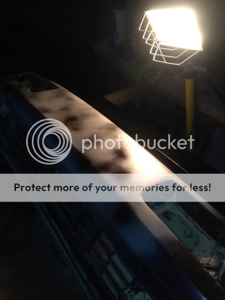

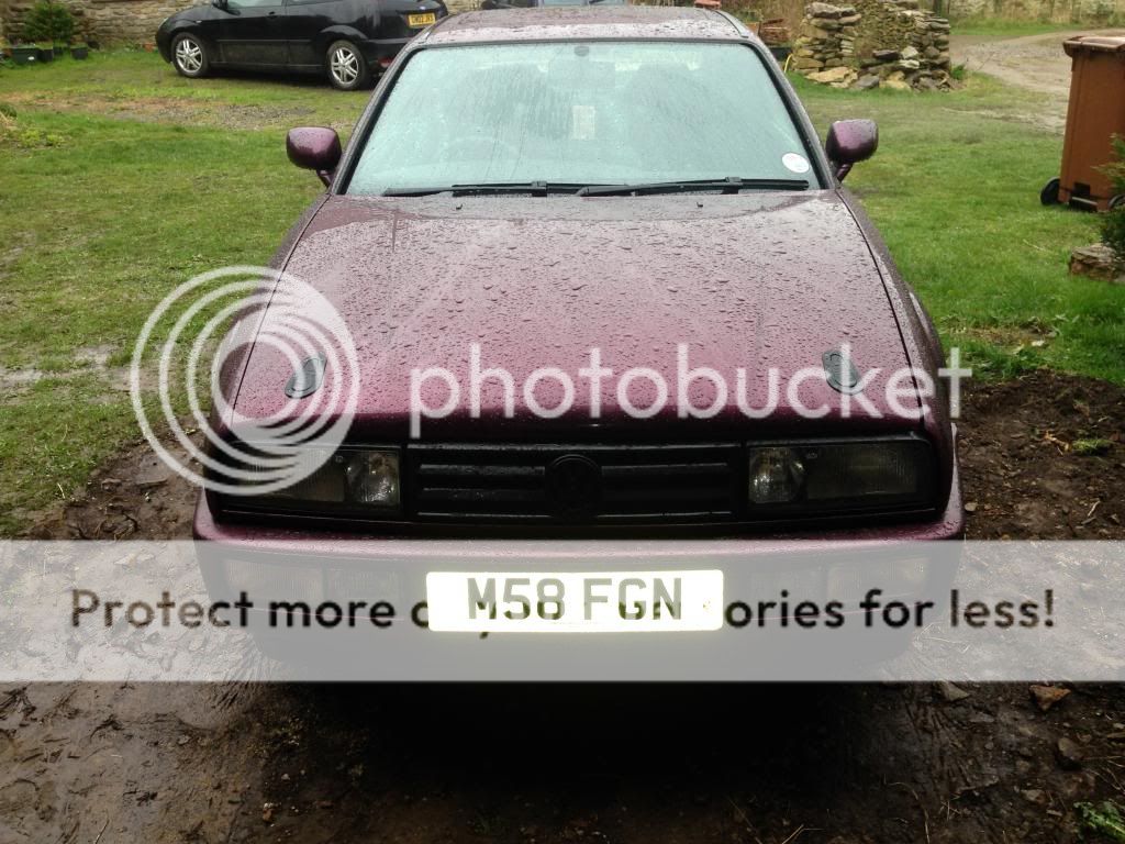

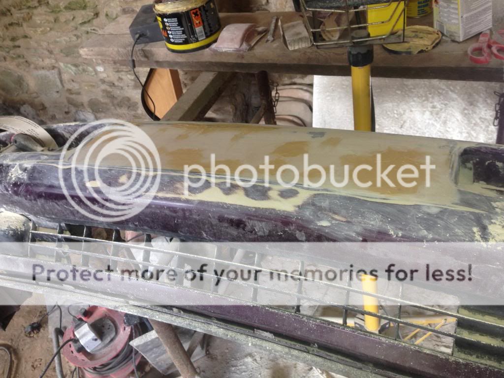

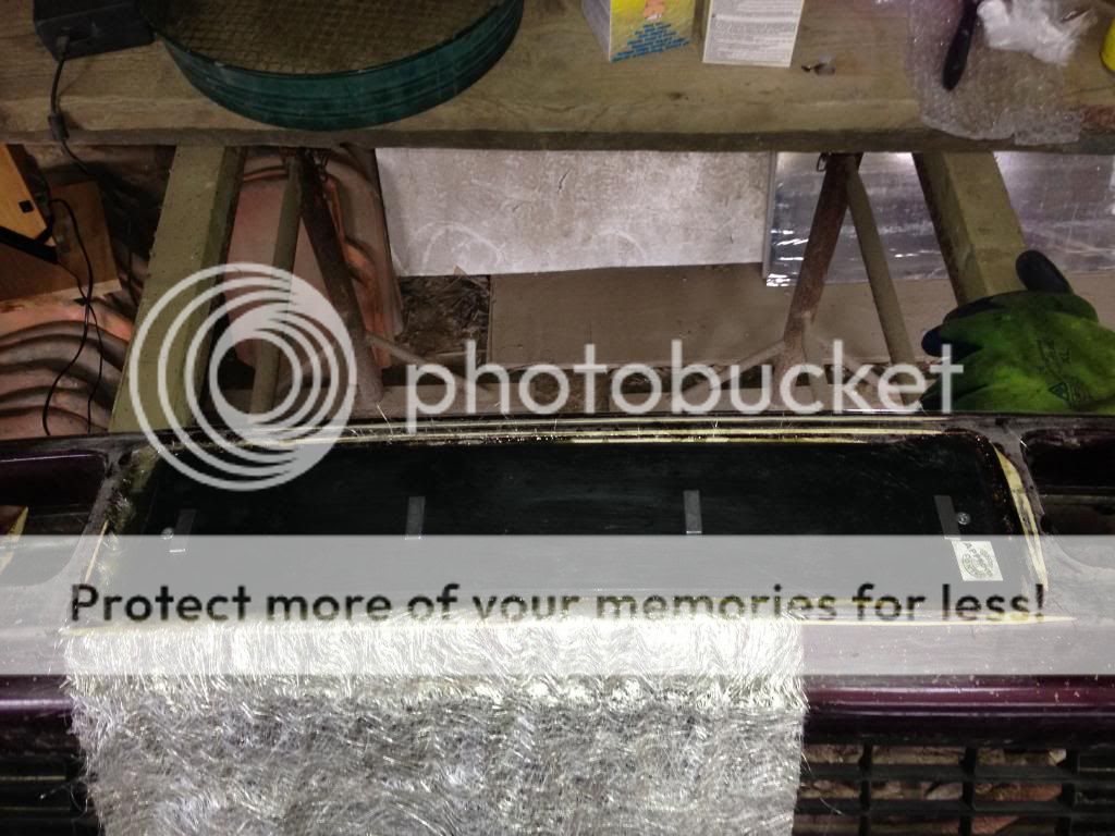

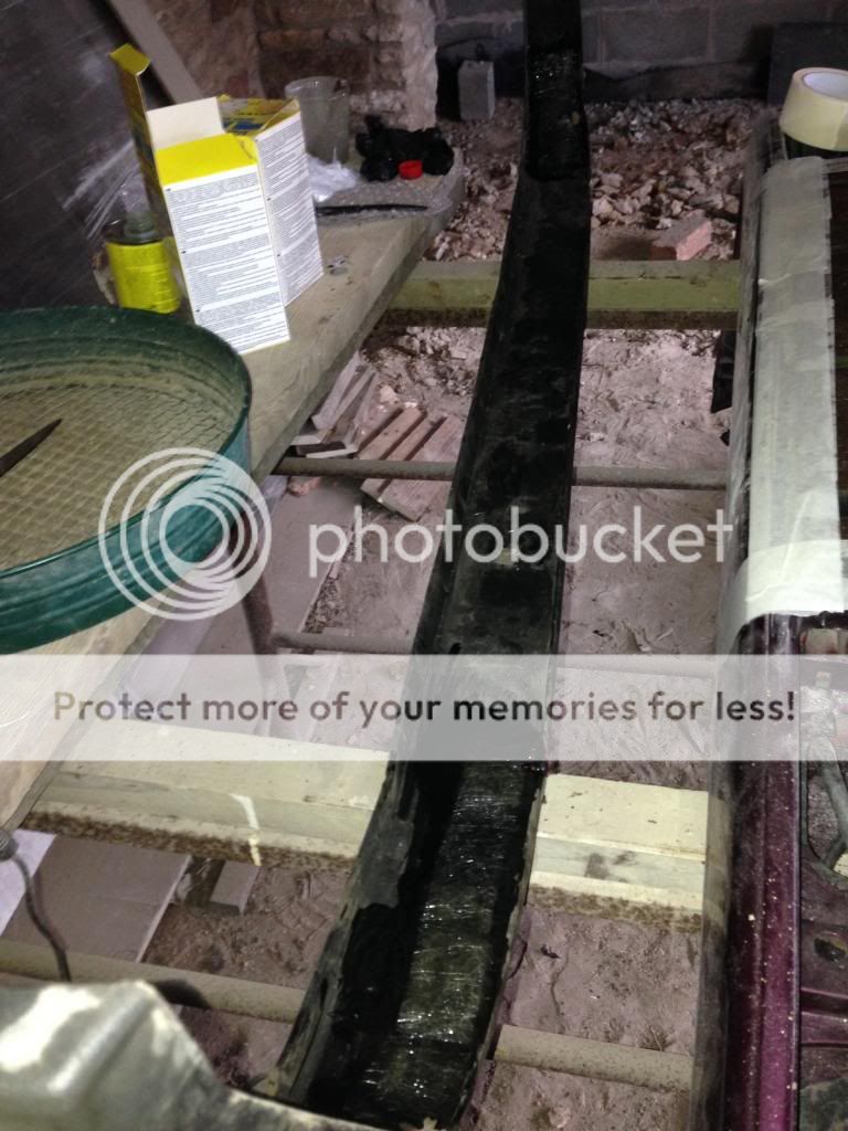

Did abit of bumper work whilst I was bored of mechanical stuff. I fibreglassed in some magnets too so that I can remove the number plate when I want too.

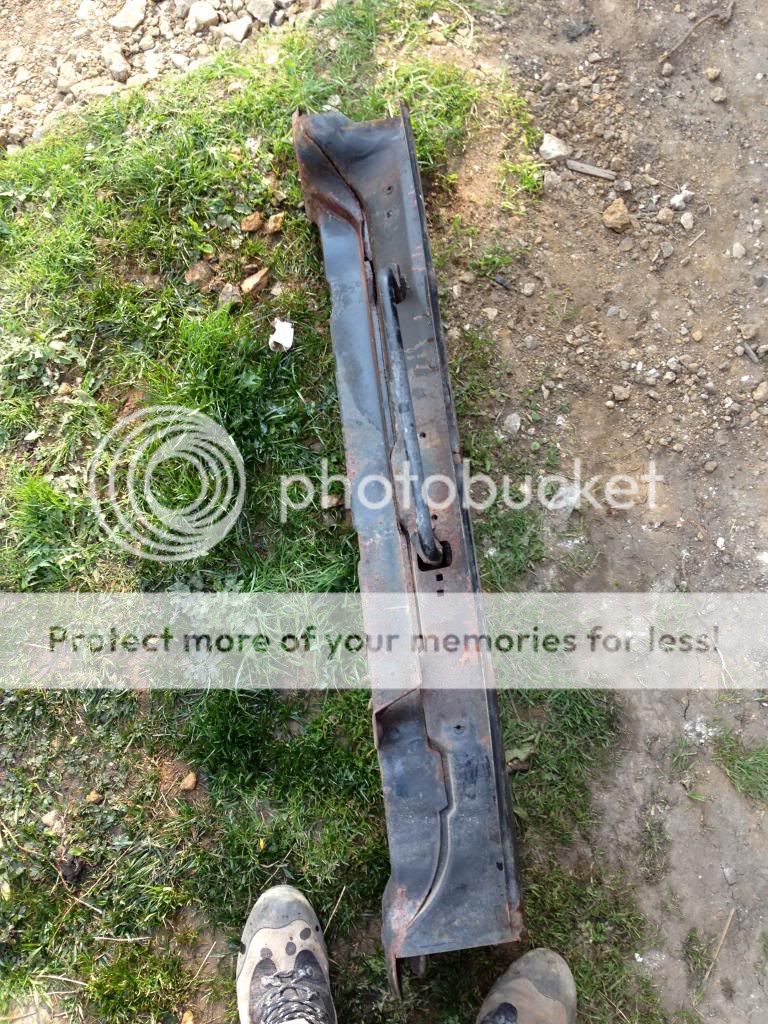

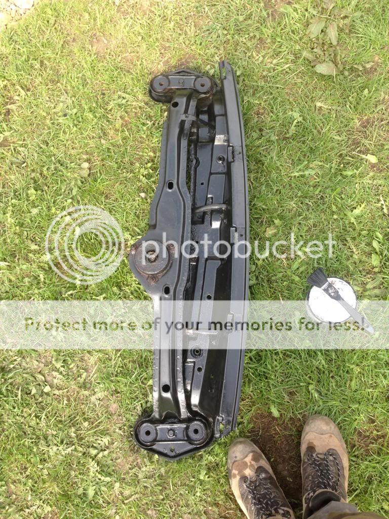

Fixed cracked splitter

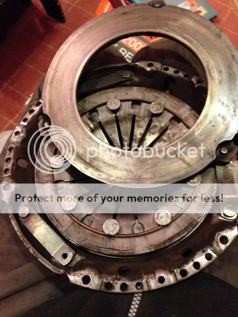

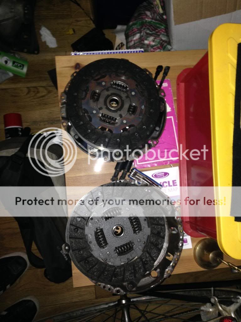

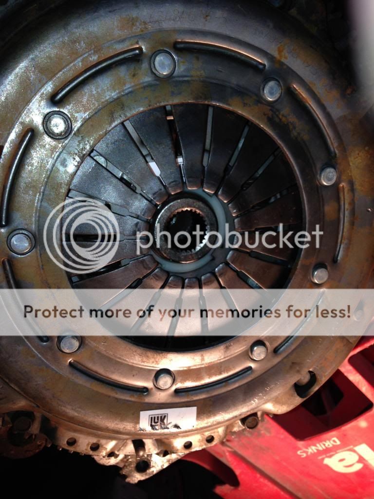

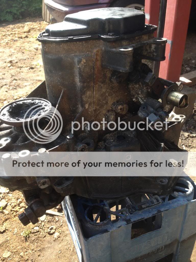

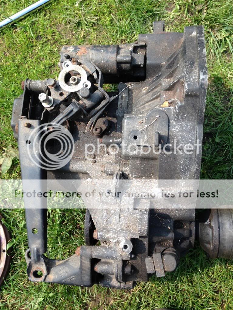

So with the engine out, I took gearbox off and found out why it was slipping!!
It had sheared 2/3 of the retaining rivet on the tangential straps on the clutch pressure plate. Bizarre...
New LUK clutch on (well, had done 100 miles in a vr in my shed before I took it out my mk2)IMG_5268_zps0a8ec066.jpg

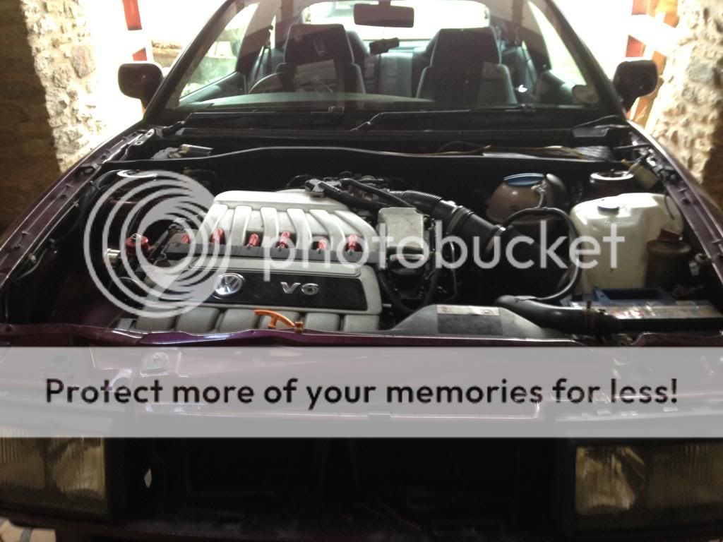

Back in:
Back together and running, clutch worked! woo.

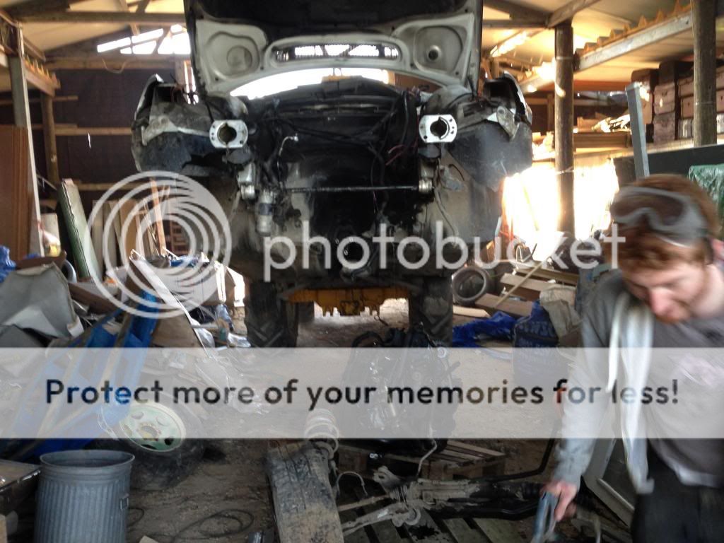

Bonnet catch broke meaning the bonnet was stuck shut, after ALOT of faffing I got it opened. Was v. ****ed at this point so out came the hole drill and grinder.

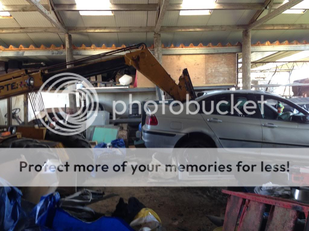

Did abit of spring cleaning of my mates beamer

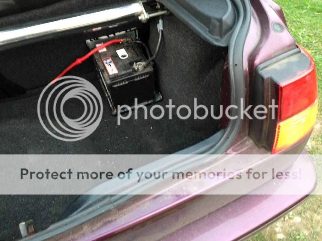

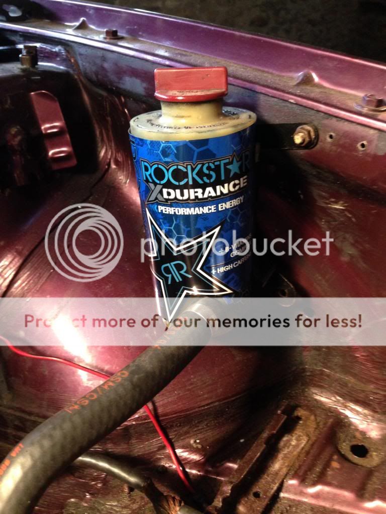

Re-located the batter into the boot with the beamers battery cable.

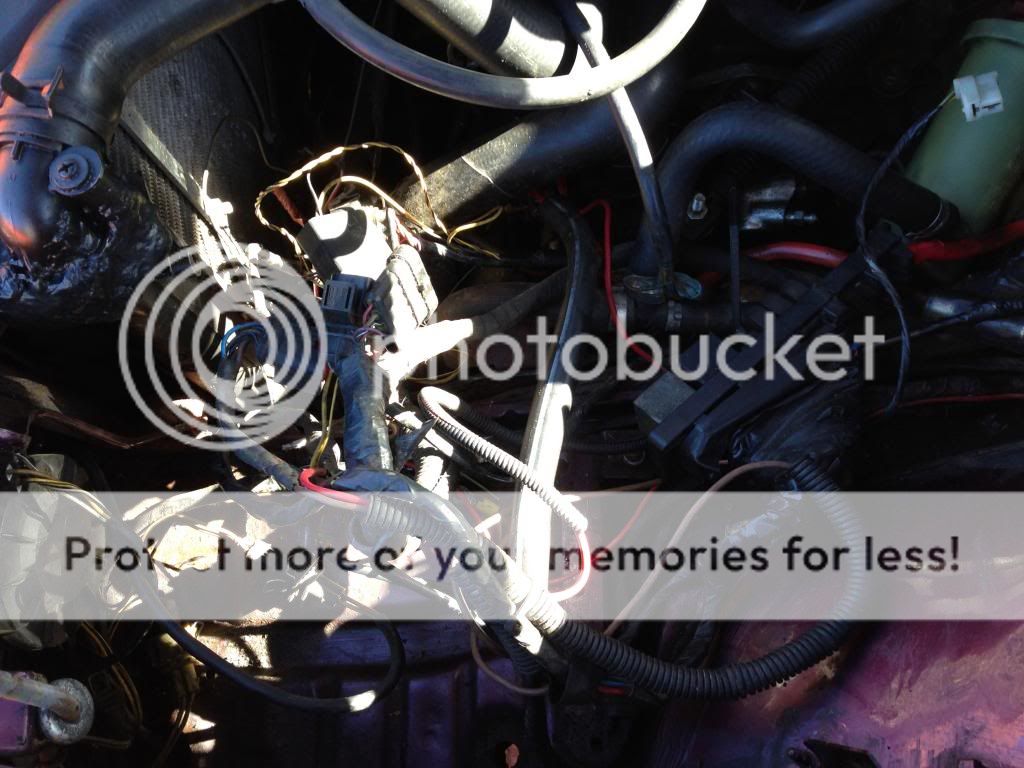

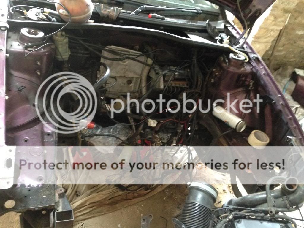

Wiring mess in the bay:

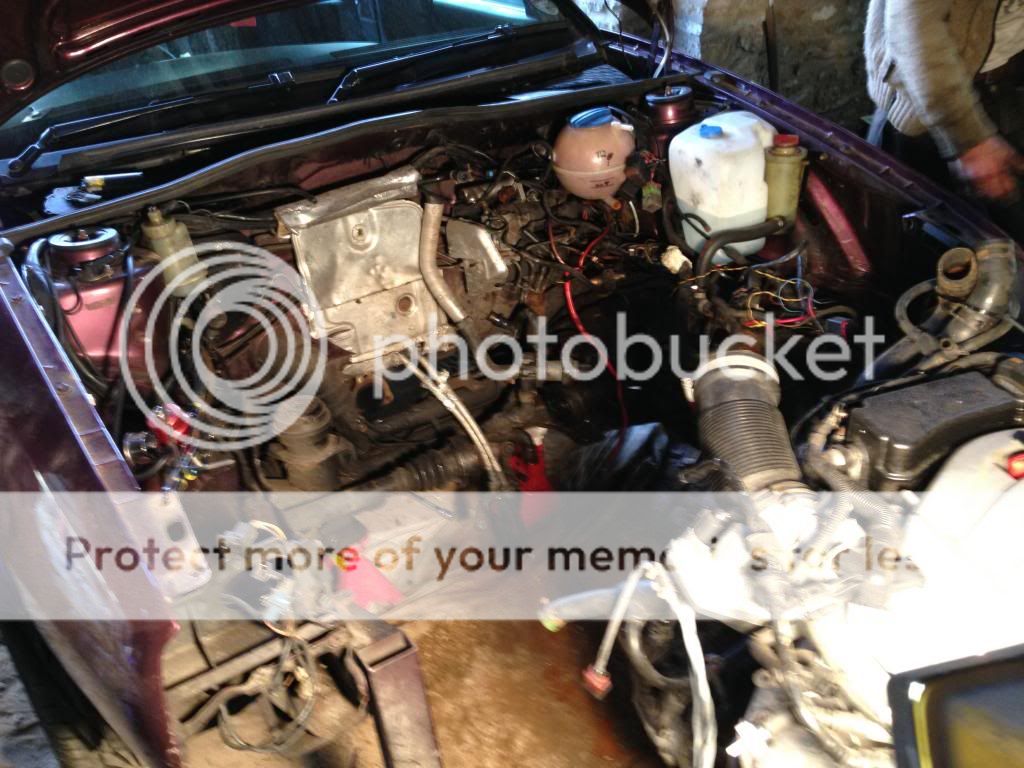

Aaaaaaand on the M1 the new clutch shat itself after a grand total of 81 miles. So when I came home few weeks after ouuuuuttttt it all came again! This time gave it all a spruce up.
Fed up of the messy wiring so sorted it and re-routed/ extended where needed etc

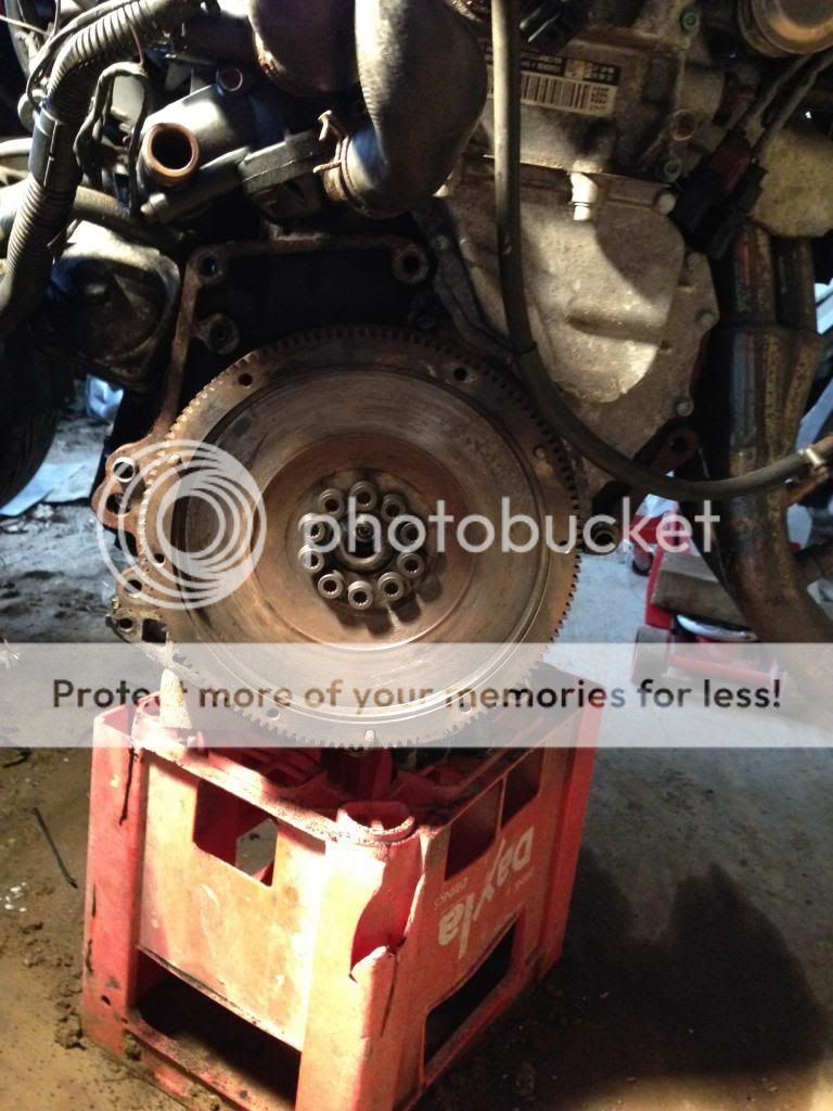

Old flywheel had a bent locater dowel, so took it off and put new flywheel on. Trying to reduce problems that could be killing clutch.
2x dead clutches. Both with 2 of 3 rivets sheered.

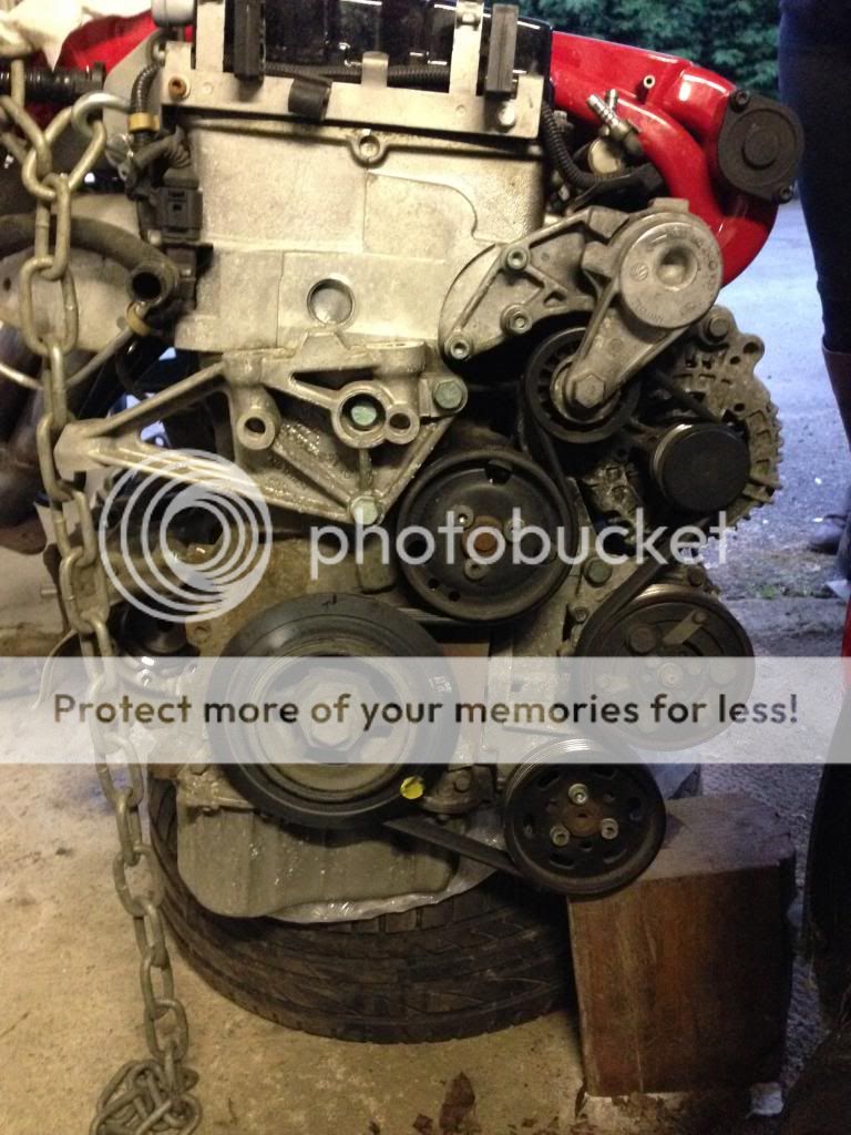

Put a mk4 r32 crankshaft pulley on, as other one was shagged. Hopefully this one lasts longer!

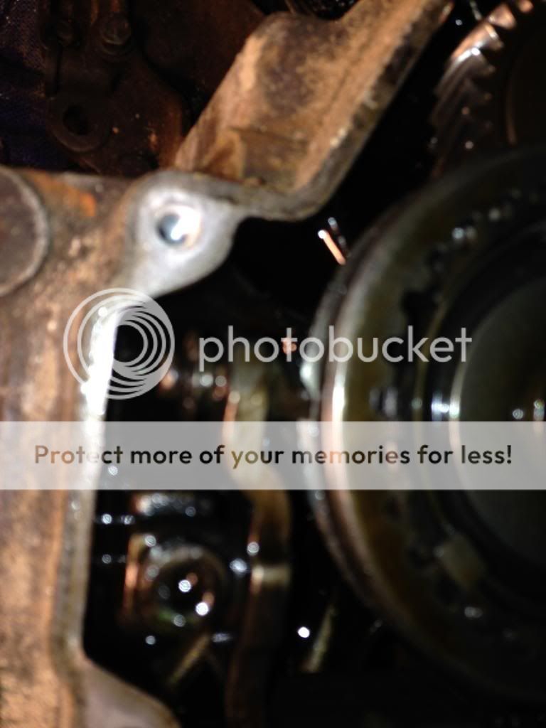

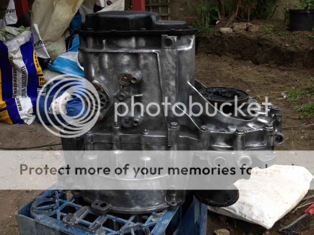

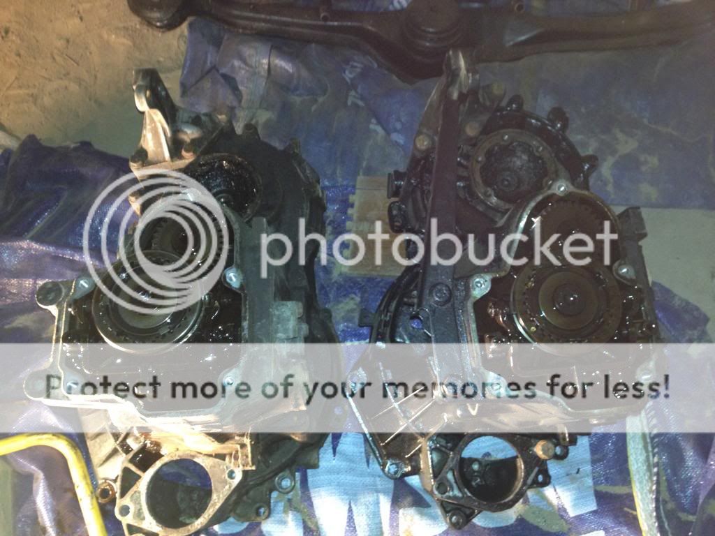

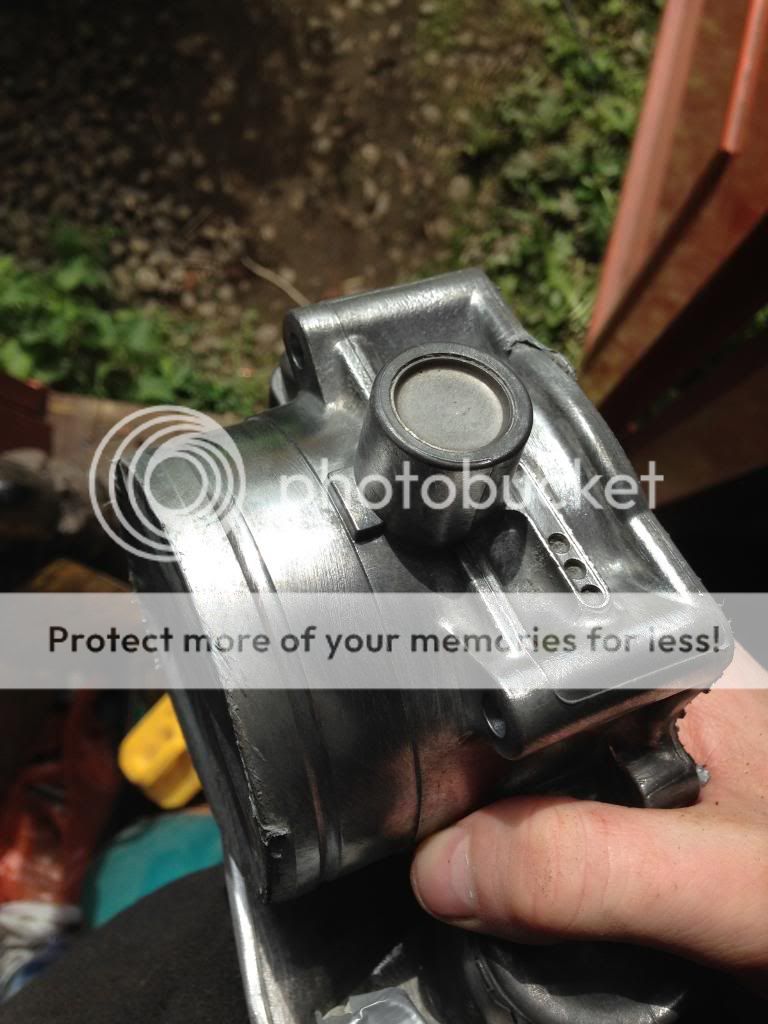

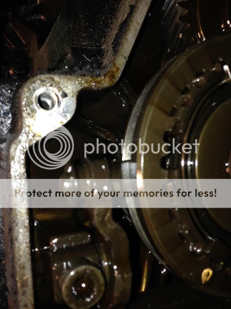

Did some digging to find why I had no 5th gear..
Second pic is the selector burred off somehow in one box!?!?! Third pic is how it should be in my spare box. So I swapped the good cond 5th gear into the corrado gearbox. The spare box also wouldnt select 5th but that was another issue. Hence taking it's 5th gear.

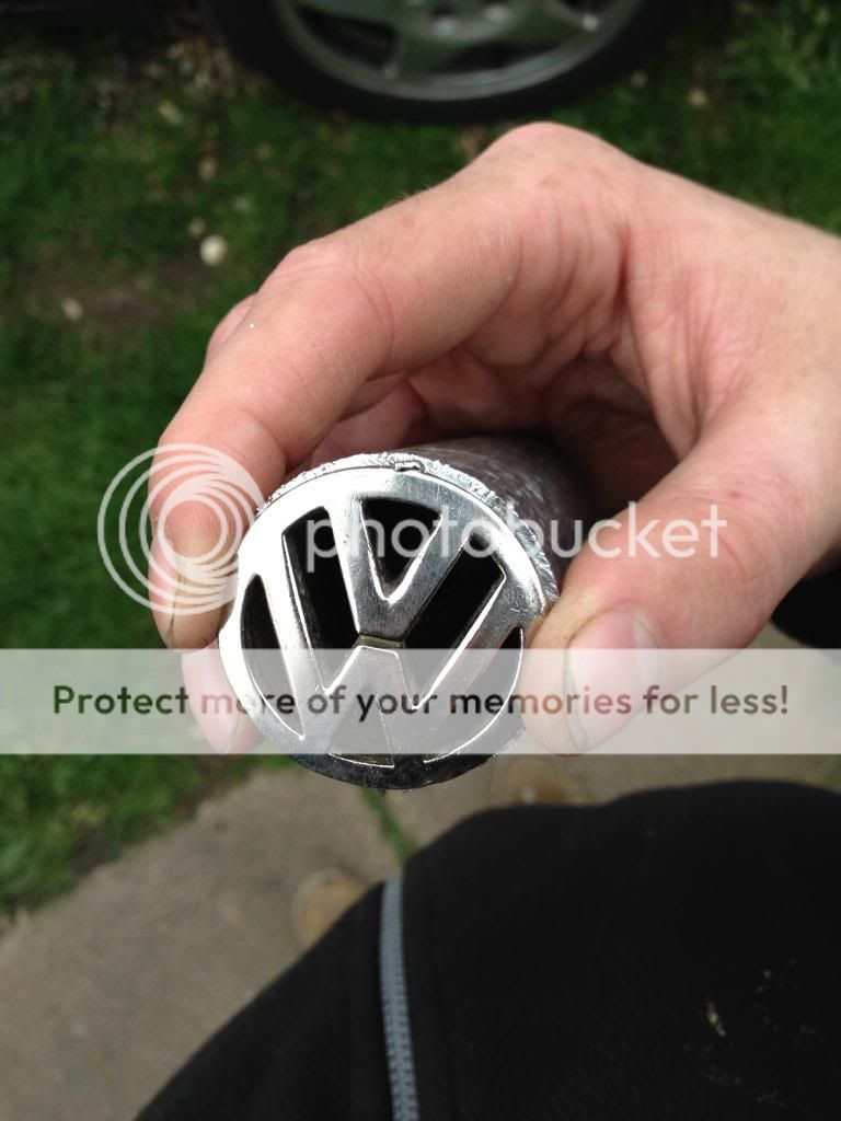

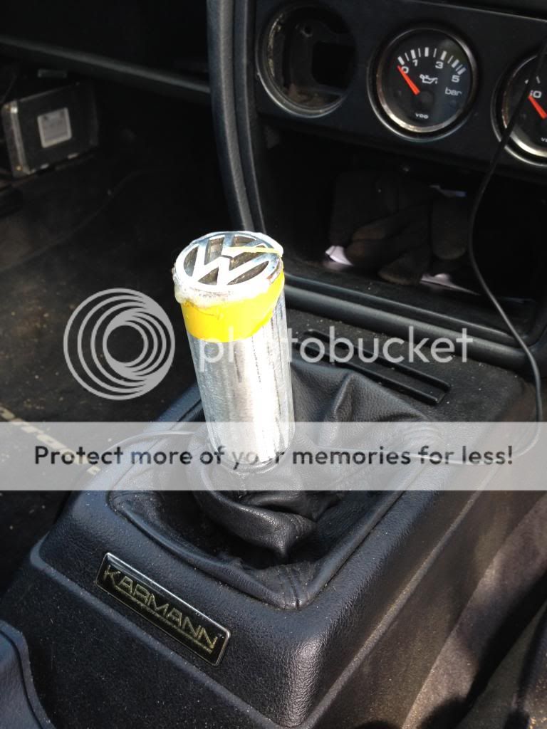

Got bored of my knackered gearknob so mate one:

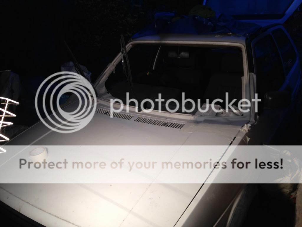

Bored again so welded up and de wipered my mates mk2:

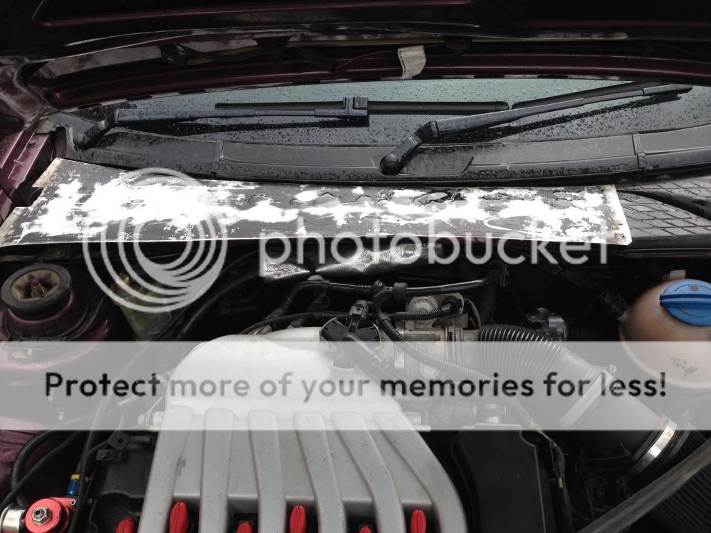

Made a scuttle cover from some spare ali sheeting that was in the shed:

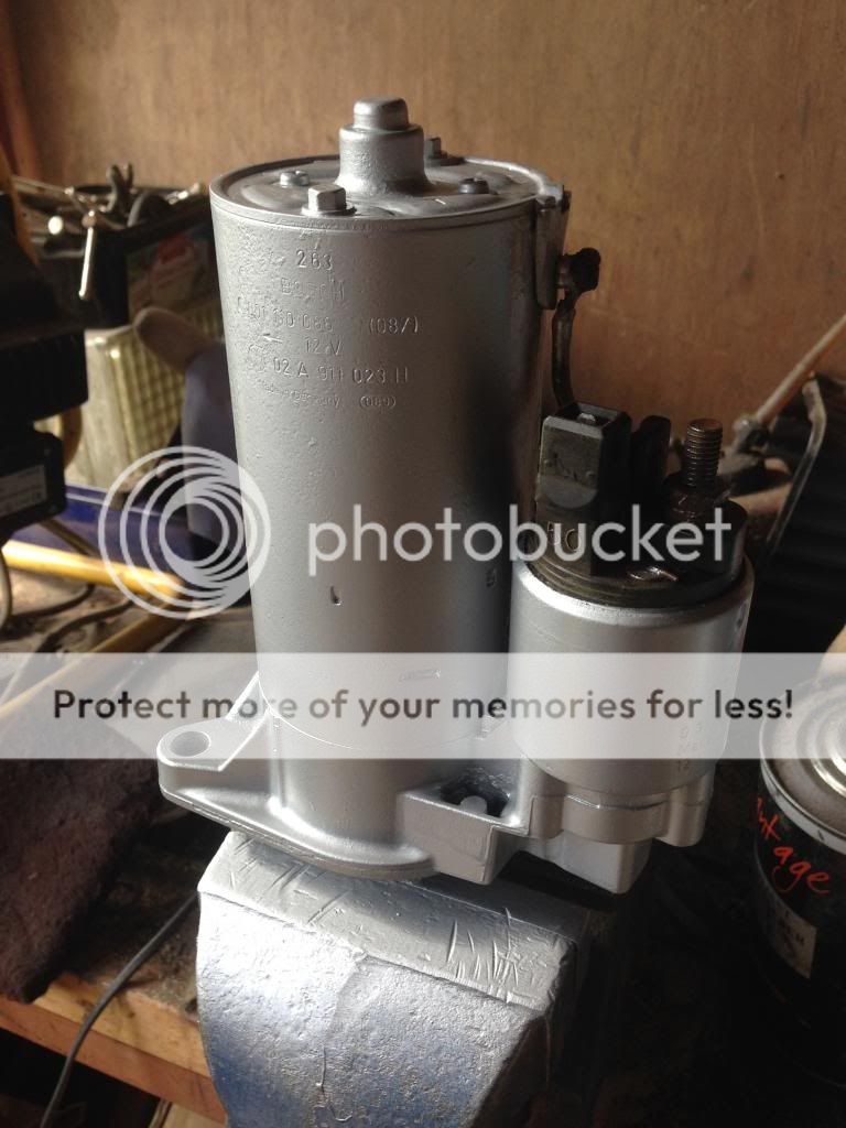

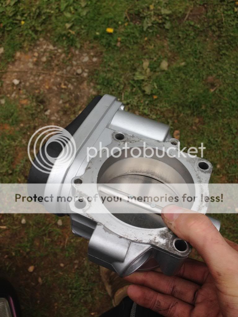

Cleaned TB up:
CLutch has now done 300 odd miles, she pulls well! Put the clutch killing problem down to excess vibrations due to loss of crankshaft pulley weight & bent locating dowel on flywheel causing pressure plate diaphragm to stretch, hence replacing both. 3rd New clutch was again an LUK unit as they are brilliant.

How do you find the front plate with the magnets?
Absolutely brilliant, I was abit dubious as I had them under a few layers of fibreglass (wanted as little filler used as poss) and it holds really well! Have done a number of trips up and down north yorkshire to leicester on the M1 etc, even once in bad winds, and it didn't move an inch! :)

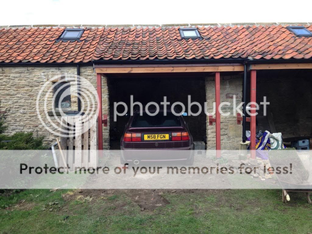

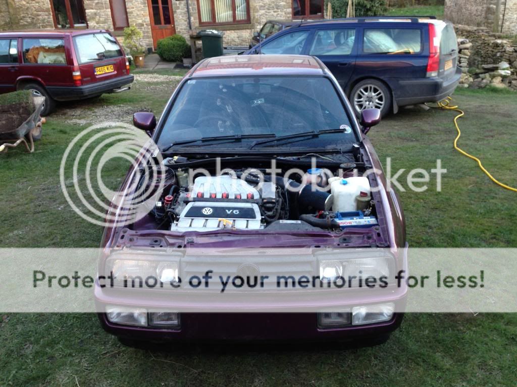

iphone pic sorry haha, just 2 mins from my house on the moors
