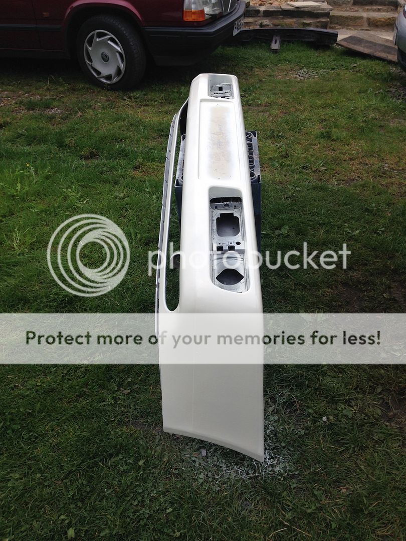

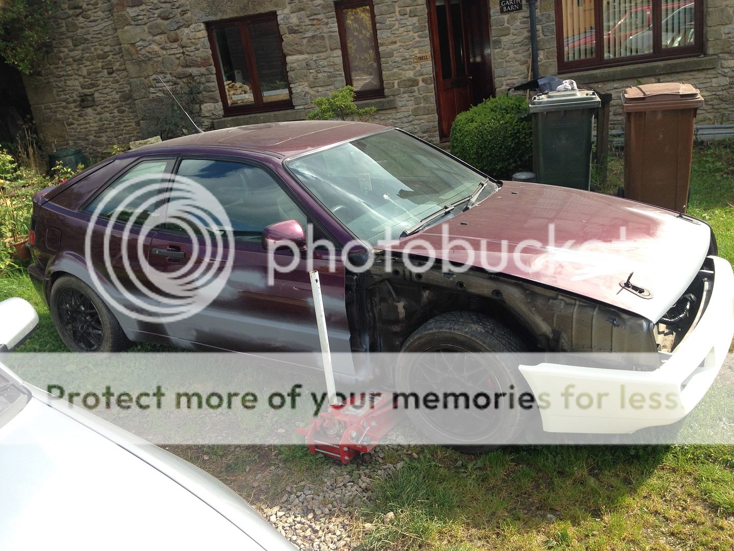

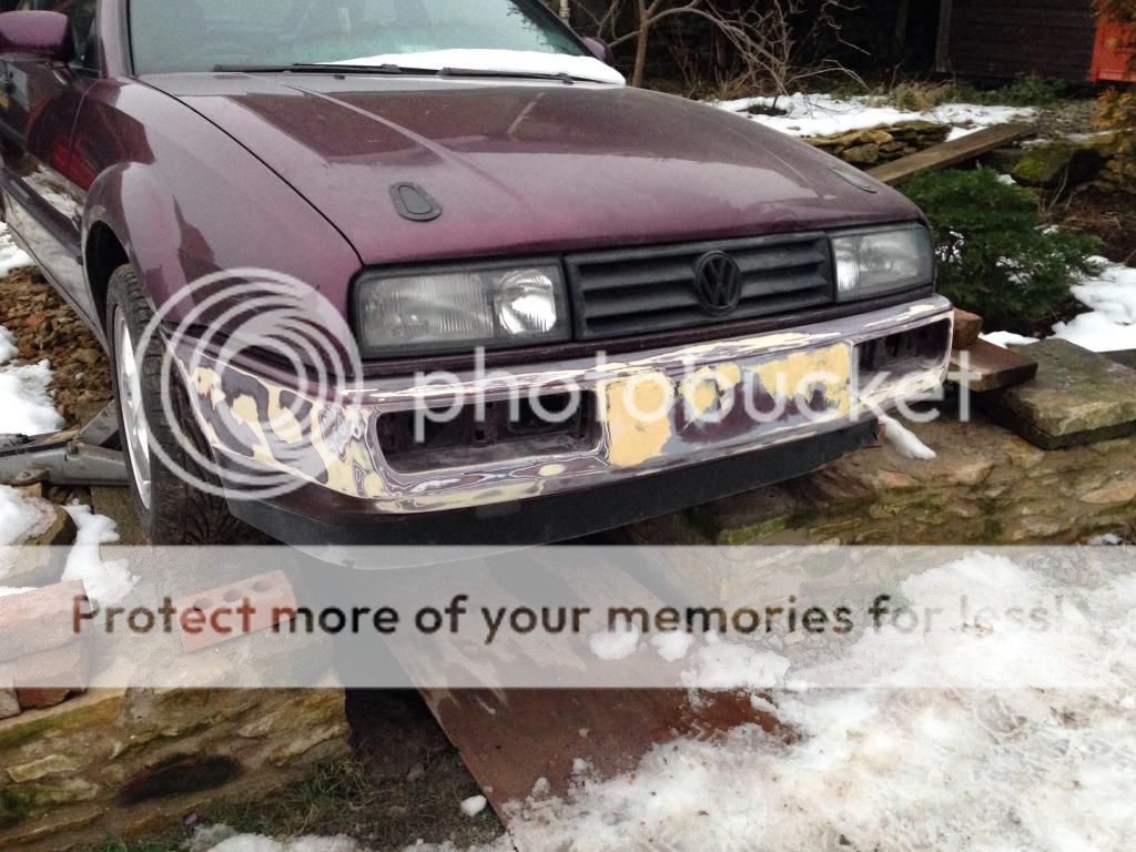

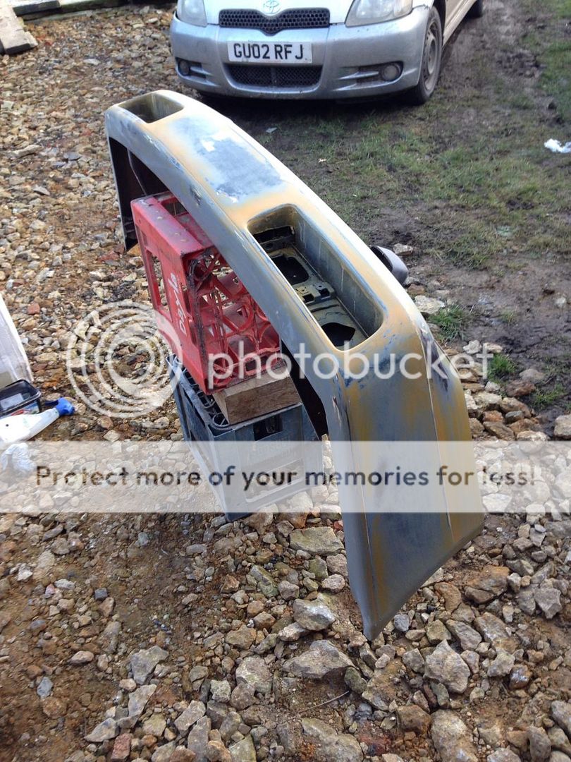

So I'm not putting it back on the road til start of march, so in the meantime I'm cracking on with bodywork issues. First up, the massively stone chipped front bumper!

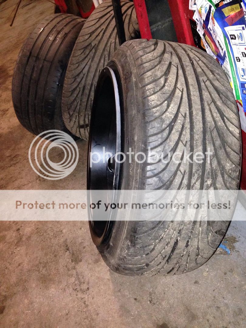

Got some tyres on the rear brocks. 215/40 stretched onto 10jx17.

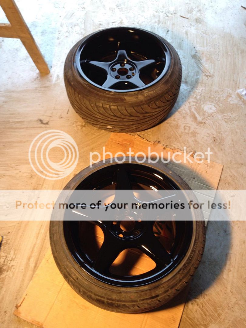

Put a quick coat of black on top of the primer to see if I liked black- yes, yes i do :D

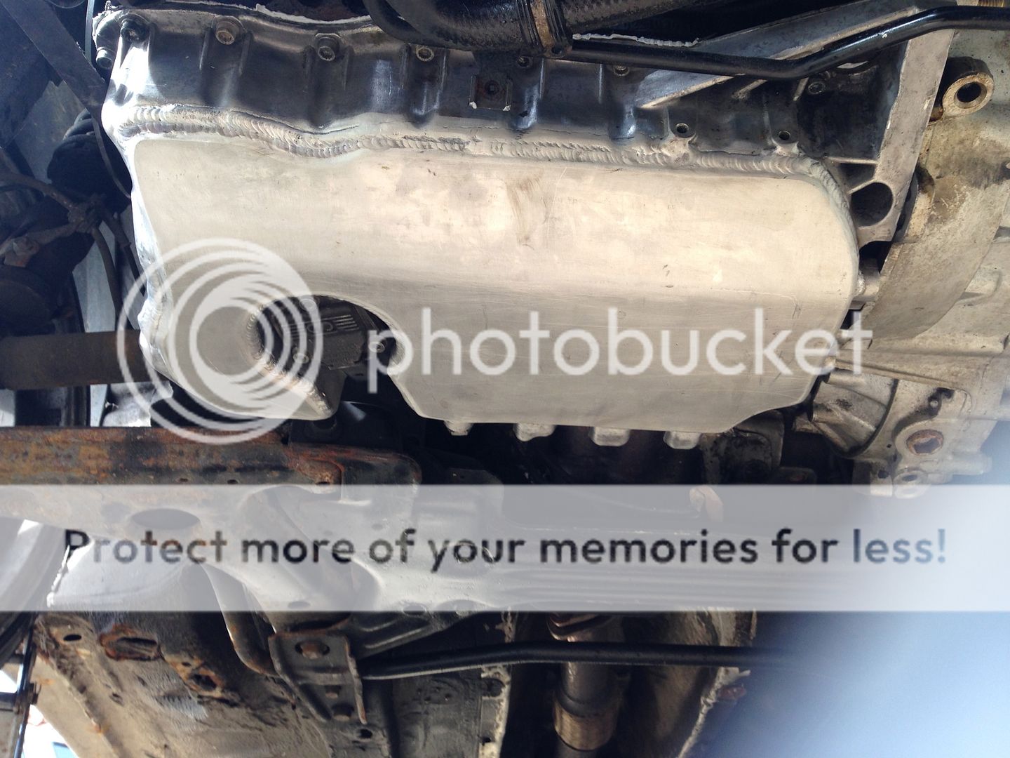

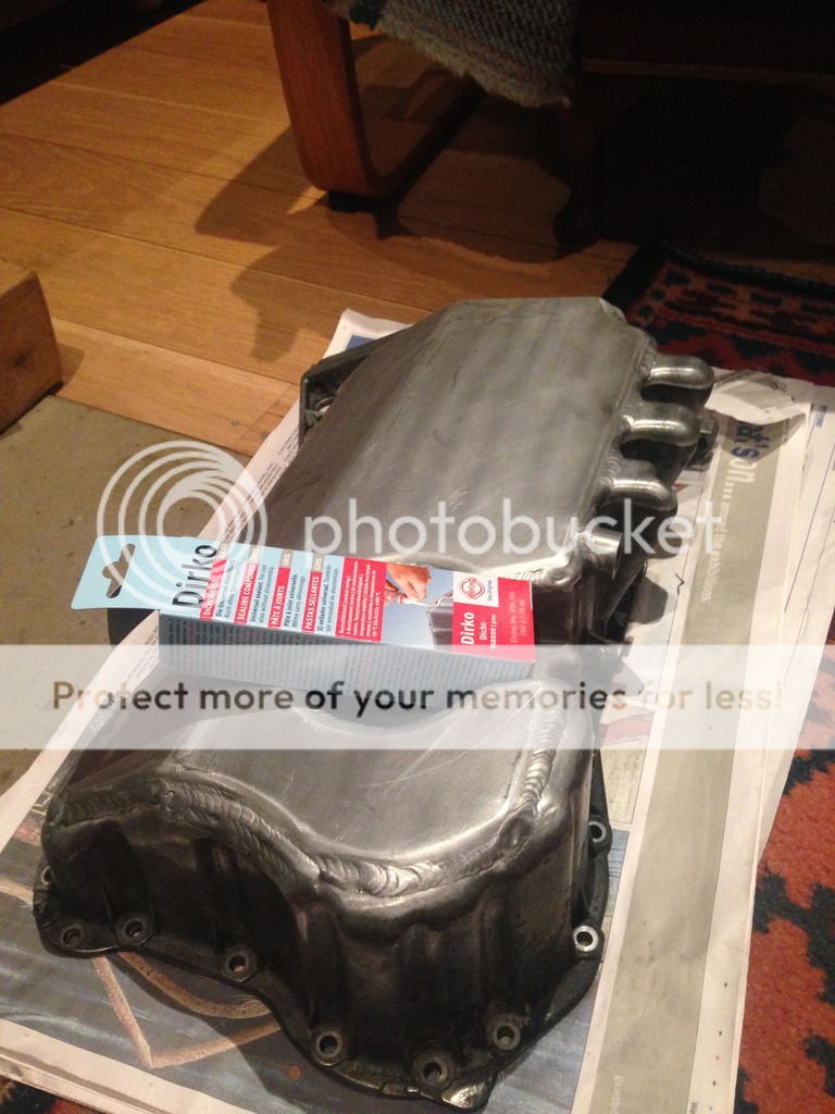

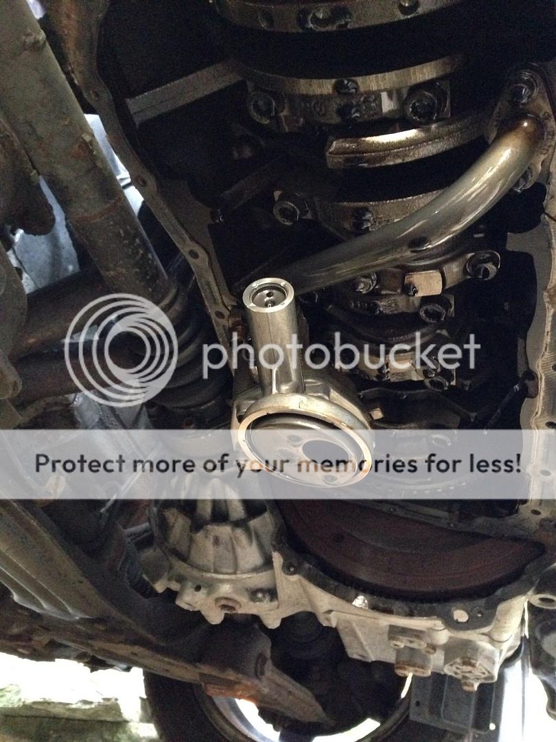

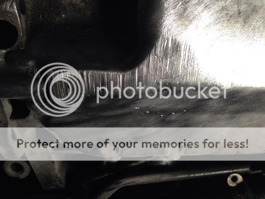

and this little bugger is what caused me to lose so much oil. Had worn through my sump via speedbumps etc. I'm doing a half inch or so raise on the front engine mount when I fit my vibratechnics competition mount. Also I've removed the sump & taking it to the ali welders next week or so to get it plated up & armoured haha.

Cheers for the heads up mate! I will do. Although seeing as it's worn through rather than a hole smashed in it I'm hoping it won't have affected the pickup, shall check tomorrow! I'm quite glad the 17's will actually raise the car up a bit!

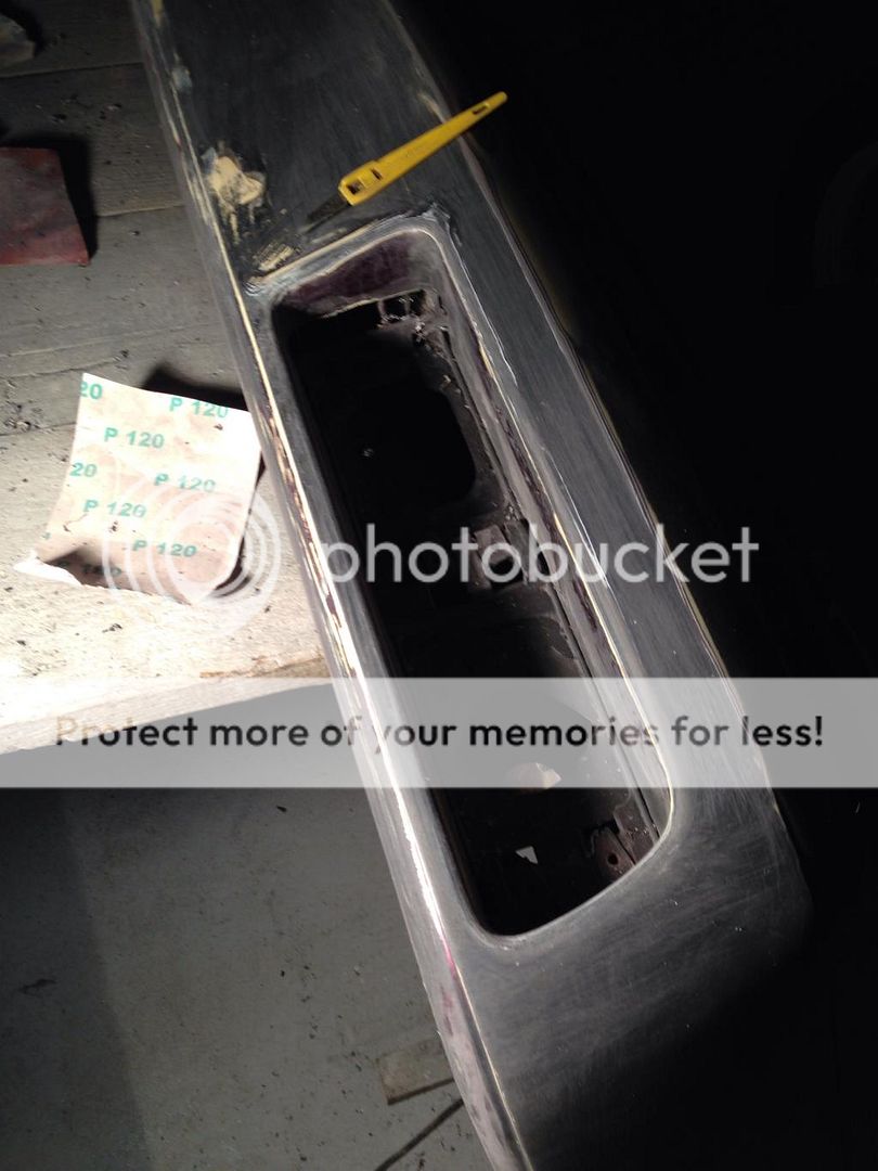

Upon sanding the bumper down I found it had previously been blue, red & finally purple haha. Sanded through that then got the knife out and scoured it back to plastic around the indicator holes.
All smooth! Primed and blocked down with wet & dry

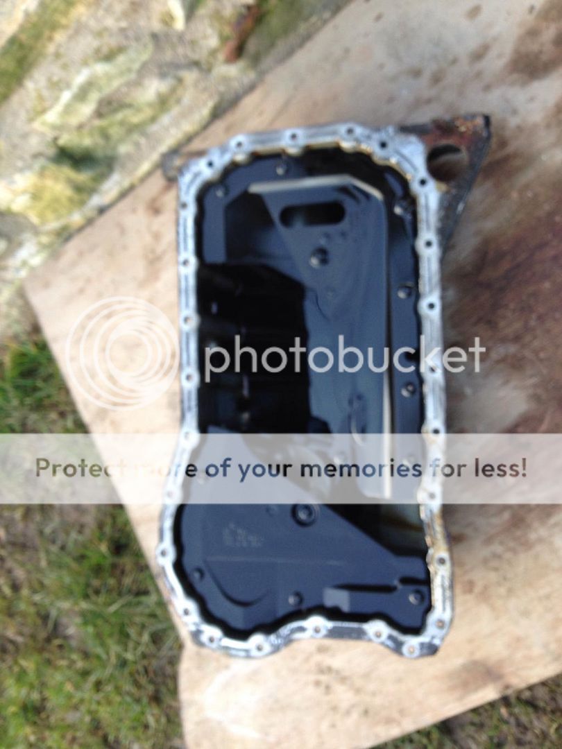

The holey sump!
Sump pickup checked & not cracked- as advised by sean!
2 wheels painted so far!
Ta daaaaa. Took the 20mm spacers off at the back as don't need them with 10j rears hahaaa. But kept the 10mm ones on the front. Sits much better on them.
More soon when sump comes back as it's at the welders getting armoured up :D Cheers

Sump back from my mate ready to go on
Put it on!

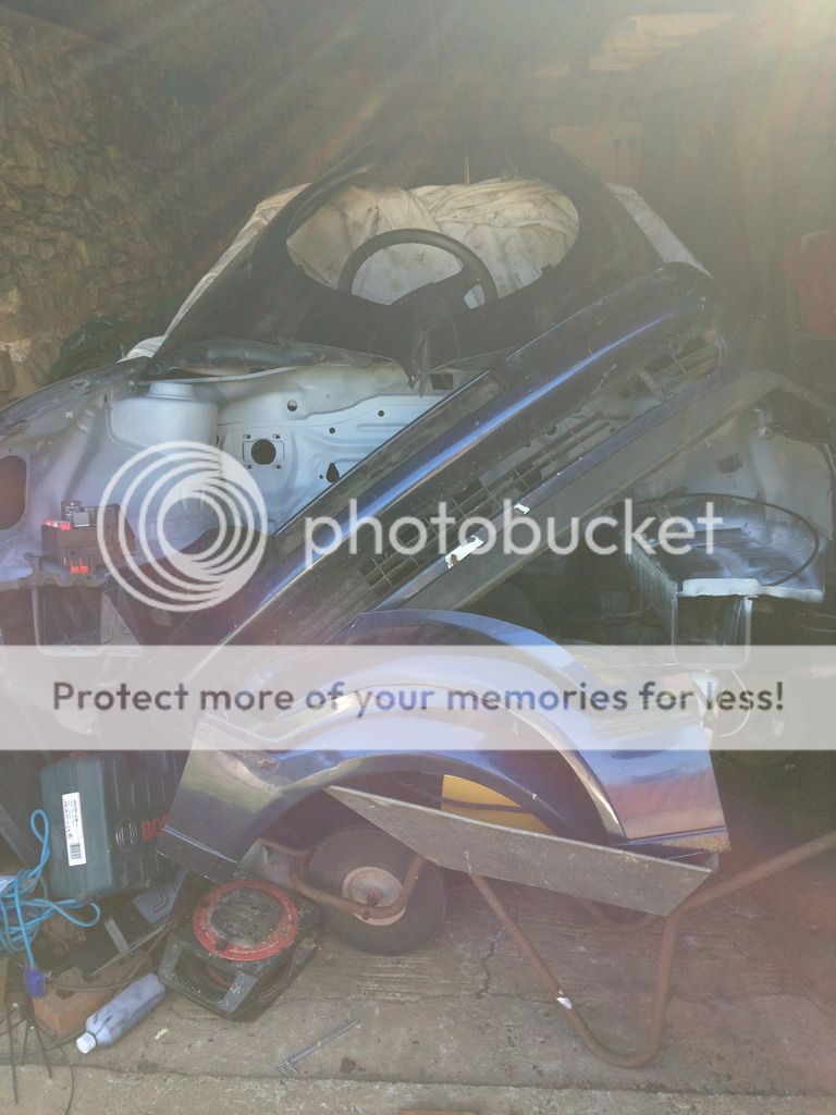

Which turned out to be a complete rust bucket :'(

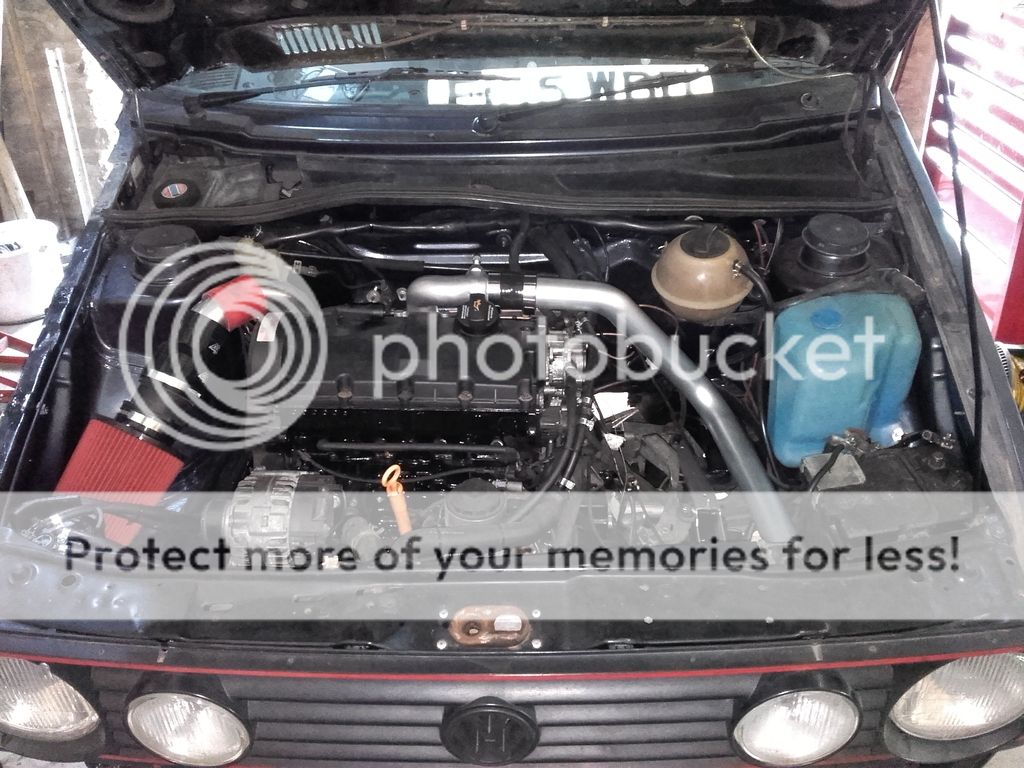

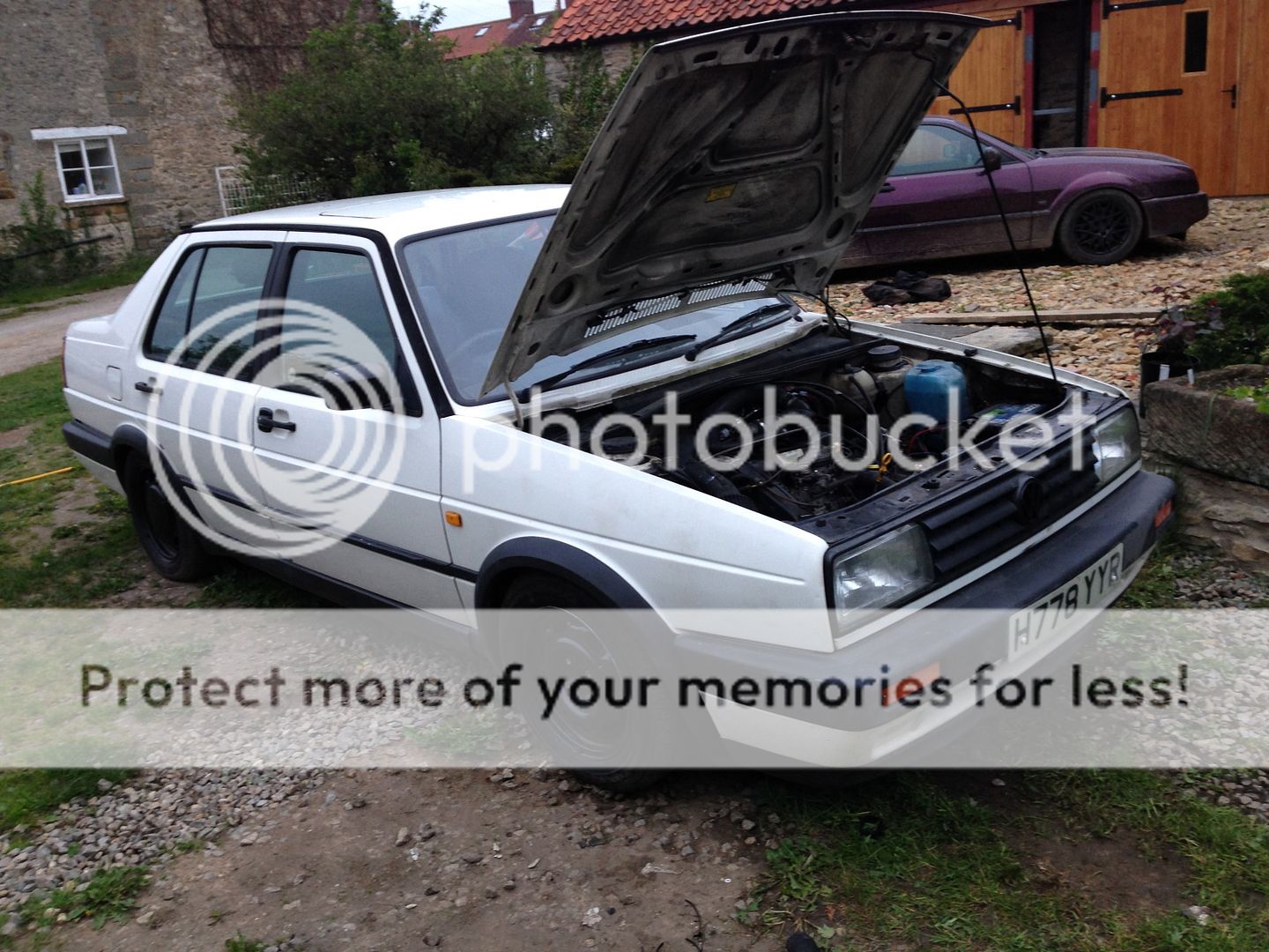

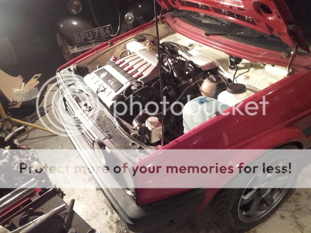

I then put the engine in my mk2 1.8Gl Jetta one weekend out of boredom
So I was distracted with that for a few weeks getting it all fine tuned and MOT'd etc.

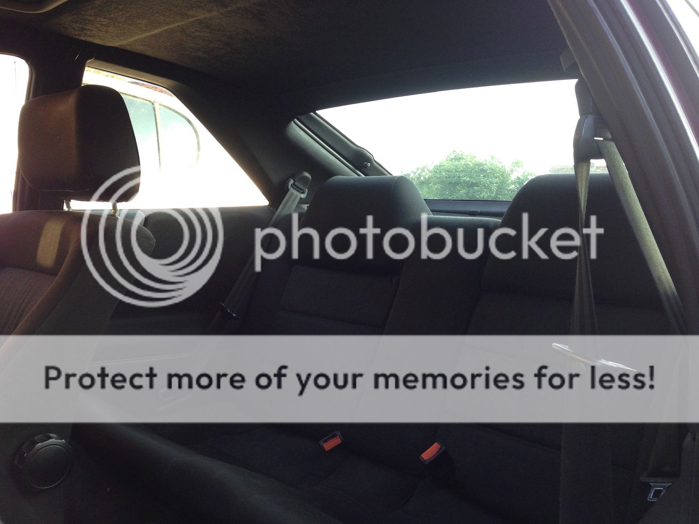

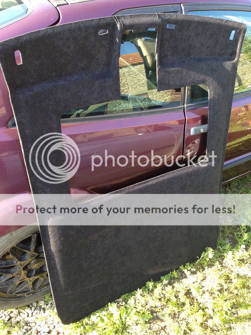

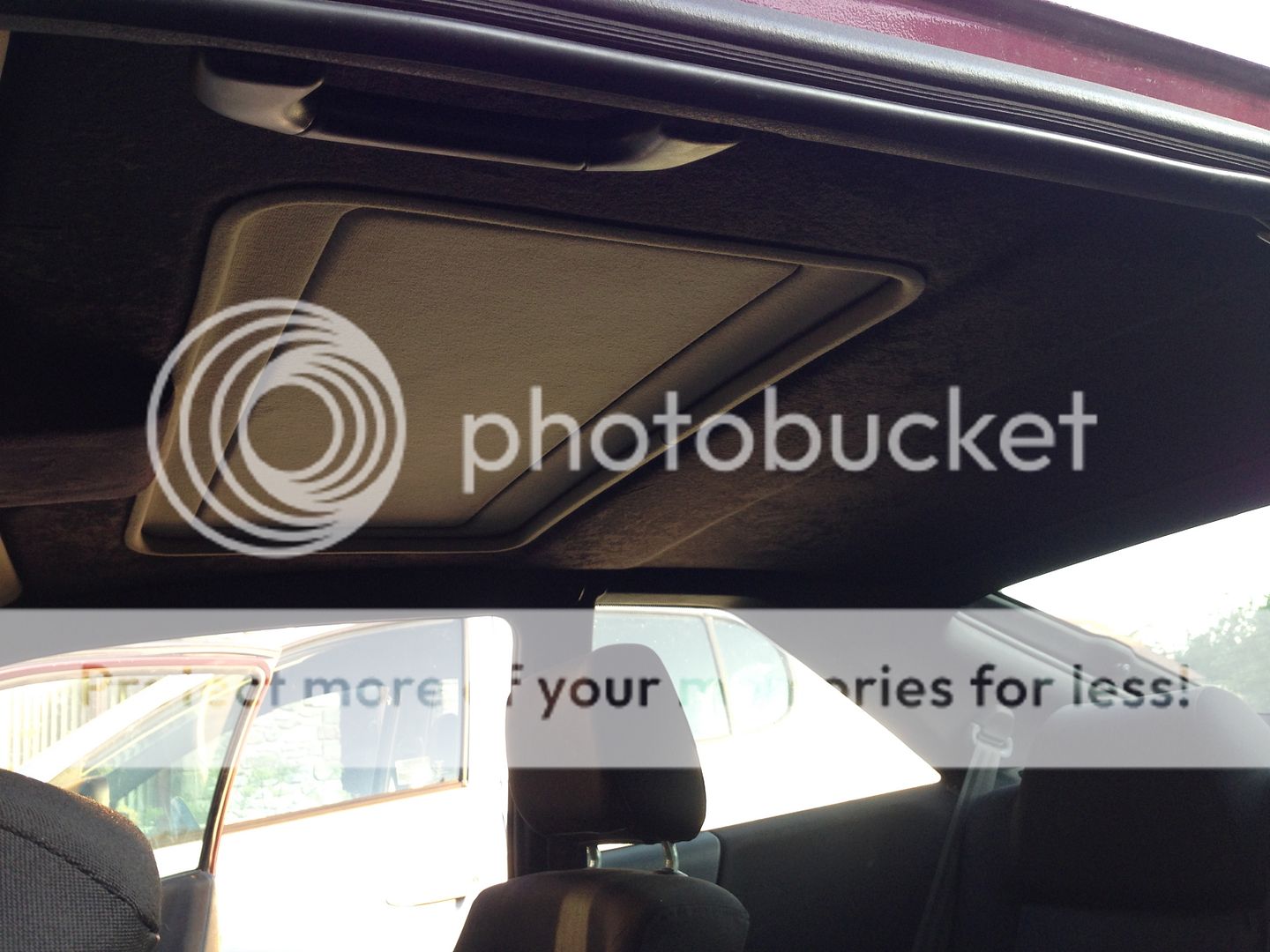

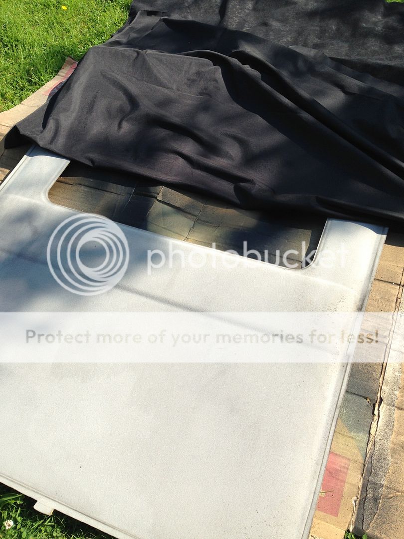

Did the headliner in some faux suede
Tadaaa

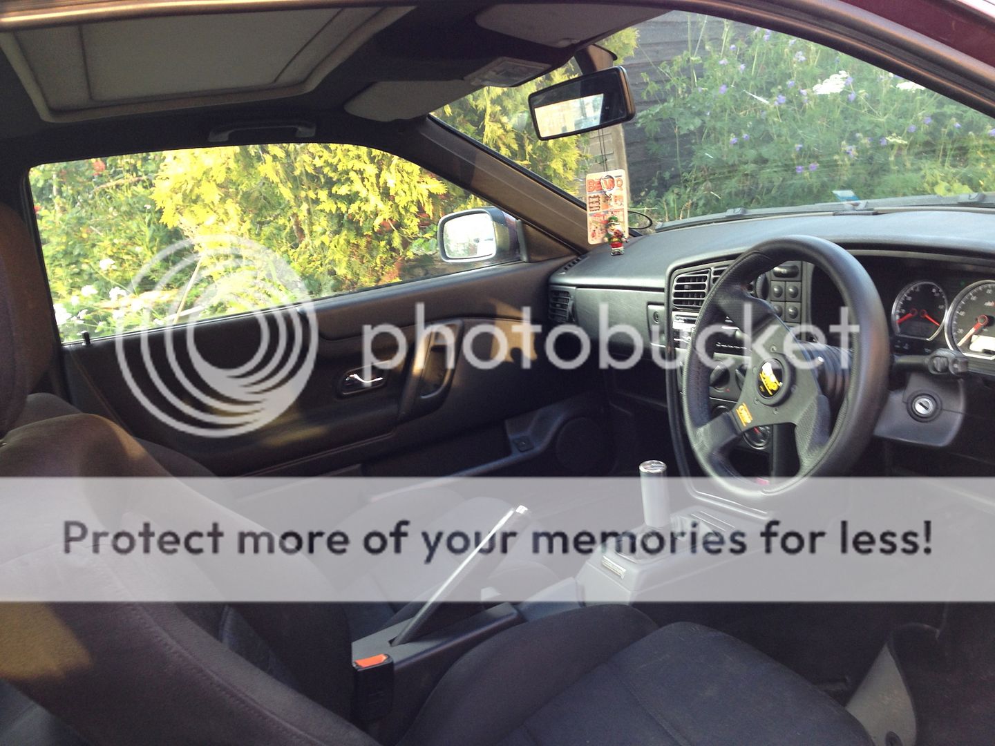

Black ABC trims in, headliner in, new rear bench in (one without a hump)
"sorted interior shot"

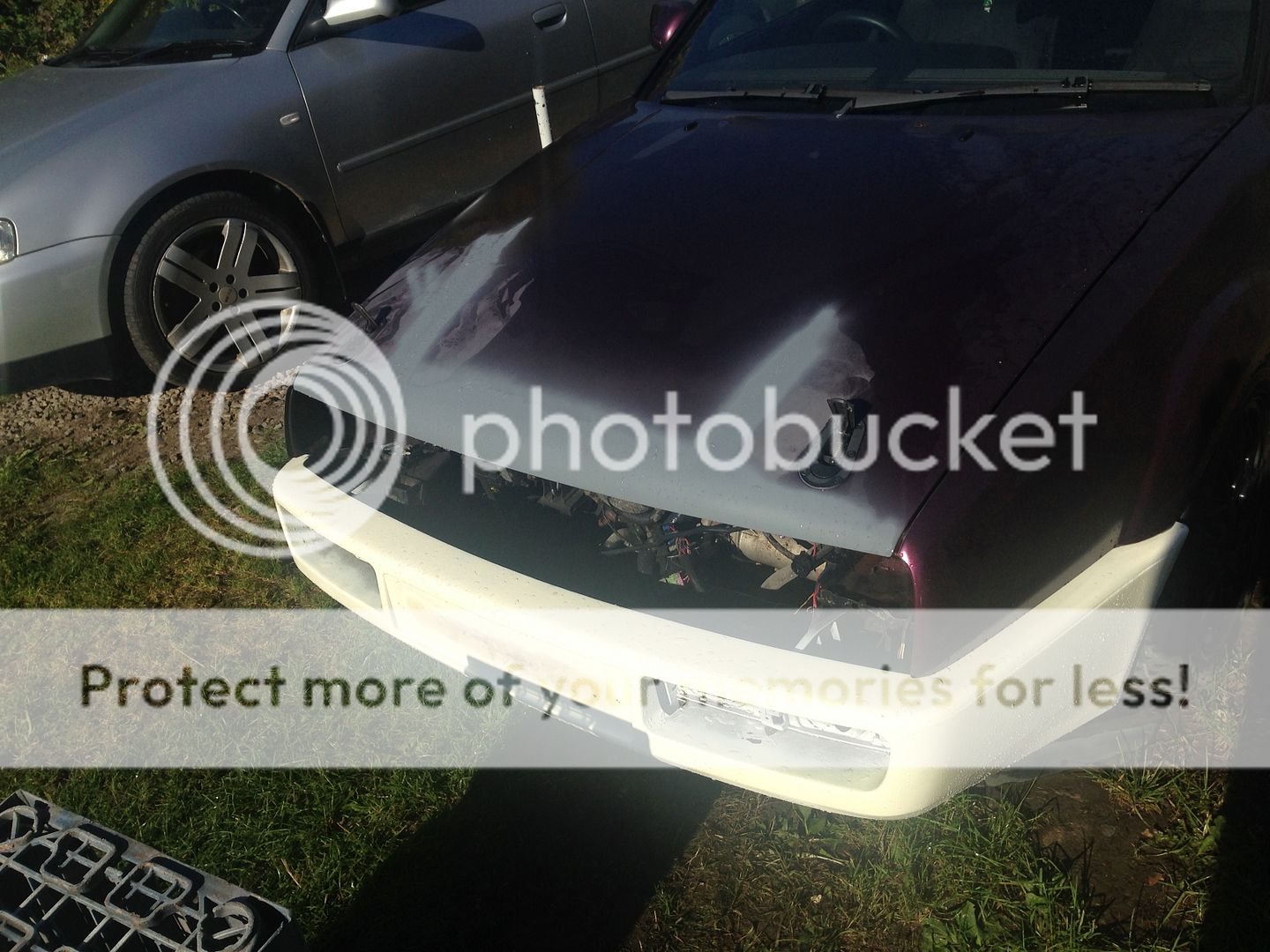

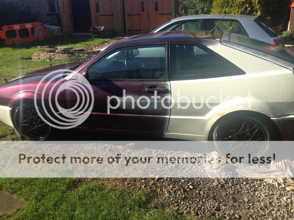

Decided I wanted a white corrado:
Cheers!
Edited by Pat.
Well seeing as the car needs a full respray & i got sick of looking at dents and rust, I cleaned it all up, smoothed out the dents and layed on a few coats of 2k matte white with the gun. It's only to last me till I find a new shell or find the time and money to respray it next year. If anyone knows of a rolling shell with alright standard paint PM me please!

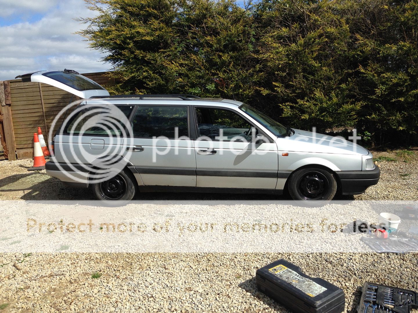

Hey, I contemplated putting one of my pd130 conversions in it, but that's just blasphemy right? (Secretly I love the idea, hybrid pd150 turbo = 220bhp 300ft/lb & 50+ MPG) But I am trying to stick with a petrol! Pic below is one of said conversions

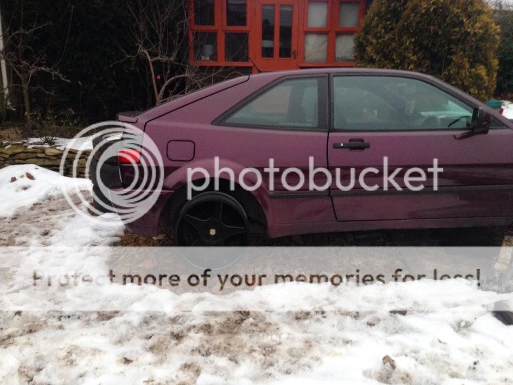

So it's sat in the yard looking sad. Plan aside from engine: ABS removal, underside sorting, new rear arches to weld in, new pass door needed, new boot needed, general overhaul and refresh & whole lot resprayed either original blackberry or to gloss black (over time I think, I want to be able to drive it as a rolling project).
