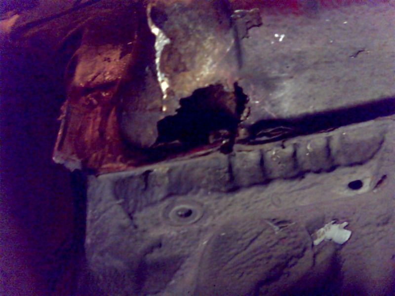

GrahamU 6 Posted August 24, 2013 I have found a hole in each sill, there at the front of it, under the wing and can only be seen from under the car. They are definitely rusty but before I weld over them I would like to know if they started of a drainage holes or has the rust caused them? Quote Share this post Link to post Share on other sites
Yandards 0 Posted August 24, 2013 I believe you are referring to one of the body cavity holes, there should be a rubber bung in it and they get filled with wax at the factory. Quote Share this post Link to post Share on other sites
GrahamU 6 Posted August 24, 2013 Thanks Yan, looks like the bungs must have been removed at some point in its life :( Quote Share this post Link to post Share on other sites
Yandards 0 Posted August 25, 2013 Thanks Yan, looks like the bungs must have been removed at some point in its life :( They tend to come out as folks use that spot to jack the car up causing a touch a panel deformation and then the bungs fall out.. Quote Share this post Link to post Share on other sites
GrahamU 6 Posted August 25, 2013 Got a pic now Its the bottom of the A pillar/sill There is surface rust inside aswell :( Quote Share this post Link to post Share on other sites

Jim Bowen 1 Posted August 27, 2013 Is that pic taken with a front wing off? Is a hole right at the front for the underside of wing to bolt to., mine totally rusted away. Quote Share this post Link to post Share on other sites
GrahamU 6 Posted August 27, 2013 Well spotted Jim, Took me a while to cut the wing off and I'd forgotten about the wing bolt, it took the insert with it when I removed it. That's why the hole is a lot bigger than I thought it was when the wing was on. Thanks, that's why I put a picture up. Quote Share this post Link to post Share on other sites
Jim Bowen 1 Posted August 27, 2013 I had my hole welded up and didn't bother with the bolt for wing. When i was putting the sealant/glue down the edge of wing i just carried it on around the bottom, and its held fine. Quote Share this post Link to post Share on other sites

Stonejag 10 Posted August 27, 2013 You can get repair panels for this area (at frankly extravagent cost!) from the dealership. Each side gives you the complete inner A pillar and top of the door frame to the rear edge of the door aperture, and at the bottom includes this rotten area up to the frontmost part of the sill. I managed to snare an unused pair from on here a while back - lucky find as I've not seen another set since! Mine are thoroughly rotten in this spot - just as bad as yours - so I'm hopefully going to get it sorted during the respray I seem to have been planning for years now :lol: Seems to be one of the worst areas on the whole car as water gets flicked up by the front wheels and trapped behind the arch liner - post-repair it's going to get a very thorough coat of underseal :) Stone Quote Share this post Link to post Share on other sites
