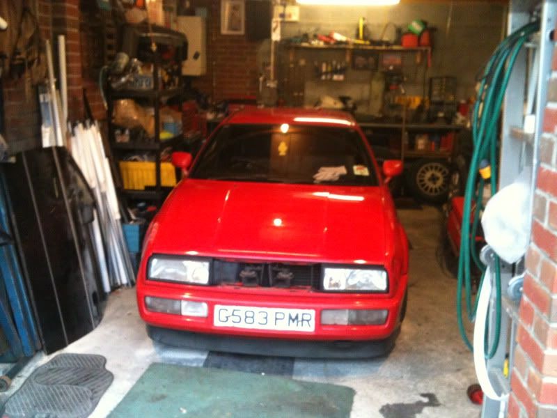

But just a quick one fellas, do any of you know where the horn is located as we can't find it and the horn does not work so were thinking it was removed for some weird reason????

The horn would of been behind the grill, one horn bolted onto either side of the center section
Not the best pic, but you can see them in my pic
Looks like a good one
I can indeed cheers mate your a star.
