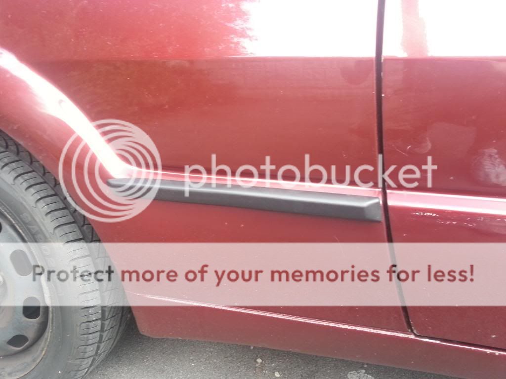

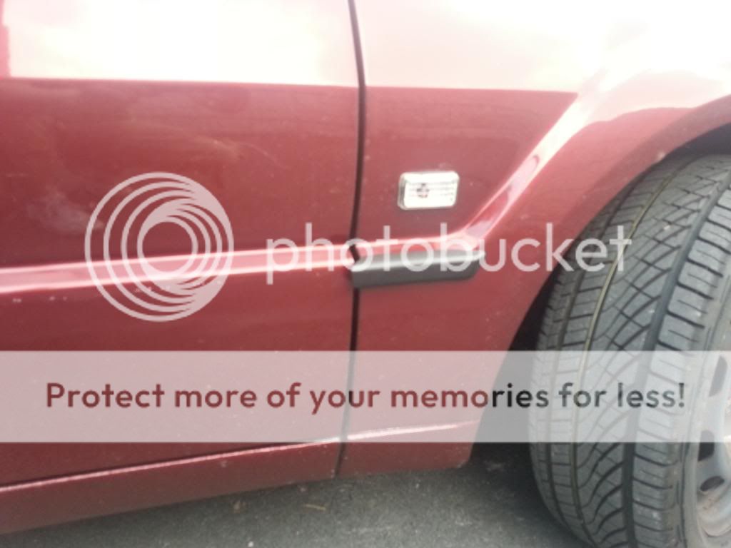

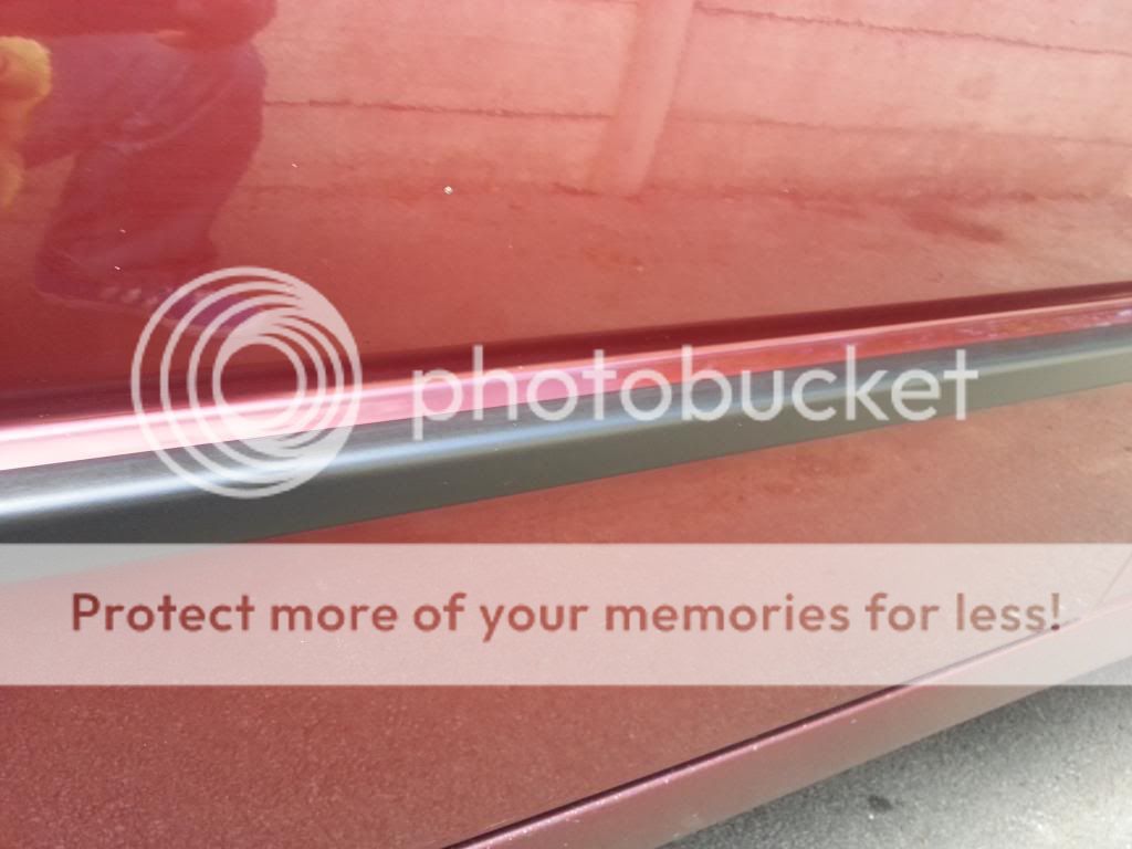

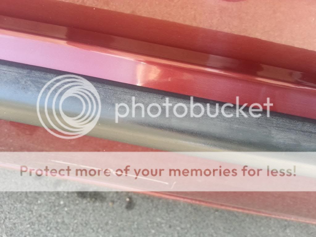

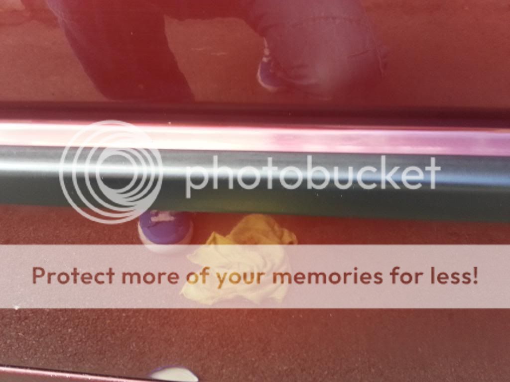

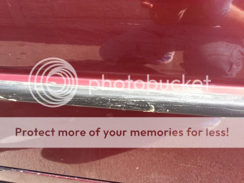

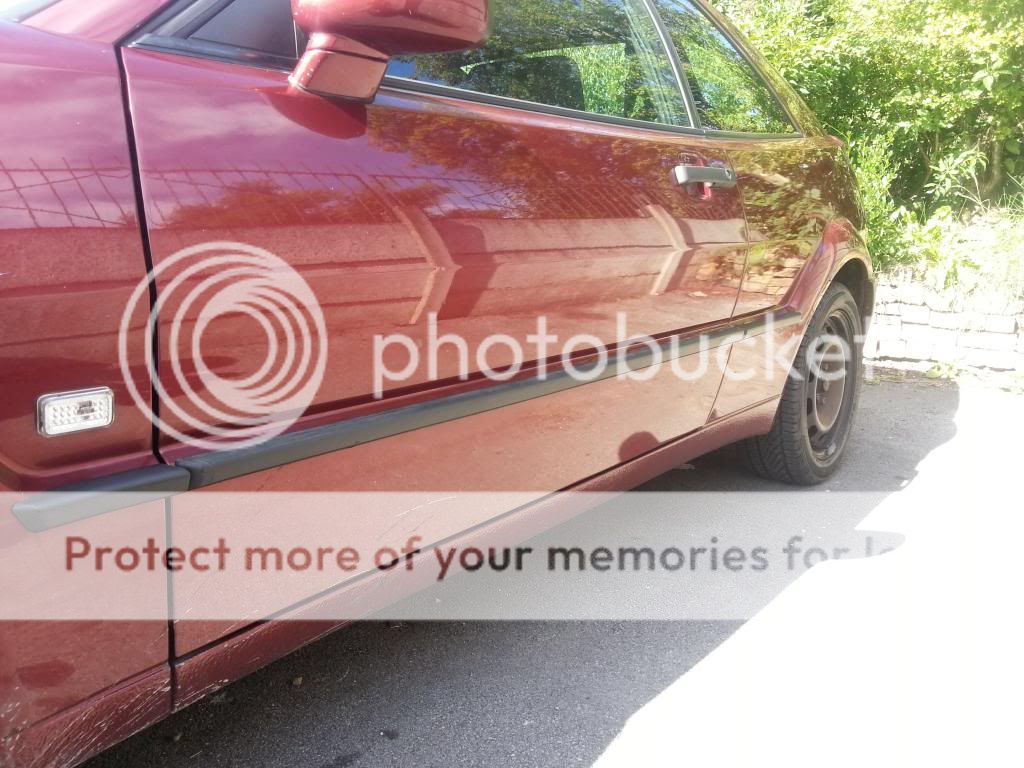

st4stokie 10 Posted September 8, 2013 Called into the local bodyshop wholesaler yesterday. They advised tiger seal would be the best thing to use. So tube of that, roll of masking tape and some panel wipe and off home to fit the rubbing strips back on. Here are some pics now they are fitted and cleaned up with peanut butter Car needs a good clean I know Quote Share this post Link to post Share on other sites
