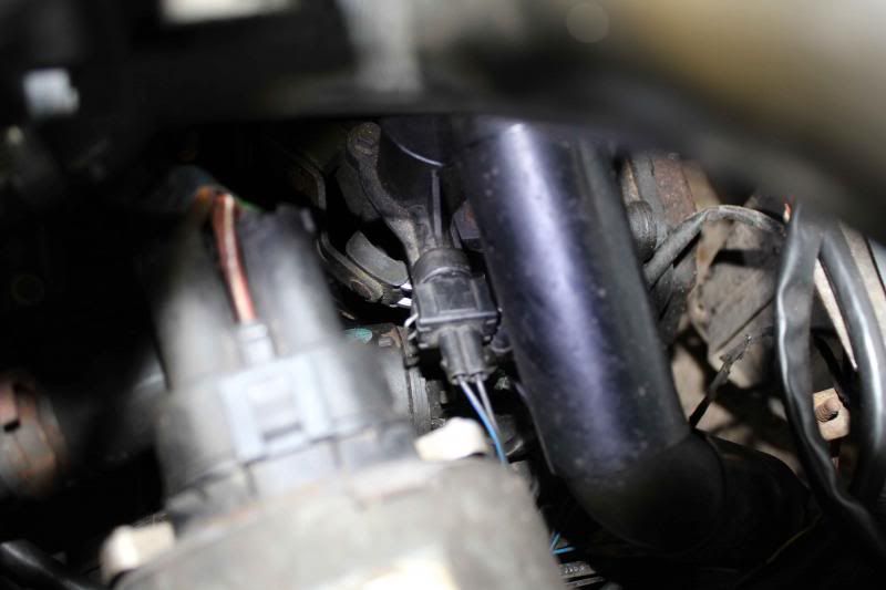

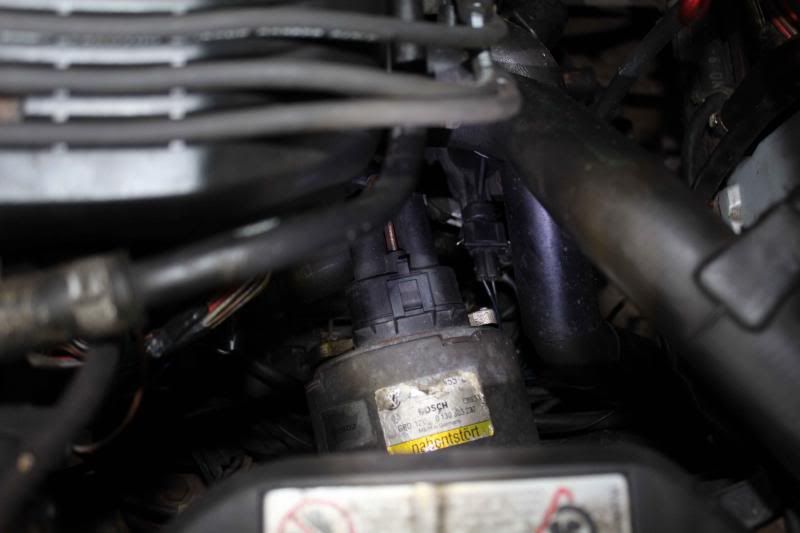

timmaaah 0 Posted November 6, 2013 Talltorrac said: Thanks for the help guys It might be an intermittent fault - saw the reflection in the other car on the driveway briefly. Think I lost track of which way round the wiring was applied to the two clusters (this is what comes of trying to see it through the rear view mirror rather than use a second person!!) so it might have been the fogs that were wired up as a pair. Going to start at the gearbox as this seems to be a common fault - going to dig my pdf manual out I think. Unless someone has a pic to hand........... That's the plug bit on the gearbox. It's just a basic push to make contact switch operated by a small rod off the gearbox. My old one just popped off with a tiny bit of pressure - judicious use of cable ties sorted it until I changed the box over :) Quote Share this post Link to post Share on other sites
Talltorrac 10 Posted November 8, 2013 Super, thanks!! Will head out and have a noses when it stops raining! Quote Share this post Link to post Share on other sites
