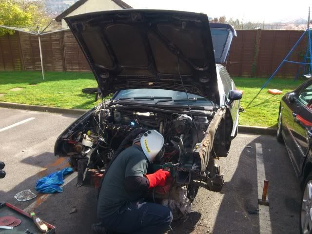

Had a productive day today. My brother very kindly organised a deal where I sold some wheels to SMITHY220 who is a professional welder.... well I didn't need the cash so we put a plan together for him to come down an help out.

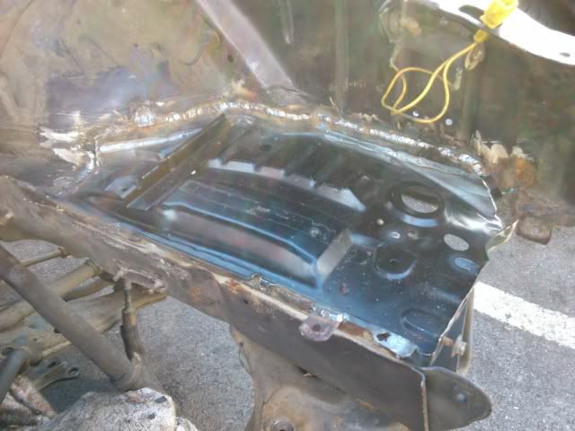

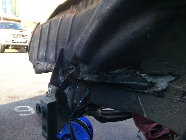

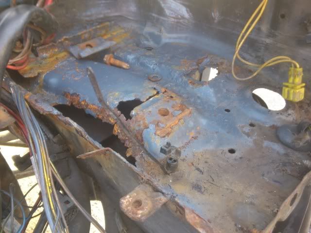

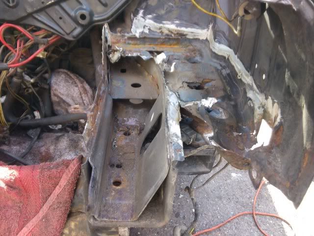

So the once nasty battery tray that looked like this:

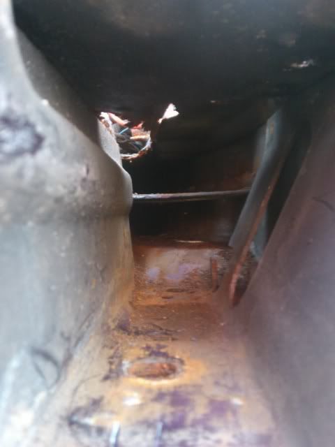

Luckily the inside chassis leg is perfect

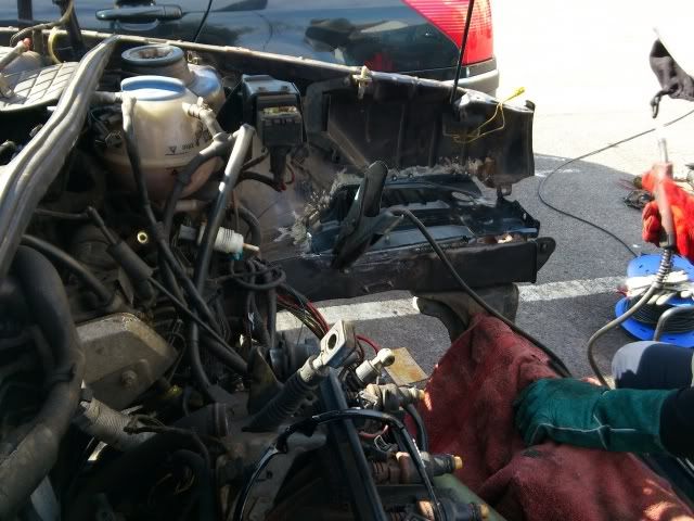

The top part of the tray was hacked out - i HATE spot welds - to leave this to work with

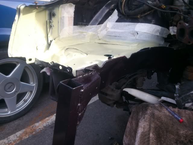

Smithy hard at work
YES all of this is getting done in a car park, no fancy workshop for me!
getting there
And done
some extra bracing on the bumper mount for good measure

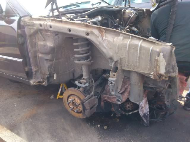

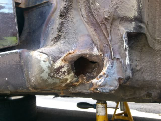

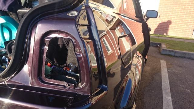

Since I had removed the passenger side wing to make it easier to weld I thought I'd use now as an opportunity to remove the driver's side wing as the previous owner ran the car without inner arches so there was tonnes of mud/crap and a little hole...
A little hole that became a BIGGER hole
NO HOLE

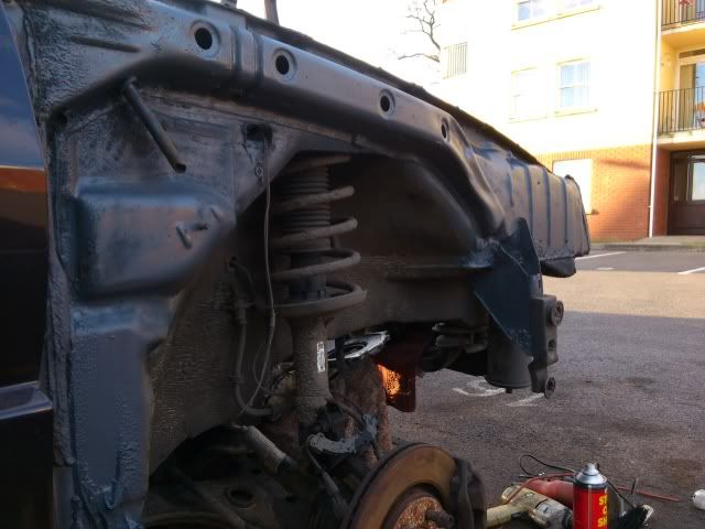

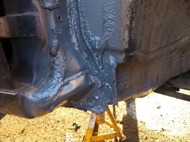

Also decided to wire brush the inner arch and apply a quick coat of Zinc so that tomorrow i can waxoil the whole lot
And the passenger side now the welding is done.
Hopefully tomorrow i will finish painting up all the inner arches, paint the insides of the wings, remove the front suspension in order to fit my new AVOs and make a start at painting the lower cross member and spend more time cleaning the engine bay.
That's enough for one day!

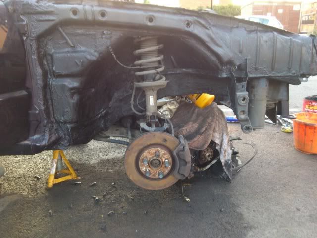

managed to fully coat the inner wings and start the inner sills with a good layer of waxoil. I decided that since this is a daily I more interested in protection and not to fussed on striping/repainting the arches DBP.
Spent a bit of time cleaning the insides of the front wings in order to apply a coat of zinc primer , waxoil and for the inner arch lip and edges proper DBP paint.

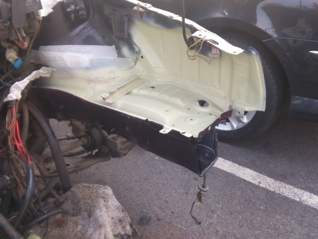

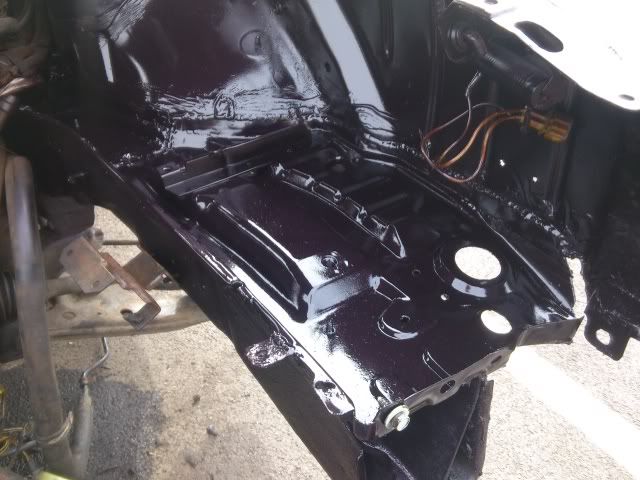

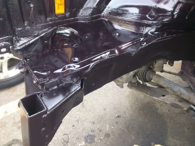

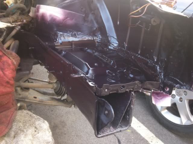

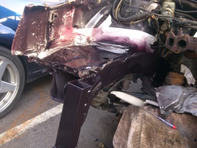

Since having a new tray in i decided to go all out and paint the chassis legs an bay.
passenger:
I did a few coats of Zinc primer first before a couple of high build primer prior to body colour
driver side:

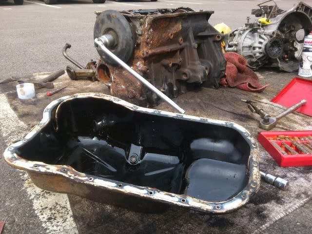

whilst the paint was drying I carried on with the engine - removing the sump first

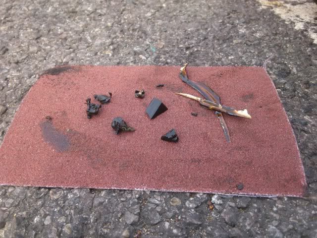

Reason why!!
more bits of timing chain tensioner!!!!!!!!!!!!!!

I painted the chassis legs as well which are looking spot on now... good enough for a rattle can effort

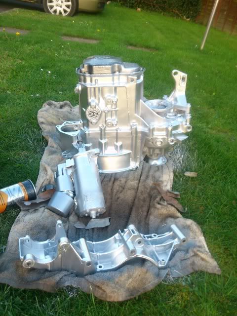

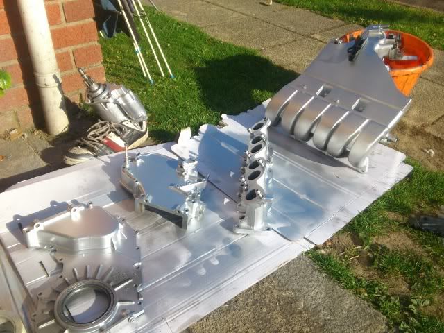

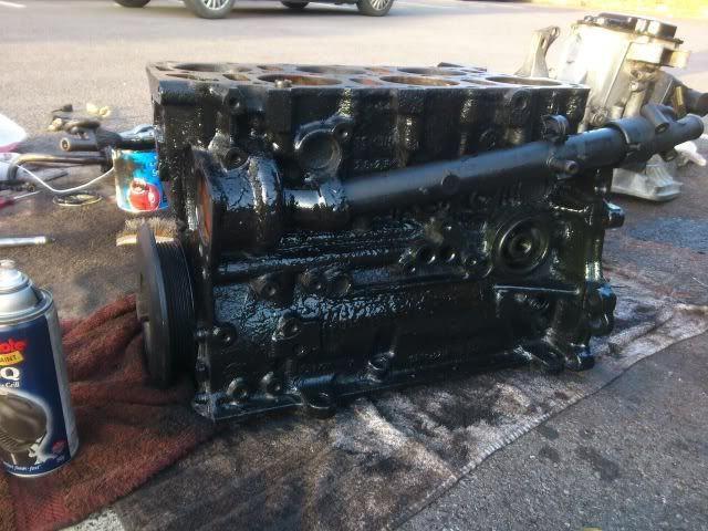

Painted the block to- Wilkinson barbecue paint haha
The front cross member, subframe, anti roll bar, lower arms pretty much everything i could get to has been painted

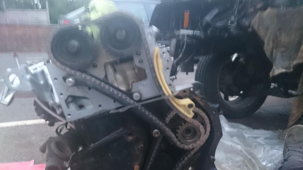

new chains and tensioners on

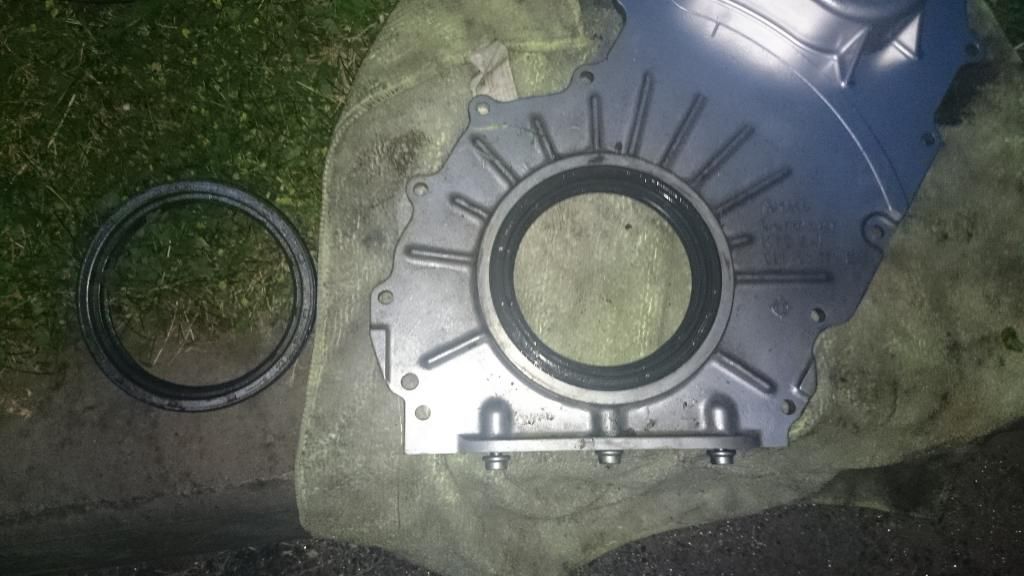

new seal

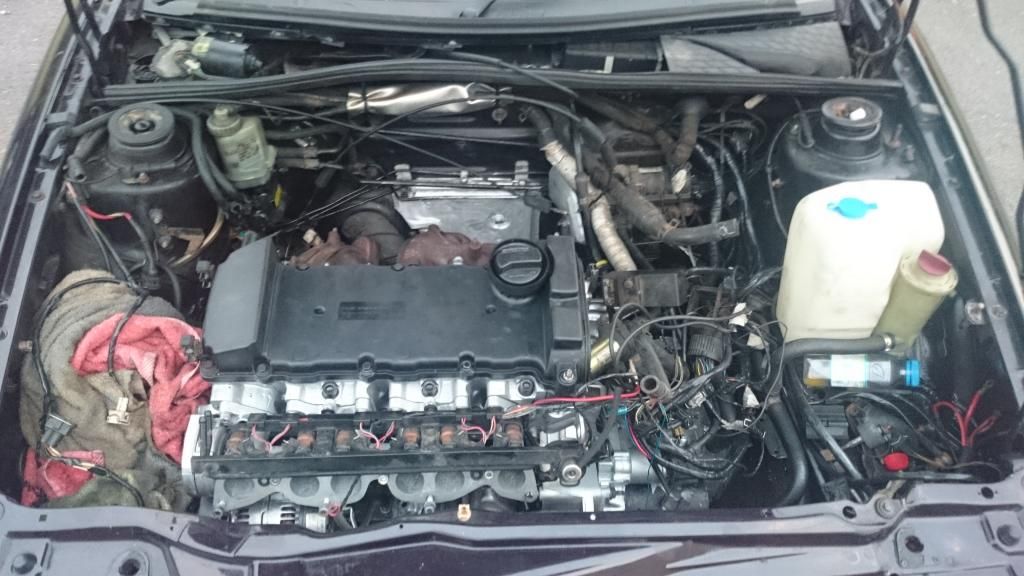

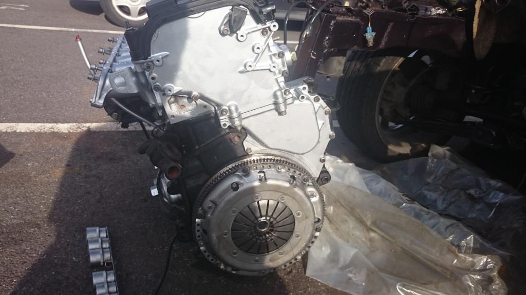

Then manhandling the engine an box into the bay. driveshafts and manifold back on, the wiring is mostly sorted DSC_000001_zpsmucw5byd.jpg
no more work today as im off to look at........another Corrado, a 2.0 16v project.

Then manhandling the engine an box into the bay. driveshafts and manifold back on, the wiring is mostly sorted and just needs plugging into place

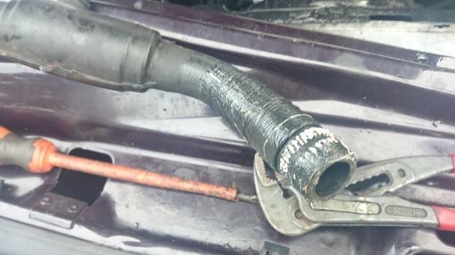

It's been another week now since it's been on the road and aside from a minor setback in the form of a split hose - gaffa tape kept me on the road for a couple of days. New hose was £20 from Heritage so no biggy.

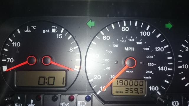

I hit a bit of a milestone earlier.
that's 190,000 on the chassis, approximately 89,000 on the block and 359 miles since all the new engine parts.

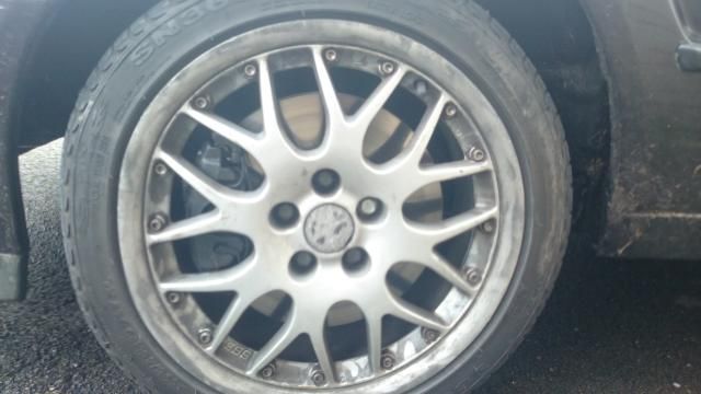

Plans this weekend are fitting new tyres , possibly suspension and give it a good clean so it's worthy of a few pics.
a slightly ropey wheel as the lips were painted yellow which has now been stripped off.

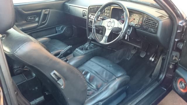

Gave the interior a freshen up to,
Should just require a quick wipe down an dry at the weekend which ought to allow me to get some better pictures. The transformation since last year is quite pleasing given the relatively meager budget.

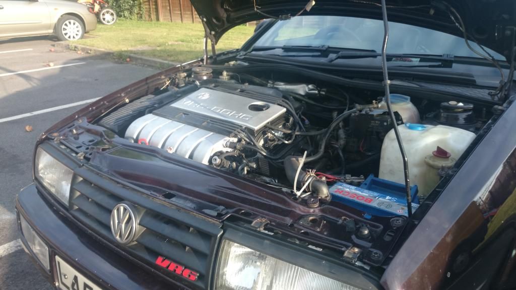

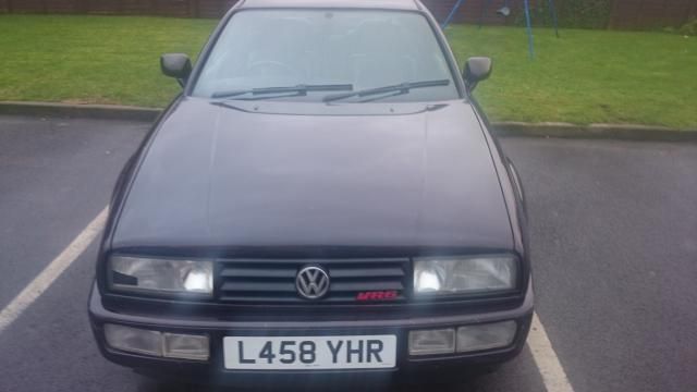

In typical fashion everyday since I had the car cleaned it has rained and been overcast. Either way here is a picture of how it currently stands

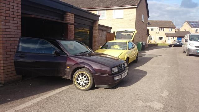

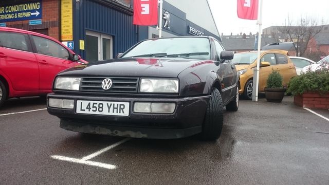

Gratuitous picture after the MOT, dodgy parking I know
an a couple of other randoms
