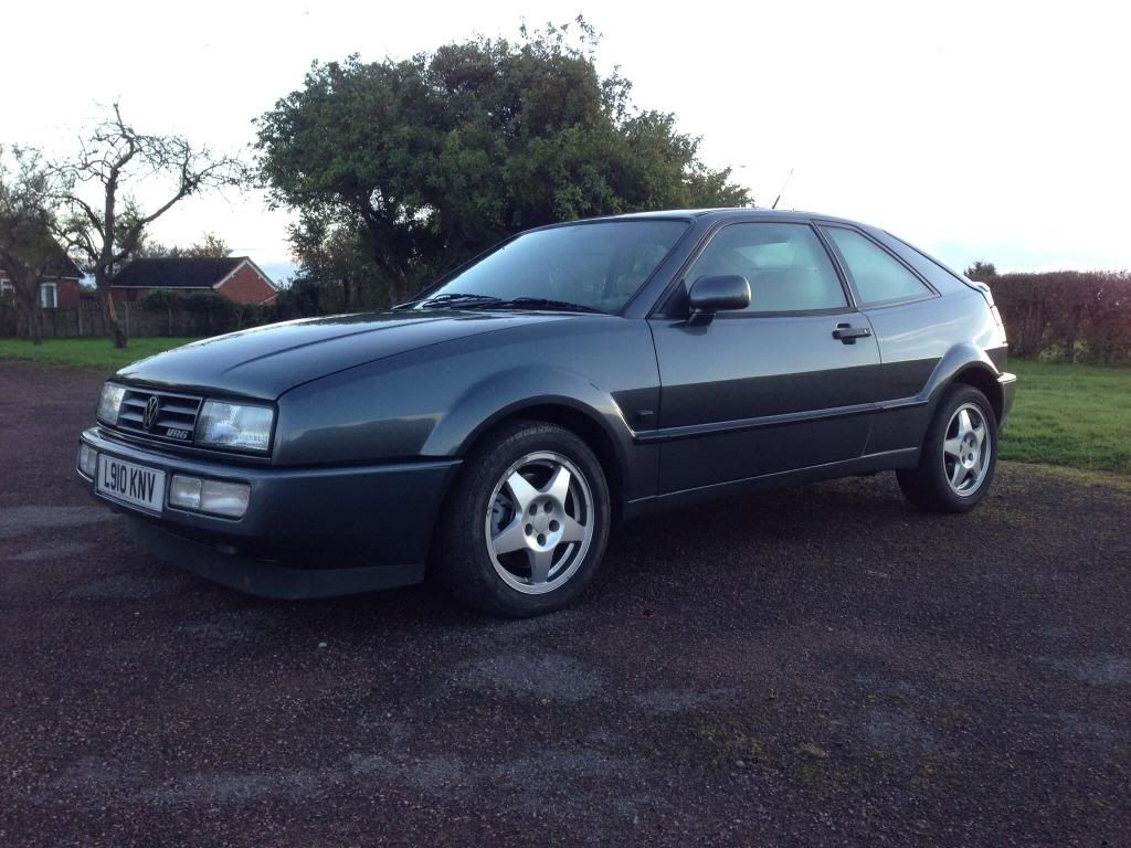

maff 10 Posted November 10, 2013 (edited) Just picked up a genuine storm grey vr6 with heated cream leather, my 5th! after selling my green vr6. I let the green one go purely because I couldn't warm to the colour, (it was a steal of a buy) and the windscreen leaked like a sieve which would of been a massive job. Anyhow I've bought Adam_sky's vr6 which was his mothers car since 2006 and apart from the rear drivers arch which needs sorting its mechanically pretty good and totally standard! My old vr6 is just round the corner and the chap wants to revert the car to standard so I may put the koni's on and also a Bmc air filter for the time being. Looking forward to returning this one to its former glory as it's my favourite colour and also love the contrasting interior, there can't be many storm greys with cream heated leather and a clear glass 'moonroof??' sunroof surely?? Here's a couple of pics from when I got her home today and ill maybe start a build thread of the bodywork which needs some attention. Edited November 10, 2013 by maff Quote Share this post Link to post Share on other sites

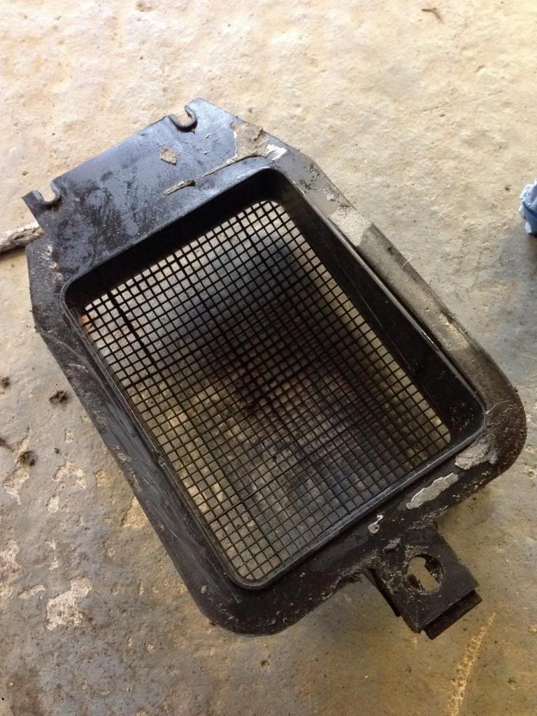

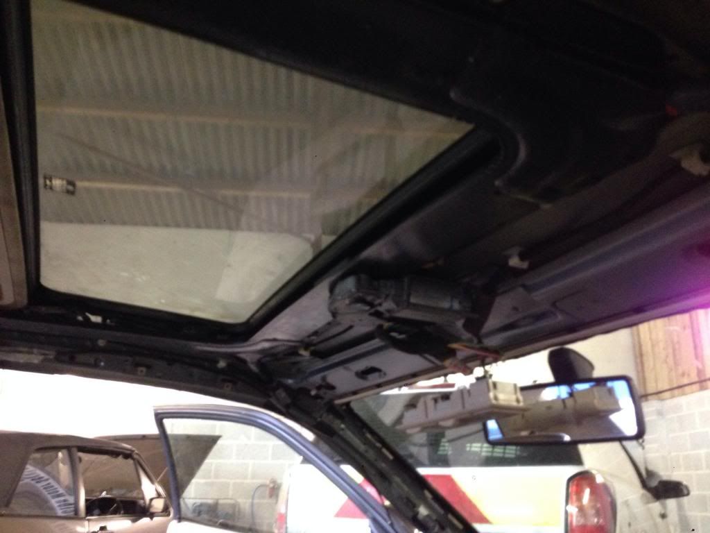

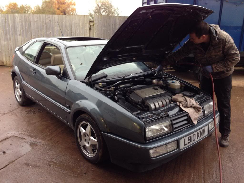

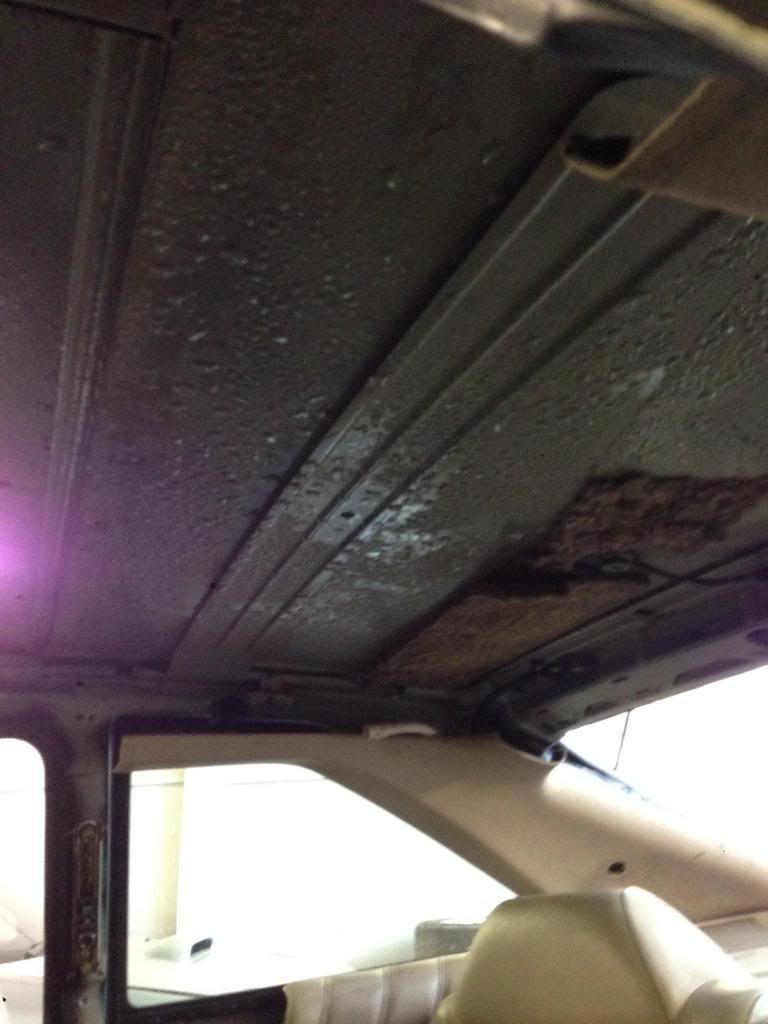

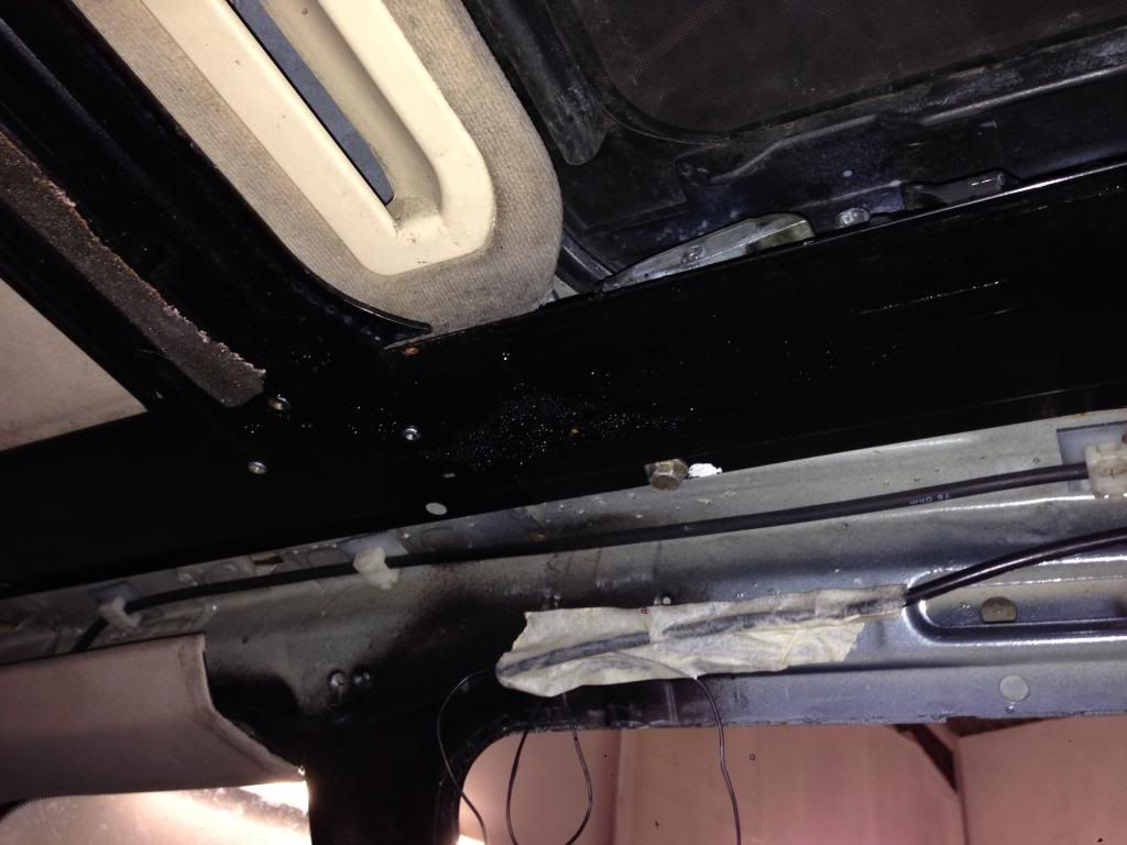

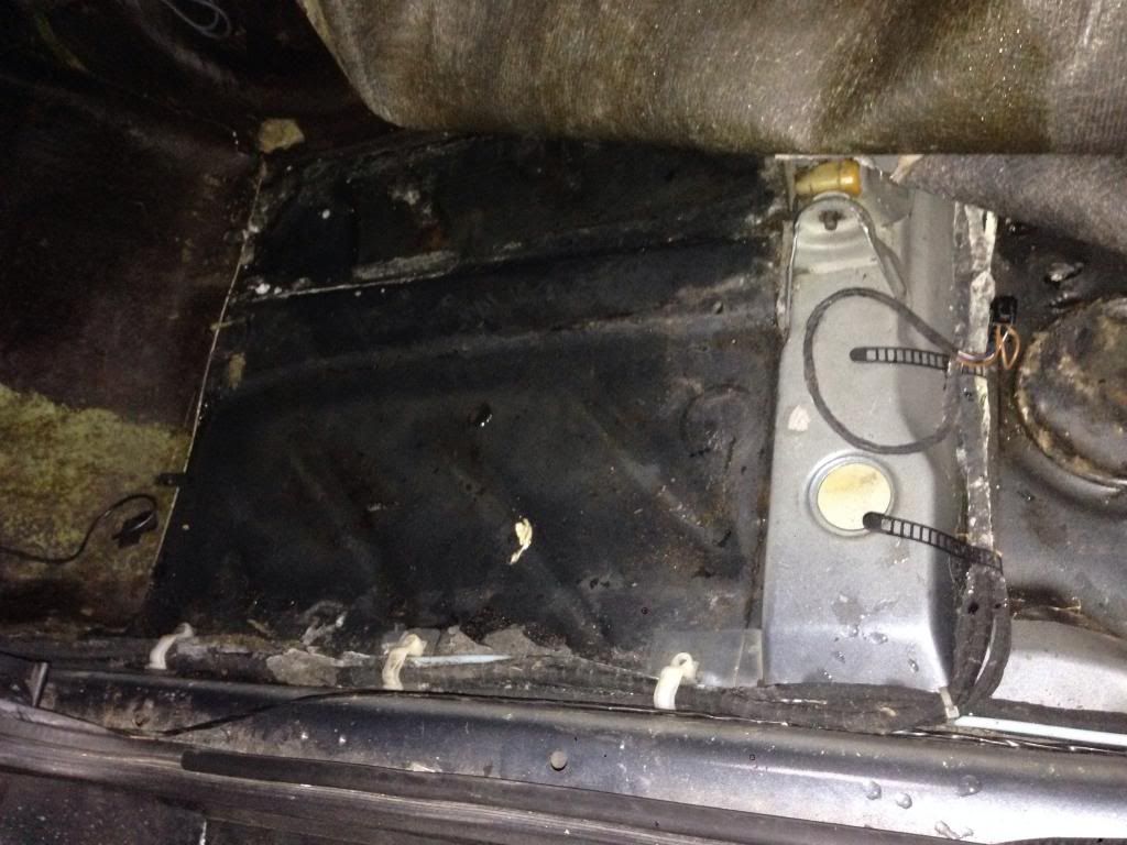

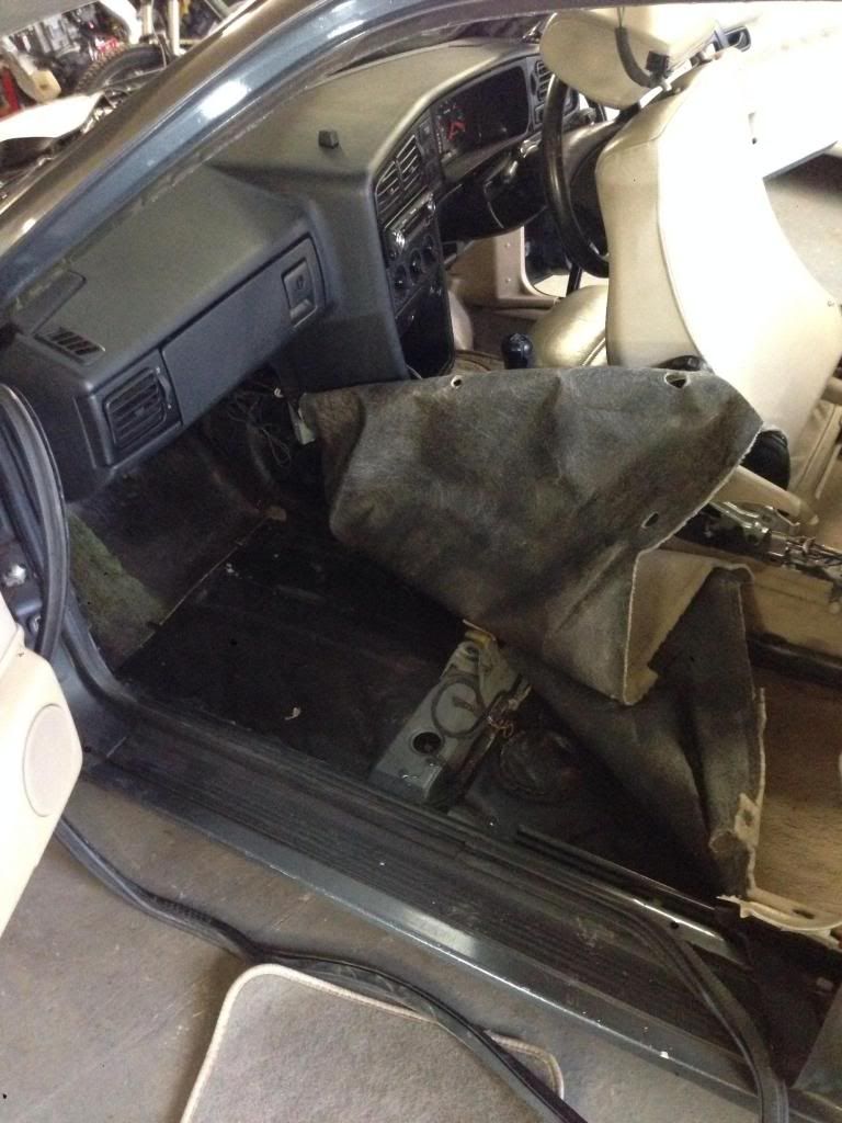

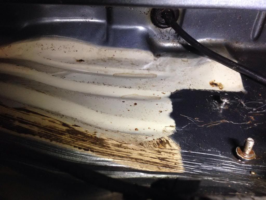

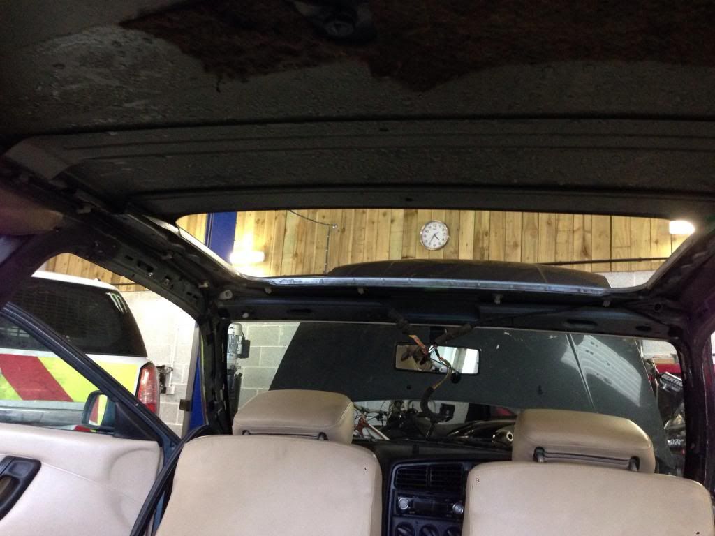

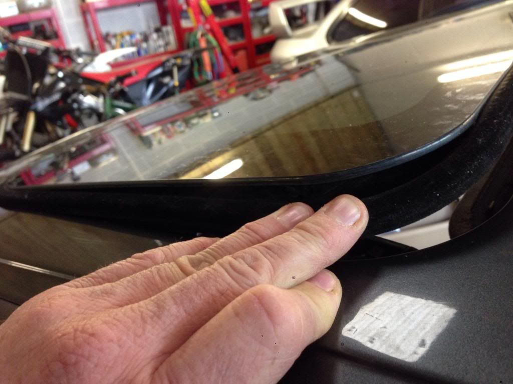

maff 10 Posted November 17, 2013 Good bit of progress today trying to find where the leak was coming from and also removing the sunroof to fix and sort that out. First off was to remove all trim pieces to remove headlining, also removed some old aerial cable and alarm cable which was cut at both ends Then out with the sunroof The sunroof was in a bad shape with a broken fixing point and also the bonding had gone causing the roof to lift from its mountings, going to investigate more tomorrow night as emphasis was on fixing the passenger side leak today Now on with removing the carpets Found floor to be wet through so removed sound deadening to dry out Condensation collecting inside roof! Then decided to get the car outside and pour water over the passenger side windscreen door area which then revealed three drips from inside the car under the scuttle and near the fan blower, heres my mate blowing out the scuttle with an air line Found the foilage seal in a bad way so will replace this tomorrow Also removed the ecu and found three drilled holes?? underneath which are letting water in, will be sealing these tomorrow also So a good day and pretty sure i've found the cause of my wet floor wells. Next up is to get everything back in and try to make a working sunroof from two that i have and then tackle the bodywork Quote Share this post Link to post Share on other sites
marshole82 0 Posted November 17, 2013 Good work, nice productive day!! Can only think those 3 holes were to drain a waterlog previously? Not a common issue though so a bit weird. Quote Share this post Link to post Share on other sites
maff 10 Posted November 17, 2013 The holes look like somethings been mounted from inside the bulkhead, alarm or tracker maybe? as theres no way you would get a drill bit inside the scuttle area! wierd one Quote Share this post Link to post Share on other sites
marshole82 0 Posted November 17, 2013 Ha! Selotape a 2p behind there and weld it up :-) Quote Share this post Link to post Share on other sites
maff 10 Posted November 17, 2013 Would that work?? mate was gonna weld it but he was worried about the sound deadening catching fire so i think ill just treat it put some sealant in there for now Quote Share this post Link to post Share on other sites
marshole82 0 Posted November 17, 2013 Hmm is it deadened underneath then? Either ripit out and replace or yeah, bathroom sealant! Just clean the rust up ;-) Quote Share this post Link to post Share on other sites
maff 10 Posted November 19, 2013 Sealed the tiny holes in the bulkhead under the Ecu last night and put everything back in the scuttle, will test for further leaks tonight then if leak free will be refitting the sunroof as my mate should have it fixed by today:-) Quote Share this post Link to post Share on other sites
