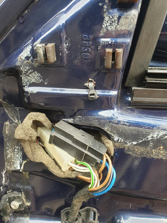

I'm struggling with this. Removed the screw and tried gently moving the triangle with a trim removal tool. It just seems to want to rotate on the top but not slide back. Any suggestions?
Thanks
Hasan
The barrel at the back of the trim (where the screw locates) is quite long and locates into the door. You have to lift this enough for it to be free and away from its location before sliding it back (It only needs to "just about" clear its location point). They're fitted real tight, so you have to be firm and persuasive, but not too heavy handed. Apologies if this is a clear as a muddy puddle, but I found this picture to help show what's going on behind it:

Many thanks James.  So its just the fact that the barrel is not clearing that it wont move away - good to know.  Might warm it slightly before trying to remove.
s there anything on the opposite end holding it secure, like a rolled edge or lip? mine seems to be restricted at the top corner for some reason..

I struggled with getting my exterior triangle off a couple of weeks ago and gave up, but will now re-visit this and replace that seal thanks to this image. 🙂
Well looks like mine had a bodge from who knows when. The retaining foot had had been snapped off and instead it was being held on with tie wraps looped together. Great. Not much i can do apart from perhaps getting a replacement. I'll refit this for the time being.
Anyone have a drivers side one spare?
