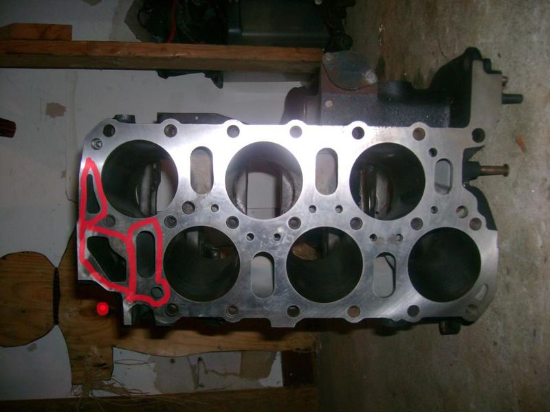

Jim Bowen 1 Posted April 16, 2015 Yeah, i went with the ARP headbolts. There were quite a lot being sold on ebay last year not sure if they are still on there but paid about £200 for mine, i used standard rod bolts though. There is also a way one valve in the block that you may as well replace. Its on that pic i posted on last page, right next to the top left head bolt hole. Quote Share this post Link to post Share on other sites
