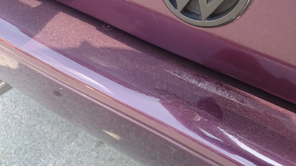

Managed to reverse it into a bollard earlier...
It was a half height one, saw a line of them, but didn't realise there was one near me .
Thankfully, the damage is pretty superficial, and will be gone in 3 weeks :) SO glad I got this wakeup call before the respray! :D
