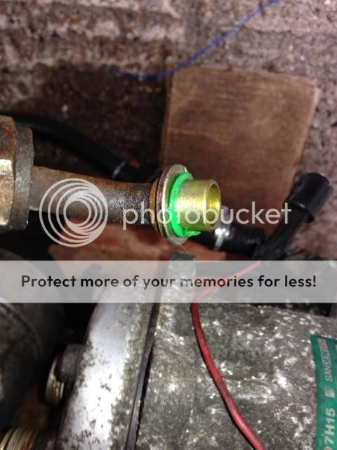

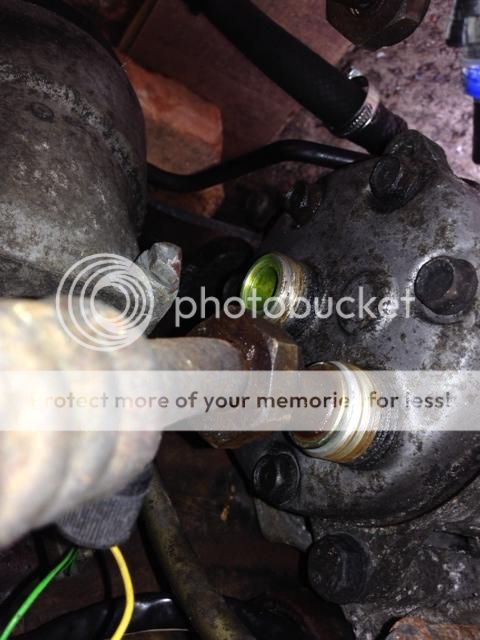

If it helps, here are some photos of my compressor and the o-rings. It looks like a different model to yours?

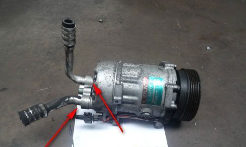

Not sure - mine is like the "top" one of the ones pictured here:
The lines seem to be secured in place with a bracket and one screw - marked 12A on the picture.
But having a hard time figuring out what o-rings are used here, and the dealer say they can't get them here (the norwegian dealers don't always carry all of the older VW parts, even if they are available from VW...:( )
I'v gotten a confirmation that the seals are the same on another Forum.

Mawrick, I've just ordered a box of HNBR o-rings for aircon use. If you know what size you need I may be able to post you a couple (assuming I have spares). Can you get the size number of the old o-rings?

Is 20.35 a "size" - at least that was what the dealer gave me for dimensions.
Hi Mawrick. Sorry. I don't have an o-ring in that size....I guess it should be a pretty standard size so can't be too hard to source from a garage.
