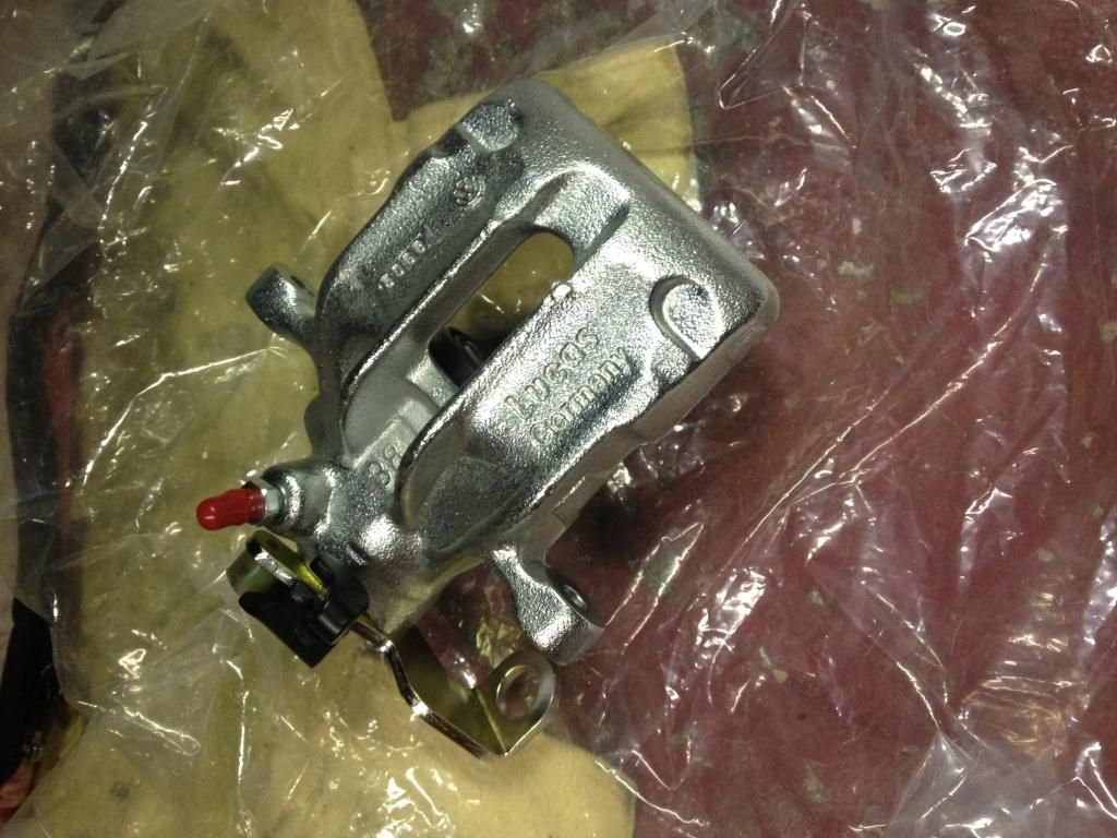

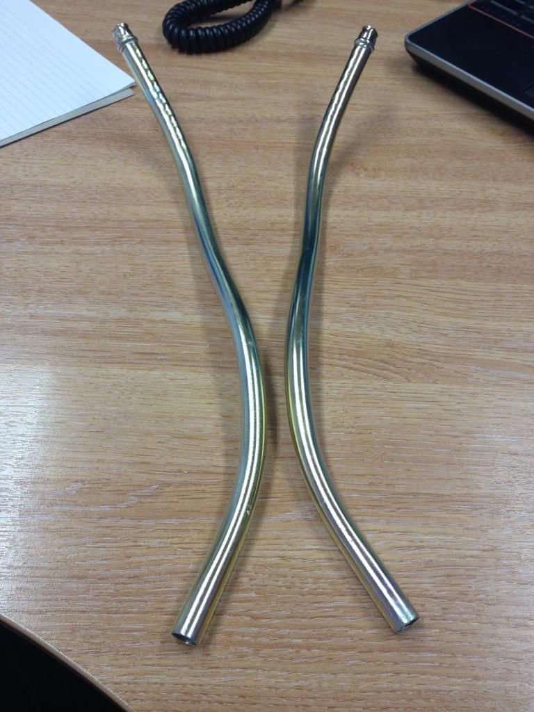

ChrisL 17 Posted January 14, 2015 Well my intention was to have the beam e-coated but in the end I couldnt get the new bushes out without damaging them and at the price for new ones it wasn't viable. So the plan is to use it this year then maybe get it done next year. So moving on, the guide tubes for the handbrake cables had started to corrode so I took them out, cleaned them up and re-plate them. I've also bought new genuine cables just because the ends will be cleaner. I've also had the rear calipers stripped, cleaned and replated, I'm really pleased with the finish: So now this is where i'm at, beam, hubs, backplates all back on. Should get the new discs on at weekend and hopefully get it back on wheels! Quote Share this post Link to post Share on other sites

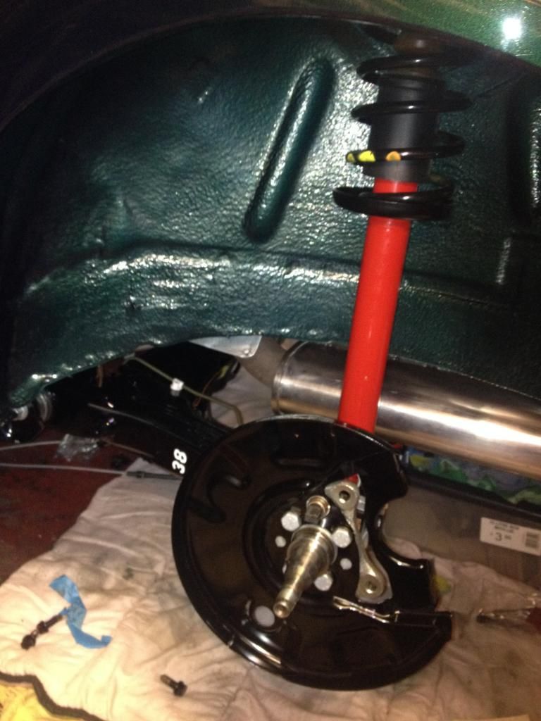

Harrier 1 Posted January 14, 2015 Are your rear shocks new , or have you re-painted them Chris ? Quote Share this post Link to post Share on other sites
ChrisL 17 Posted January 14, 2015 I painted them, they are actually koni adjustable dampers on standard springs (the only part not standard on the car). Are yours red or black on the new VR? Quote Share this post Link to post Share on other sites

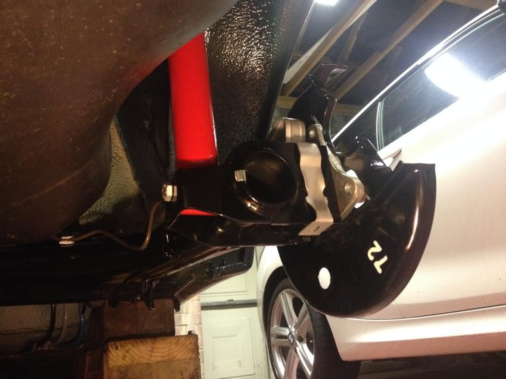

delfinis38 1 Posted January 15, 2015 I painted them, they are actually koni adjustable dampers on standard springs (the only part not standard on the car). Are yours red or black on the new VR? Red is the orig colour. What's with the 38 and 72 Quote Share this post Link to post Share on other sites
ChrisL 17 Posted January 15, 2015 The 38 and 72 must be factory markings as they where on the beam and backplates before I stripped them. I took measurements and positions before hand so I could get them the same. Quote Share this post Link to post Share on other sites

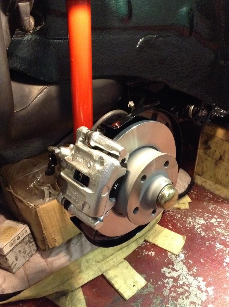

ChrisL 17 Posted January 17, 2015 nearly finished, new brake discs and refurbished calipers on. Quote Share this post Link to post Share on other sites

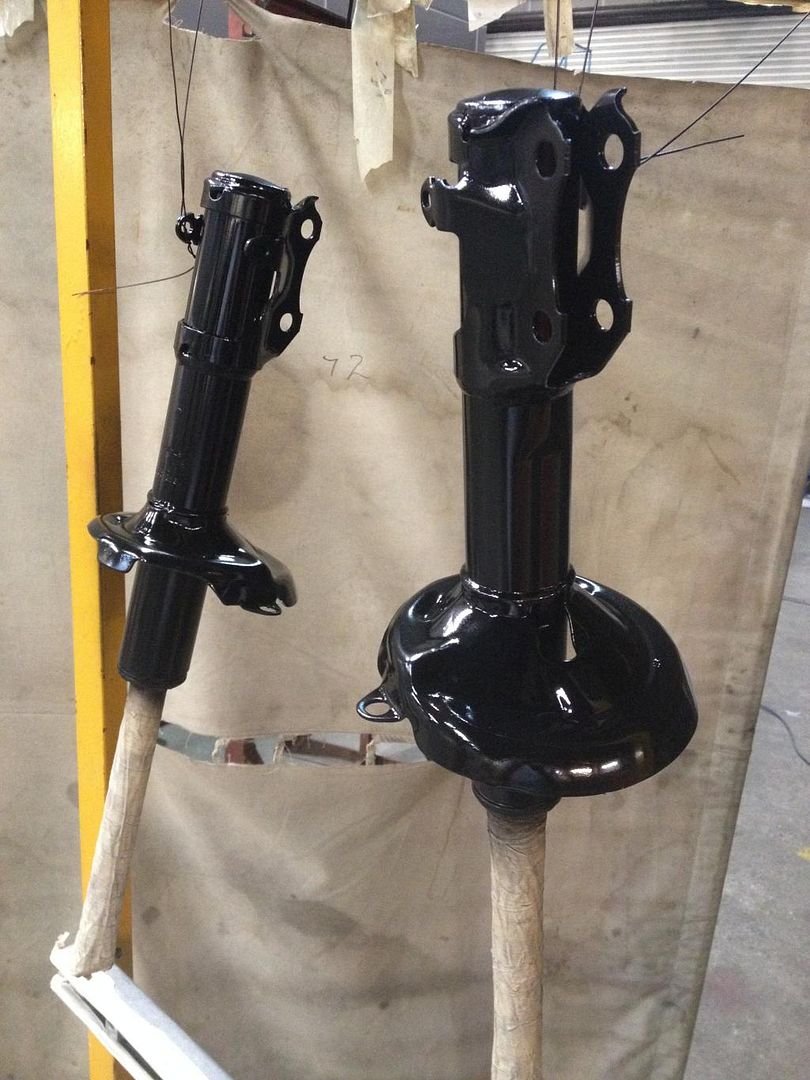

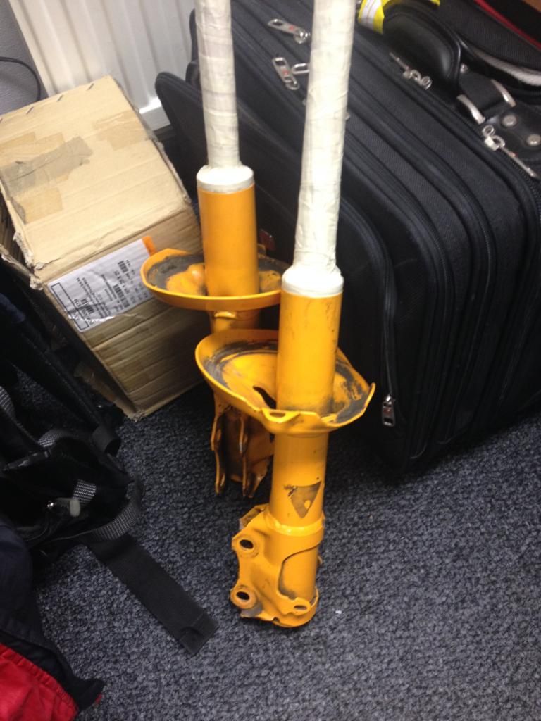

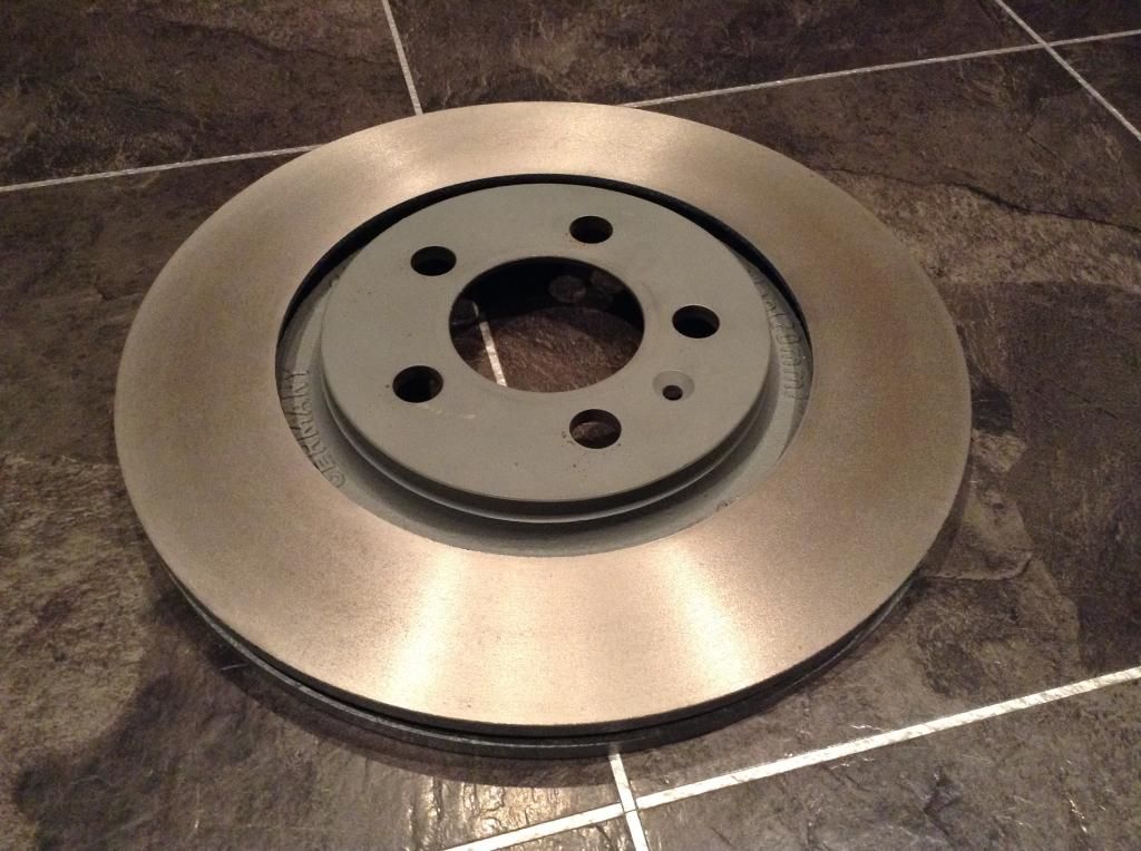

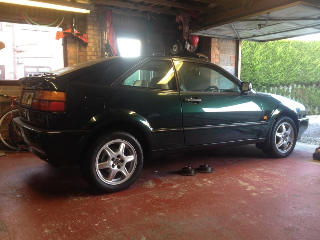

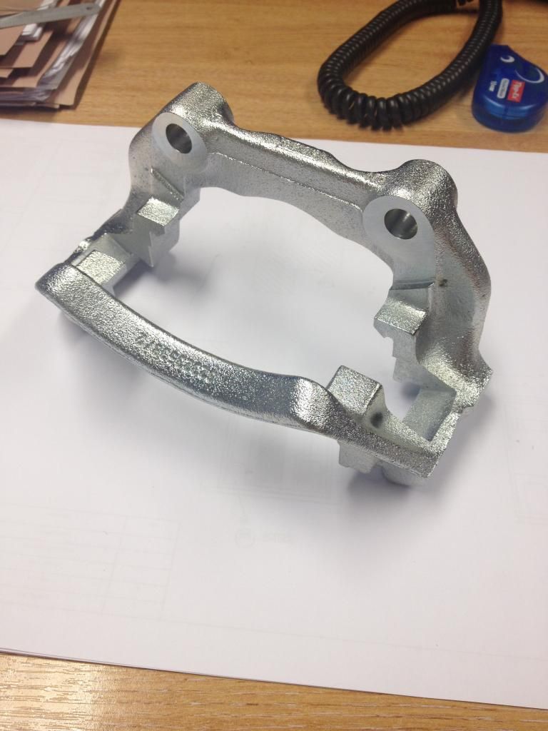

ChrisL 17 Posted February 28, 2015 The rear end is all complete now (for this year!) so back on its wheels But, looking through the gaps in the front wheels, the brakes didn't compare with the back so up it came again. The front discs where to be replaced with new genuine articles but VW have decided to obsolete them!!! I wanted to keep original items on the car as they have the part numbers and VW logo on the centre hub part so off to the shot blasters, then the machine shop for skimming then found some paint that matched the new rear discs The calipers have been stripped and sent away for plating and have come out great The front suspension struts where looking a little marked too so off they came and where masked ready for shot blasting And then a quick lick of black satin And that brings me up to date. A bit of cleaning under the front arches, refit the brakes then bleed the system ready for April. Quote Share this post Link to post Share on other sites
