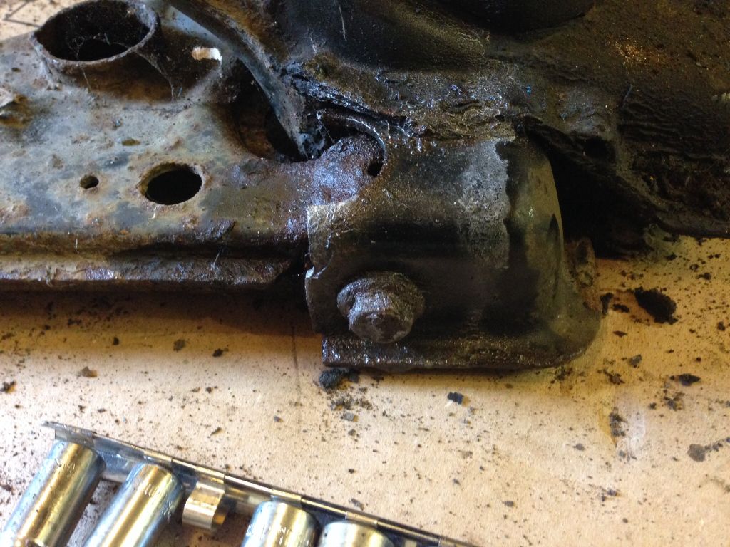

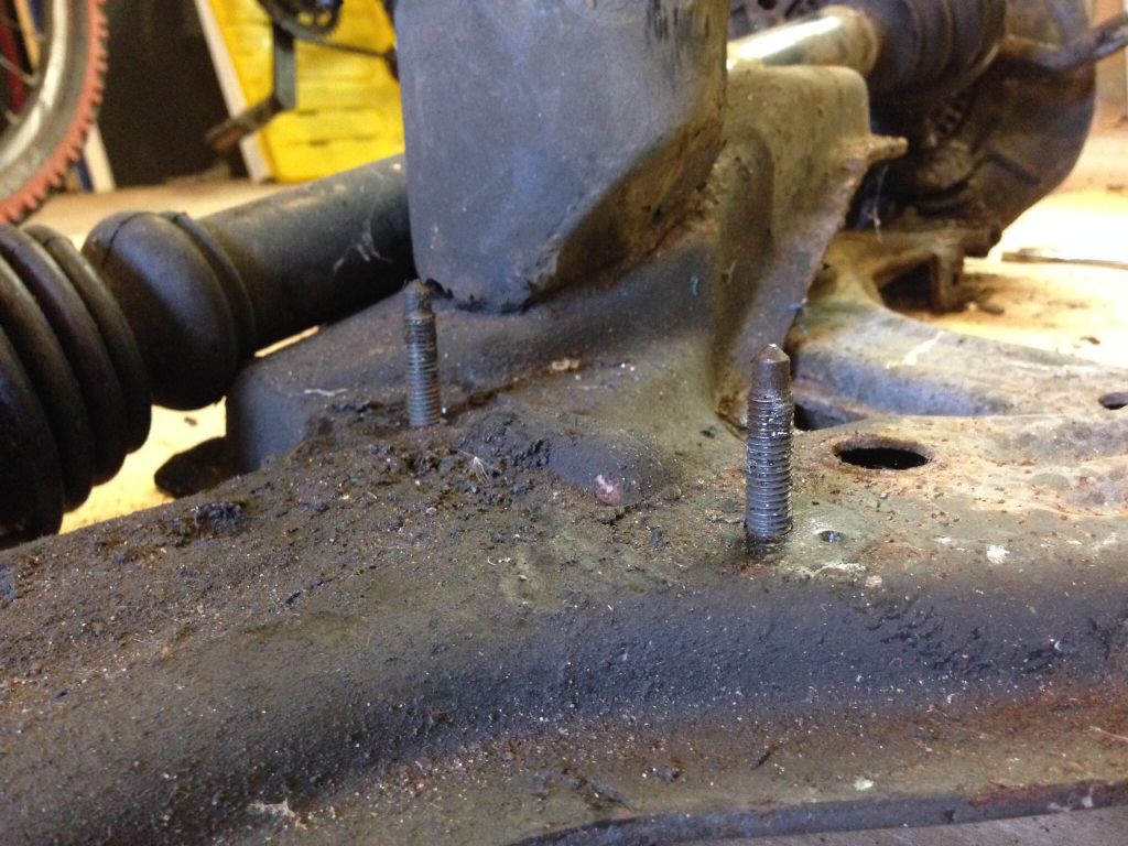

easypops 8 Posted July 12, 2014 Good evening all, I decided to strip down the spare subframe I have had for a wee while. Couple of questions 1.The steering rack came off easily enough but the bolts are still in place and don't seem that easy to remove? Do I leave them in or whack them out with a hammer? 2. The big bolts for the wishbones are very tight and I'm fairly sure I've read a couple of sheared captive nut stories, so should I use brute force or an impact gun? Also the bolt seems a weird size 11/16's? I will have other questions about bushes etc later :) Steering rack bolts Wishbone bolts Quote Share this post Link to post Share on other sites
ChrisL 20 Posted July 12, 2014 The steering rack bolts have a spline bit on the shank, just tap them with a hammer and they will come out. Put a nut on the end if you are planning on re-using them. I bought new though. One of them front bolts is likely to snap! If you can, try and get to the captive nut and soak in wd40 for a while. If they do snap you will have to drill them out carefully until you can get the arm off then drill the centre of the bolt with a pilot drill getting bigger until it comes out. Re-tap with an m12x1.5 tap (fine thread) Quote Share this post Link to post Share on other sites

Kezbo 0 Posted July 13, 2014 You can try heating the bolt up with a blow torch too, try to get to really hot as the differential thermal expansion of the metal is often enough to break the rust seal. Wait until the bolt has cooled before trying to undo it otherwise the risk of snapping will be increased. Also when I did mine the bolt was rusted to the metal lining of the control arm bush rather than the captive nut. I ended up cutting off the control arm and bush. Quote Share this post Link to post Share on other sites

sexybourbon 0 Posted July 13, 2014 Try giving the bolt a good whack face on with a big hammer , the shocks usually slightly free bolts up They are a true pig though i snapped mine half way down the shaft and had to drill it out while the subframe was still on the car It was a complete pig as the gearbox doesent allow you to get a drill in there straight Also i ised a 18mm impact socket on a bbreacker bar and then a steel tube on the breaker bar for more leverege but sadly when i thought the bolt was coming free it was actually just twisting until it pinged of lol Quote Share this post Link to post Share on other sites
easypops 8 Posted July 13, 2014 Just back from Halfords, got a breaker bar but they didn't have an 18mm impact socket or even a normal 18mm 6sided socket? Just the star type and I have one of them but it's already started to spin on the nut.......already had a blast with the hammer lol, that is one tool I can use :lol: Quote Share this post Link to post Share on other sites
