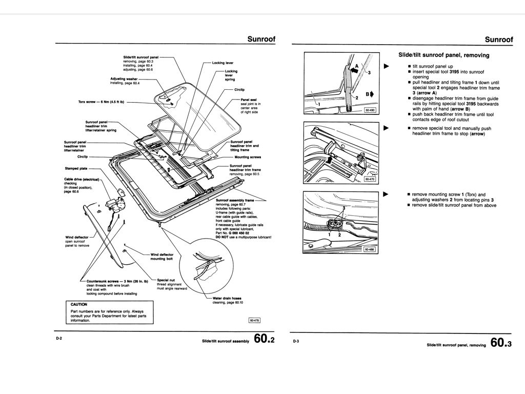

kevinbowe2000 10 Posted July 25, 2014 I got to work today and the sunroof only closed half way. So I remove headliner and sunroof from the car at lunch. Removed totally from car. It looks like one side of the sunroof is popped off the rails but the other isnt, and it is nearly closed and will not move. I did a search but unable to find any way of dismantling the sunroof so i might be able to get it back on its rails and close fully. Dont care right now if it will work or not. Just need to get it fully closed and back on the car (Security and potential rain). Does anyone know of a place that might have a few pics on how to do this, or even just a few instructions. Thanks in advance Quote Share this post Link to post Share on other sites
g0ldf1ng3r 16 Posted July 25, 2014 IIRC the bentley manual has an exploded diagram showing all the mechanism of the sun roof - not sure if you can find it online though Quote Share this post Link to post Share on other sites
pbradley98 0 Posted July 25, 2014 Try some of the links in this post... http://the-corrado.net/showthread.php?t=79750 Hope that helps.... I used the link to a wiki Pdf to help work out how to remove, strip and rebuild the cassette and reinstall that I posted in that thread.... Quote Share this post Link to post Share on other sites
easypops 8 Posted July 25, 2014 Hope this works :) Quote Share this post Link to post Share on other sites
kevinbowe2000 10 Posted July 25, 2014 Amazing. Thanks guys. Really appreciate it. Lucky it happened on one of the hottest days Glasgow has seen in donkeys. Quote Share this post Link to post Share on other sites
easypops 8 Posted July 25, 2014 What do you mean? It's always sunny here :lol: Quote Share this post Link to post Share on other sites
g0ldf1ng3r 16 Posted July 25, 2014 nice 1 easypops thats the diagram i had in my mind Quote Share this post Link to post Share on other sites
