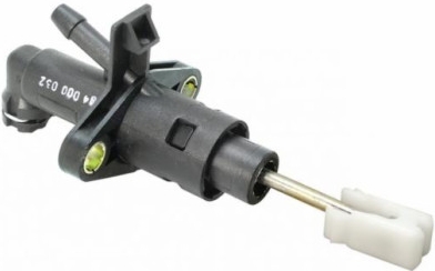

Jim Bowen 1 Posted December 8, 2014 Just looking around online and keep finding part no: 6Q0721388C Its for quite a list of cars, audi TT, Beetle, Jetta and looks just like the corrado one. Is there any reason i couldn't use one of these? Can get a decent sachs one for about £50 Quote Share this post Link to post Share on other sites

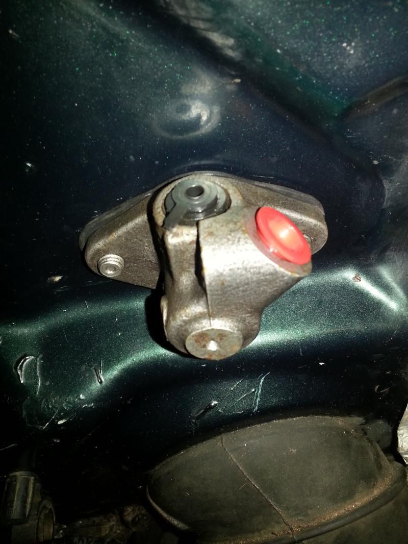

Jim Bowen 1 Posted April 30, 2017 I have an update. My reconditioned one popped today and is dripping fluid out onto my foot. Only done about 3000miles with it. The fluid coming out is really rusty. Seems fine in the reservoir. Quote Share this post Link to post Share on other sites

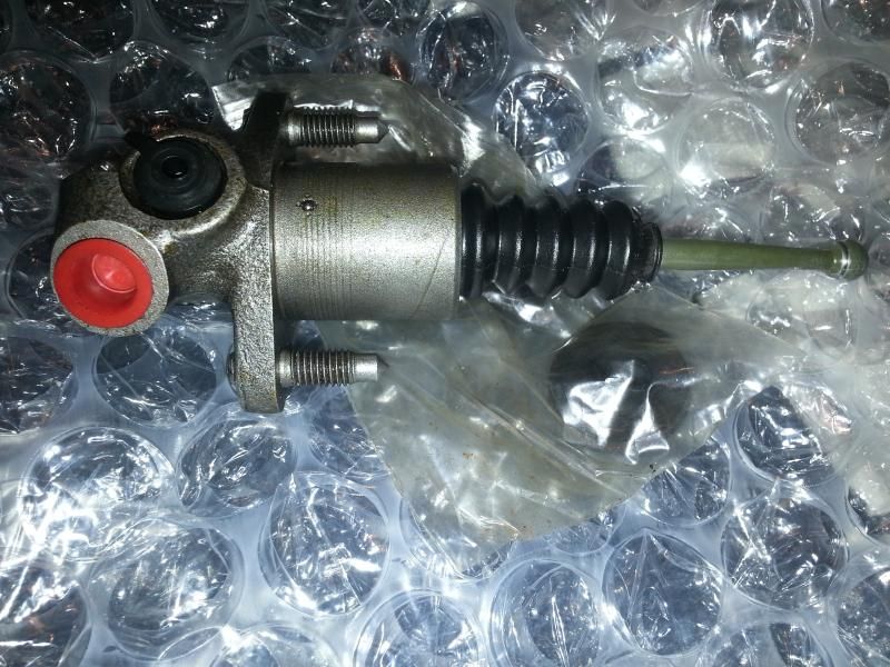

Jim Bowen 1 Posted May 4, 2017 Turned up today, i got a TRW one, was about £60 and came from France, am hoping it works, can't see why it wouldn't Quote Share this post Link to post Share on other sites
